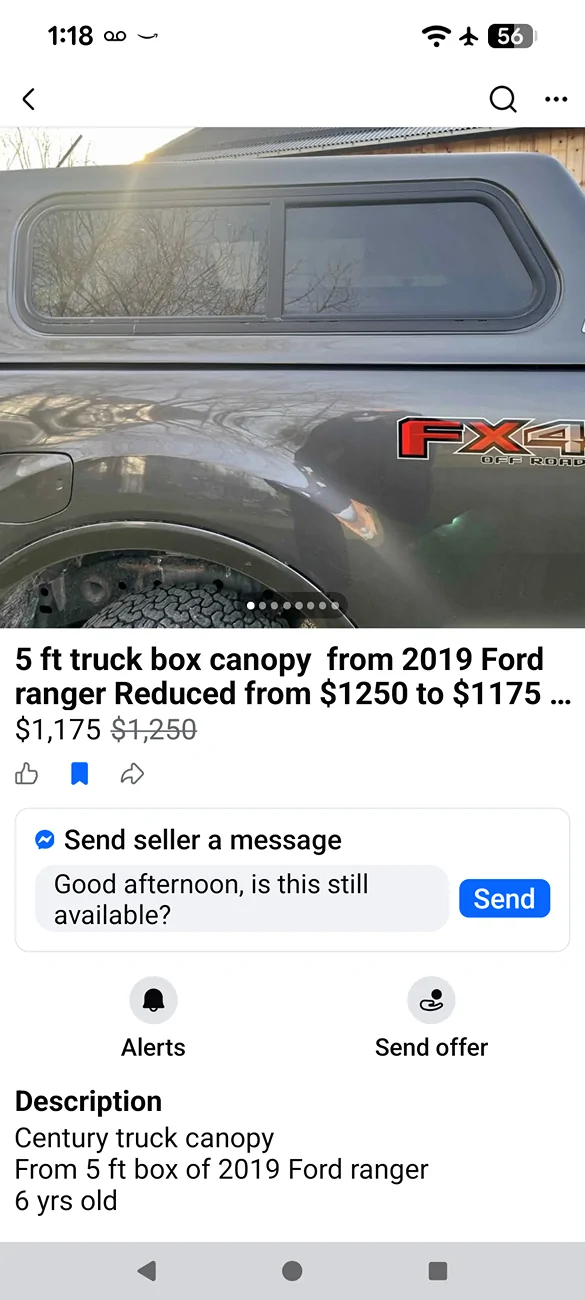

Has anyone successfully fitted a bed cap from the previous generation Ranger to a new one?
I've been sort of wanting a bed cap for my Ranger Raptor. There is a bed cap that has popped up locally on marketplace but it is for a 5th Gen truck. I'm wondering if anyone can tell me if it will work.
I'm running a 5G hard folding tonneau cover currently, so I know the bed sizes are very close, but the new Rangers have the dumb plastic bed caps that the previous gen did not.
Any input is appreciated.
