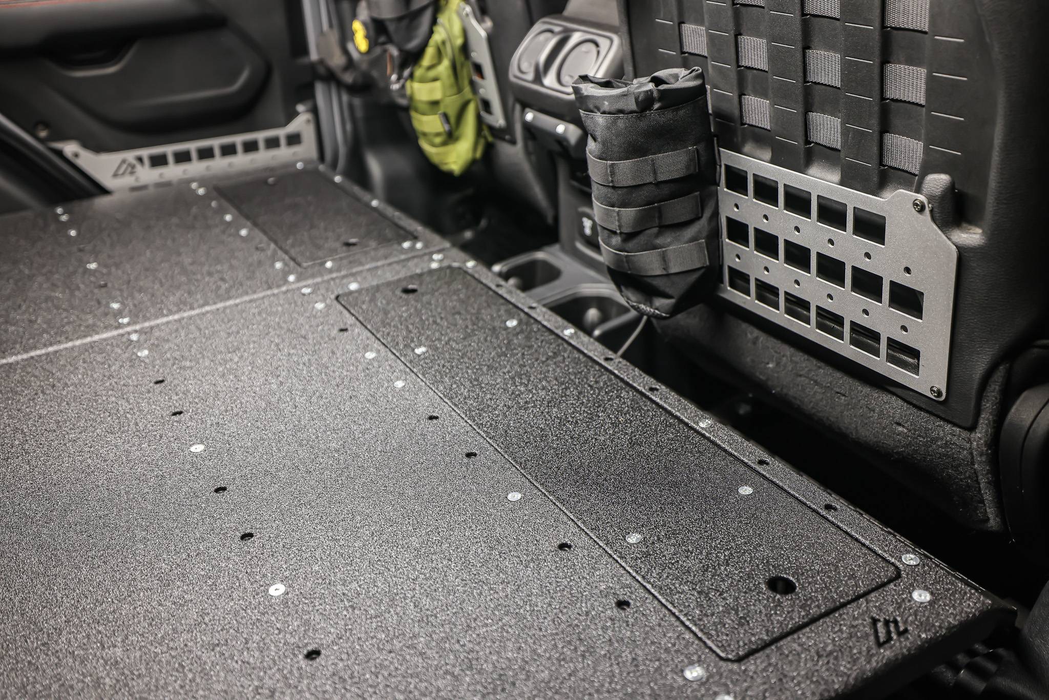

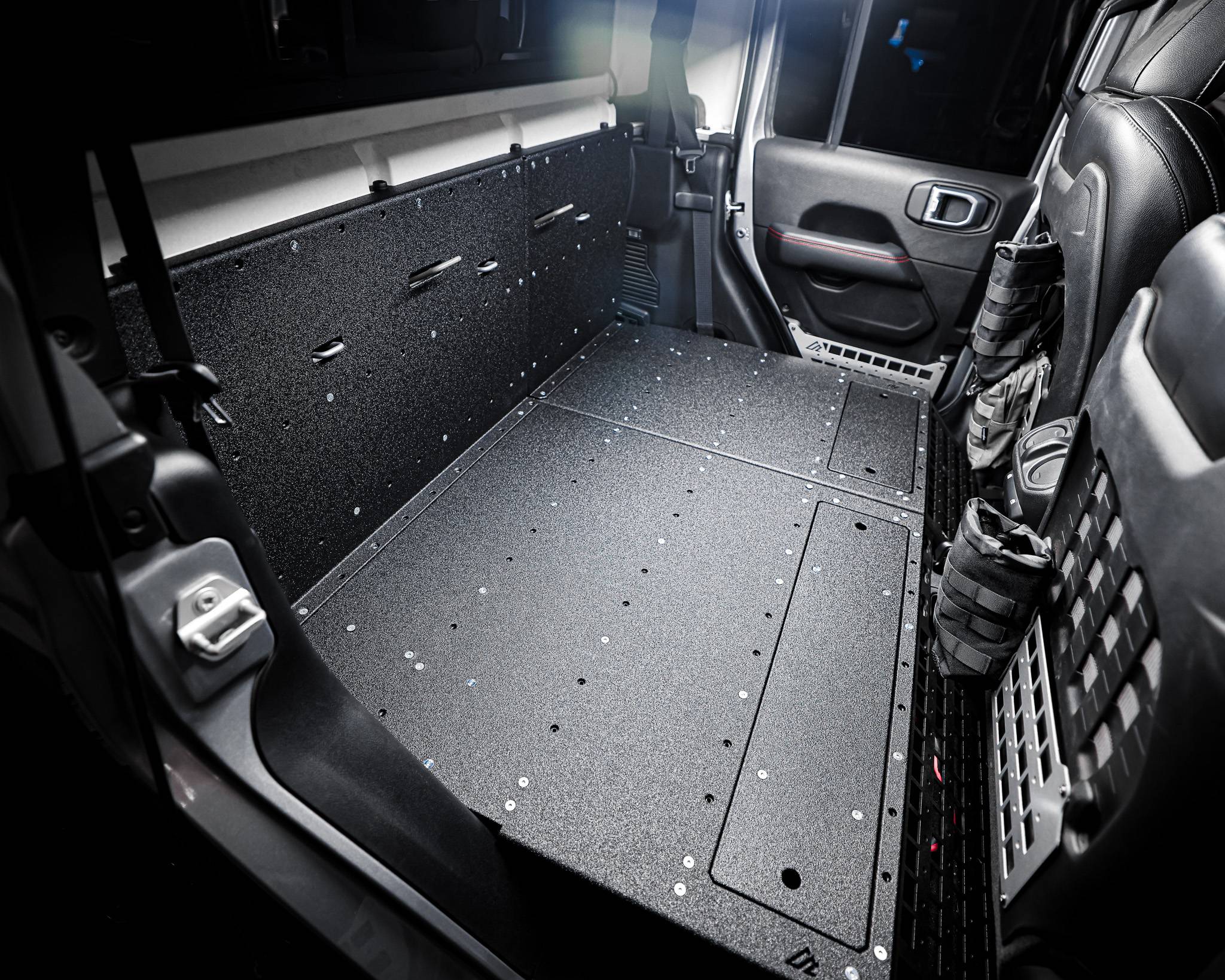

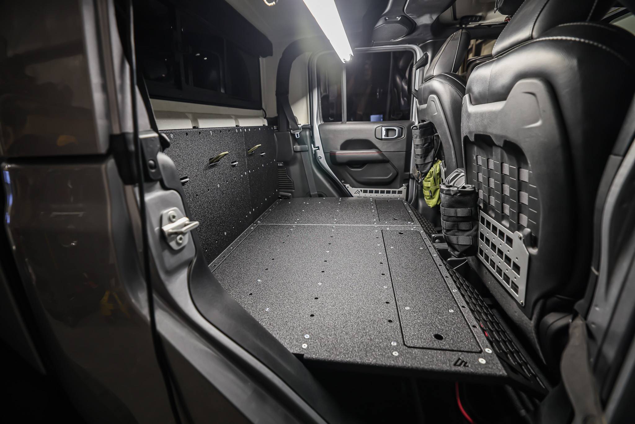

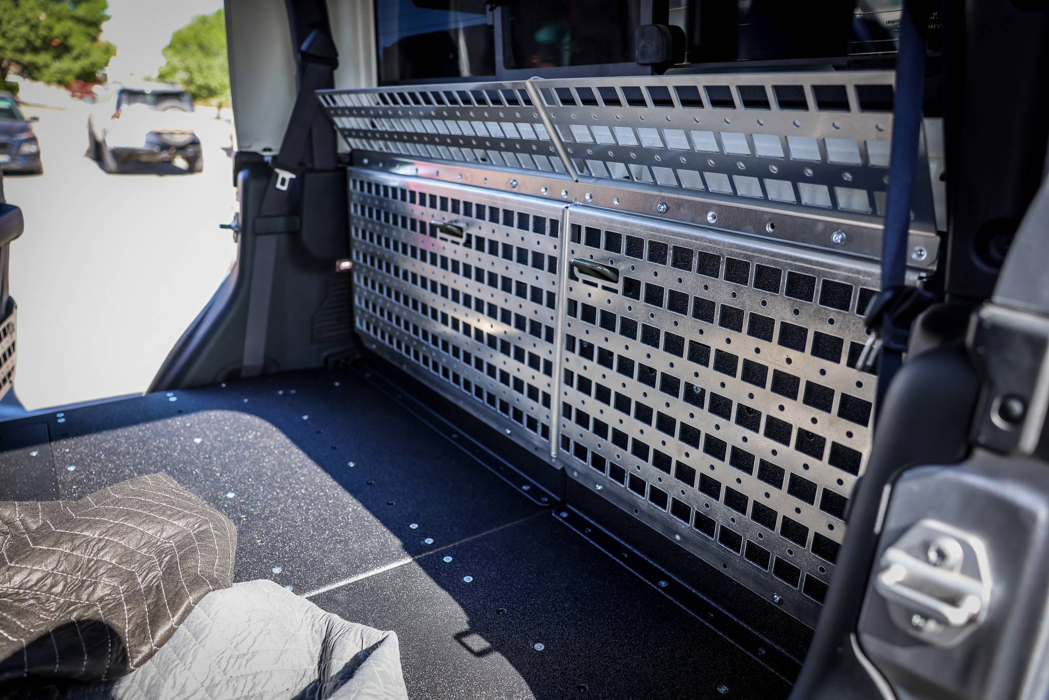

We are beginning the R&D process, on Monday, for our 6th-gen Ranger Crew Cab Rear Seat Delete. It will be very similar in design and function to our current Gladiator version. It will be extremely light weight and durable with the main panels being 3mm 5052 aluminum and the support structure being 3mm mild steel. Textured black powder coating and Mil-Spec liner will be the finish options.
More details on the design can be seen on our Gladiator product pages:
You guys have been very helpful with feedback and suggestions while we develop products for this market. We know rear seat deletes are not for everyone, but if this is something you would use, please let me know your use case and what features would make it work better for you.
We will also develop accessories, mounts, etc. that work with this product. Here's what we were working on yesterday as an example.
Here are some photos of our Gladiator version for reference.

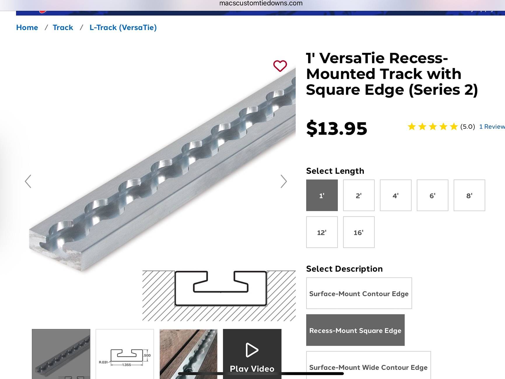

My goal would be a clear flat lower platform with recessed aircraft L-track along both the front and back edges, going full width (door to door). That way I can secure a dog crate or any hard cargo like storage bins. I have no need for a fridge, though many buyers would like the option to mount a slide on the right CURB side, for easy access when parked along a street.
So the bottom platform would be pretty much solid except for flush access panels to the two factory storage bins. A rear molle panel is great for all the small stuff like pouches, fire extinguisher, etc.
In the past I have fabricated wood platforms from Baltic birch, and added a strong cargo barrier behind the front seats, I have sold all my woodworking tools and no longer want to go that route! So with my RR I need lots of good solid adjustable tie down points along the bottom. I would probably buy just the bottom panel first, then wait to see if I really needed the bulkhead panel.
