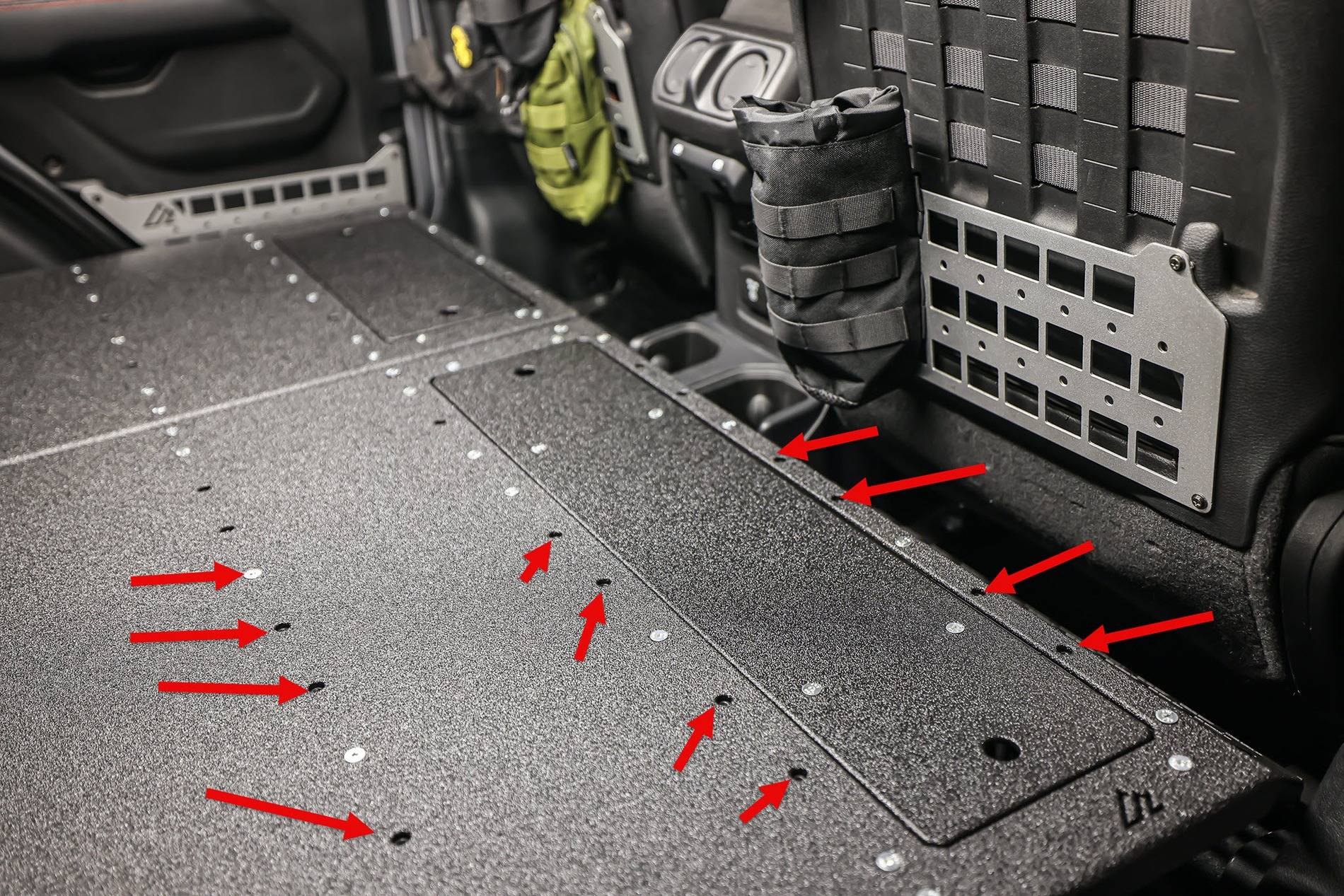

As with all of our MASS (Modular Adaptable Storage System) products, we incorporate patterned tie down points. We use the same pattern throughout our product line so the mounts/accessories/slides are all transferrable to different vehicles. We use the same "grid" that L-track uses (1" spread). In some of our products, we actually cut out a "dogbone" that is two holes of the L-track pattern. That way, you get the benefit of L-track without the expense and drawbacks. That's still a tradeoff, though. The extrusion is stronger than the plate.
That being said, it seems like you're mostly after the ability to secure things to the floor, moreso than the L-track itself. Our seat deletes have round holes through the top plate that line up with threaded plates below the surface. That way, nothing is protruding above the floor and the holes are small enough that things can't fall into the holes. It has worked great thus far. It's a lot easier to clean this way as well. The L-track seems to hold dirt and dog hair in the creases, etc.
We will continue down the current path as that's what is expected with the commercial clients, but please feel free to continue suggestions. We're definitely paying attention to all of this. Thanks for the feedback!

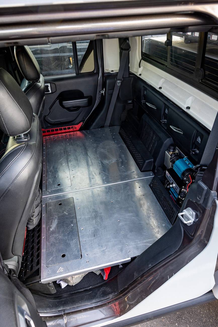

Attached is a photo of the "OEM Back Wall" version we produce for the Gladiator. It retains the Gladiator's sub and plastic wall panel. This is what is in my Gladiator now and I really like it. Unfortunately, the Ranger's back wall is not as finished as the Gladiator, so we may need to build some panels to make it look more presentable. As always, our panels aren't just visual. They'll have attachment capability as well.
Please see my recent reply to John for an explanation on the attachment holes. I'm confident it will provide what you're looking for.
It may be hard to see in the photo below (very bottom of the photo), but there are removable side panels that are attached with thumb screws (not installed in this photo). Personally, I don't even install those on my vehicles. I really like the easy side access to the area below the panels and when the doors are shut, that prevents anything from falling out. Would any of you guys be interested in these removable side panels?

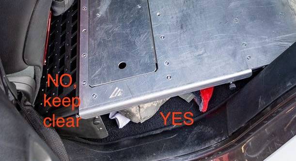

One more suggestion, please leave adequate clearance behind the front seats, we use that space for all sorts of bulky items - purse, laptop, “possible bag”, emergency starter box, shoebox with Kleenex, a 1 gallon plastic bucket with cleaners and rags, etc. I would hate to lose access there, normally the seats are half way forward and access is barely acceptable and not nearly as easy as in my old Land Cruiser 200. The Ranger cabin is tight….. admittedly some of the stuff I already carry on the floor could work on the platform too, unless I have two dogs loaded.
it would be cool to have two front platform sections that extend far forward, with piano hinges, so you could flip them up past 90 degrees if you needed the OEM floor room vs the extra platform room. Did I make that clear? It’s a little fuzzy even in my head…… I really don’t want to lose the use of the truck floor immediately to the rear of the front seats. I think the ramp with openings is for air flow, is that correct? Please explain. It looks like a dirt and hair trap to me, how easy is access to clean under it with a shop vac?
And I do like quick access to the otherwise wasted space right at the doors openings this is perfect for small stuff like bungee cords or even snacks….

The panels immediately behind the seats have the MOLLE cutout pattern on them. It's mostly for weight savings and air pass through, but we definitely have people mount MOLLE stuff to them. As for not losing the space behind the seat, at first thought, that may be contradictive to the purpose of this product. We are intending to create the largest flat platform possible that is sturdy enough to secure big heavy things. If you are looking for a "half depth" platform, that is probably not going to be a good fit for this system. I'm not saying that wouldn't work, or that we wouldn't make something like that, it just won't be this product.
I don't know what our mounting options are for the Ranger yet, but once we get into it I will have a better idea of what the product will look like.
Thanks for the feedback! We appreciate it.
