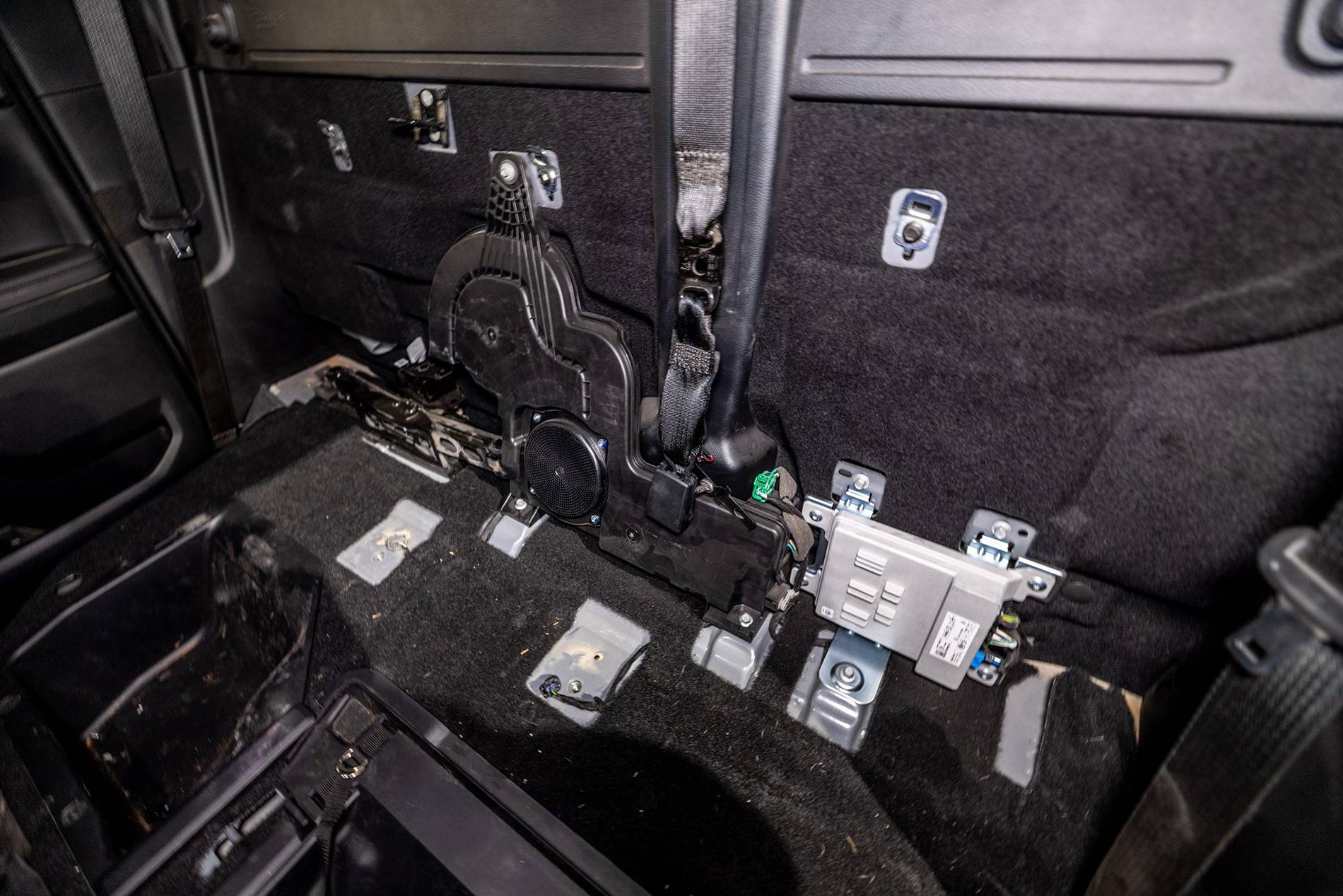

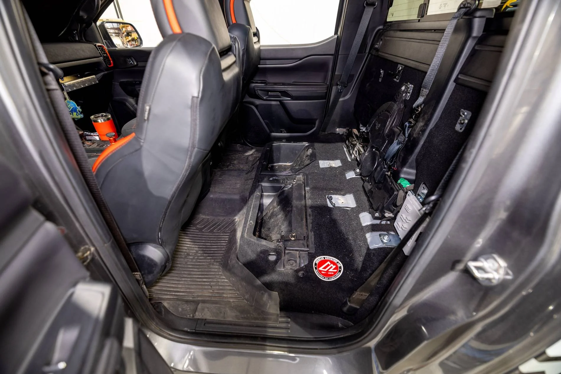

Alright, here's what the truck looks like without the seats installed. Pardon the dirt. This one gets beat on nearly every weekend. First impression, there is a ton of space back here without the seat. This will make for a really great storage area.

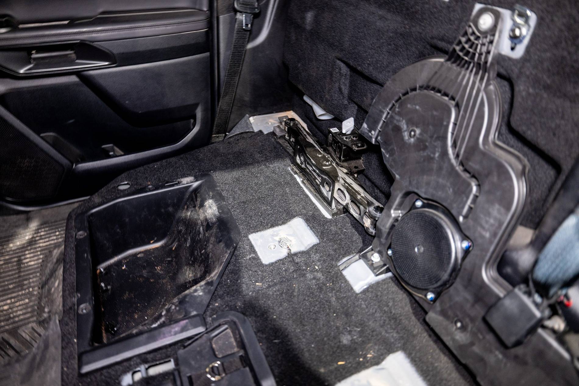

Here is where your opinion counts. We have some options to consider while designing this platform.
Would you rather keep the OEM jack in the OEM location or would you rather have the extra platform space and remove the jack?
Would you rather remove the subwoofer or work around it?
Another option would be for us to provide "patch panels" that take up the space for the jack and/or sub if you wanted to remove those (or didn't have the sub), but that will add to the cost. We probably wouldn't be able to make those components optional just due to the way they'll need to attach to the platform. They would just be included with the product and you could choose to use them or not.
What do you think?
A few more dollars for panels that allow the mounting of the jack in it's factory location or relocation of the jack is worth it. Different customers won't have to just "make things work".
Likewise, setups change. For now, I'd like the jack in the factory location but, later, I'll probably want to install a better jack somewhere else. Might even keep the factory jack there as a backup.
It's too versatile to ignore.

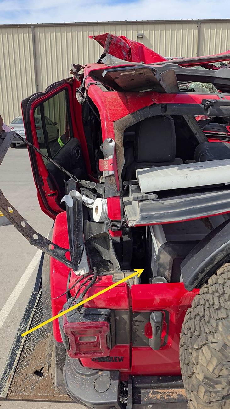

Is the plate strong enough to retain, say, a refrigerator (could be a tool box, or anything else that's relatively large and heavy), in a collision or on higher speed washboard roads for hundreds of miles at a time? It's not just stuff in the bed I need to strap down.

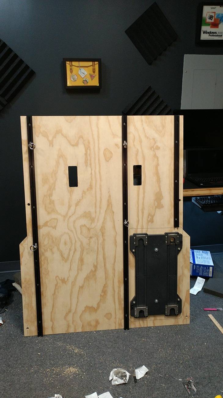

The plate pictured is from my Land Rover. It's fitted with flanged threaded inserts to prevent pull-through; but the plywood itself is strong enough to stay dead flat when cranking down on jerry cans.

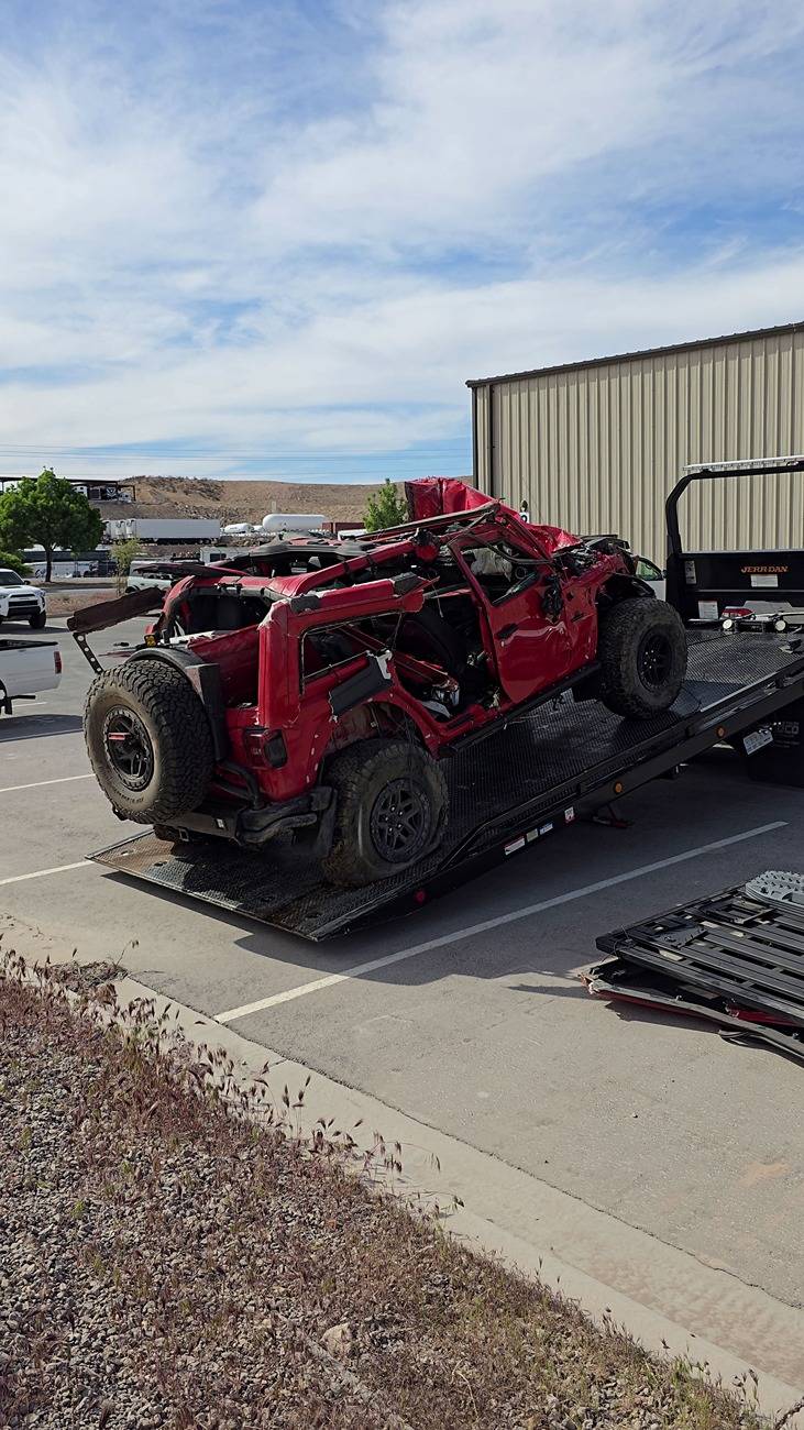

It recently withstood being nailed at near 60mph when not moving with a bit of medium mass cargo strapped down. Nothing happened back there. The vehicle was destroyed, but the cargo plate survived, and so did everything on it.
That's what my plate looks like for versatile use anywhere in the world with any manner of cargo. The refrigerator mount was the weakest point, but it held through hell. I need something that can take the same kind of beating that thing did. The tracks were solid as a rock on the plywood.
OEM position
Keep the subwoofer.

I’d like to keep the jack and the subwoofer where they are.

Terrible that happened, but that's exactly what I needed to see: Some manner of visible test of attachment, durability, and cargo retention. Given that's an absolute worst case scenario, I would certainly imagine the product will be sufficiently built.
My concerns came not from a material standpoint, so much as what I've seen done with that material in the past. I've seen cargo solutions that bend under stress many times, or feature weaker areas in logical retention locations.
As for mine, the original plate was actually 1/2" thick HDPE, but that, while in many ways better than what I ended up with, turned out to be annoying. The plywood was only in when the trim was. Quite often, it was a tin can back there; no trim or carpet at all. I had a U shaped tubular cargo cage with a spot for a sub reserved back there at one point, but ended up selling it.
