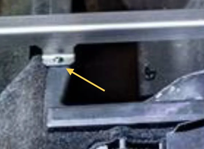

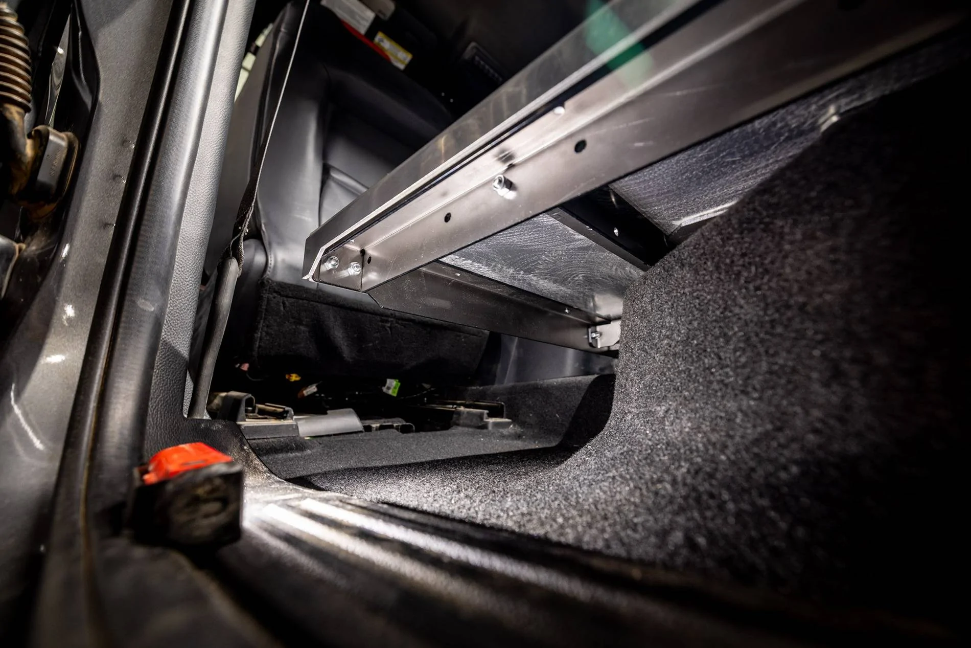

Lovely work, the problem with your posting detailed pics is you get questions like this: the brackets that attach to the top of the plastic Ford cubby liners and also on top of the OEM carpet, do you remove material and/or install hard spacers? Heavy loads on TOP of these soft materials is not good, they will break or compress. Please comment.

I will speak to your install questions in a follow up post. Some great news to share there.
As for the plastic, it would take a load of several hundred pounds to cause an issue there. At that point, the steel rails would be suspect, which are overengineered for this application already. I don't think we would provide any type of spacer for that as there is substantial surface contact with the plastic.

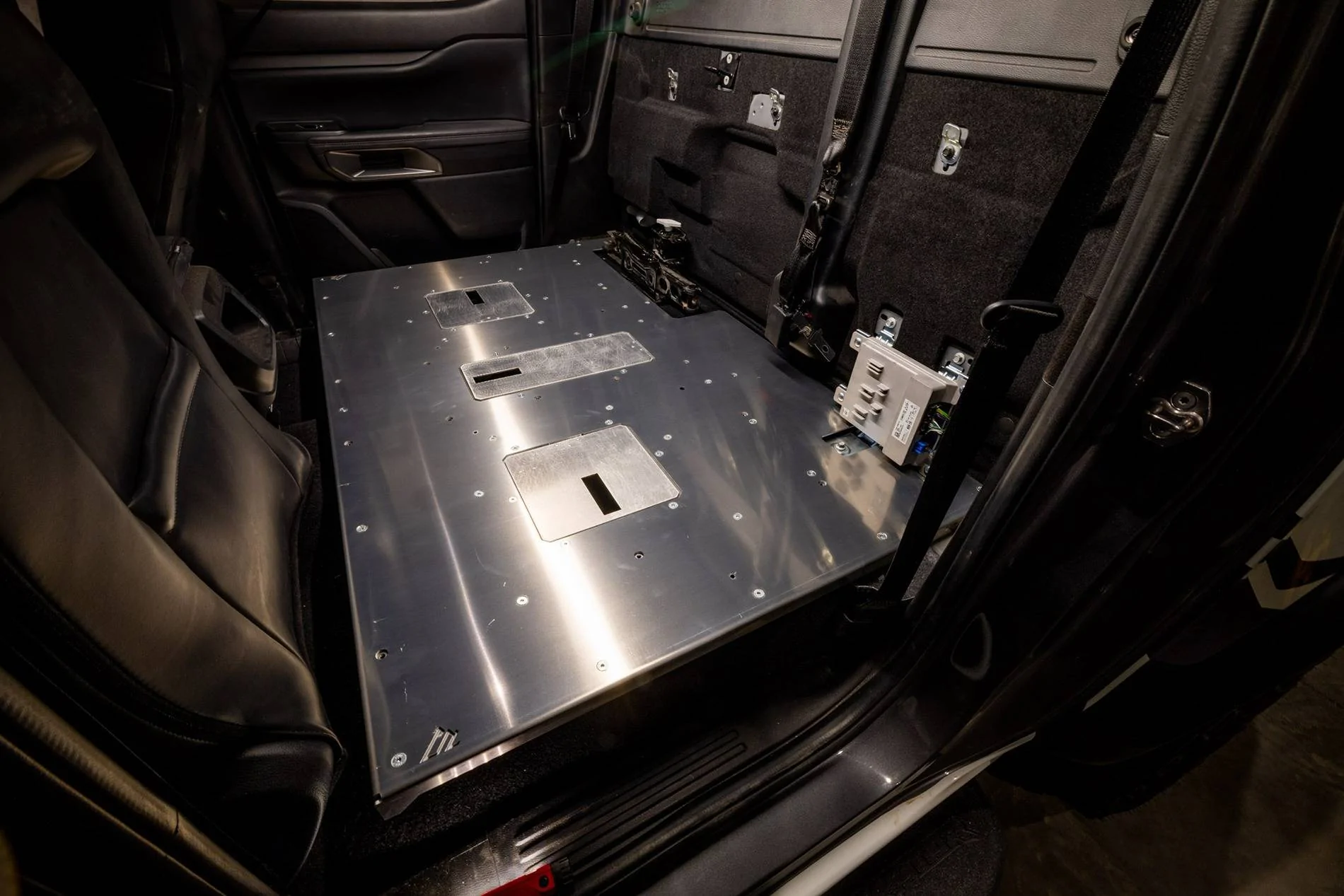

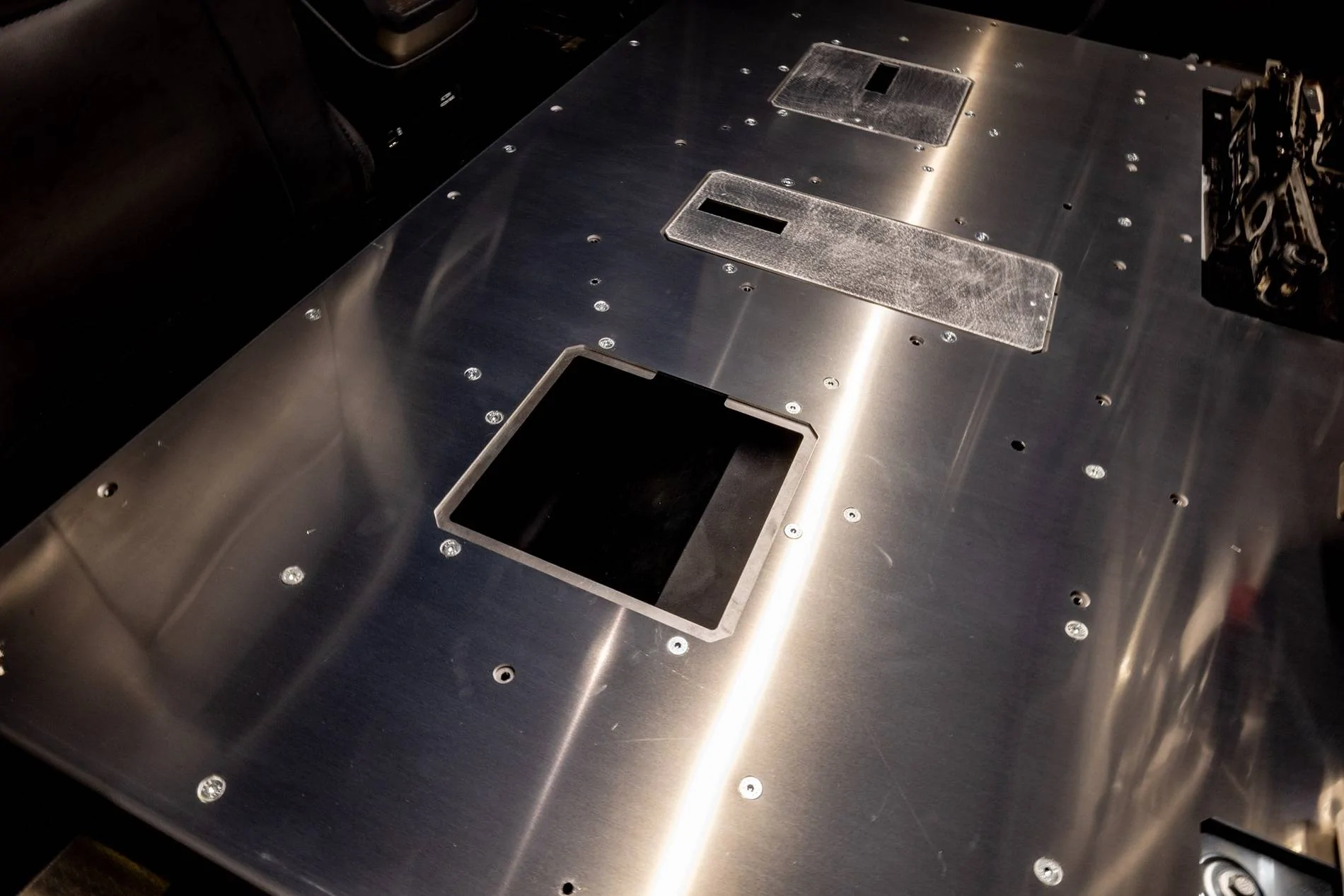

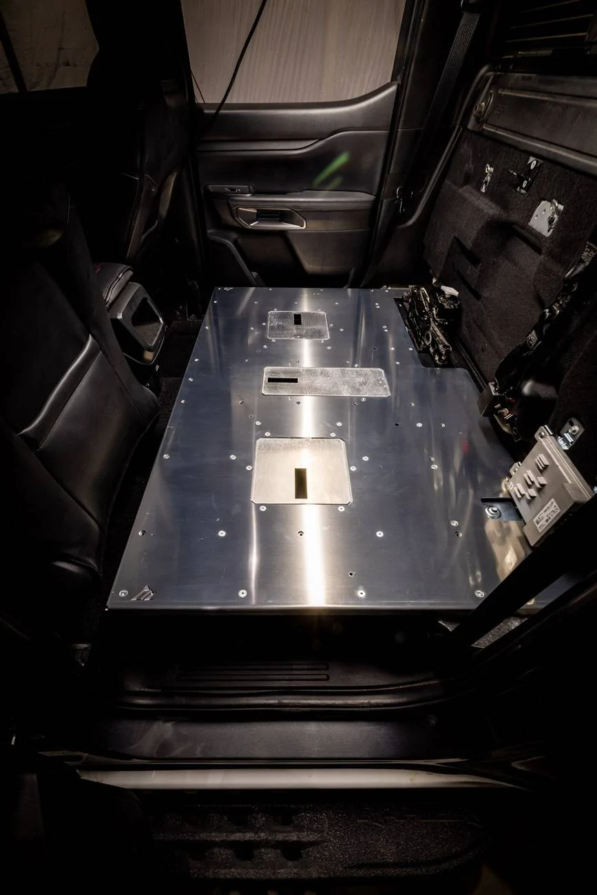

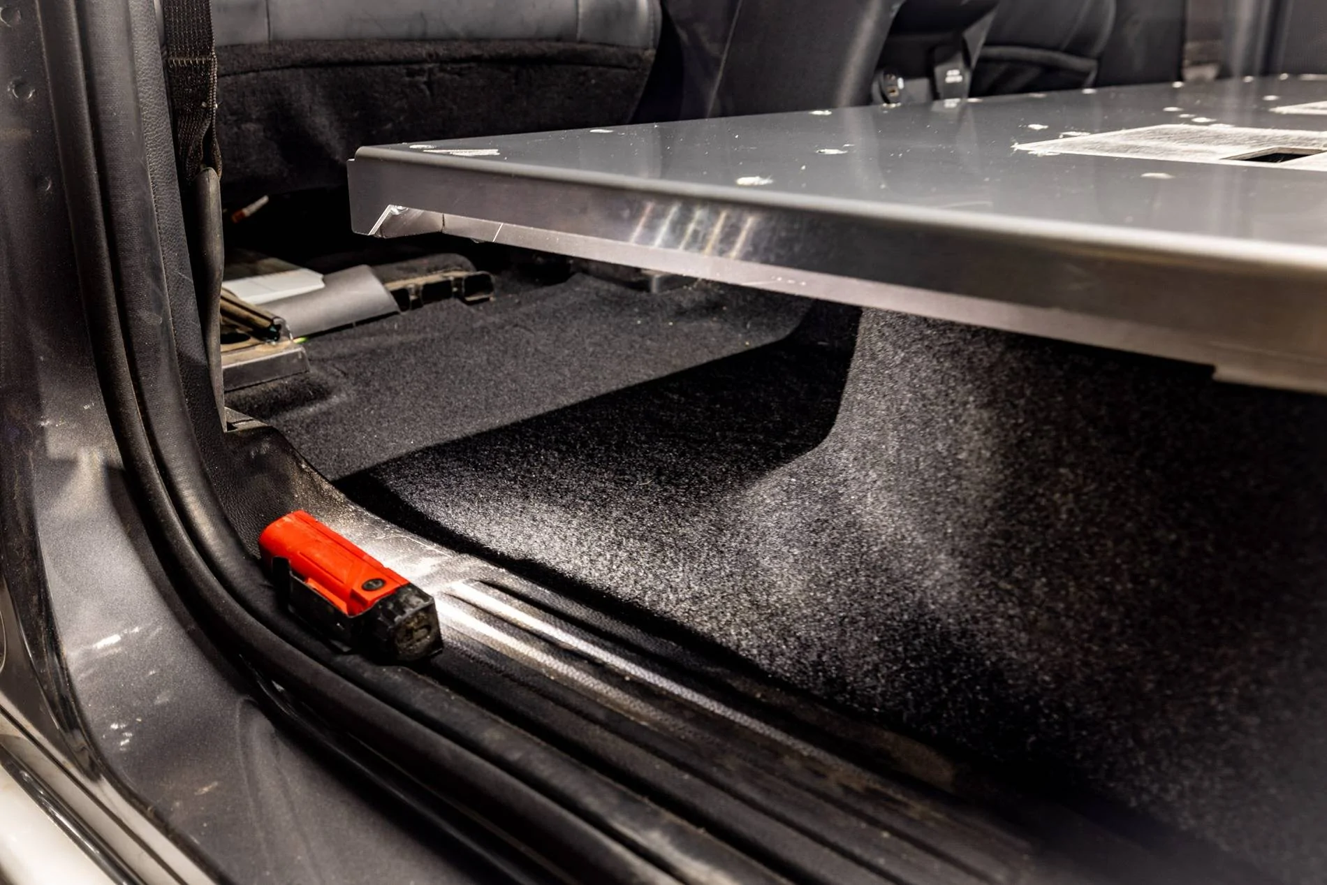

Well, here we go! Today went so well with this part of the process that even when I dropped a bolt, it feel right into the hole! True story. ?

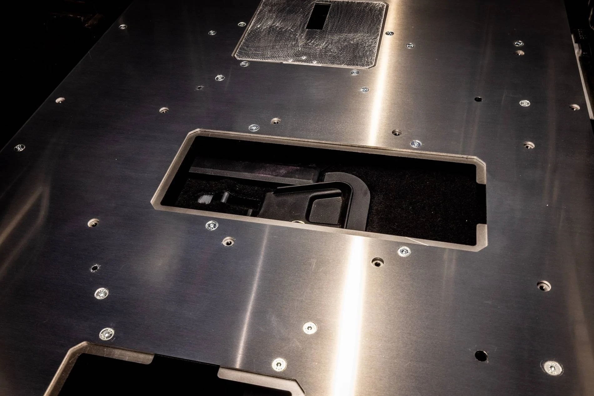

I'm going to eliminate the middle access door. It isn't really usable like I had hoped. The carpet and plastic cubbies take up most of the space below there.
Here's the big news of the day. I think we're going to ship these fully assembled. We figured out a few small design changes that allow us to install and remove this in one assembled piece. That means, installing will take only minutes. The same for removal. It will reuse the stock hardware that holds down the seats plus an additional few M6 bolts. It will ship with a few nut plates that will stay installed in the truck, negating the need for a wrench to hold nuts. We have put a lot of time into the quick-change (from platform to seats) process and are super happy with how this has worked out.
When we ship fully assembled, it makes the packaging a little easier and drastically improves the user experience. Worth the tradeoff for the assembly labor! We want this to be the most premium seat delete platform on the market, regardless of vehicle.
