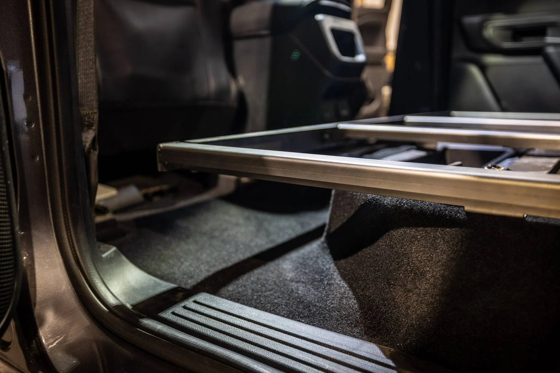

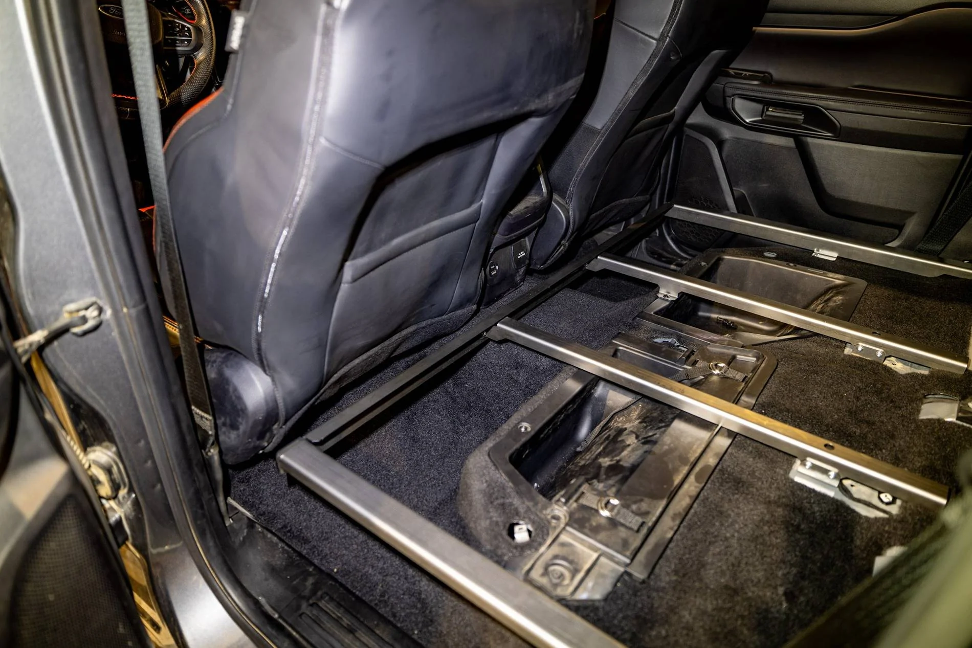

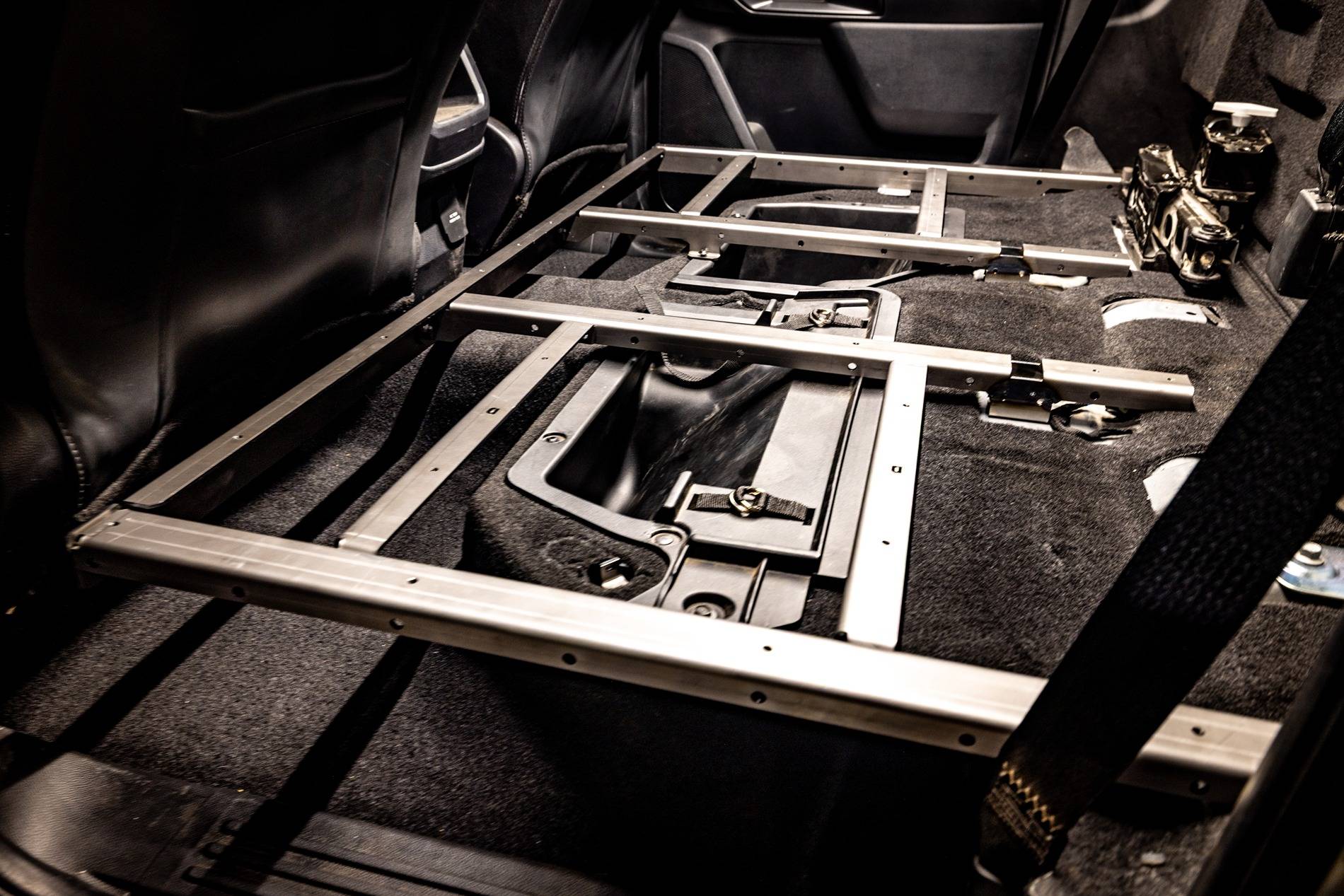

Well, today went REALLY well. I usually don't put too much detail in my fist iteration parts with the expectation of replacing them quickly. However, these all fit perfect the first time! Now, I wish I had put the threaded holes in them to mount the plates and attachment holes. ? Either way, I'll get this finished up tomorrow.
I couldn't be happier with the design. I don't usually have such a firm structure to work off of below the seats. The small cubbies that Ford builds into the body have substantial sheet metal surrounding those. I was able to leverage that existing part of the truck to make the rails super strong, light weight (relatively) and we won't require a forward support reaching down to the floor. I can literally sit on these rails, one at a time. That's substantially stronger than I expected from this design. Very pleased!!! It is also going to install and remove quickly. I have three parts that will get installed into the floor that will stay in after the platform is removed. Those will drastically speed up the install/remove time for subsequent installs.
Tomorrow, I'll add the top plate, attachment points, and start the back wall cover. Moving quickly now!

You are a BEAST! Great work!

Now I get it. ?
I've just seen so much unsupported folded tin with 50,000 pieces of hardware holding it all together, at this point, that I'm immediately suspicious, these days.

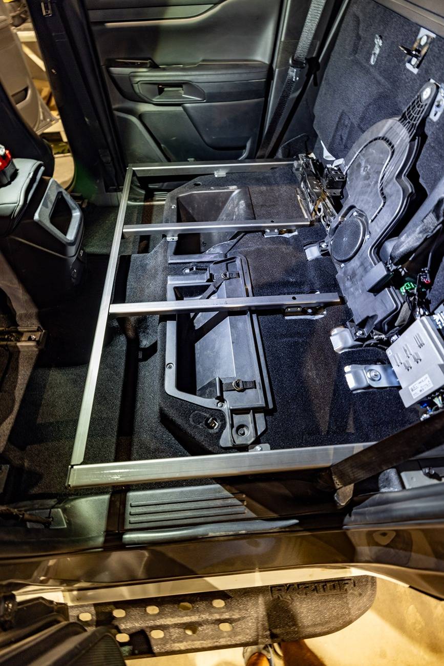

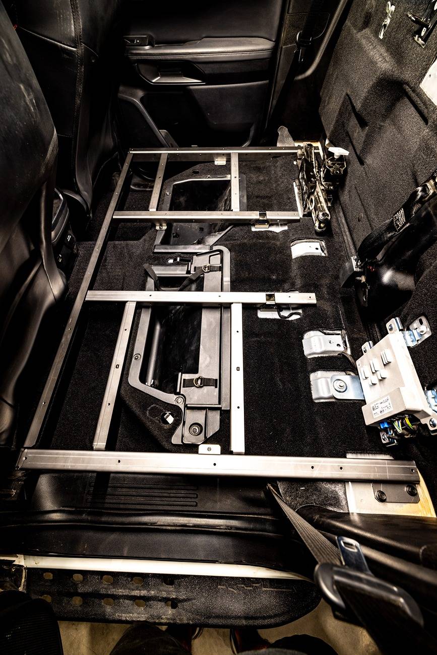

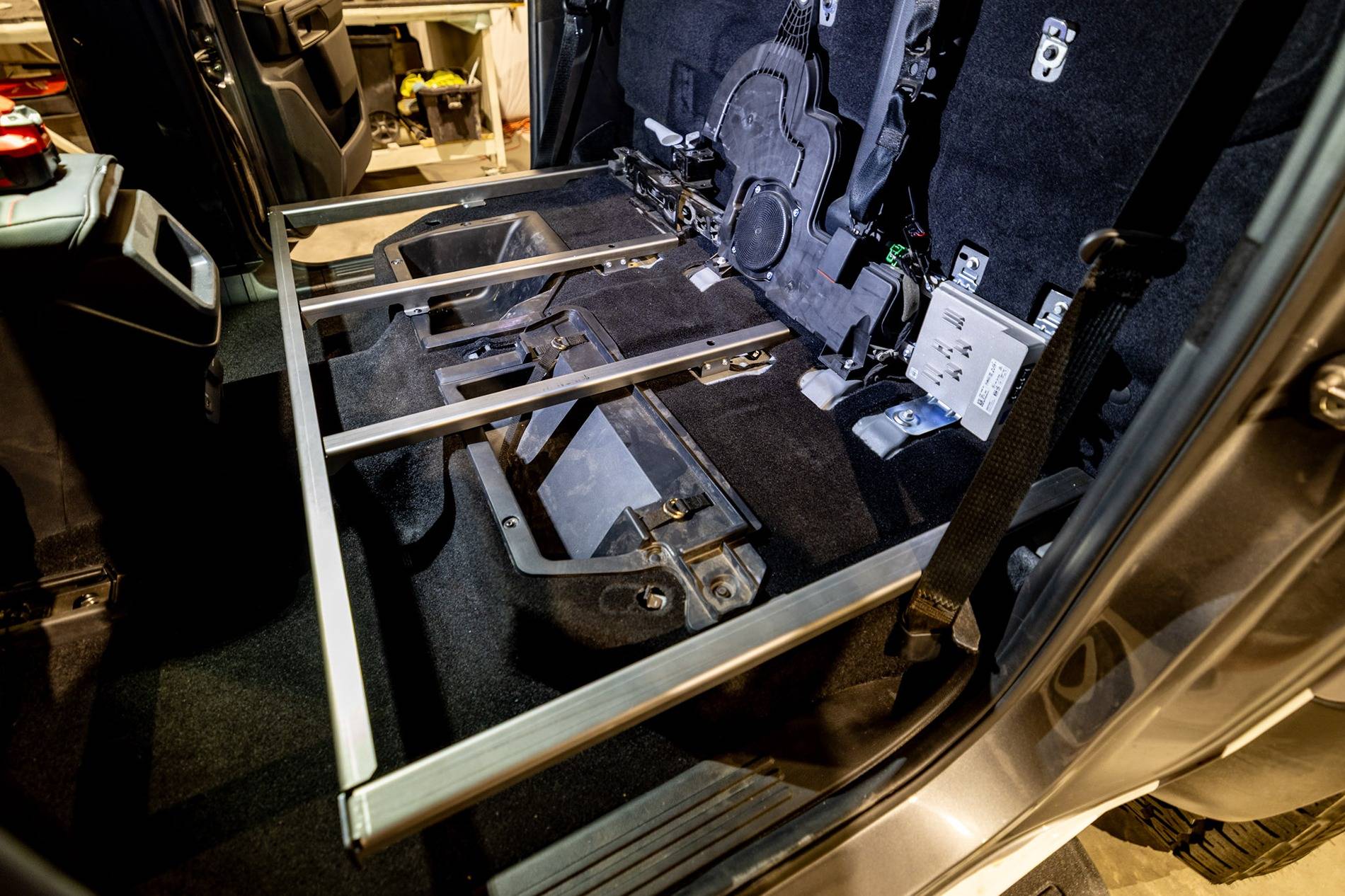

The new rails went in flawlessly! Very happy with how this one is working out. Sometimes products just seem to design themselve in synchrony with the vehicle. The OEM holes and bungs just seemed to be in the perfect spot. The length of the canilever was the perfect ratio to the secured portion of the rails. The access panels worked out perfectly to allow the accessory attachment pattern to be unbroken.
Tomorrow morning, the one-piece aluminum deck and attach the access doors.
If you'll notice, there are tons of pre-cut holes in the rails. This is for future expansion. One thing we will definitely be adding is a subfloor panel that will live below the middle access door. This will be a great spot for overlandy electrical things (DC to DC chargers, fuse boxes, relays, etc.
We wil also be building some battery brackets to hang some lithium batteries from the overhang. That will keep them climate controlled and out of harms way.
