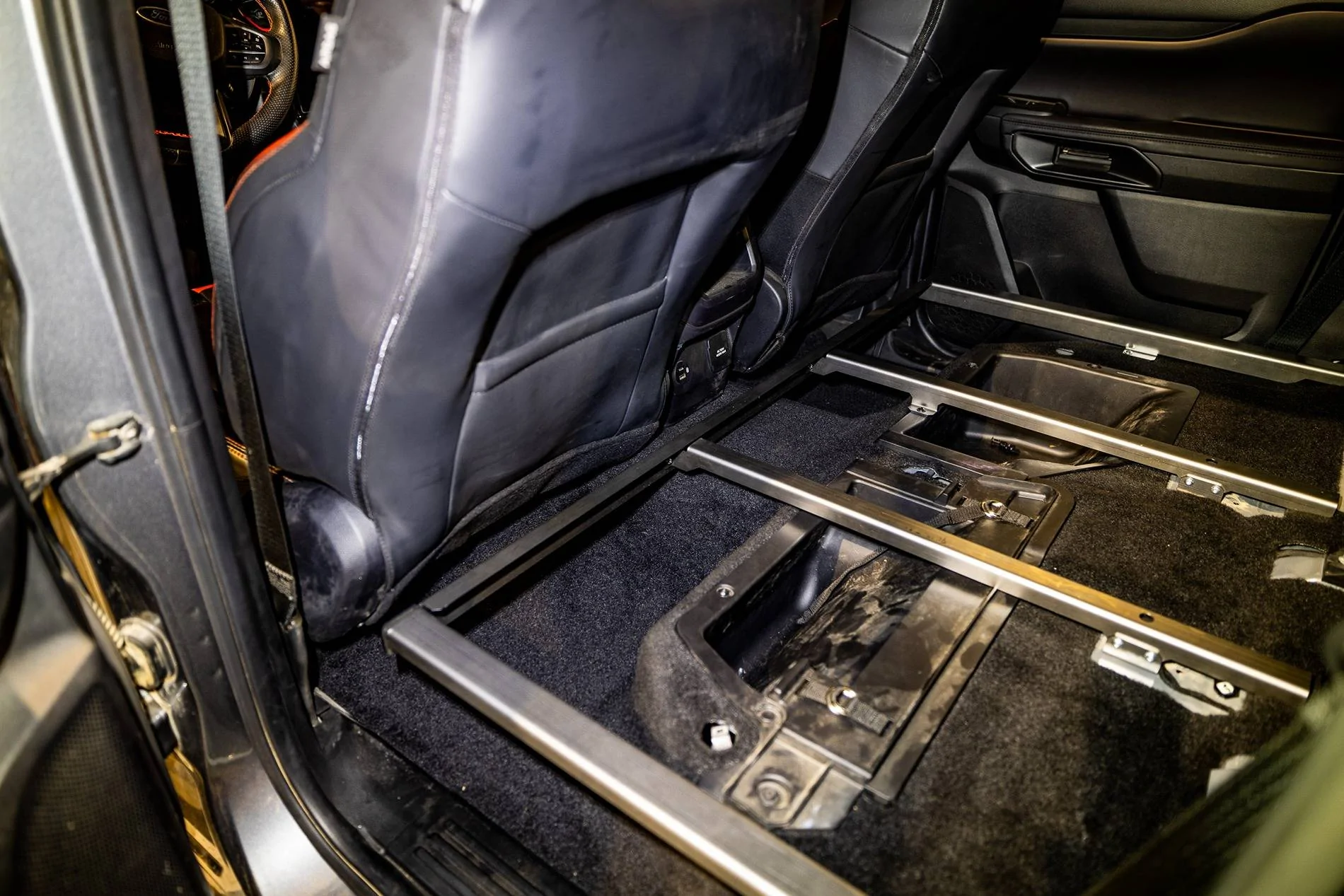

I'm definitely interested. Looking at the photos, I think you've designed for this already, but my one request would be to not have the platform come so far forward that it would interfere with the front seat recline. Those of us who are tall and keep the seat all the way back and with some recline need that space.

thanks! I'm 6'3", so I'm inherently familiar with what you're talking about. In the photos where the seat is close, it is all the way back. I kept the platform as low as possible to stay below the pivot height of the seats.

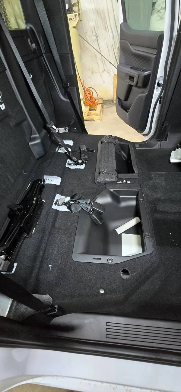

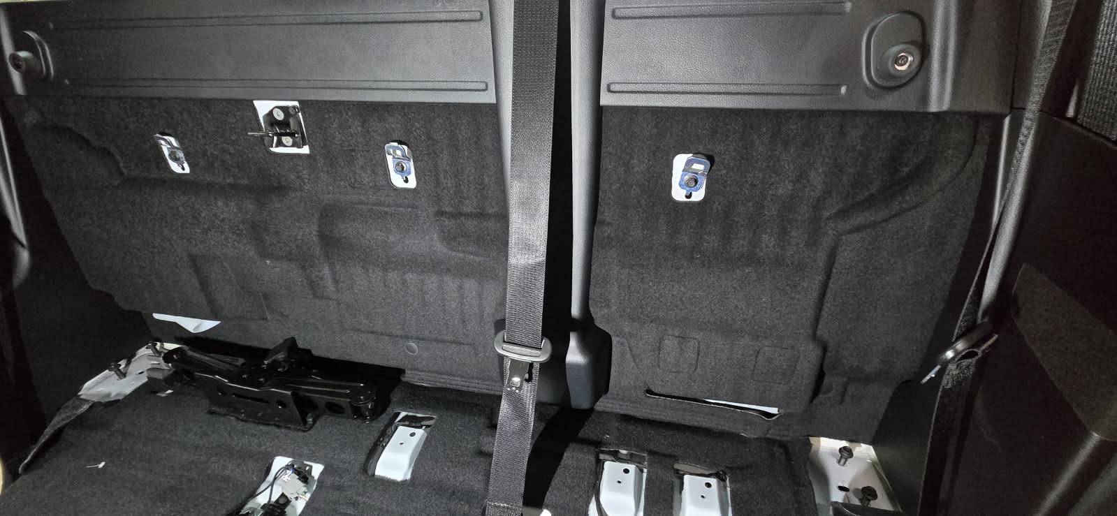

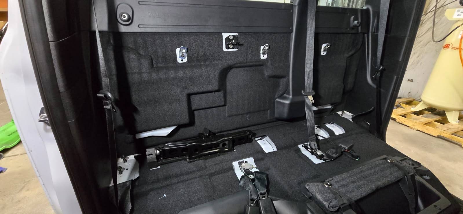

As far as I can tell right now, they are the same. Here are some of the photos one of our commercial clients sent in. I will be delivering and installing a couple of these later this week (or next) and I wanted to make sure the vehicles were the same before I made the drive to Colorado. I can't see any differences.

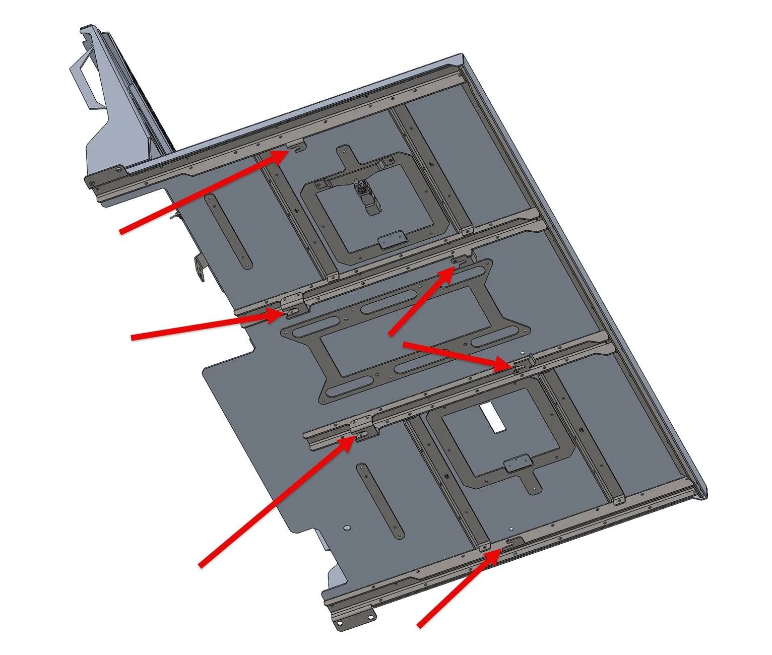

Another big update. I'm trying really hard with the design of this system to make it super easy to install and uninstall. The uninstall process will be as follows:
  1. Remove the back wall (if installed)
    1. Remove (7) M6 bolts (4mm allen wrench)
    2. Remove the back wall as one piece
    3. Remove the three upper mounting brackets (OEM bolts using 10mm socket)
    4. If you want to reinstall the child seat safety hooks, now's the time to put those back in. If no child seats will be installed, you won't need to put the hooks back in.
  2. Remove the four OEM bolts that previously secured the rear seat (13mm socket)
  3. Loosen the remaining attachment bolts - (2) T50 bolts that previously held the seat belts, (4) M4 button head bolts (M4 allen wrench).
  4. All of the bolts in the previous step are accessible from the top side of the platform. So, you'll just loosen them (no need to remove). Then, slide the entire platform forward about 20mm and lift up. Then, the entire platform can be removed as a single assembly. It will be easy to store since it is only 40mm thick. Lastly, remove the hardware that secured the platform. You will reuse the two T50 torx bolts to secure the seat belts if you're going back in with the seats.
To reinstall the seat, you'll just need to put the seat back in, secure it with the (4) bolts at the outside corners and reconnect/attach the seat belts. Having the cubby "box" below the seats really made this design work! This will be our all-around best seat delete yet.
I hear you guys loud and clear that you want the ability to easily swap back and forth. We're making that happen! I expect this process to take about 10-15 minutes to swap from seat delete to seats installed. It will take slightly longer for the initial install as there are some nut plates that get installed on the initial install. They stay in after the platform is removed to make subsequent installs faster and easier.
Notice the slots in the "feet" of the attached rendering. That's how it can be installed/removed without fully removing the hardware.
