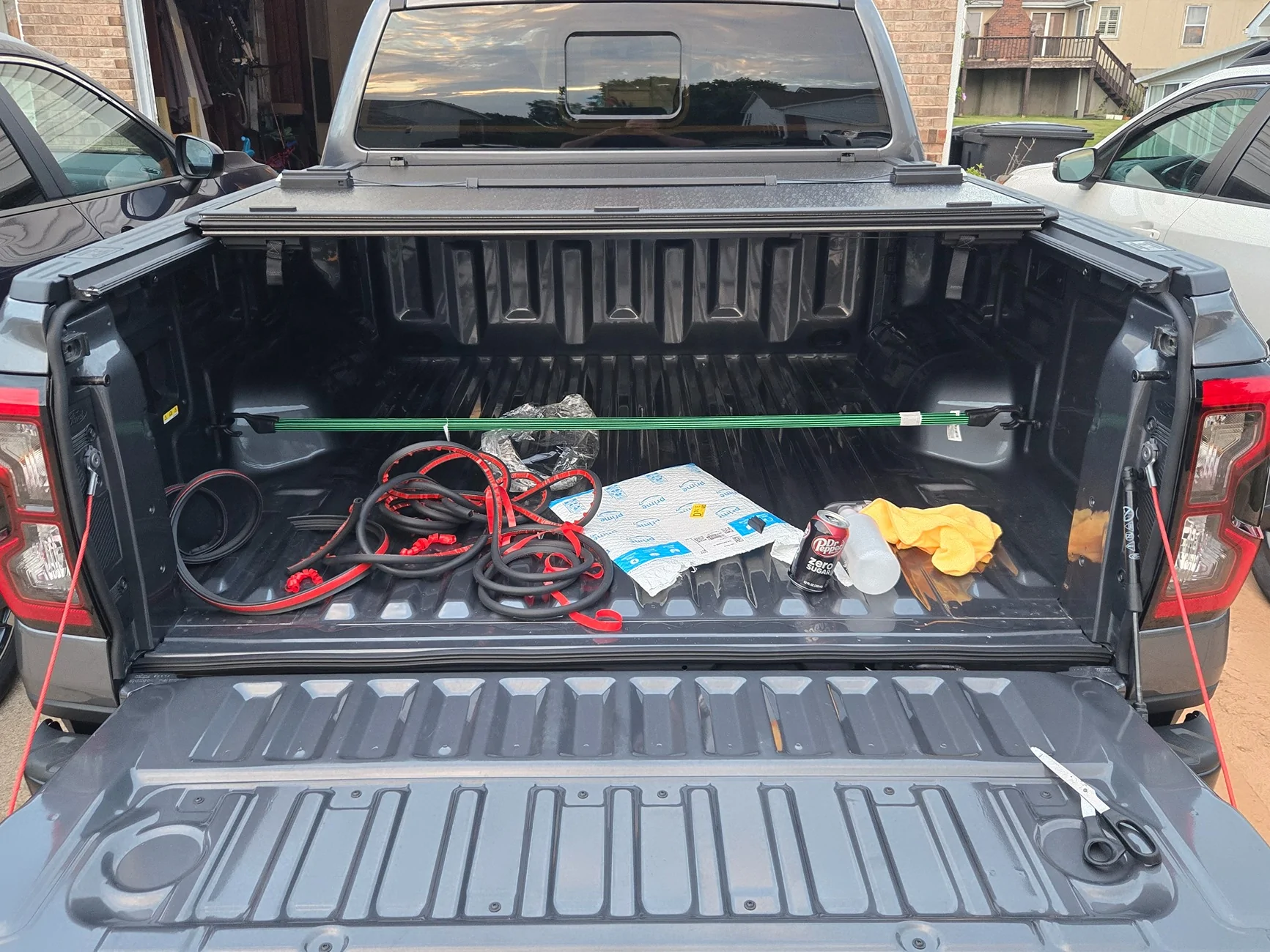

I Removed the rails caps. You can access alot of the clips from below, inside the bed. Some you can't but I had no problem getting those out. If I went slower I wouldn't have broke any clips, but if you break any dont worry. They break very flush and the loctite plastic bonding seals them back very well. Just wait at least 1hr after applying before putting the caps back on the rails.

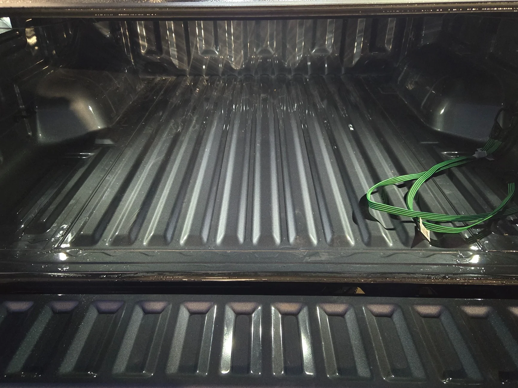

I ordered a tailgate seal kit from truxedo and instantly realized it wasn't going to work. The tailgate edge meet design is just as confusing as the swiss cheese rails with built-in water ingress points in the rail covers above.
I originally used the .5x.5in D shaped weather stripping to run the outer edge of each tail light side section, running a bit under the rails for tonneau. This worked well for for a watertighting but the strip rubber started deteriorating from rubbing within a week. Ordered and installed the KEKO tailgate seal for the 24+ Ranger. The kit comes with brackets that allow for a strait bed seal, works well, no water ingress as well.

I let the truck sit and everything dry/seal, then went and took it to my local car wash. Ran through twice. Almost zero water entry. A few DROPS probably blown in by the high pressure dryers, or when i popped the tonneau and tailgate.
Overall very happy with the outcome. Time will tell with heavy storms, but hopefully this ends any water concern for me as I will be traveling 30,000 miles a year all over the Midwest with parts and tools in my bed, family camping trips, etc

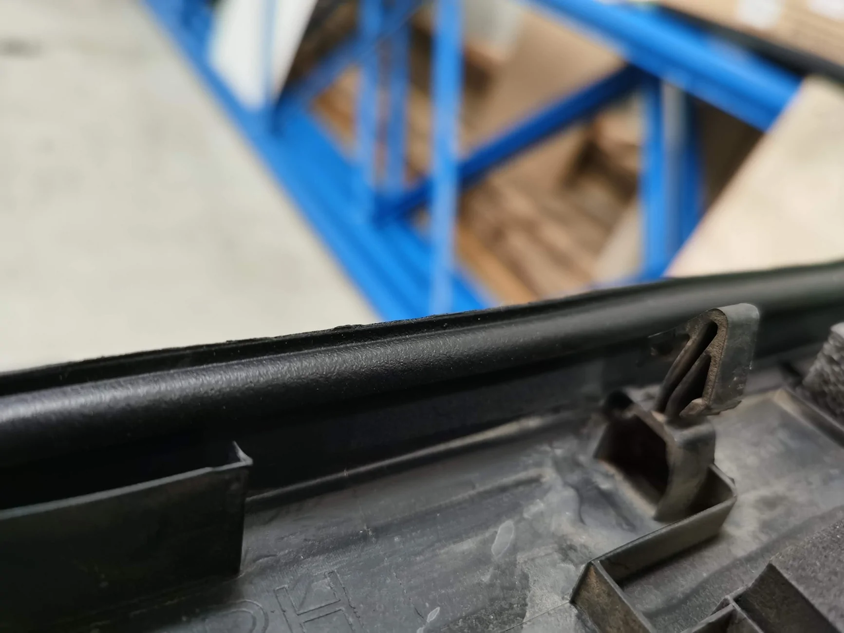

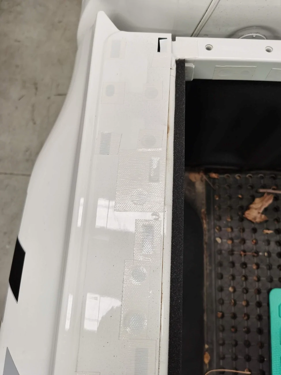

I covered the Swiss cheese bed caps using gaffer tape (100mph tape - whatever you want to call it).
Ford Ranger Watertight bed DIY how-to. Rails/Tailgate/Tonneau IMG_20240602_140738_small
Then I added a foam rubber seal around the bottom edge of the plastic cap to reduce dust getting in as much as possible - I do use the post holes for various things so no option to seal those caps.

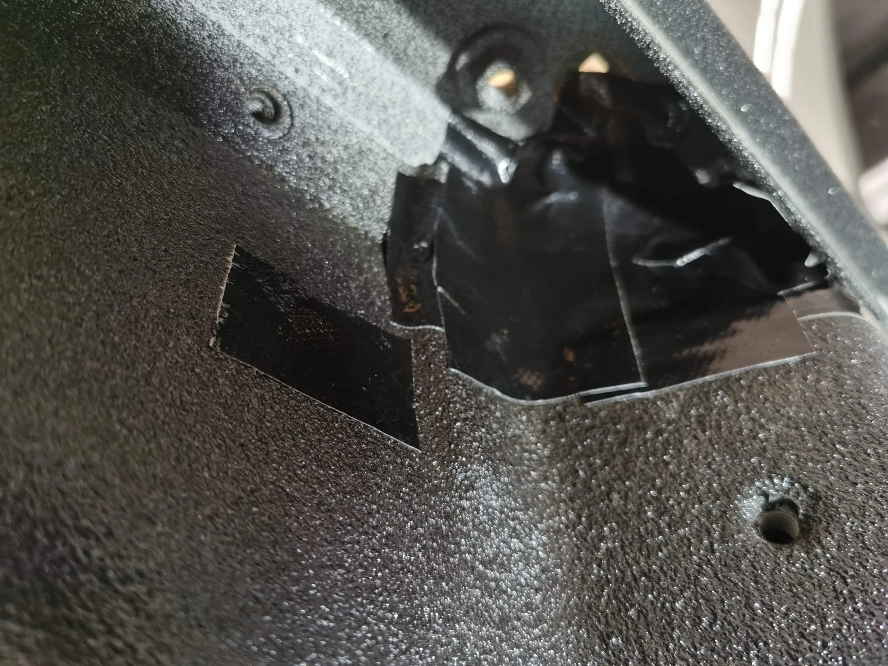

There are also a heap of holes and openings in the sides of the bed so I sealed them with black gaffer tape.
Ford Ranger Watertight bed DIY how-to. Rails/Tailgate/Tonneau IMG_20240602_140619

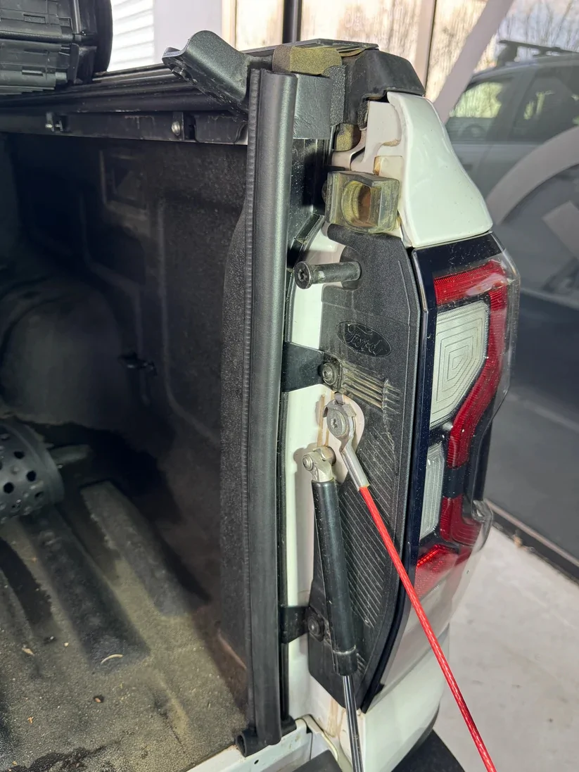

But the most important thing I did was develop a kit to seal the tailgate:
Ford Ranger Watertight bed DIY how-to. Rails/Tailgate/Tonneau 20250422_061013603

Update: the .5x.5 weathstripping worked for watertighting but started to deteriorate after only a few days from the constant rubbing when opening and closing the tailgate. Walk through updated with the KEKO 24+ Ranger Tailgate seal kit. Comes with brackets for a straight bed seal on the Ranger for $50. Passed the 2x car wash test for no water as well.

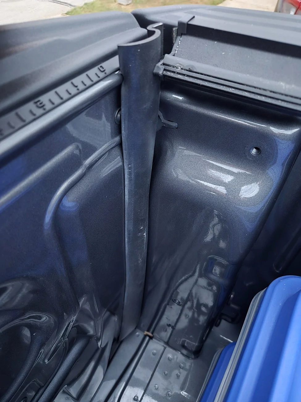

I tried this just as an experiment, and it worked so well I left it on there. I used a piece of 3/4 water pipe insulation and just double sided taped it in place. It is very flexible, allowing you to form it to the curves/gaps in the tailgate. Works great, all for less then 10 bucks.
