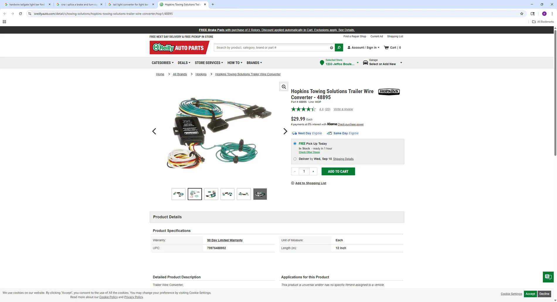

This is the path of least resistance until reasonably priced adaptor kits are availible-see Putcos $400 lightbar and harness. The Lightbar and trailer harness cost me less than $100.
Current tailgate lightbars will not come standard with proper connections for full functionality with our rangers. Hooking up to the trailer light connection throws trailer errors and disables crosstaffic/blis.
But hooking directly to tail light connections leaves you without brake light or a turn signal. However, all we need for full functionality is a simple LED compatible trailer light converter harness. ($20-$30)
This can be used to easily connect and carries the turns and brake light signals in 1 wire without feedback into the system. Most of them also have inputs/outputs for running/park lights and a ground as they will use the standard 4 pin trailer connector for output. With reverse connection made from the llightbars reverse wire if applicable.

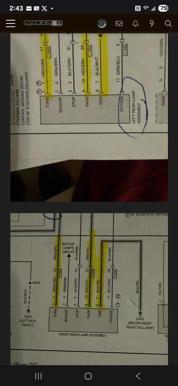

#1 Run your connections (most made on driver side, 1 to passenger side turn signal)
-Connect the trailer light converter harness wires to left and right turn signals, brake, running/park, and ground. Connect lightbar reverse wire, if applicable.

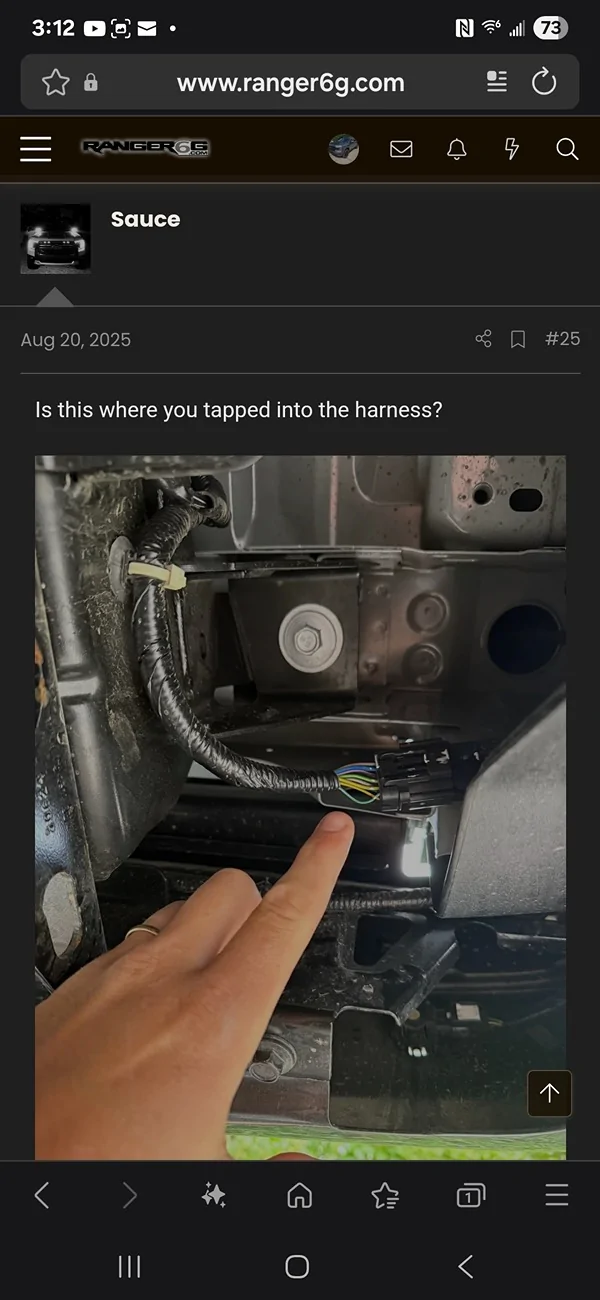

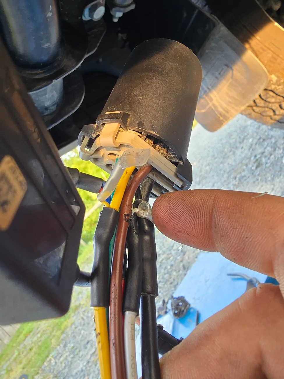

-Look underneath the truck, directly below the tailights are cable connections for the taillights, tap off the colored side.
-I soldered and heatshrinked, but you can use taps if you dont have that skill or patience. Just make sure your connections are solid and electrical tape them well after completing the steps.

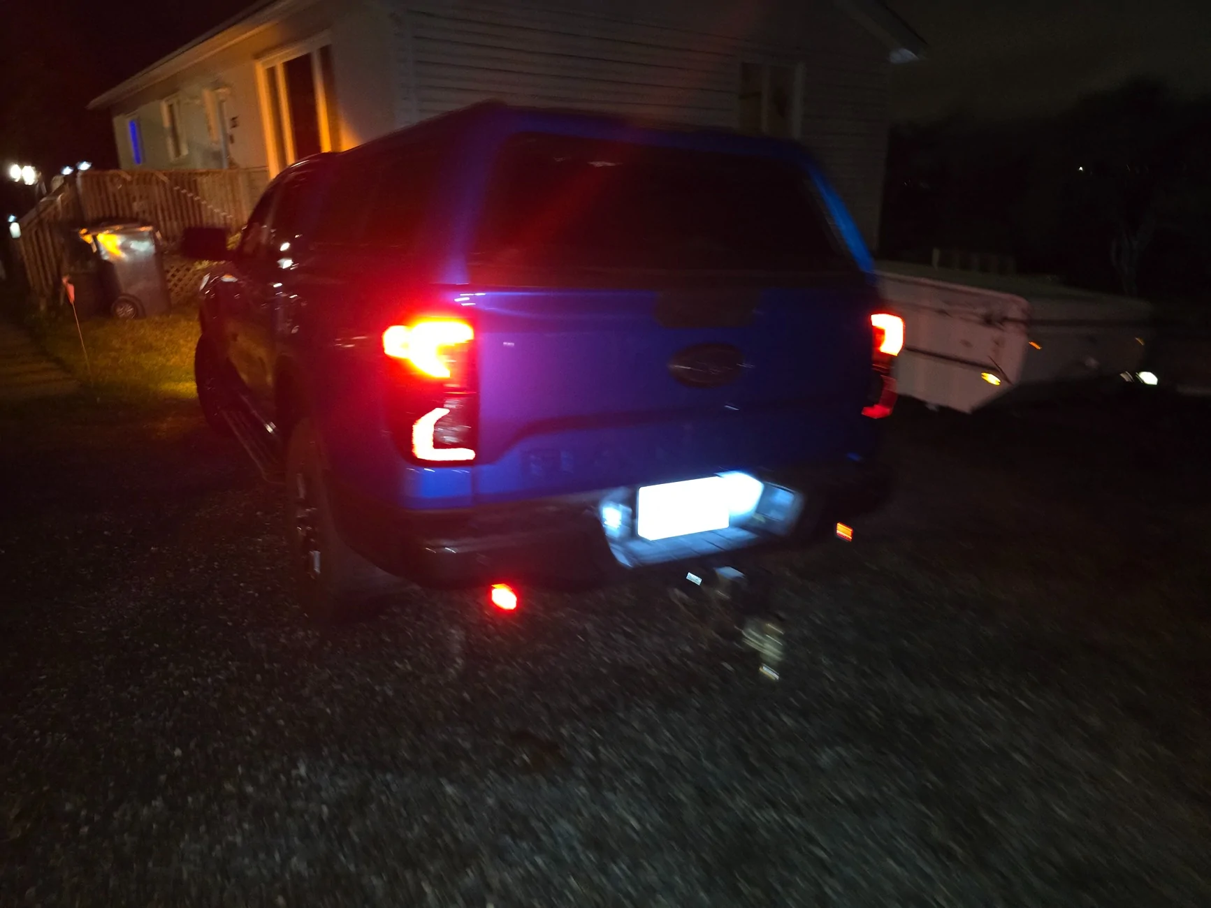

Thank you. Ive been rear ended 6x in my short 35 years, 4 when ive been sitting still at a stop light, the most recent being 3 days before buying my Ranger 3 weeks ago. I wanted more reds lights to indicate to people that im stopping or am stopped lol

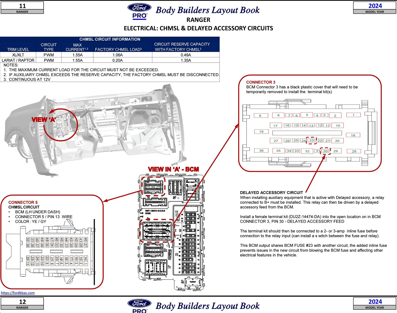

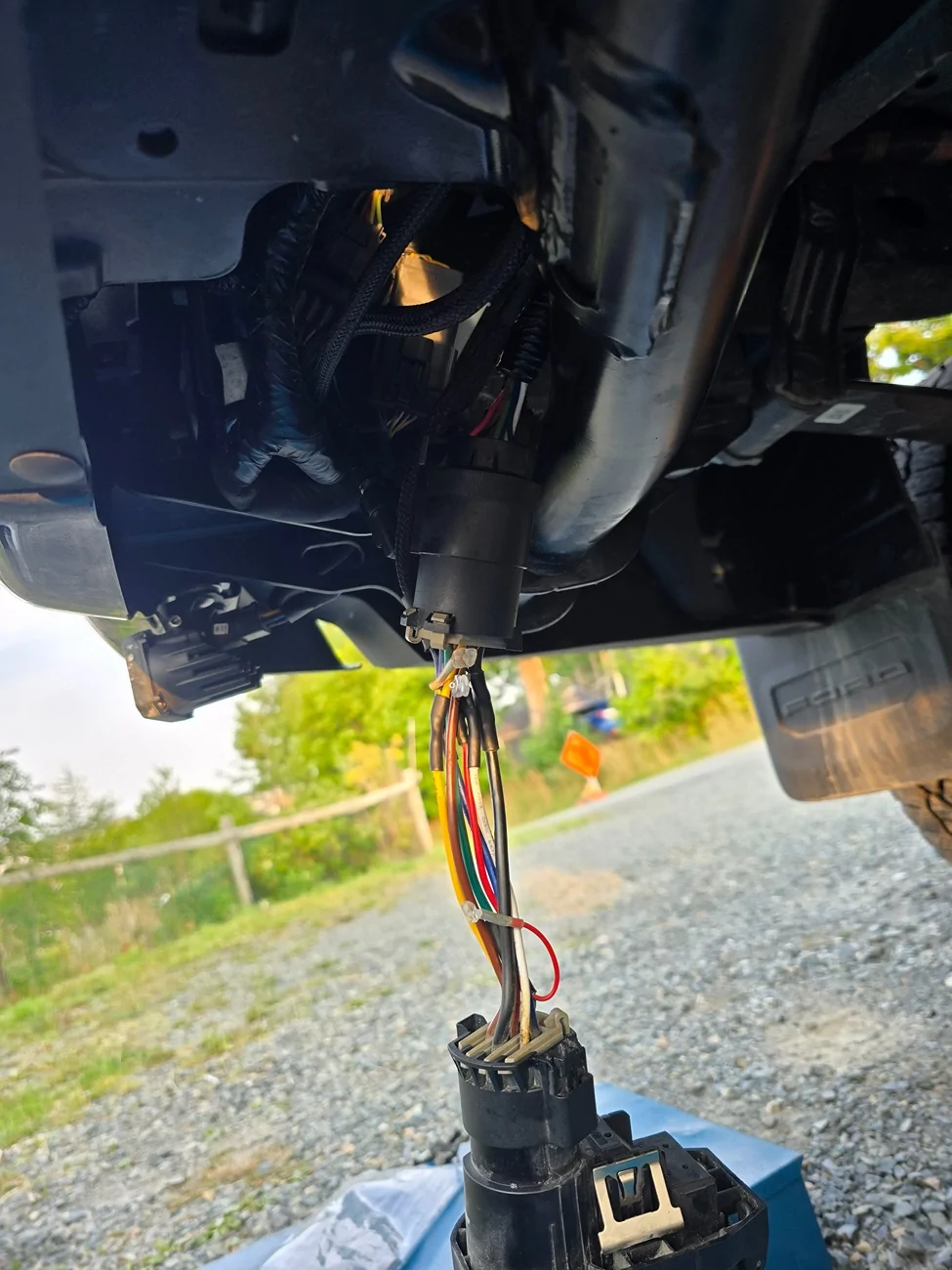

Nice, I used my Diode Dynamics C1R's I had on my old rig. I did use their 7pin adapter harness. and was getting the trailer light error with their harness. the solution for me, as they were just extra brake/marker/ reverse was to remove the brake function from the trailer plug altogether, and as per the ford body builder layout(upfitter guide) I ran a wire from the bcm back for the c1r's and my cap I was getting installed. the trailer harness still give me my ground, marker, and reverse, I just had to remove Diode Dynamics left and right trailer turn/brake wires going to their brake module box(allowed them to flash when your hazards were on) cap the wires on the pass through harness, and tie the new bcm brake wire into the input for the c1r's and the cap.
