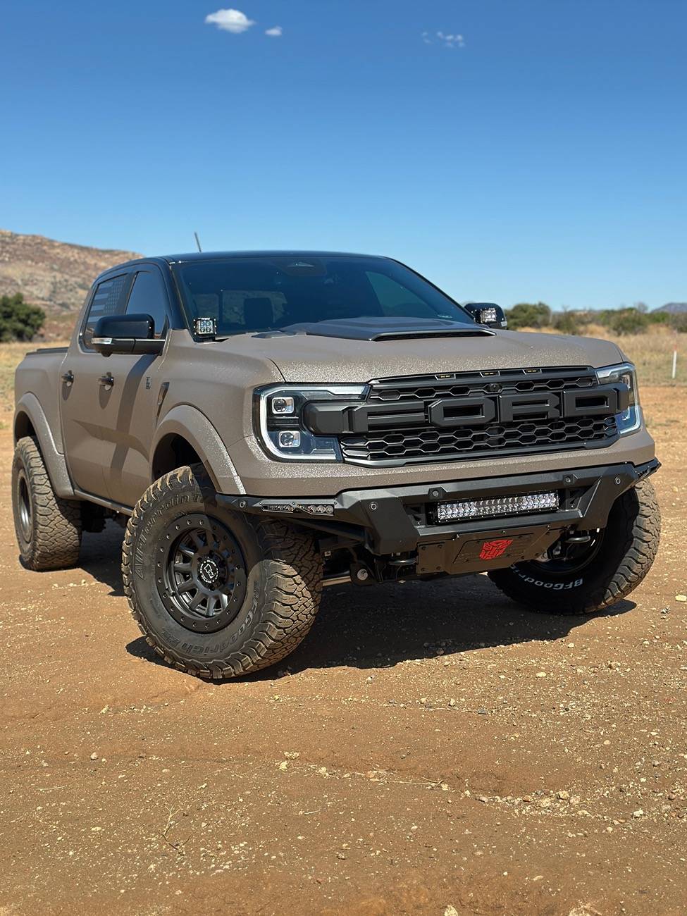

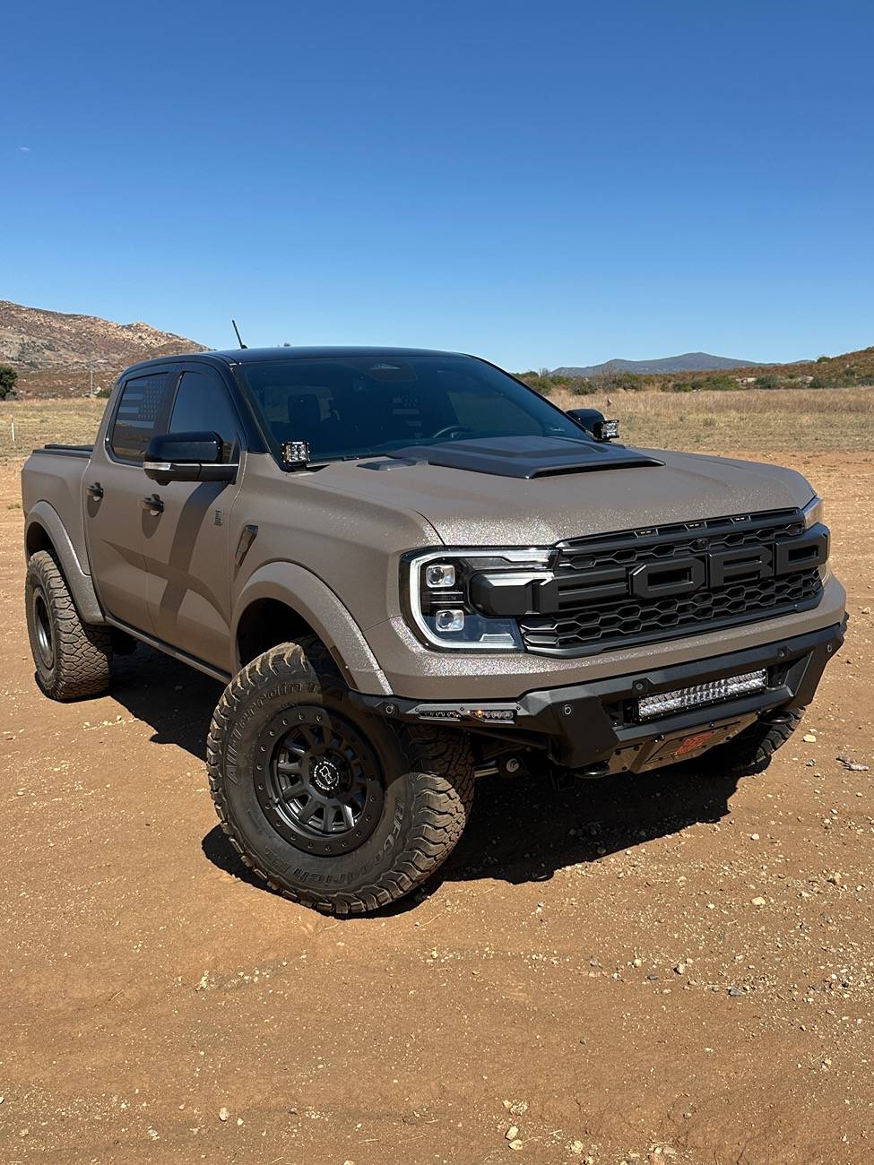

On a side note, did the 34" KO3's fit without removing crash bars or rubbing?

Crash bars were removed when I switched out the front bumper prior to the 34” KO3s, but I assume they def would need to be removed with the factory bumper and 34” KO3s (I attached a couple photos). As shown I don’t have any issues (factory raptor suspension, no spacers, no lift, just 305/285R17 KO3 on 17” black Rhinos that have 0 offset (vs the factory RR wheels that had +55). I don’t have any rubbing or grinding issues and have have full wheel turn.

Front Hood Scoop???
Deleted member 9086
Yeah… couldn’t help myself lol, I’ve been a lifelong Tacoma driver until this Ranger Raptor, and just wanted a bit more aggressive look to match how this lil monster drives:)
