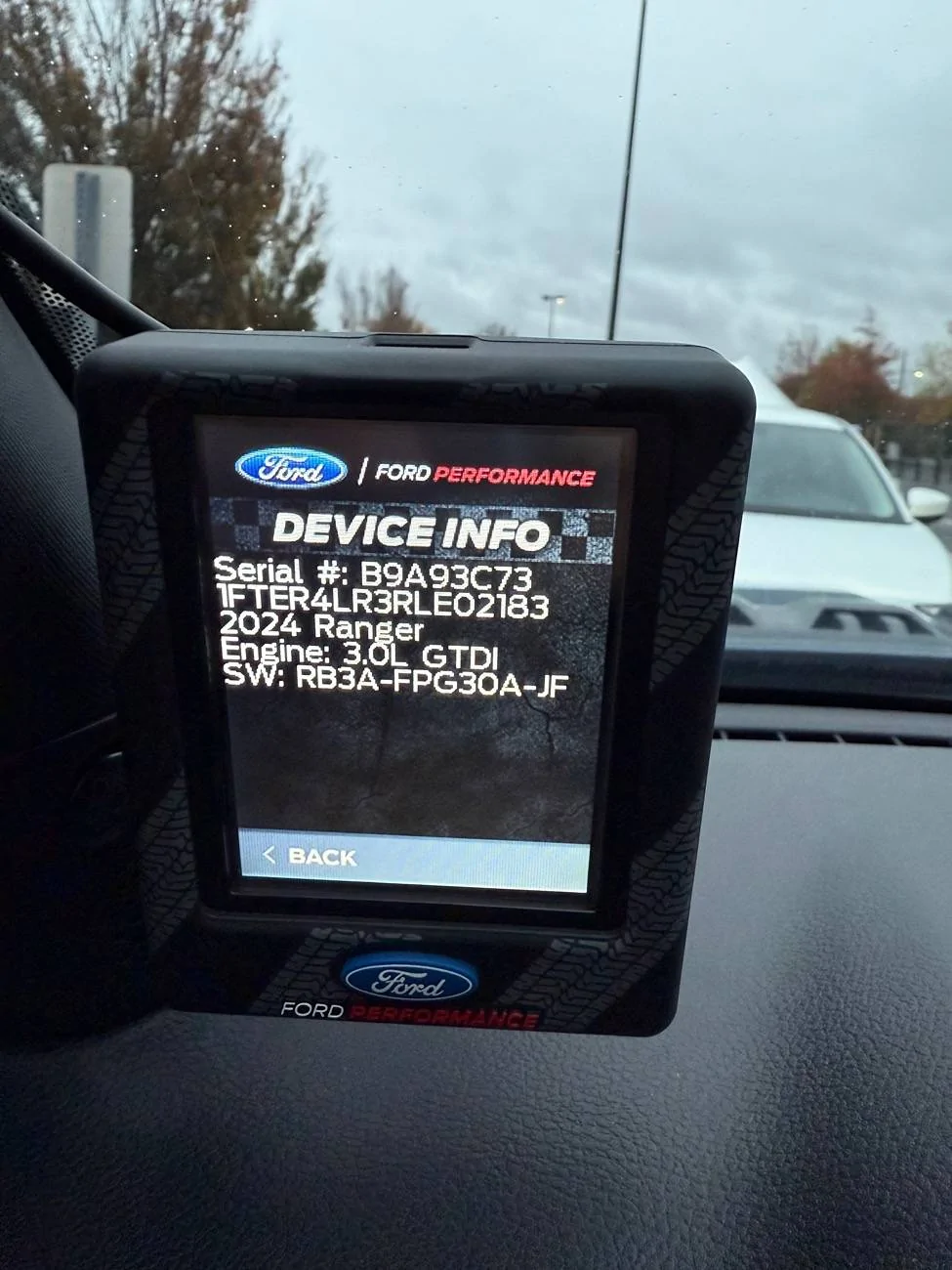

I spoke with Ford Performance and they said by looking at software version on pro call if the sw version has FP in it then it is the tuned software installed so you can confirm with that. Here is picture.
Ford Ranger Pro Cal tune IMG_0312
