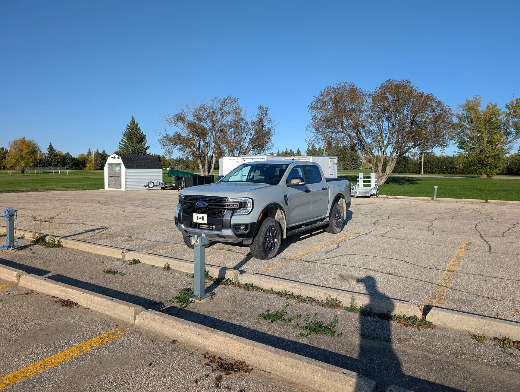

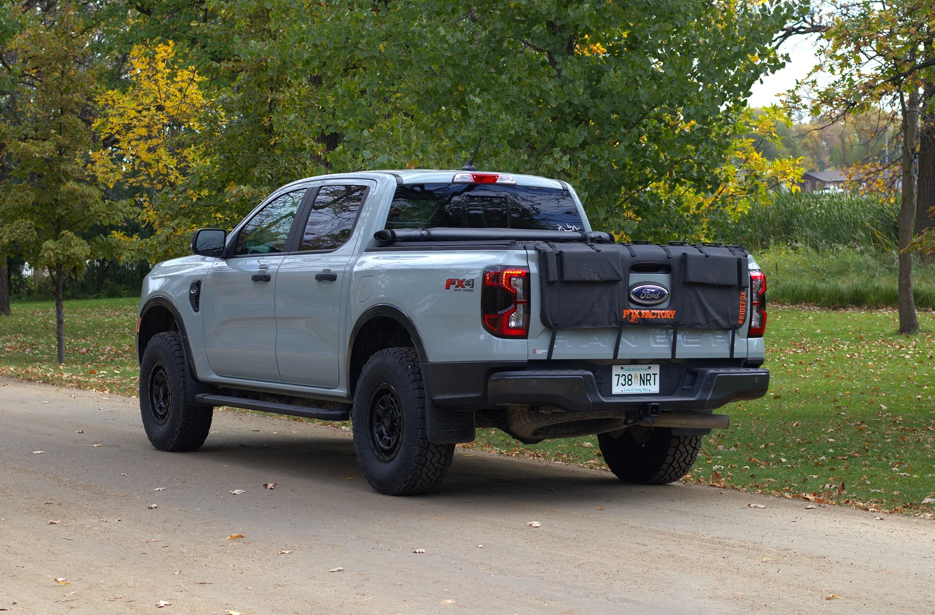

Sup guys, figured I'd post about my build now.
Got this truck in Jan 25, first new vehicle and first truck. I've been eyeing out everyones builds and talking about doing myself, so here's my "budget build"
So far just did a FordRangerLifts 2" level kit (shout out to @garyo for setting me up with a good deal for this kit because he wasn't using it). Looking at getting some new wheels and rubber within the next week or two, possibly a 16" wheel with 285/75R16, will update once installed. Anyways, it's dirty but after about 3h of work here's the look!

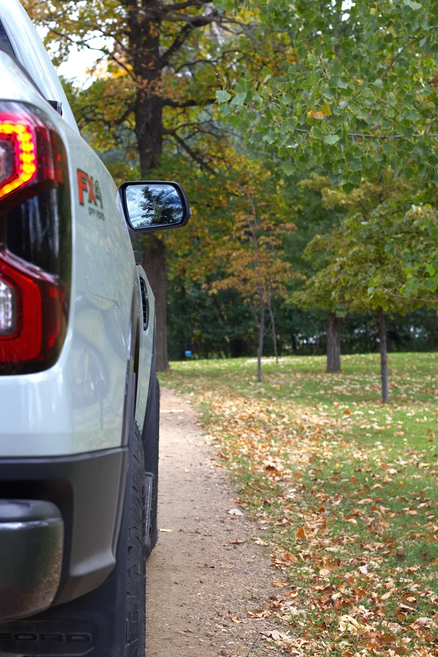

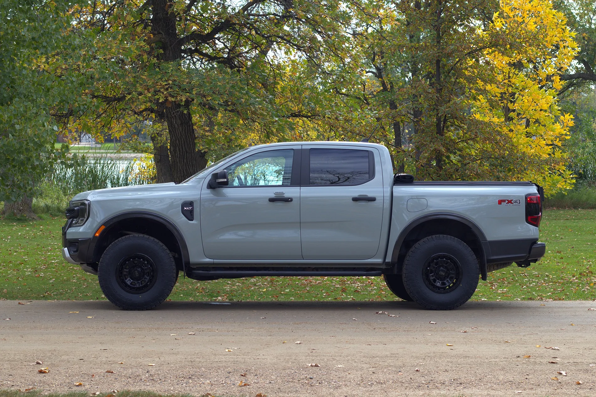

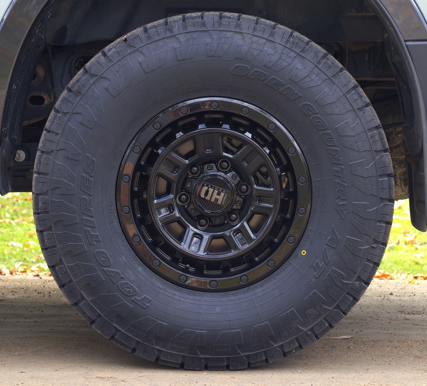

Got the wheels and tires and installed them yesterday. Just missing that final alignment and getting the new TPMS sensors synced up with the truck which i'll be doing hopefully this week.
Toyo Open Country AT3 LT285/75R16
Fast HD K-O 16x8 +40 Offset
Ford Ranger 24 XLT FX4 Cactus Grey budget build Frontside2
Ford Ranger 24 XLT FX4 Cactus Grey budget build Backsid
Ford Ranger 24 XLT FX4 Cactus Grey budget build Sid
Ford Ranger 24 XLT FX4 Cactus Grey budget build Pok
Ford Ranger 24 XLT FX4 Cactus Grey budget build Wheeltir
Minor rubbing on driver side felt liner while reversing with wheels cocked to the right about 75% to Full Lock. (Wheel well liner has a small bump shape on the driver side, hence the rubbing only on one side)
