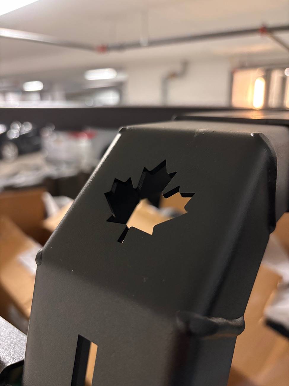

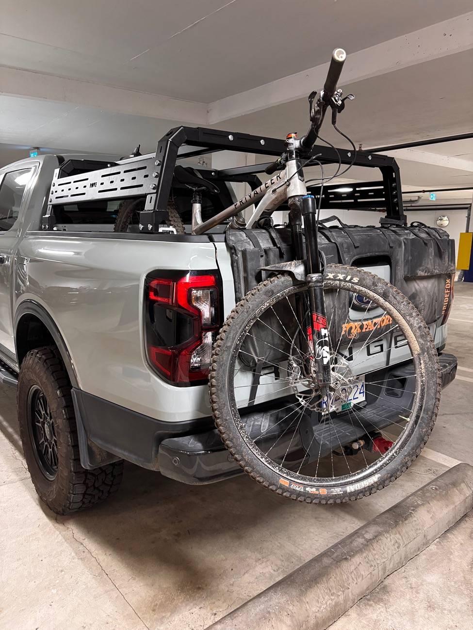

Finally got my bedrack and got it installed. Overall pretty happy with it. Made in Canada, shipped from Toronto, has room to fit my bike and it’s tonneau compatible! I like the little Canada maple leafs, and overall I think it’s aesthetically a solid looking rack!
However I think has a few downfalls that I’ll have to figure out.
First thing, the c clamps they sent were too small for the new Ranger. I assume it was built for a 5th gen as the clamps were too short. I ended up going and buying bigger ones that worked out well. (85$ later) however I’m not confident they will work with a roll up tonneau as advertised, I guess you could drill into the rails from the top down and that would solve a lot… but there’s no going back from that!
I also kinda wish it had black hardware as the silver sticks out like a sore thumb, but I can plasti dip them easily.

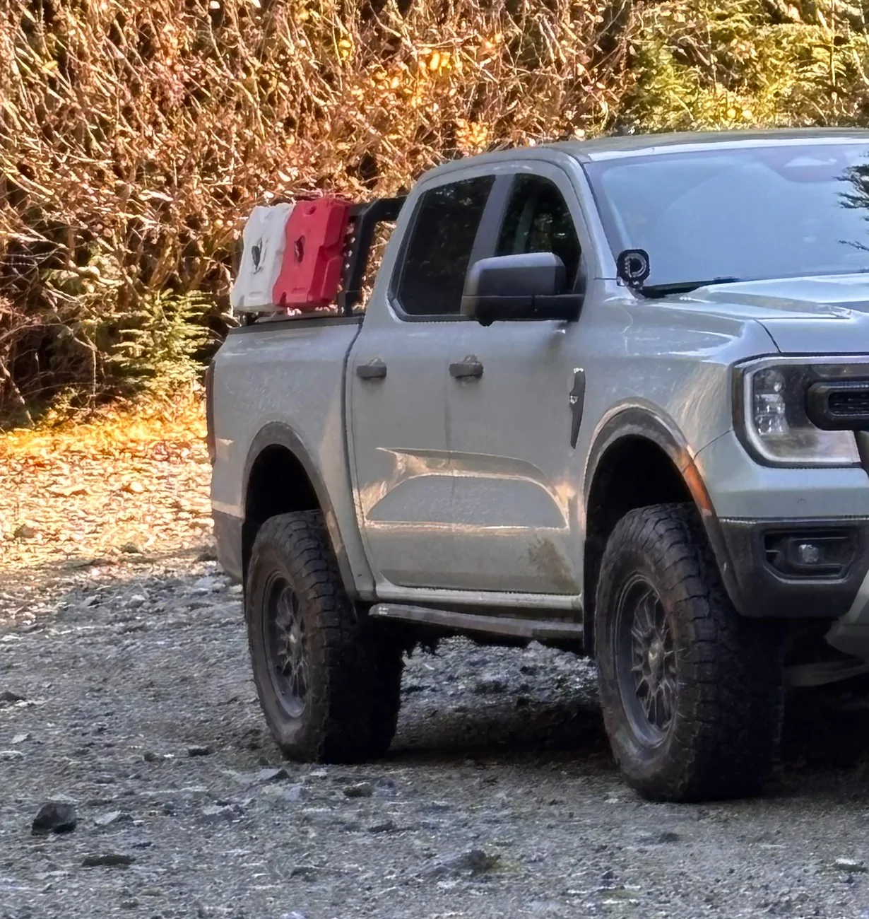

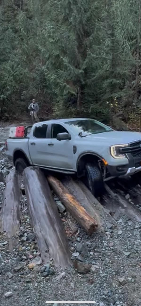

Took the new rack out for a spin to make sure everything was mounted right. Made some… interesting noises which I hope is just cause it’s new… and the flexy bed with a solid rack on top probably doesn’t help. Sure would suck if I did need those braces after all. Lol
All in all Solid day in the mountains for Canada Day.

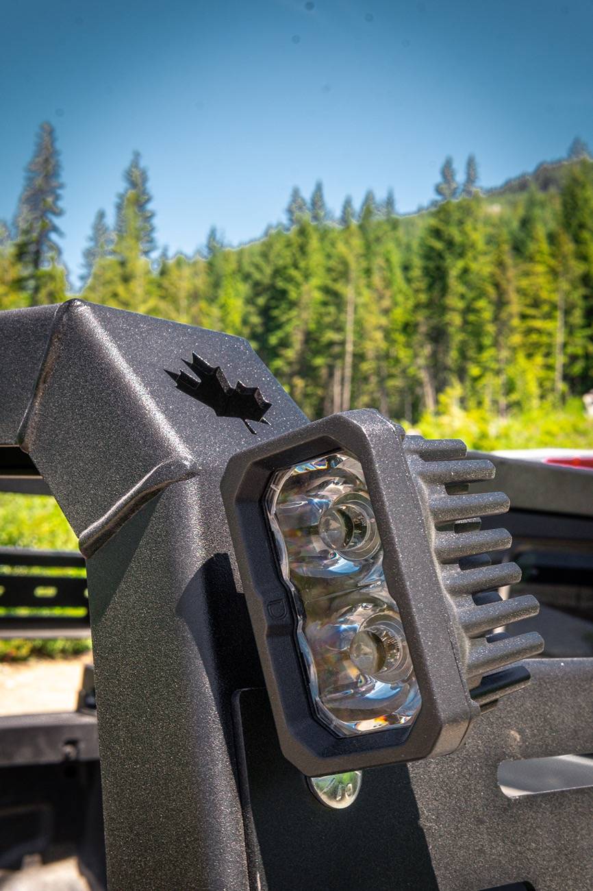

Wired up some reverse/scene/chase lights. Fairly easy install but hiding the wires and fishing them through stuff under the truck was a bit of a B, but we got er. Diode dynamics SSC2 Pro floods with the amber backlight. I also got the yellow lens covers for dusty days.
Heading down to Oregon for a week if anyone has any spot recommendations!

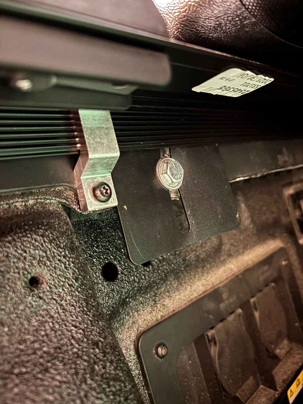

The tonneau cover is a truxedo low profile soft roll up. I’ve attached some pics to show how I did it. I did have to drill into my rails to mount the bedrack with the tonneau.
The tonneau itself attached to pre existing holes. However my one rack bracket covers one of them so I had to drill a new one!
Due to the brackets it wasn’t 100% waterproof, (I know nothing is) but it was just draining into the bed so I ran a bead of silicone down where the tonneau rails meet the bed caps.
