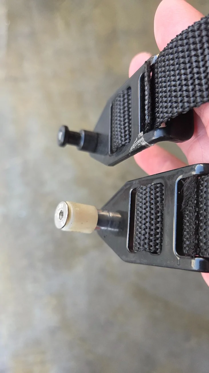

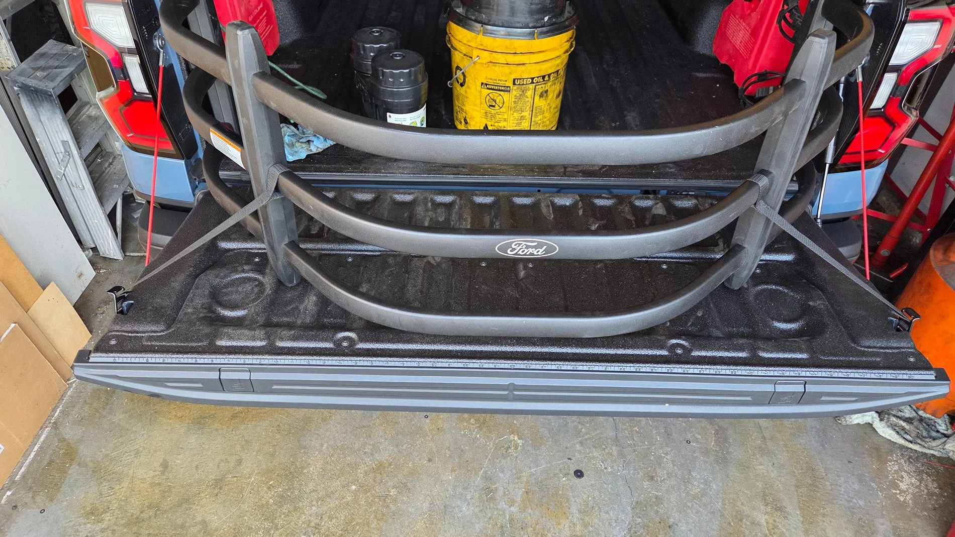

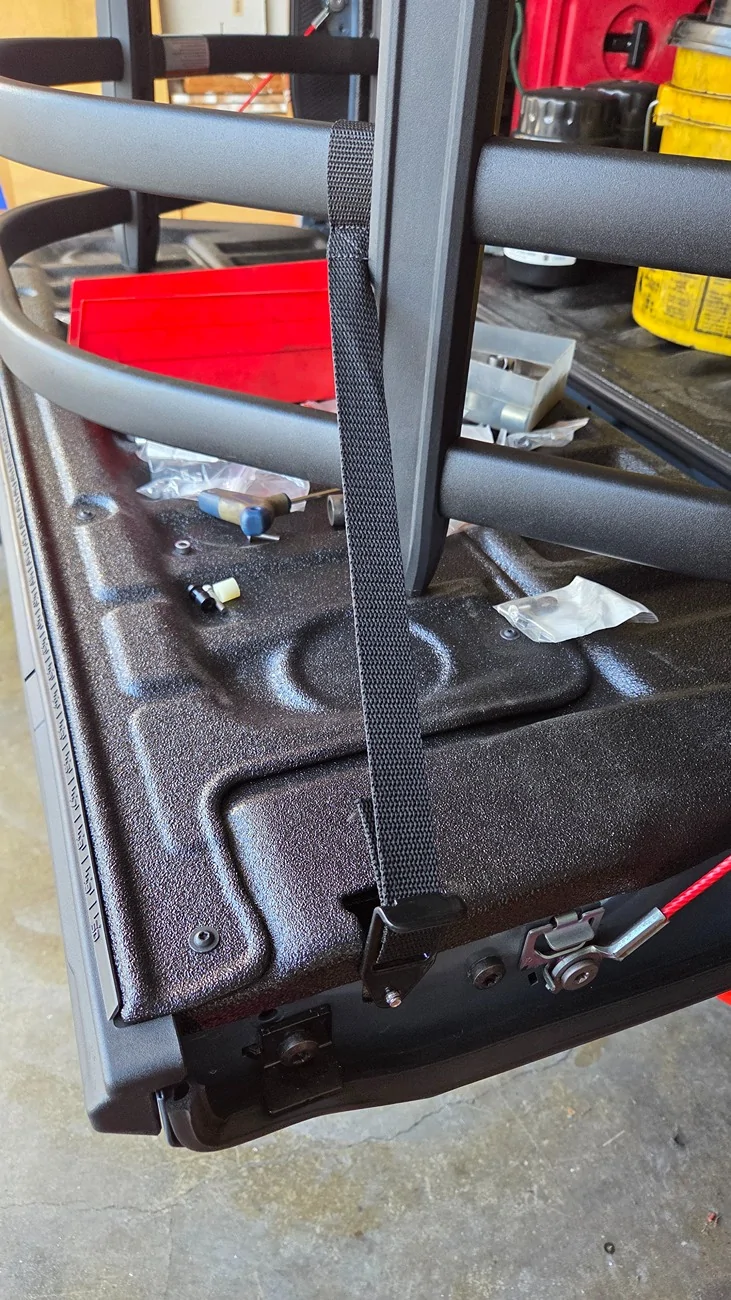

Cobbled together replacement pins since the original ones were way to small to latch into the tailgate. Hold down straps are nice and secure now.

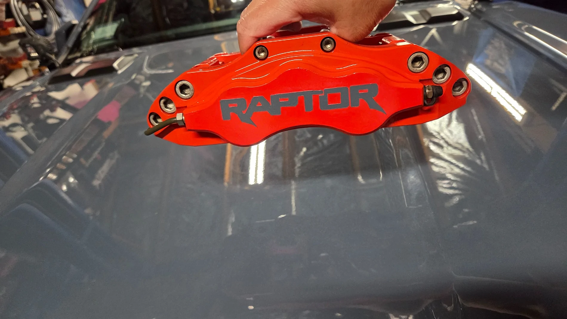

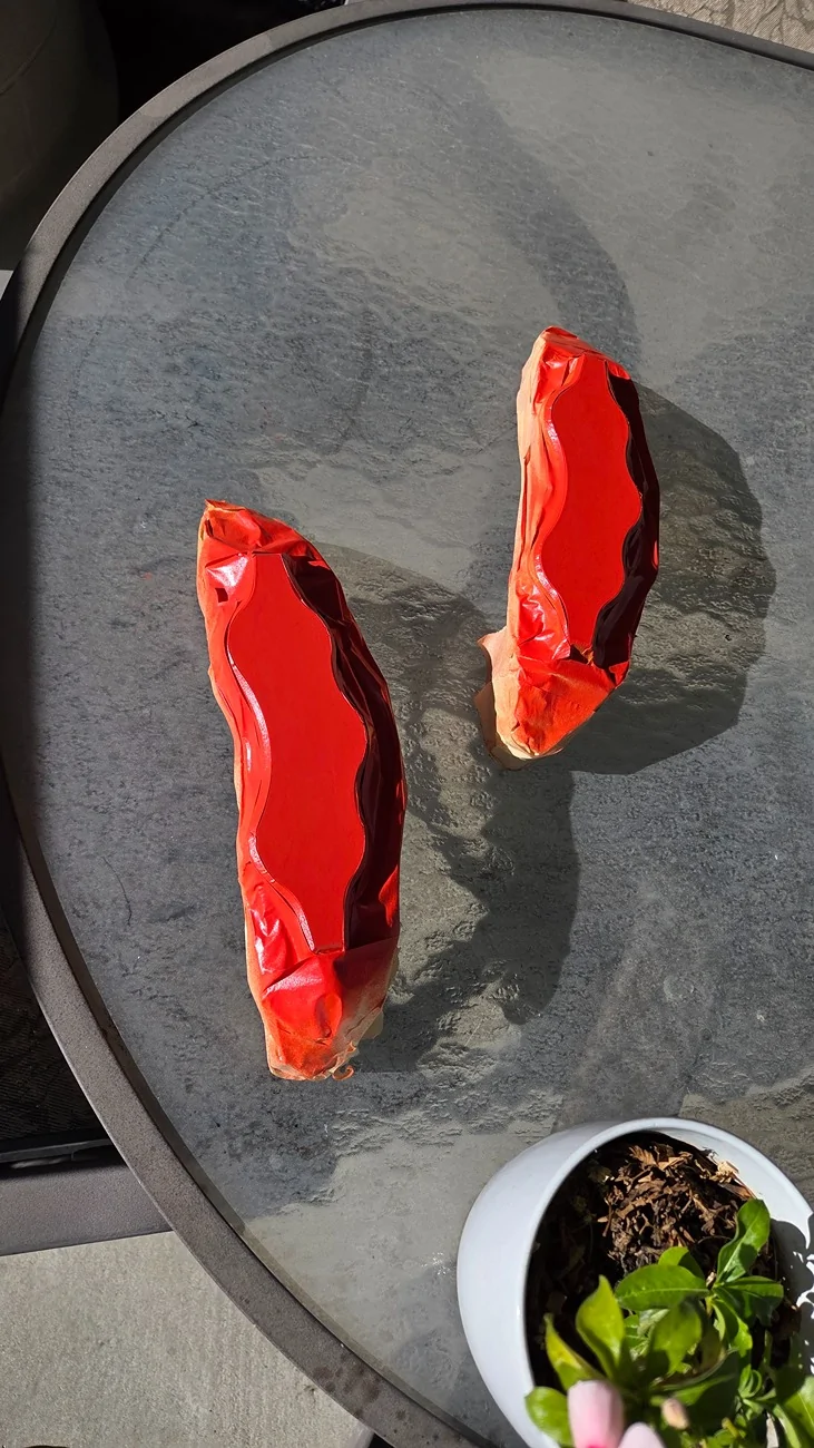

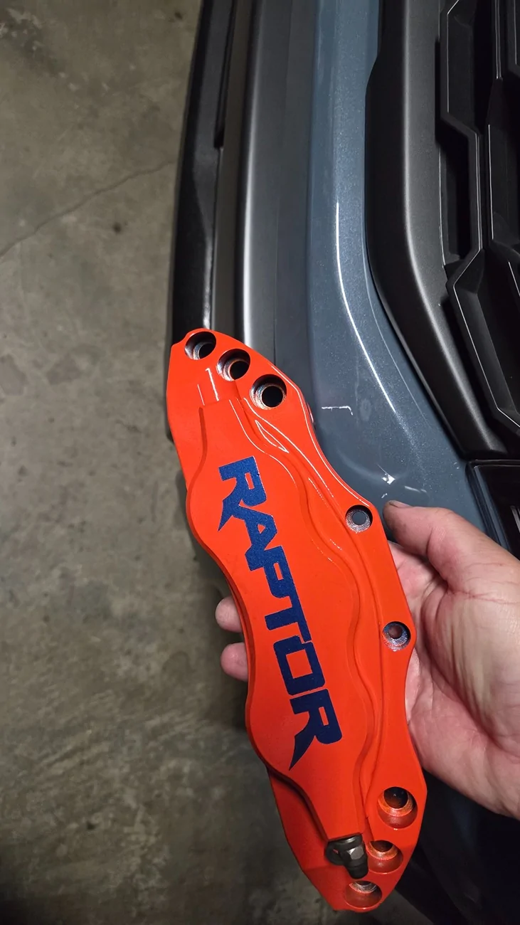

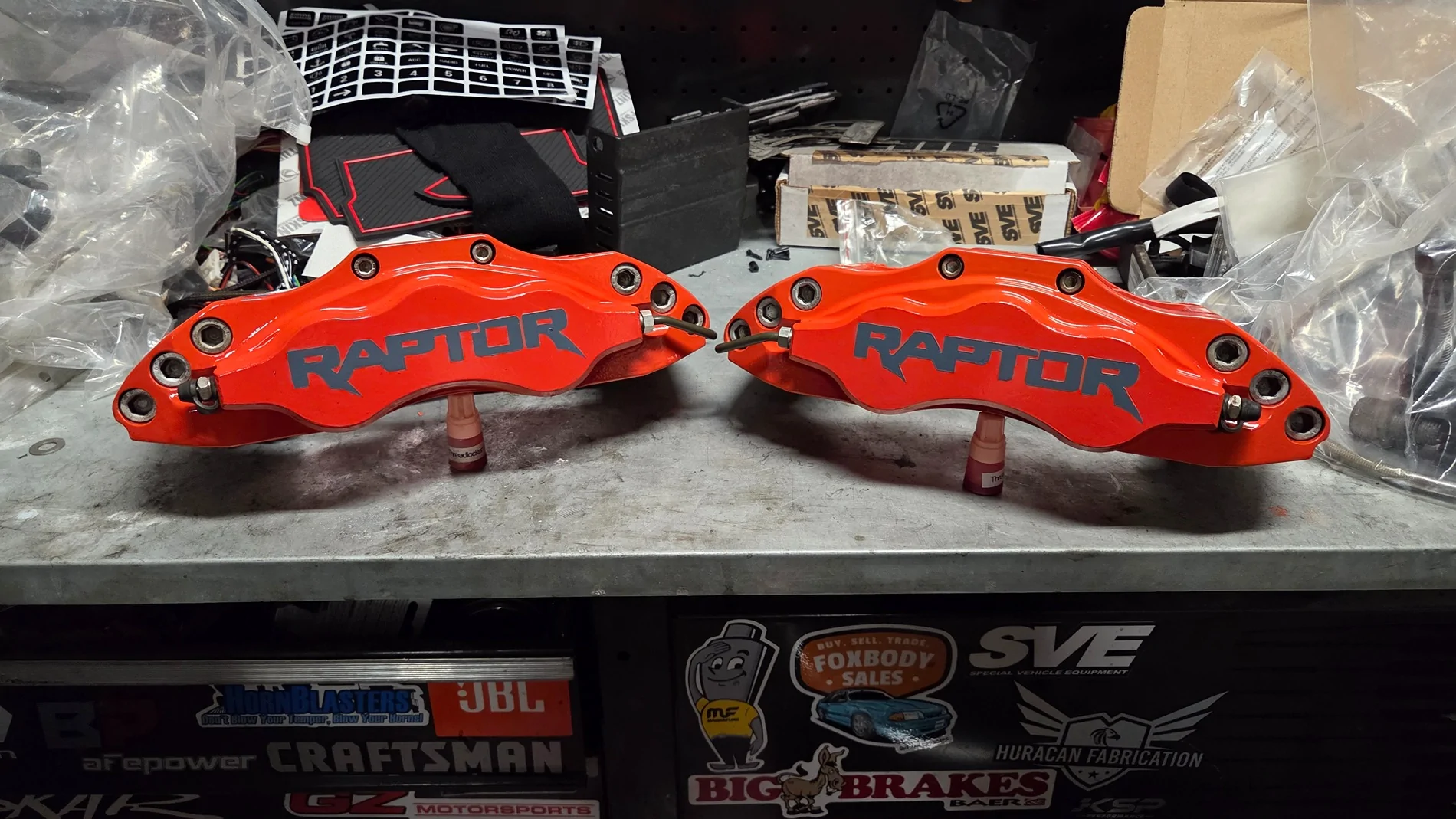

Finally. First batch of code G4 paint was completely a different color than Azure Gray. Had to sand the letters down and start again. Correct G4 Azure Gray came in today and it's a good match. Code orange caliper with Azure Gray letters. Did the opposite theme to the truck.

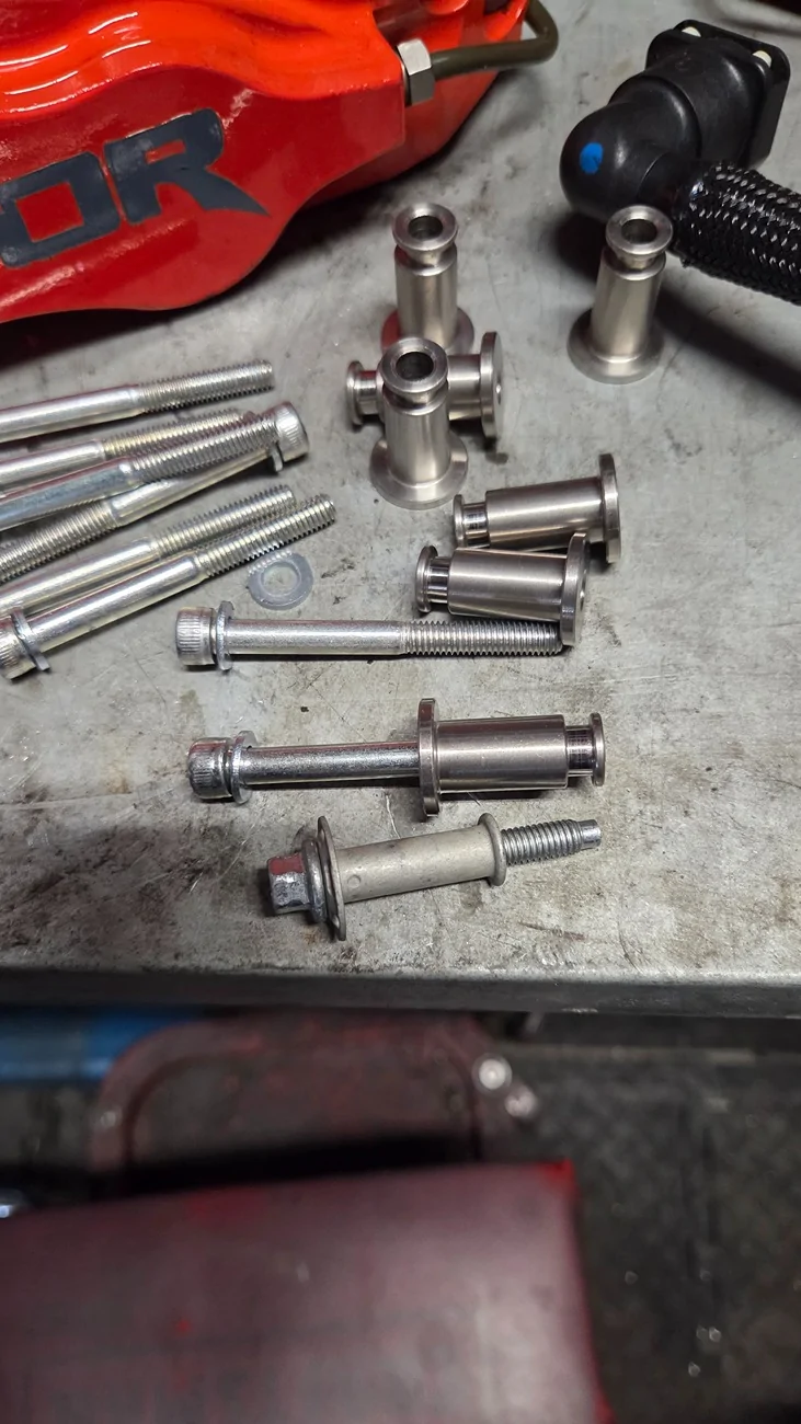

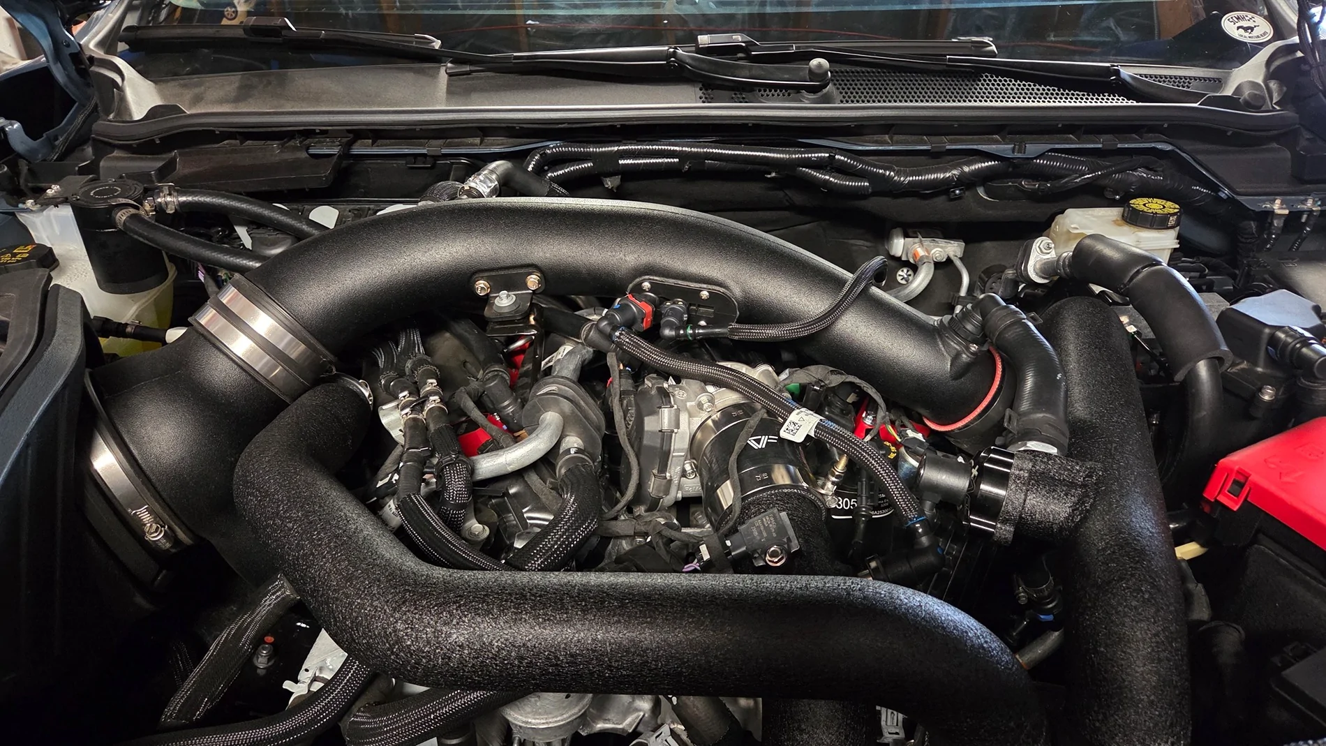

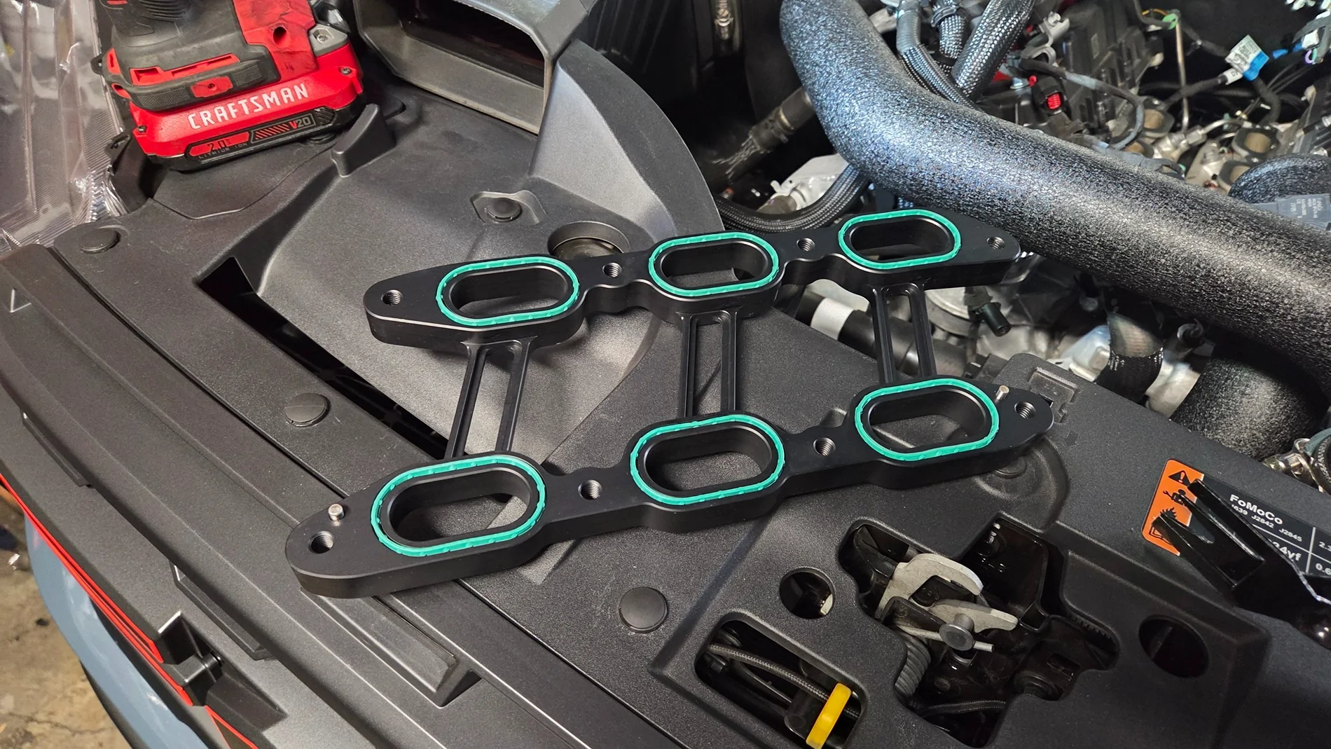

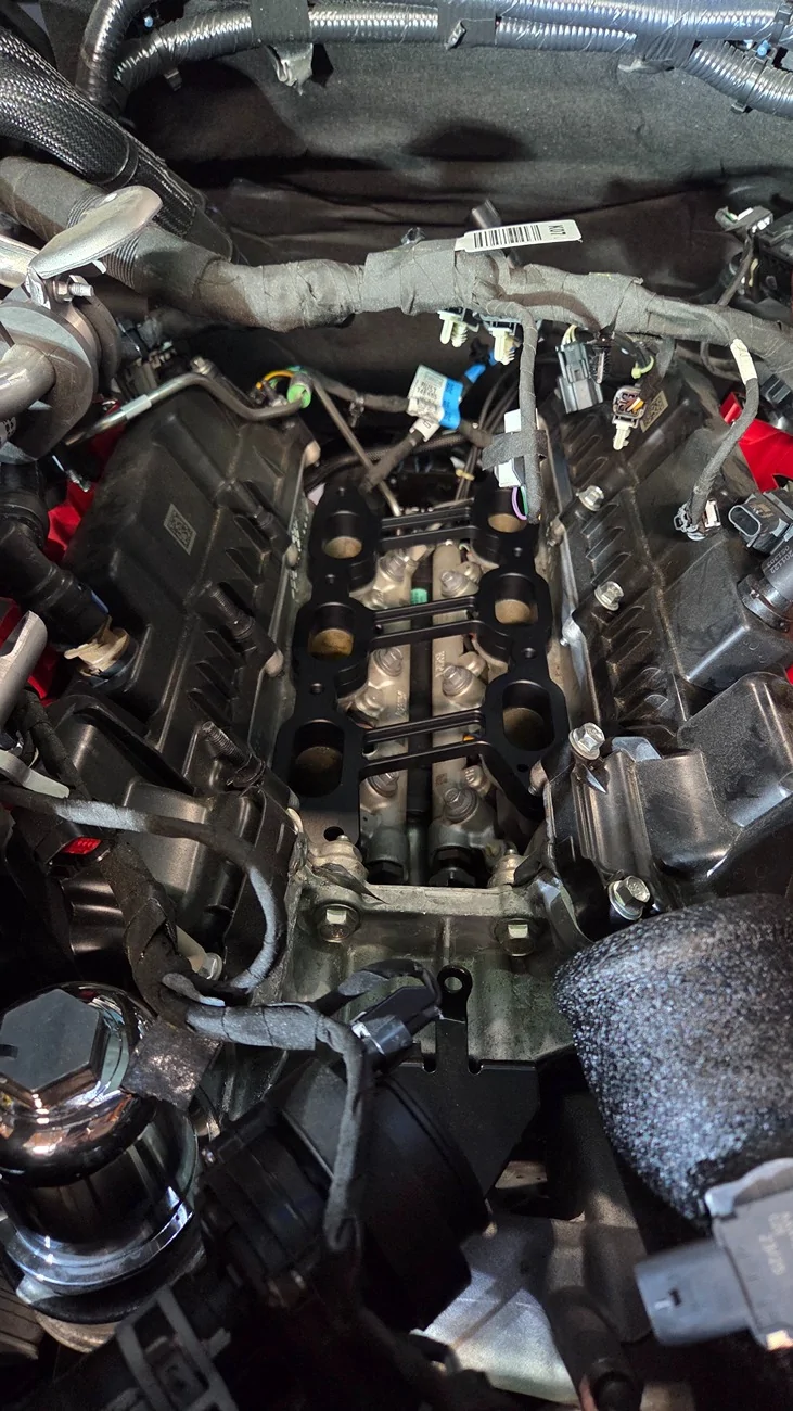

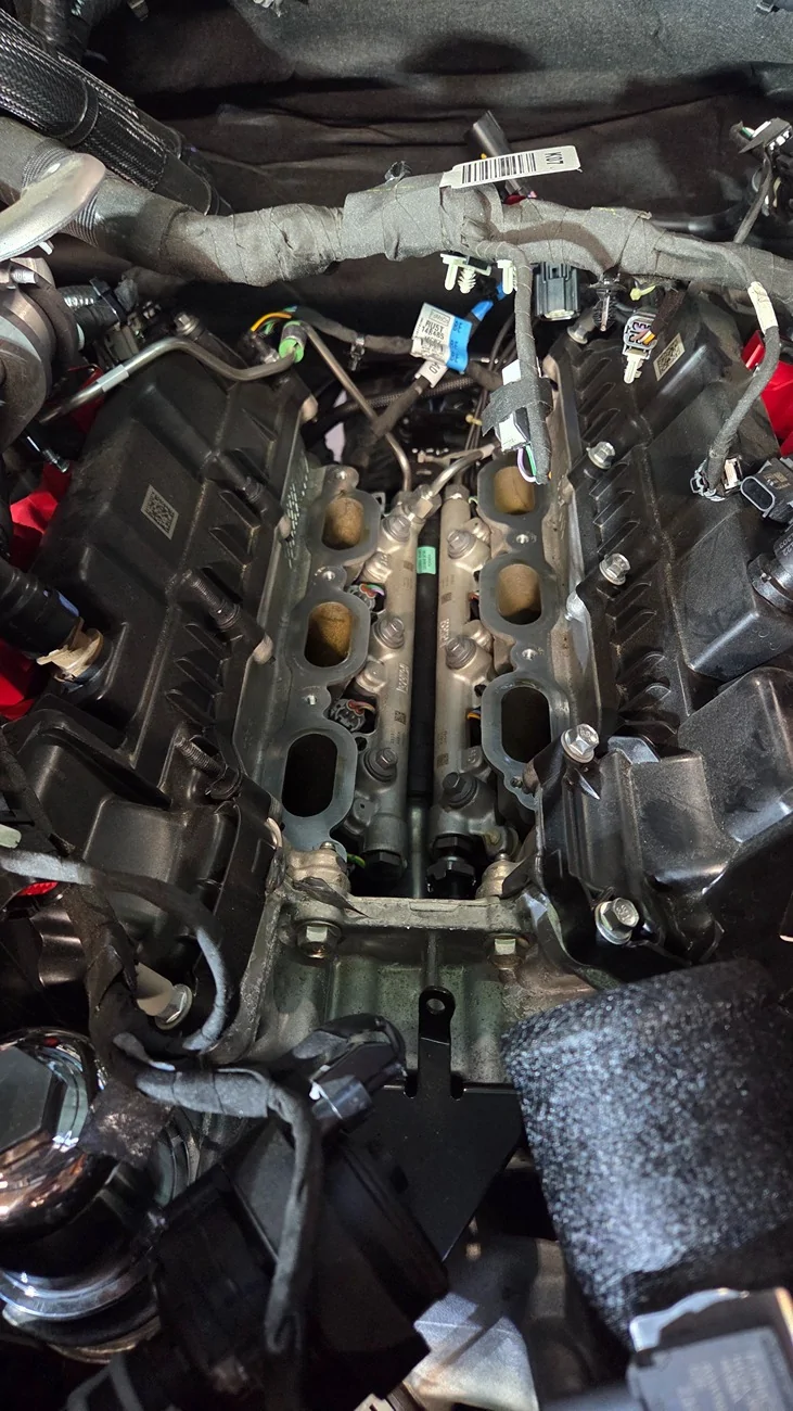

Final mod before the tune. Intake manifold to head spacer. Little more runner length for low end off boost torque. More for mileage than power is my goal. Worked on my 2019 2.3 Ranger. Knocked out the stock bolts and stands for the intake and replaced with the new longer hardware. Needed to add a small spacer to the heater line bracket due to the height increase. Took about 2 hours because I had to go back and readjust and tighten charge pipes. Otherwise could be an hour job. Can't even tell it's there.

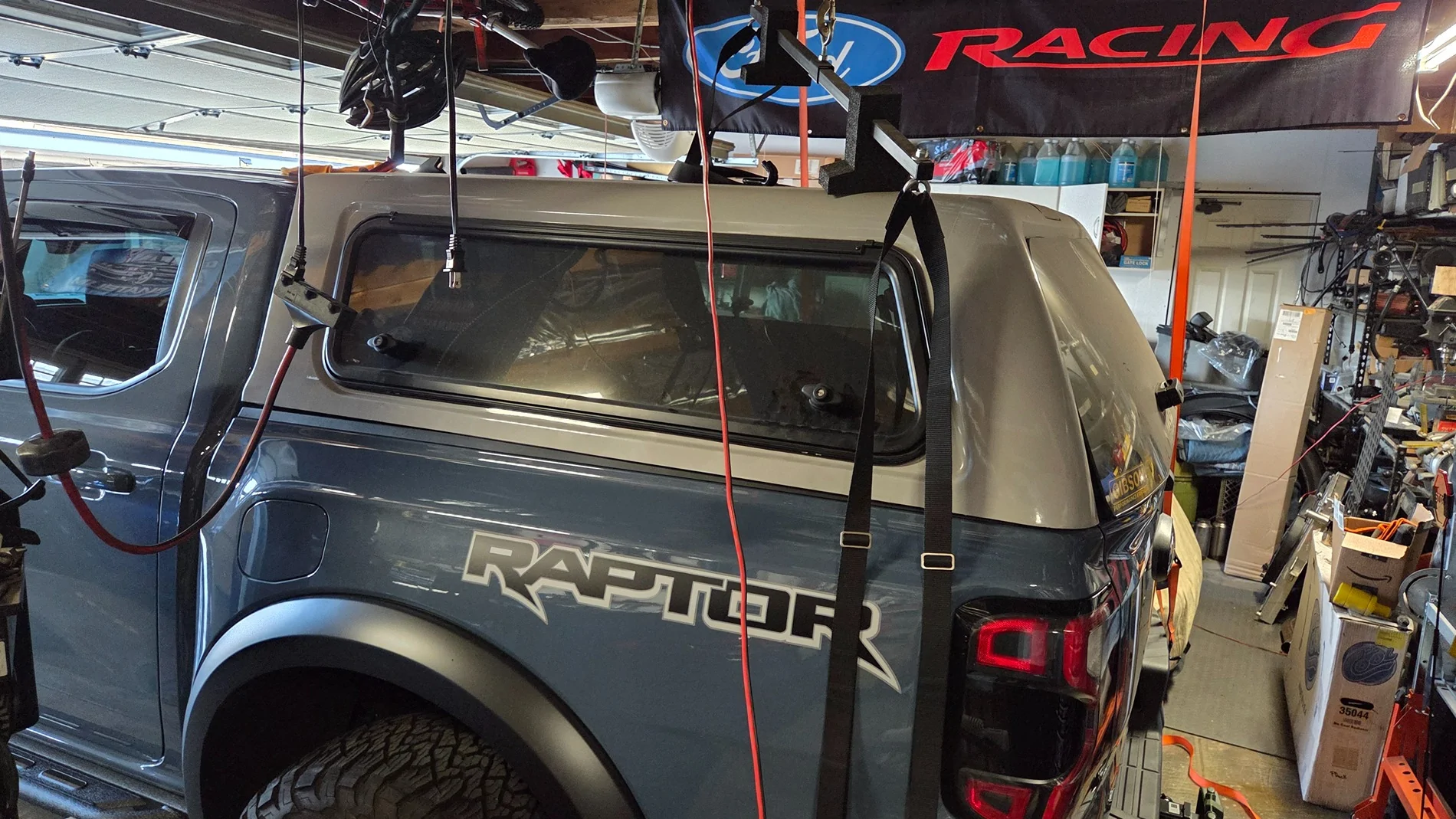

Finally got around to checking the fit on the camper. And we have 95% fitment. Won't have to buy a new one. Just need to paint it. ARE Evolve CX from my 2019.

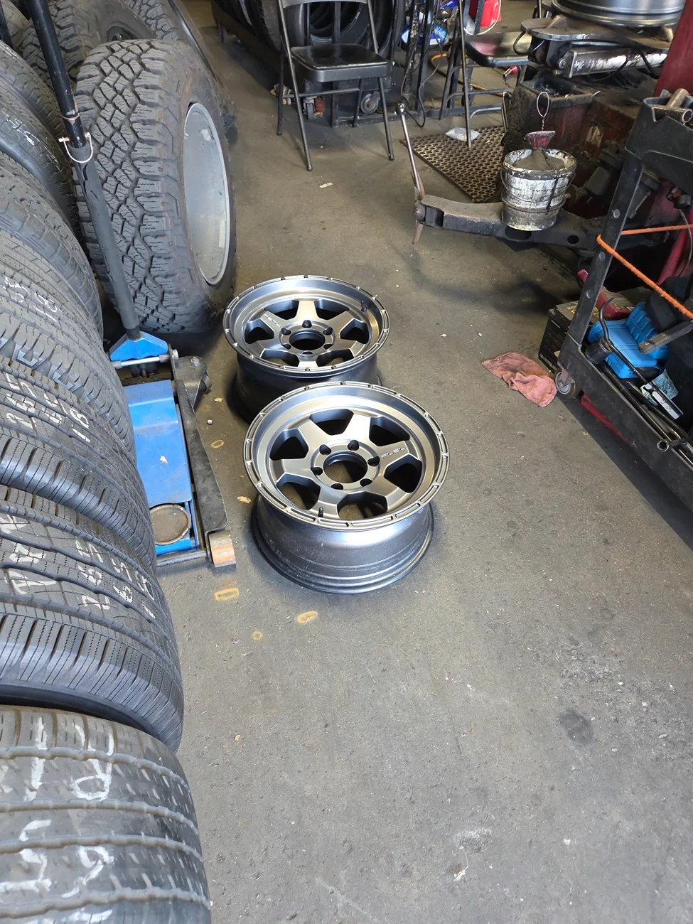

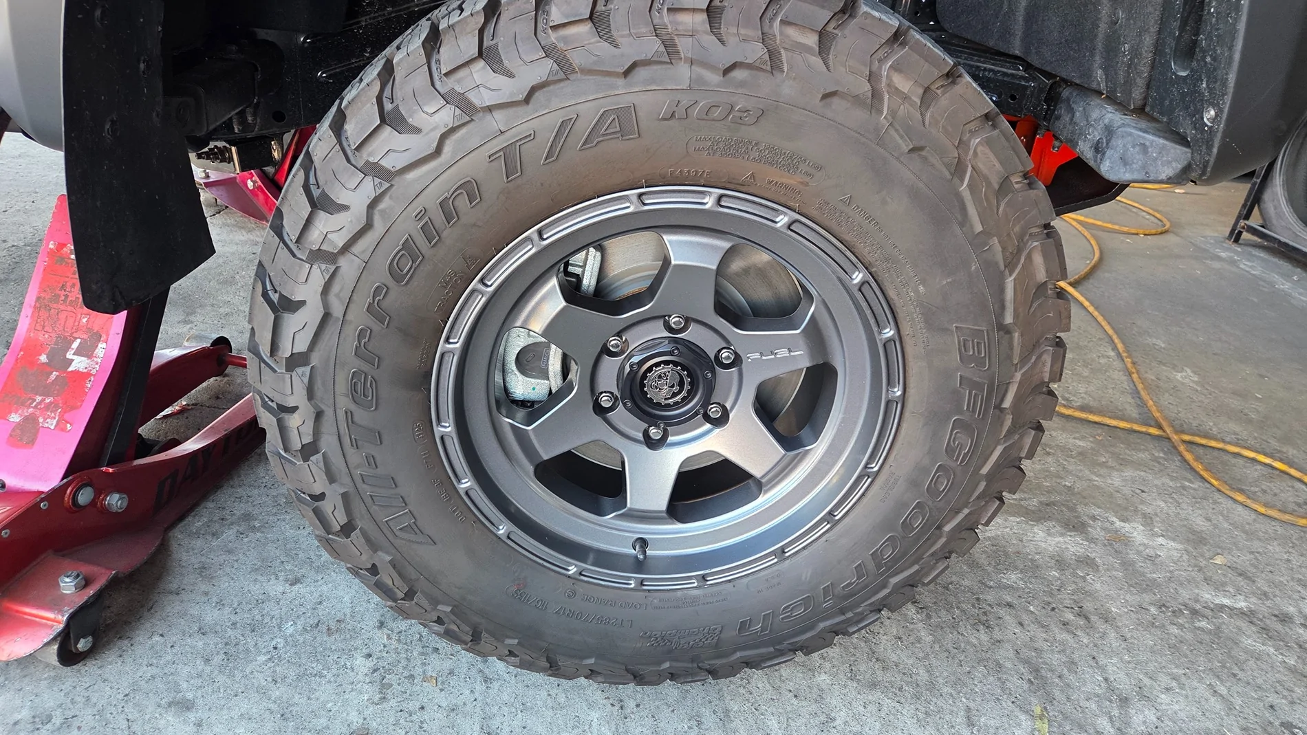

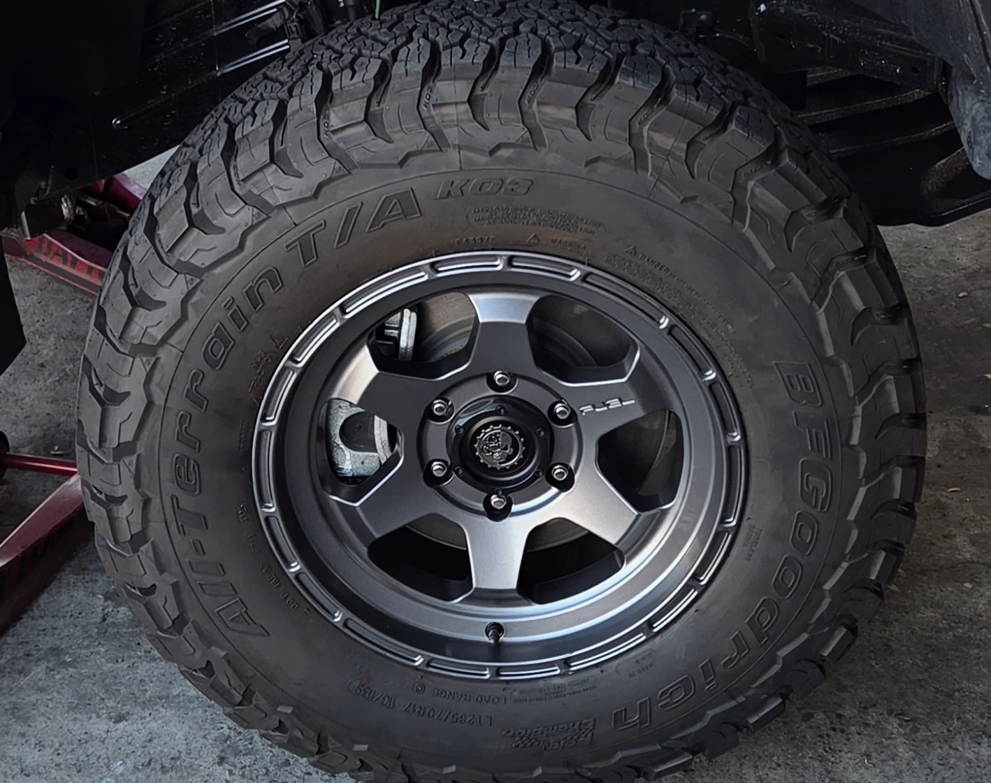

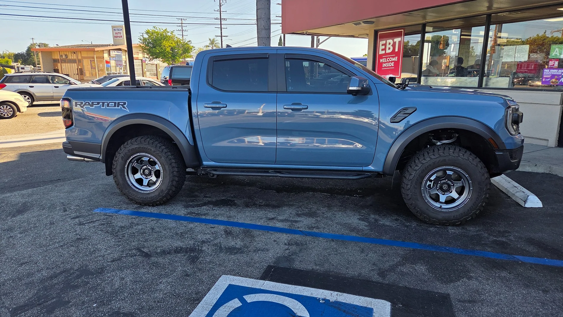

Looking pretty good all cleaned with the new old wheels on. They sit out just a tad bit more than stock. Almost perfectly flush with the fender flares. Mud flaps have been perfect in rock throwing protection. Fuel Shok 17x9 +20 mm vs 17x8.5 stock.

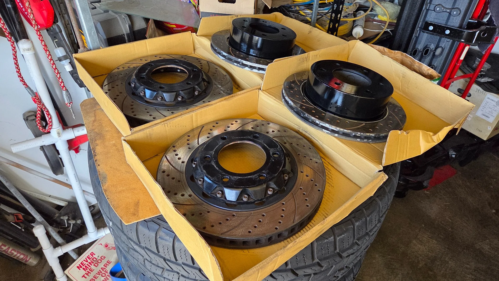

Cleaned and touched up the rotors for the upcoming upgrade.

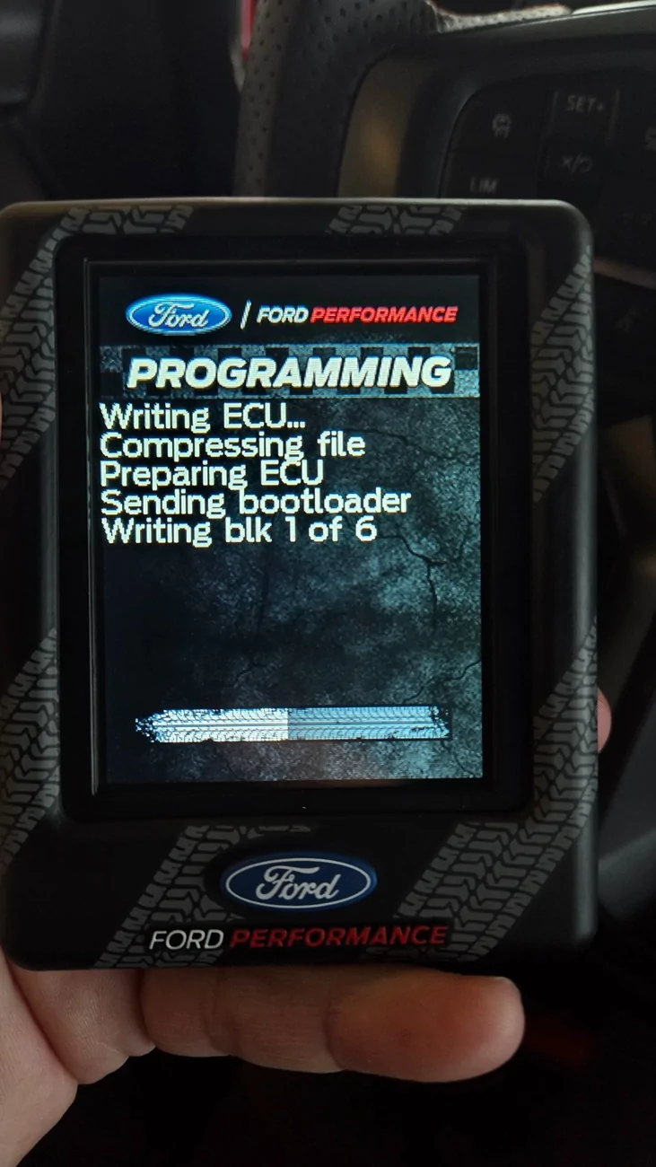

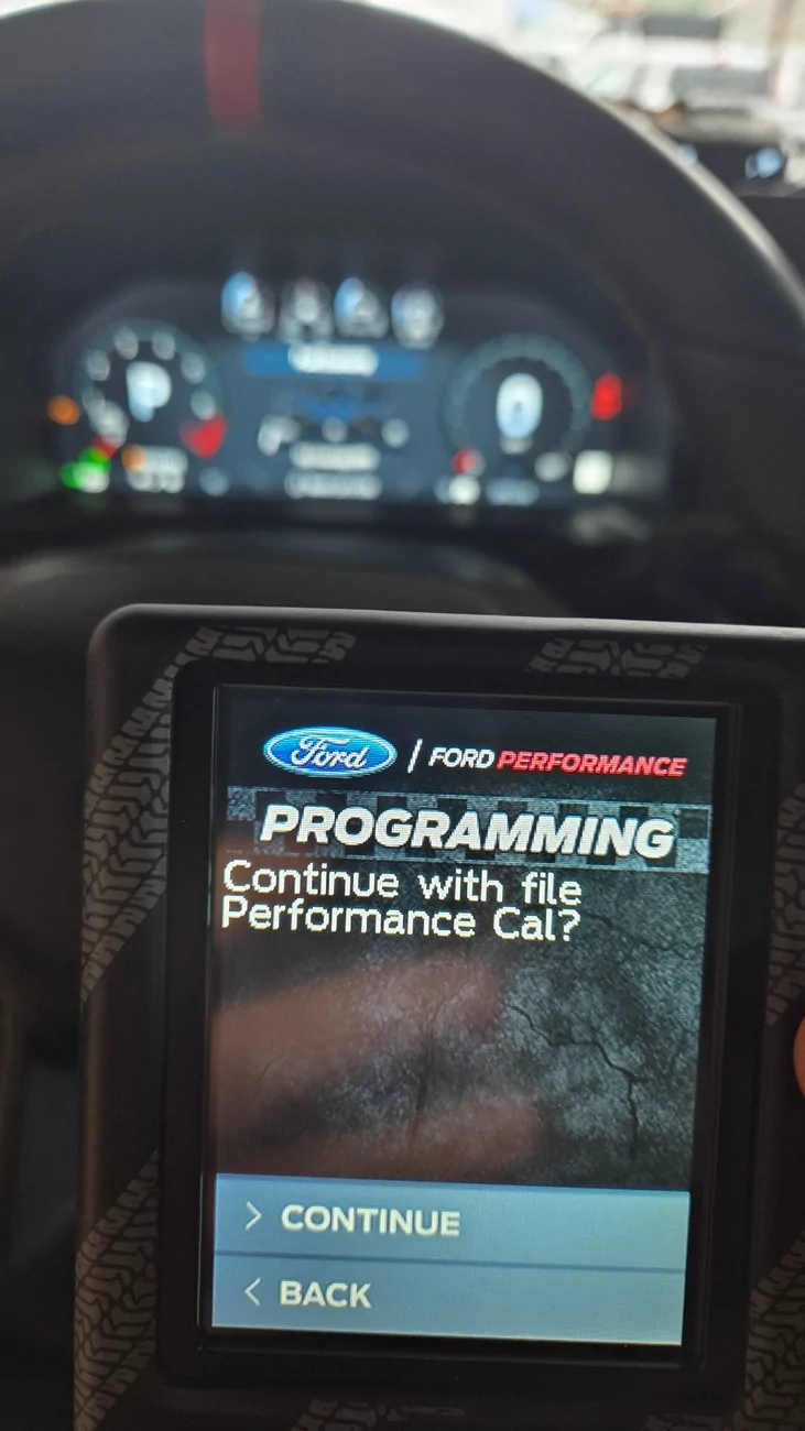

And it's done. Ford Racing tuned.

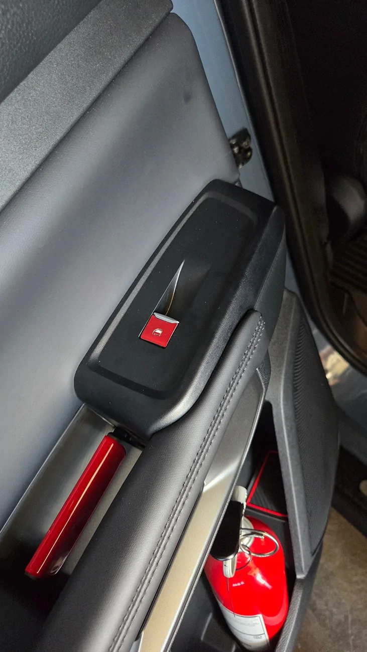

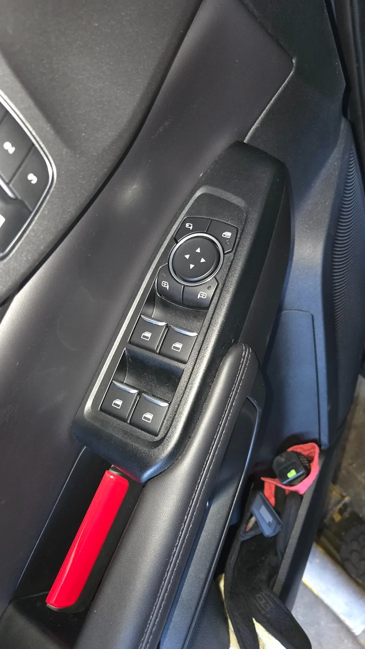

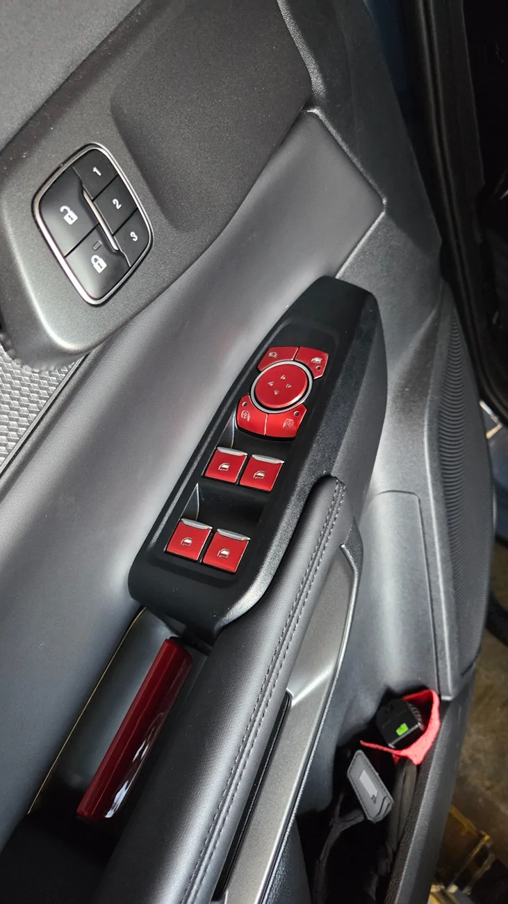

On another note added some more color to the interior.

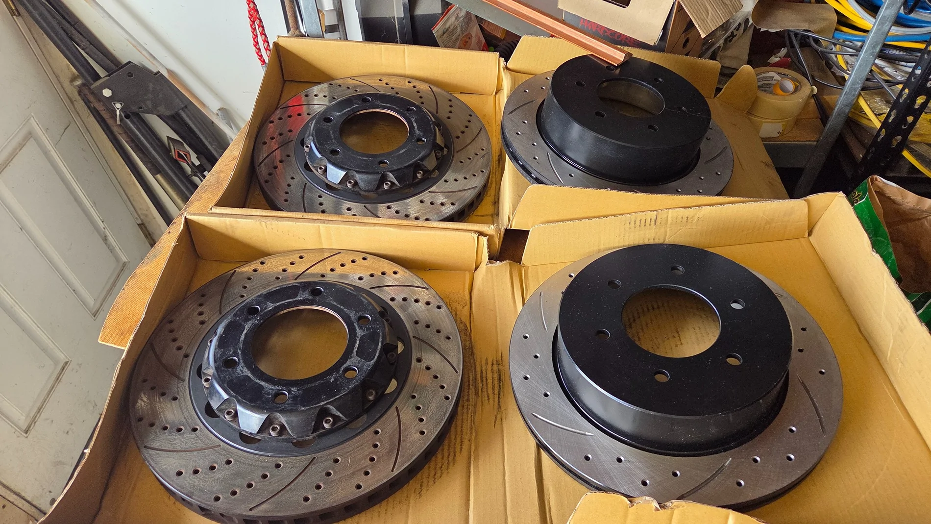

Got the correct rear rotors on the right. Much bigger than the standard Rangers. Pairing up with the 6 piston front kit.

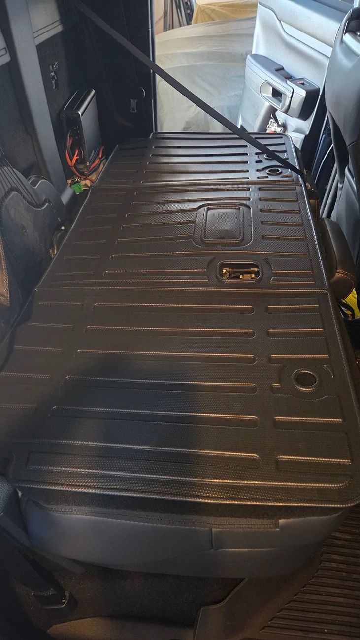

Protective mat for the seat back.

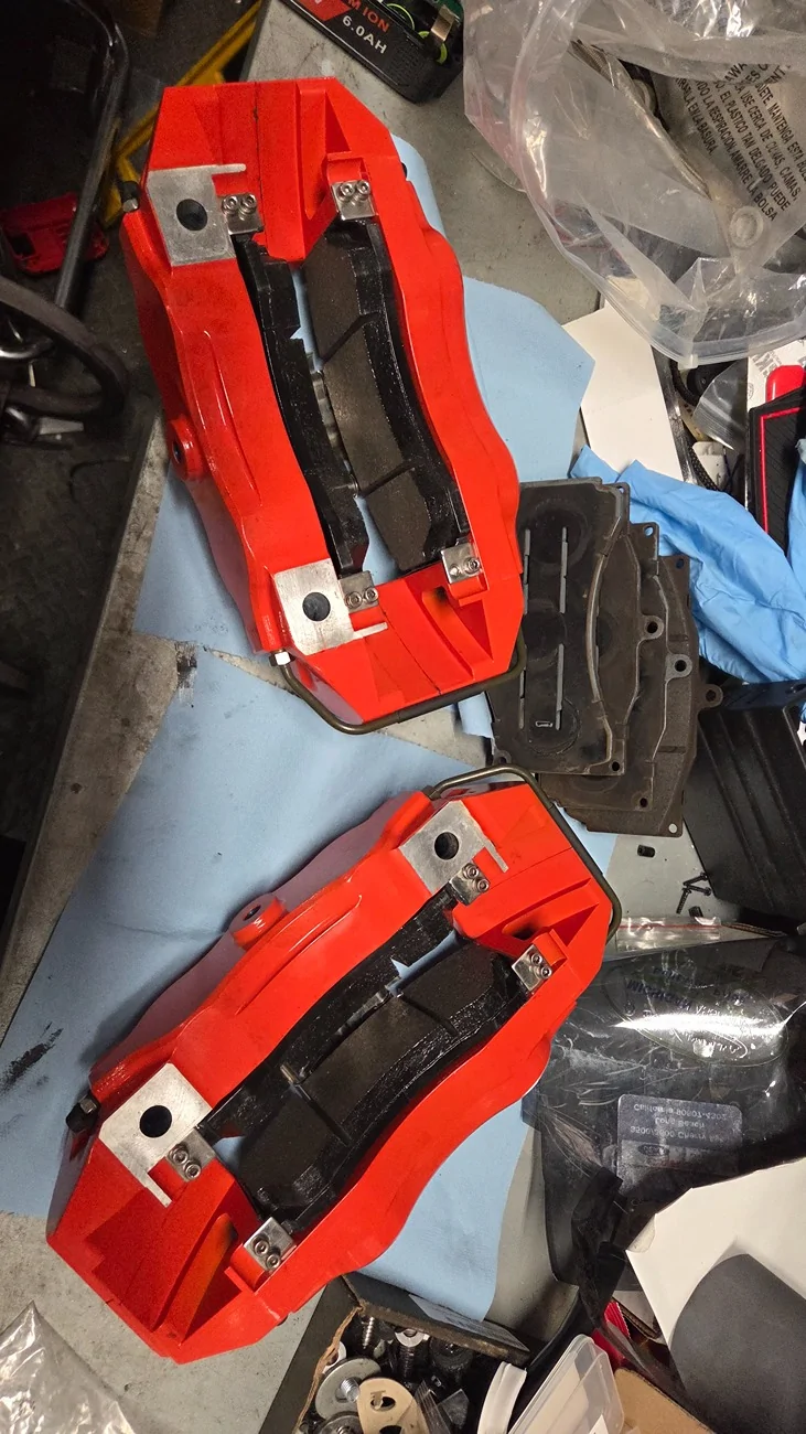

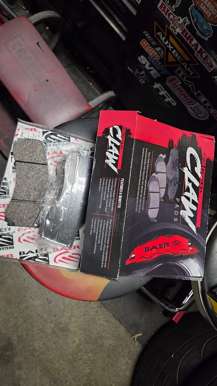

Loaded the front calipers with Baer ceramic pads. Nice low dust units. Let's see if i can find a set for the rear.

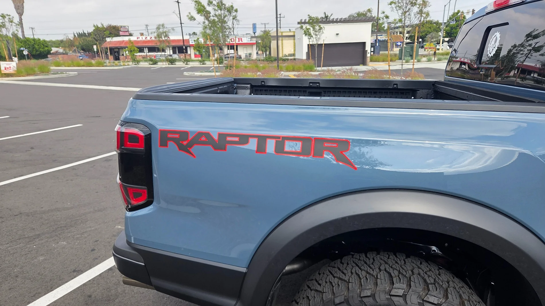

Finally got around to the PFF which allowed the new bed decals to be applied. Instead of white outline is code orange to match the theme.
