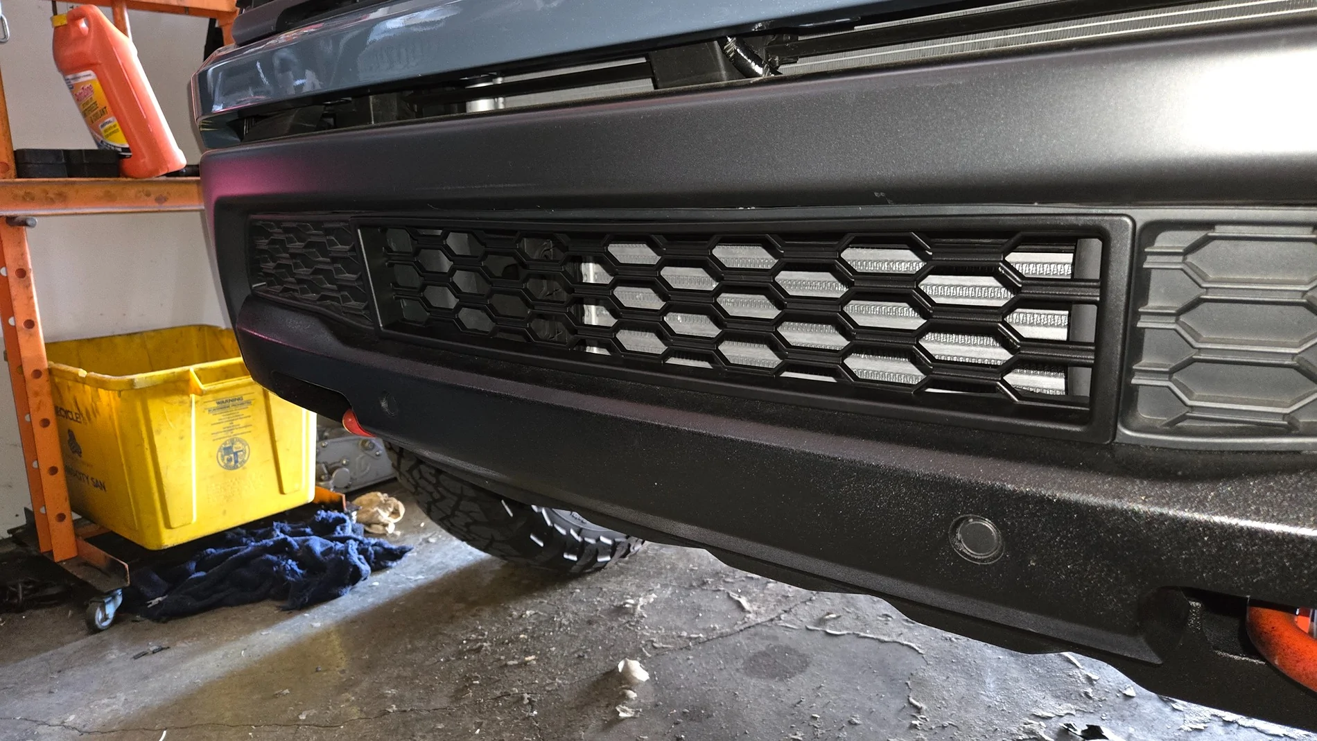

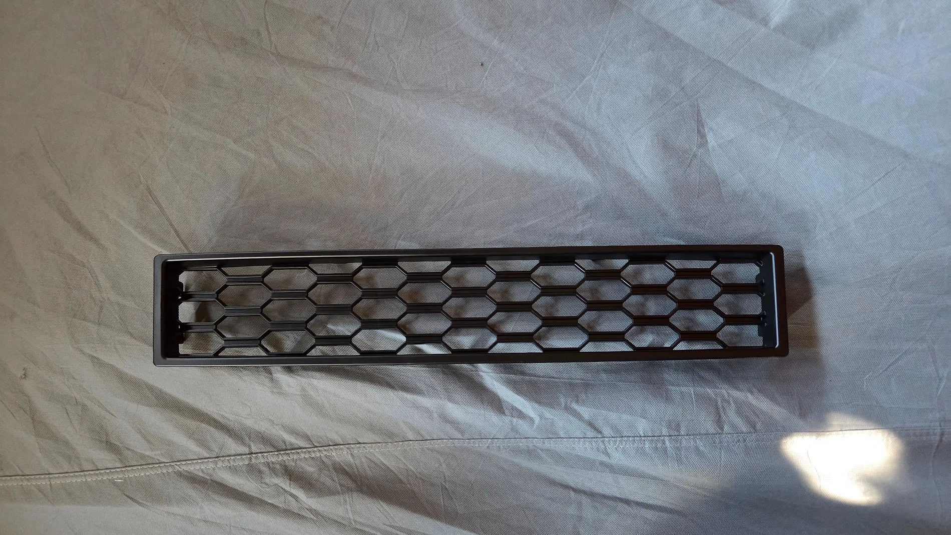

Why did you take them off better airflow?

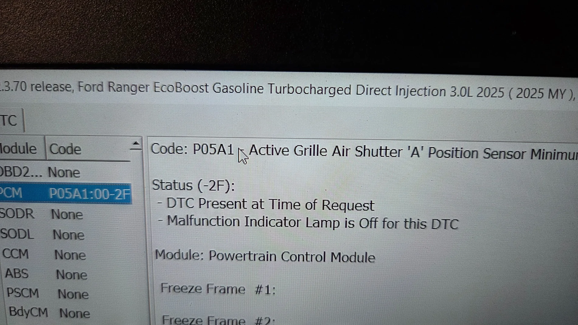

Yes, pre mod before intercooler. It says you're supposed to remove them with the intercooler install. BTW, did yours pop a code P05A1 active grille shutter sensor minimum/maximum?

No code I just snapped tied the grille motor under the bumper to some other wires so far it's good

🤔 have you run codes? It's not a code that will trigger the check engine light. I only saw it because i had forscan running to recalibrate the ACC relocation and was looking at all module codes.

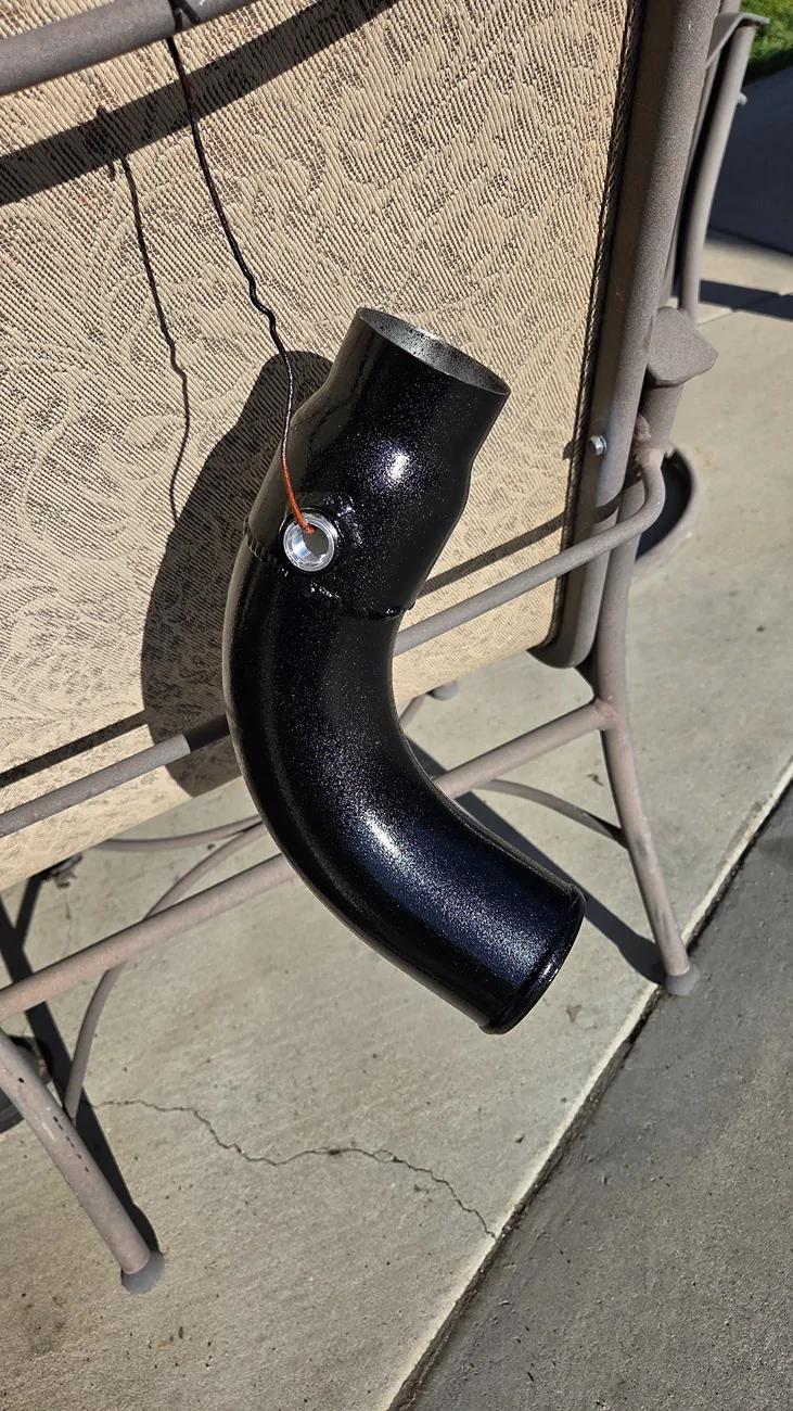

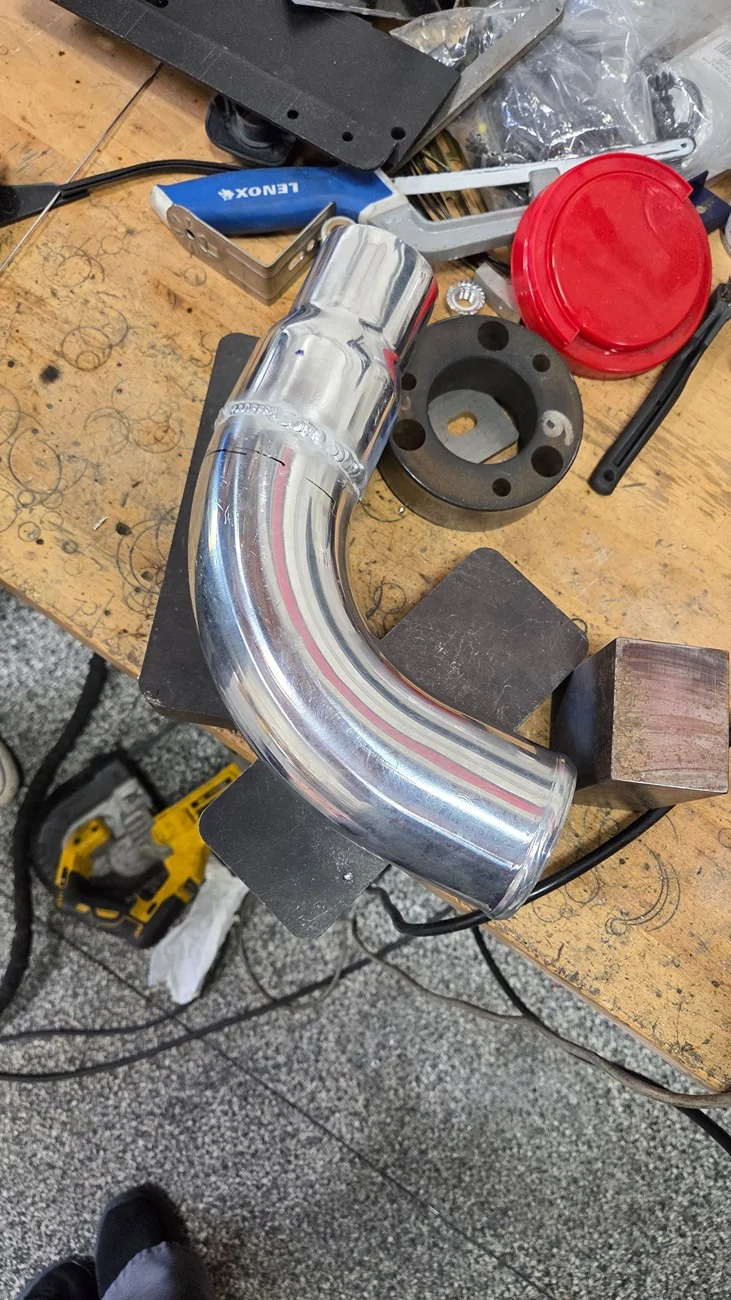

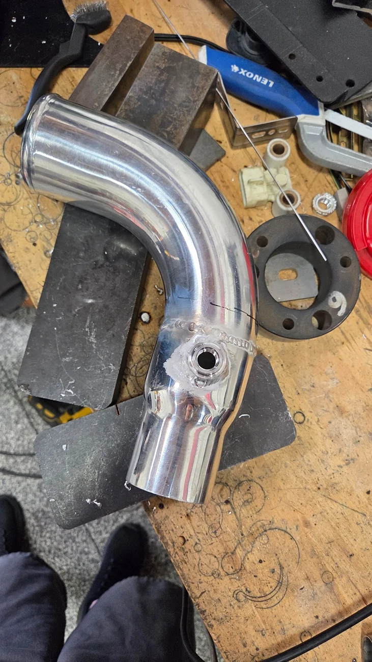

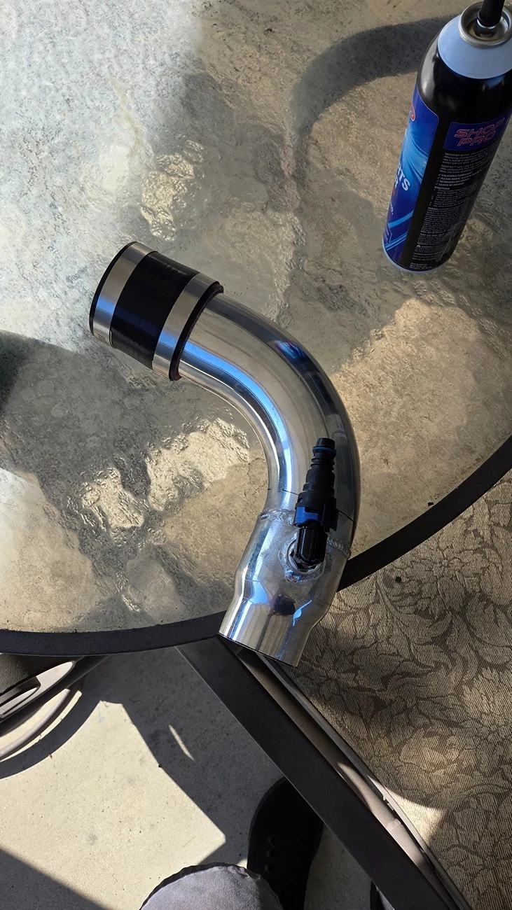

Got the final portion of the cold air kit made. I had a brain fart and put the fitting bung on the opposite side. 🥴 On the bright side it doesn't matter as I can just reroute the crankcase hose. Lol. Waiting on paint to dry.

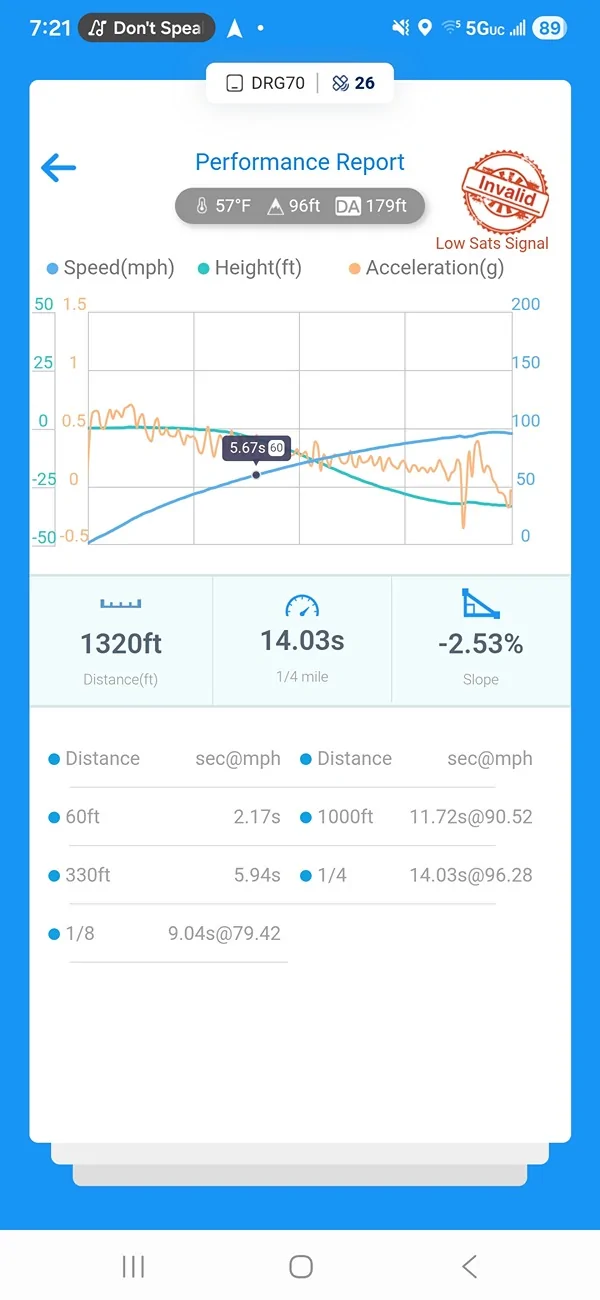

Draggy run finally done this morning for the throttle body. Throttle body was worth almost a tenth. Might have run a 13.99 in the right condition.

How did the throttle body help just in terms of "feel?"
I believe I mentioned it but I monitor the instant mpg and the throttle input %. It now requires less throttle to maintain the same speed with a higher mpg now. I just did the draggy run this morning and picked up almost another tenth on the quarter mile. So, I say that about a 10 hp+/- gain along with better low speed flow. Hence the higher mpg and less throttle input to maintain the same speeds.
