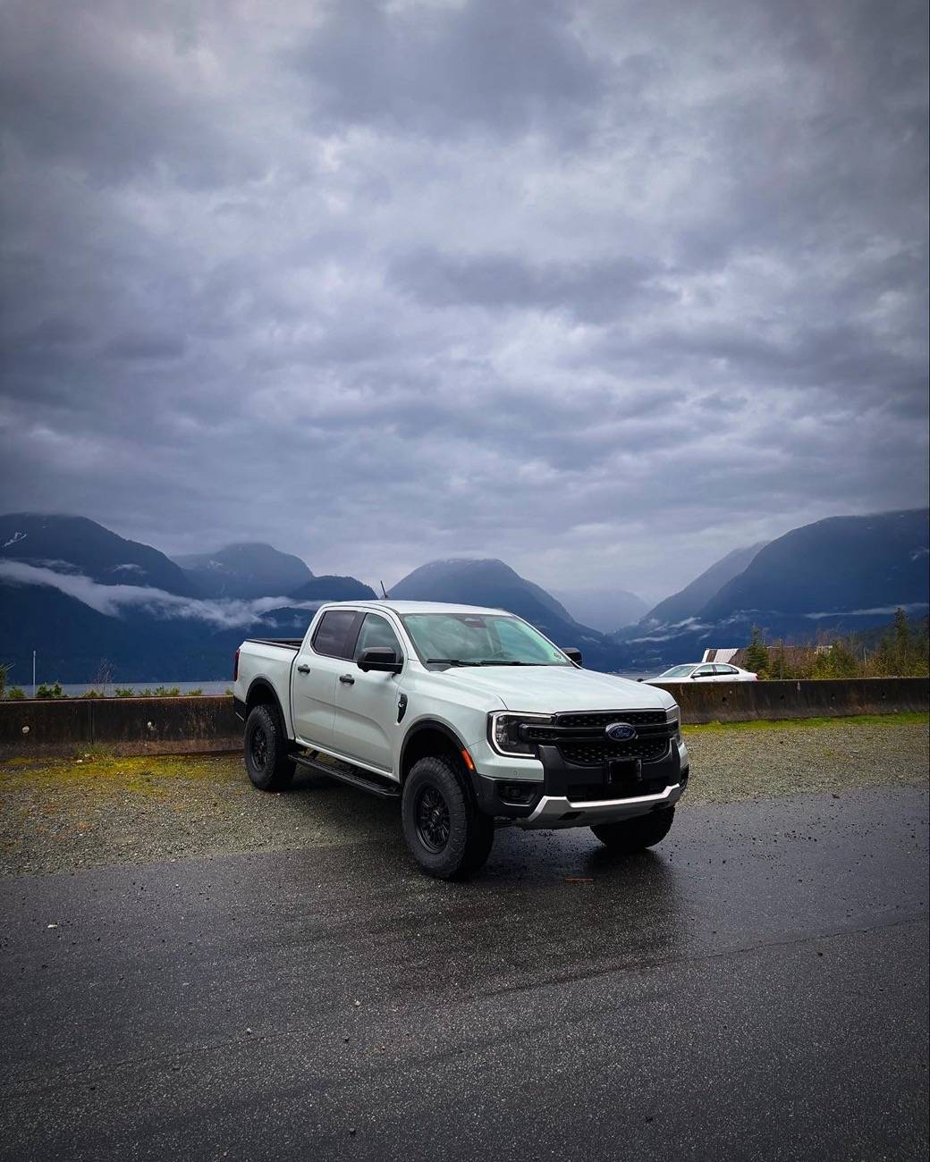

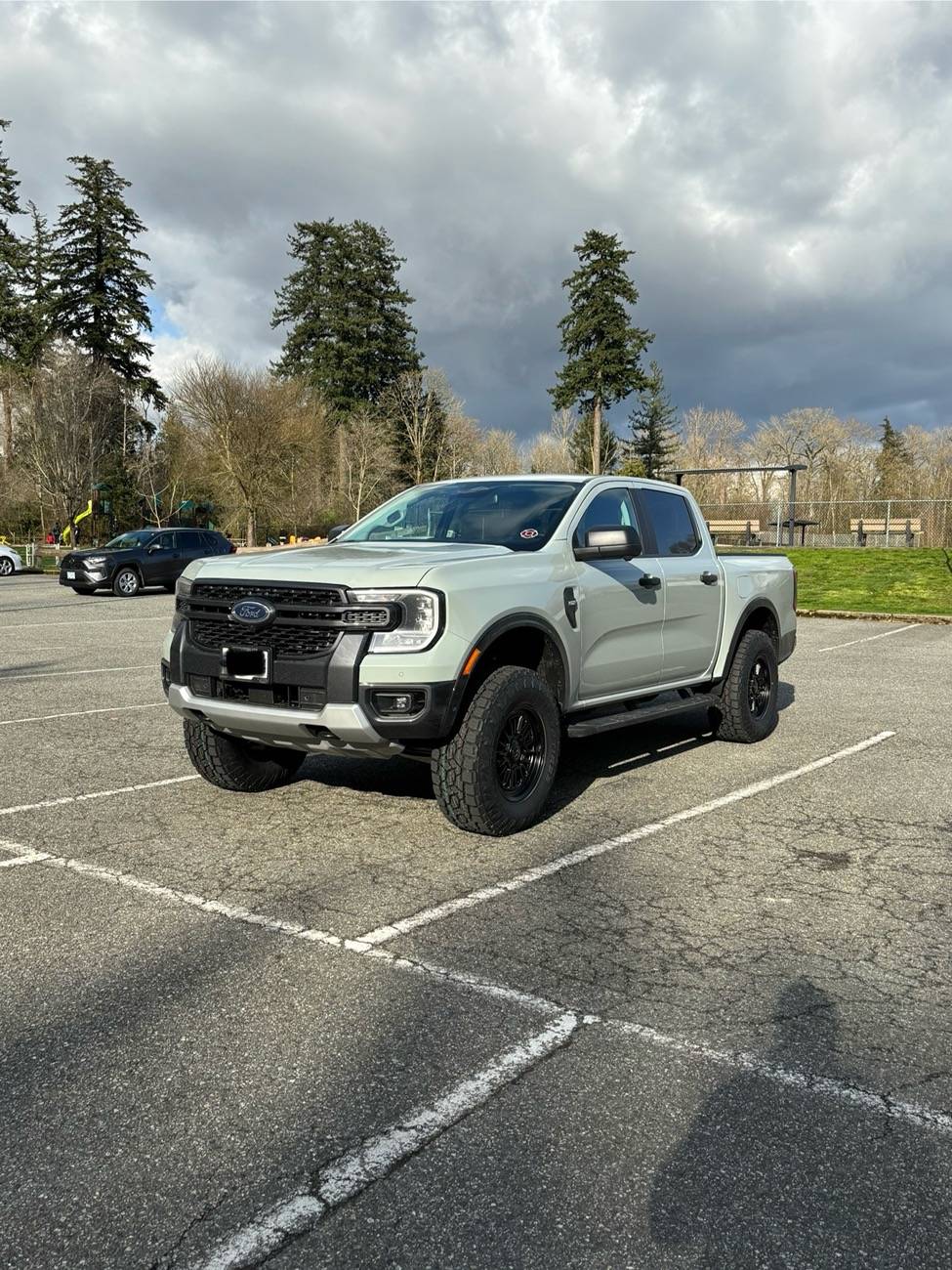

Welcome to my 2024 Ranger FX4 XLT cactus build! I wanted to make a little thread to document my build for fun.
Comingfrom a 2021 tremor I was a bit worried, but I’m happy to have the freedom to do what I want to it as the tremor had limited lift options and such. So far this thing has been amazing and I couldn’t be more stoked.
Day 1

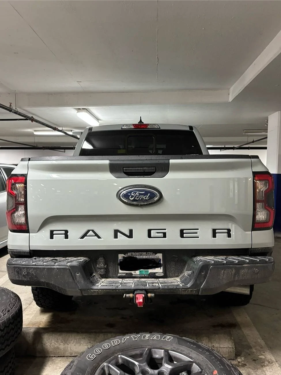

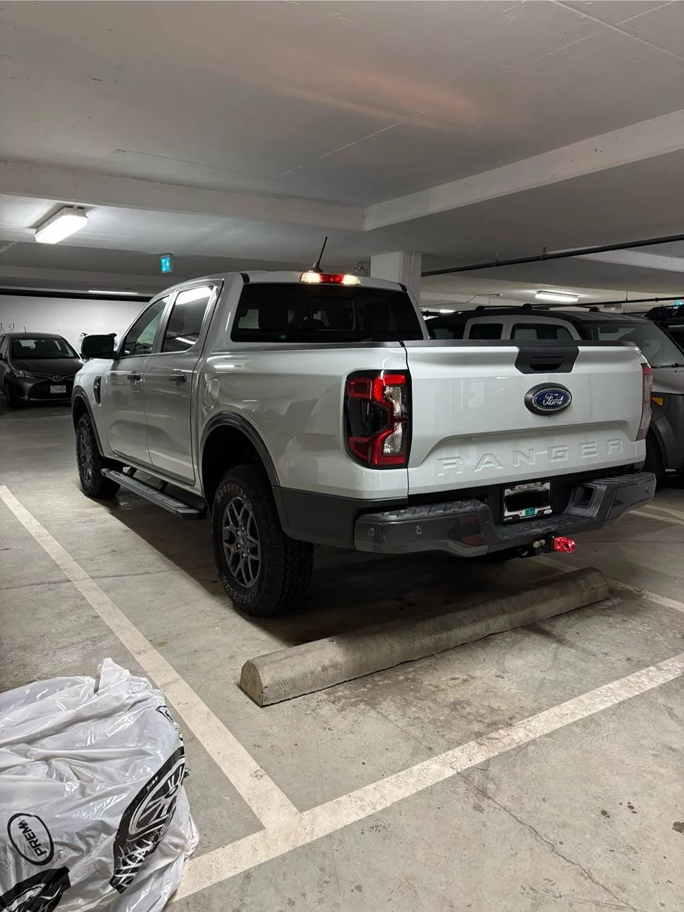

I started immediately by removing the air dams, bed side decals, and adding my red rocket hitch recovery point!

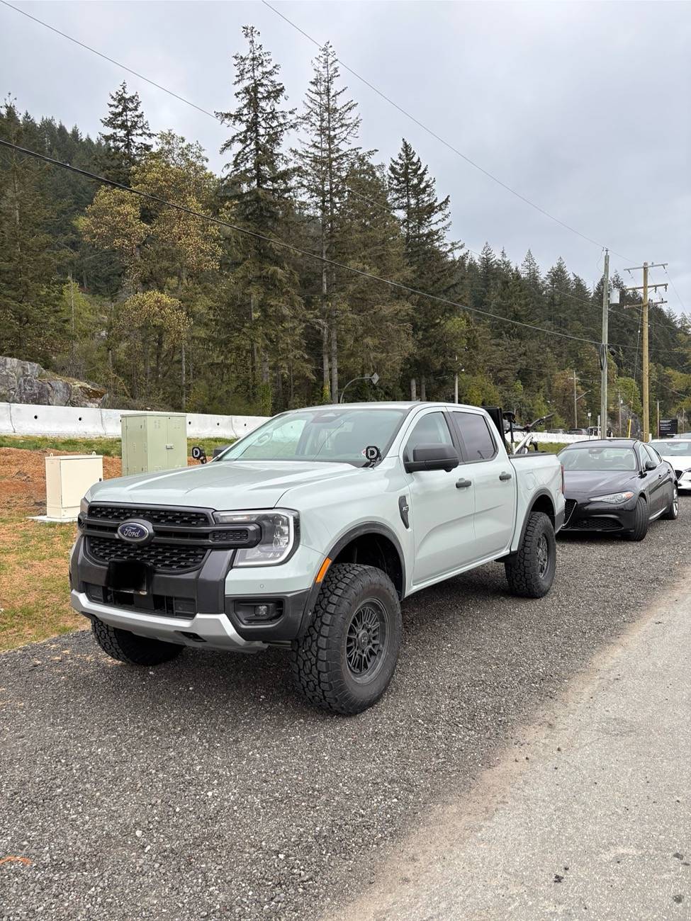

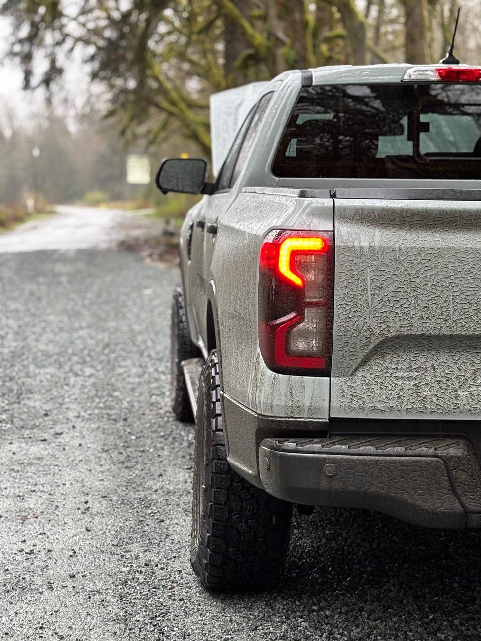

Next was pretty big, level, tires, wheels.

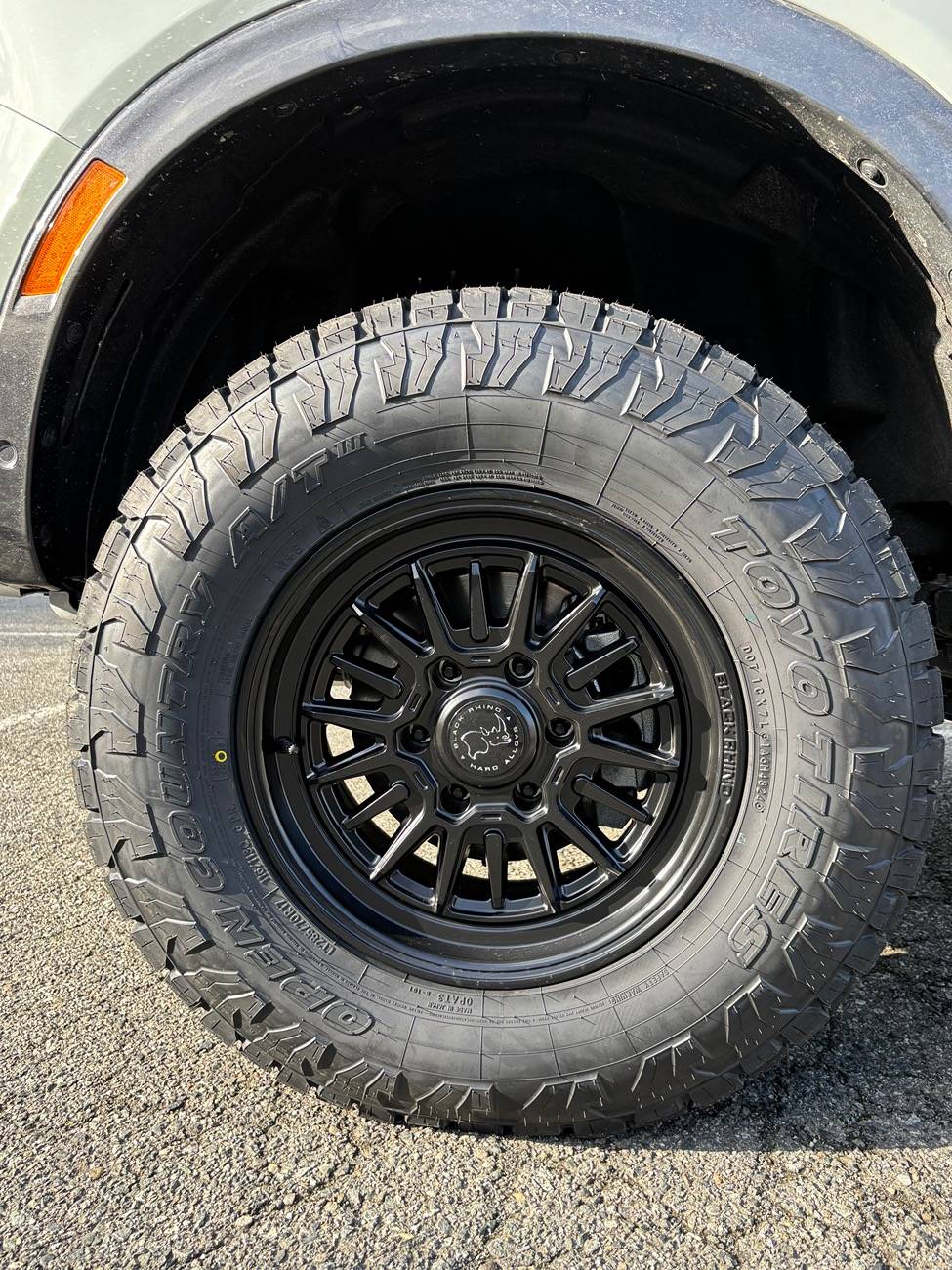

Bronco Bilstein 5100’s with OME coil/Top Hat.
Toyo open country 285/70/17’s
Black rhino wheels 17x9 +25mm

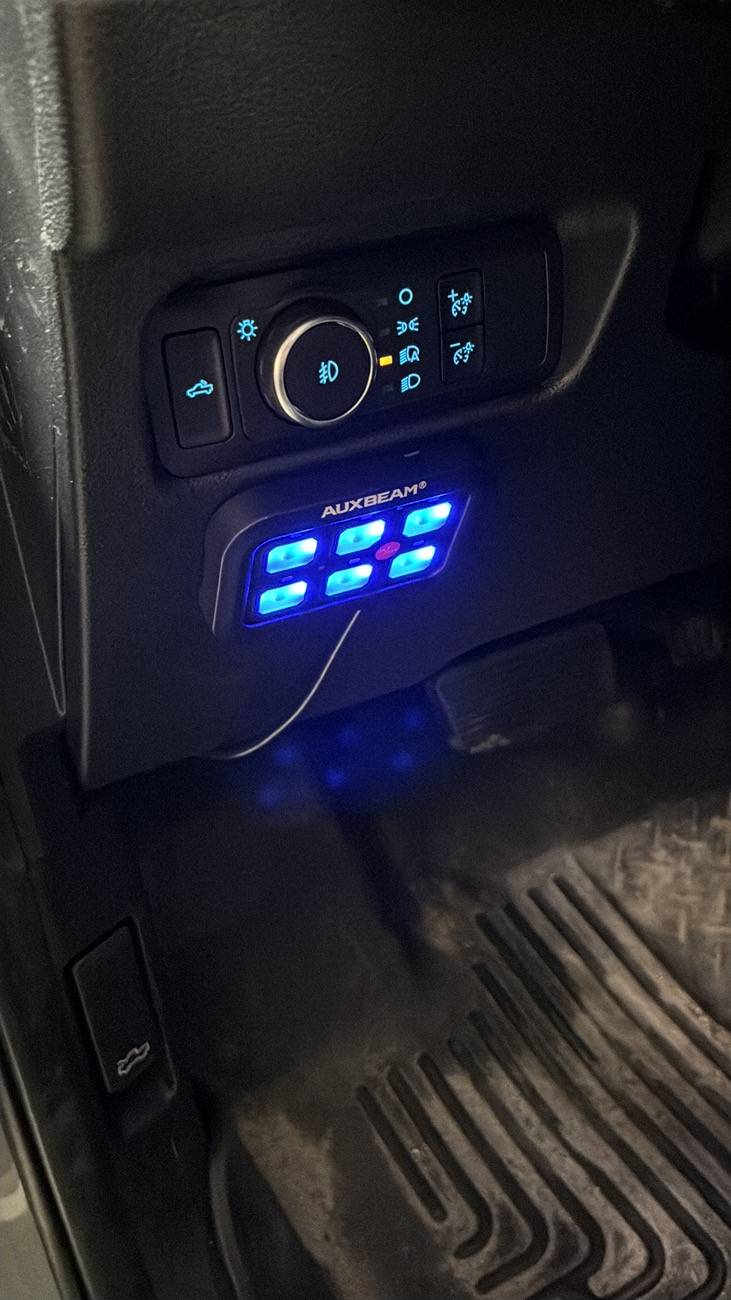

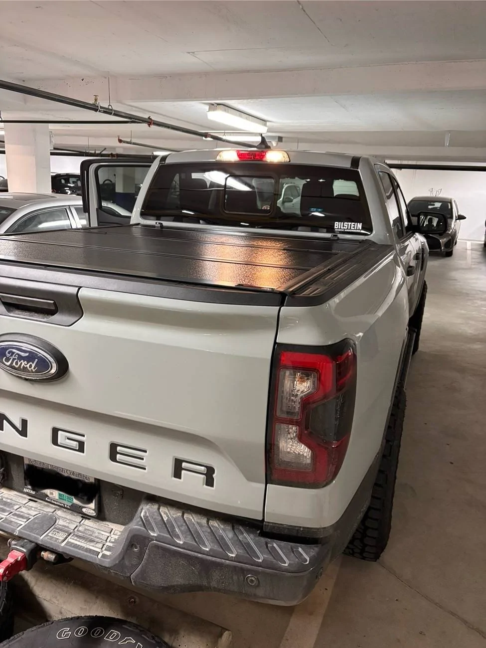

Next up, was ditch lights, tailgate letters, switch panel, step removal, and tonneau cover.
AuxBeam Switches
Diode Dynamics amber combo lights.
Bison Hard Tri fold tonneau cover
Next up will be GoRhino rb20 slims and then will chill for a bit, but I hope to keep updating this thread as it
I’m also trying to figure out some sort of mounting method for maxtrax, rotopax and such. Maybe a bed rack or bed mounting. Not sure yet!
Anyways. Thanks for your time, hope you can gain some info for your builds!

A few More Pics cause I love this thing.

I have the same exact wheels and tires in my cart and about to pull the trigger for my 2024 WildTrak! I have a couple of questions if that's okay
- I don't see the Black Rhino Taleo in 17x9 and it isn't listed on their site - are you sure these aren't 17x8.5?
- I am stuck between the +25 offset and +35 offset and this makes me want the +25 offset. Besides the poke and rocks being flung onto the truck, anything else noticeable or wishing you went more tucked?
- I noticed in another post you are starting to dislike the Toyo's? Is there a reason? How is the ride and noise when on the road (where I will be 90% of the time!)

I appreciate it man! I’m pretty confident they are 9 inch wide and +25. I’m not sure what the model is as they were unreleased and used for a photoshoot and I bought them off the guy who got them from BR.
As for the poke. I feel like it’s perfect. There’s days I wish I had more poke.. purely for aesthetics. They did shoot up some rocks but the sliders and mud flaps solved that problem
I can look into the offset/width for ya.
As for the toyos. They honestly are great at everything, except wet pavement is terrifying here where I live. We’re talking fishtail in corners at slow speeds. Losing traction on hills. I will likely change them out after summer. But they have been great for everything else.
Thanks for the feedback!
The wheels are for sure Black Rhino Taleo - and I know this because this was my wife's favourite option when we were shopping for the truck. I think I will go with the +35 version and add spacers if needed as I am not a HUGE fan of poke but yours makes it look very good.
I think you just helped me make my choice of tire as well. I live in the Cayman Islands so absolutely no snow and it rains for about half of the year and 2 of those months we are under hurricane warning and it can flood within an hour. I was stuck between the Toyo's (looks slightly more aggressive) and the Nitto Terra G3s (wayyy better traction for dry and wet conditions but less aggressive look). I think I might pull the trigger on the G3s since the roads aren't that great and its either always extremely hot or raining.
What tires are you thinking about going with or you haven't crossed the bridge yet?
Is the front and back perfectly levelled or did you leave a small amount of rake? The back looks a little lower than others I have seen on here where they only level the front
Ya fair enough man, I’ve talked to a few people with the open country, and they have the same issue, but if you search online they have glowing reviews. So not sure what to say there, that’s just my experience.
I had the fallen wildpeak at3 on my last ranger and they were incredible. If I were to upgrade I’d go back to wildpeaks 100%.
As for the level. I’m pretty sure it was super close to level maybe a tiny bit of rake.
Maybe it’s cause I see the truck everyday, but I always feel like it looks low. Would love to lift it but I live with underground parking and that gets tight fast. Lol
In theory it should be at least a couple inches higher than a stock in the front with a level and 33’s, but I guess I’ve never really done a side by side test.
