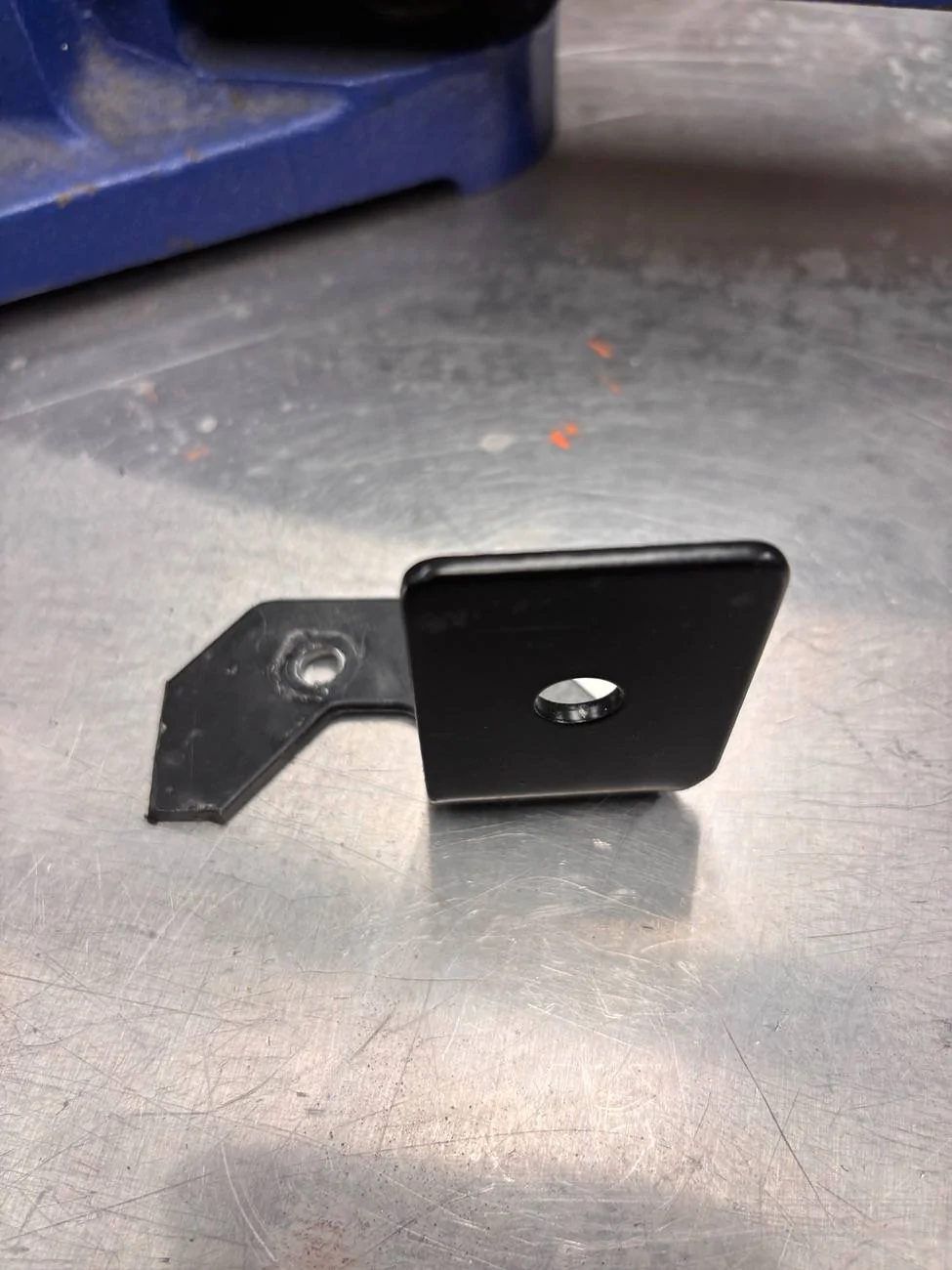

Gotcha and thanks. I was going to use those same holes and just extend using a mending plate with a hole drilled where the mount is centered. Any reason you went with the L bracket instead?
Looks sick. Our cactus trucks are nearly twins. I’ve gotten a lot of inspiration from yours. I’ll post pics once everything is dialed.
I appreciate that man, the truck is sick!
I did the L cause I wanted it to be centered up down left right. Also the bolt that mounts the light to the brackets is like 1.5 inches long so it has to get up a bit. I couldn’t find any A piller style brackets that weren’t like 4-5 inches tall so I tried these guys. Bit of “fabrication” but pretty simple to get it to all fit, would be ideal if I could weld and make a little bracket but this was closest I could find off Amazon. 16$ experiment as oppose to trying anything more expensive

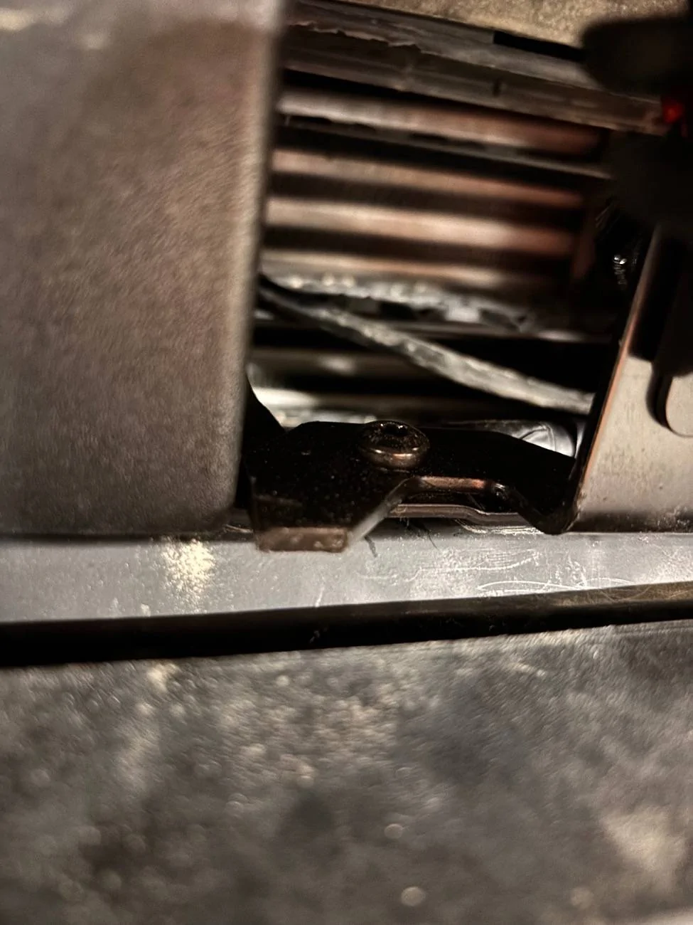

Update on this. Cut the bracket some more so the connection could fit.
This pic is before the Final Cut.
I took about 3/4 inch off the top.

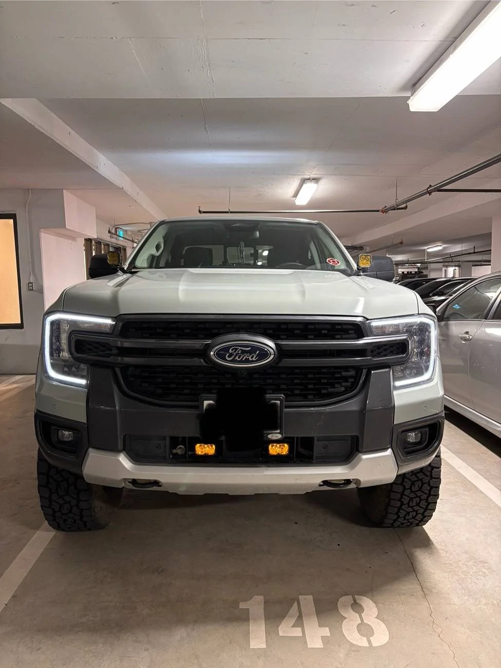

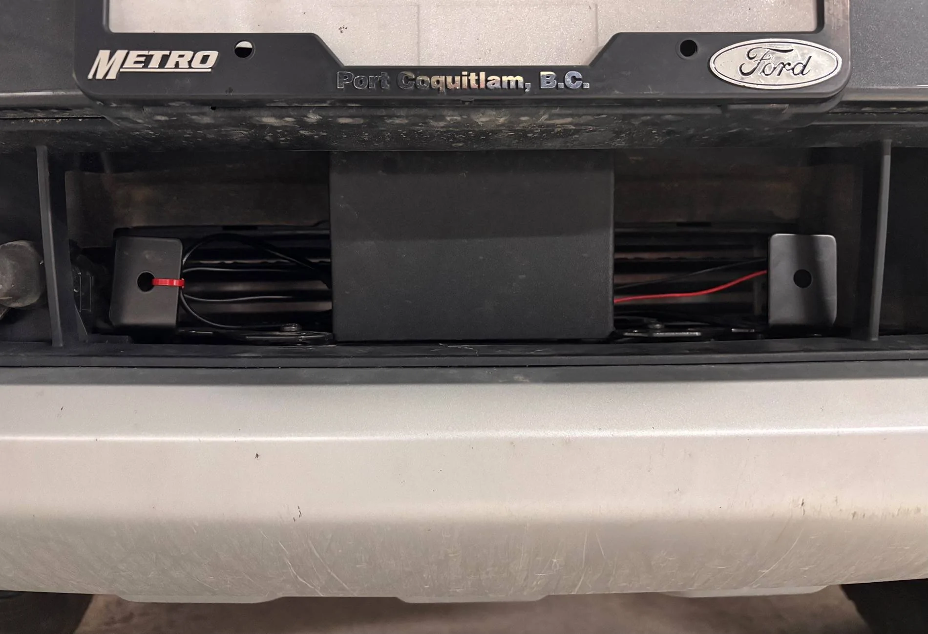

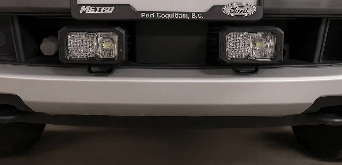

I got the lights in and I’ve been having issues with one of the pods main beam and a backlight flicker. Luckily the company I ordered from has great customer service and a replacement pod is in the mail. I’m the mean time I was able to shove a zip tie inside the side of the connector to make the backlight work at least but still no main beam.
Turned out exactly as I planned. Can’t wait to get the replacement! I’ve attached a few pics to show mounting locations and such for others.

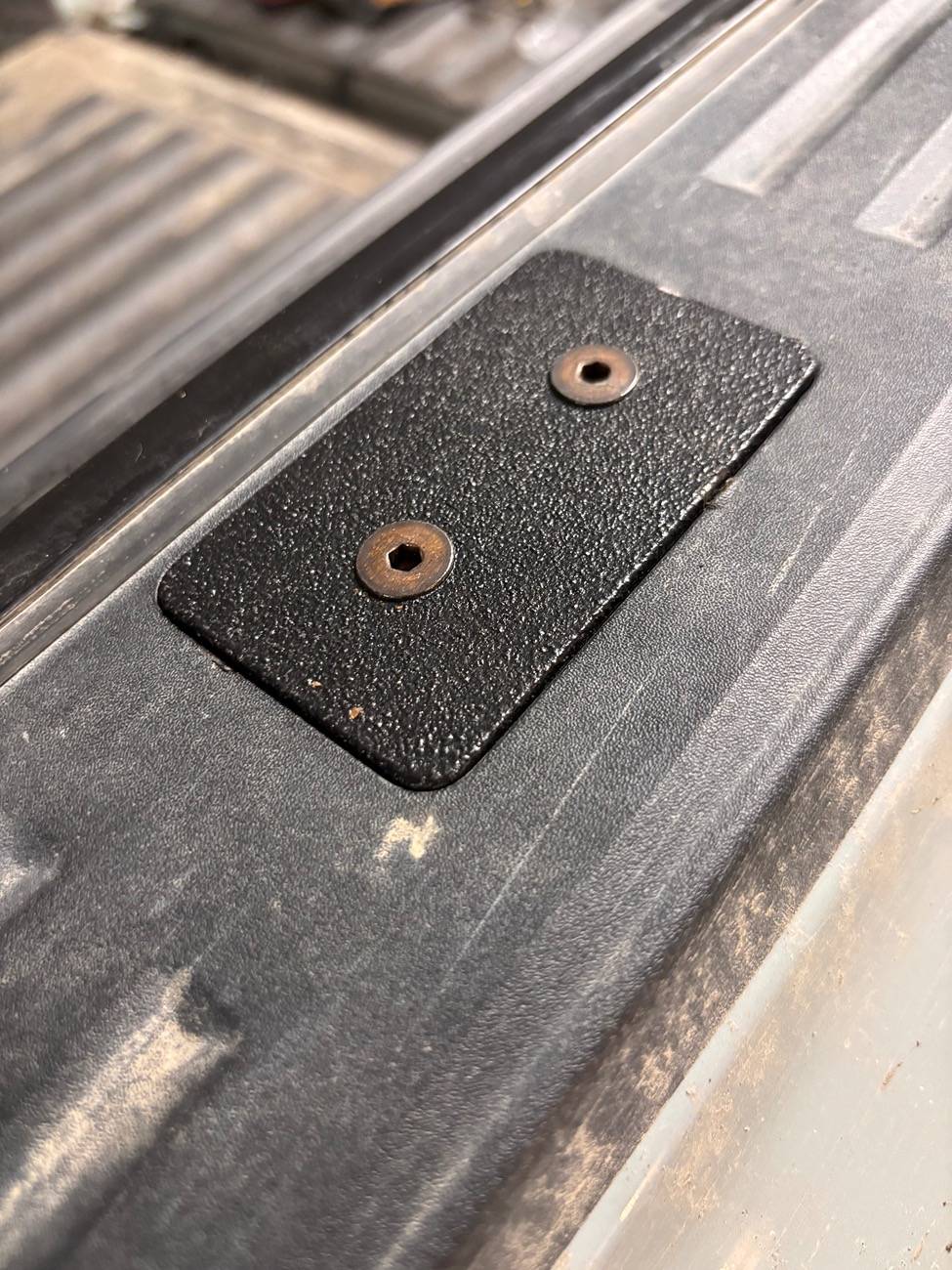

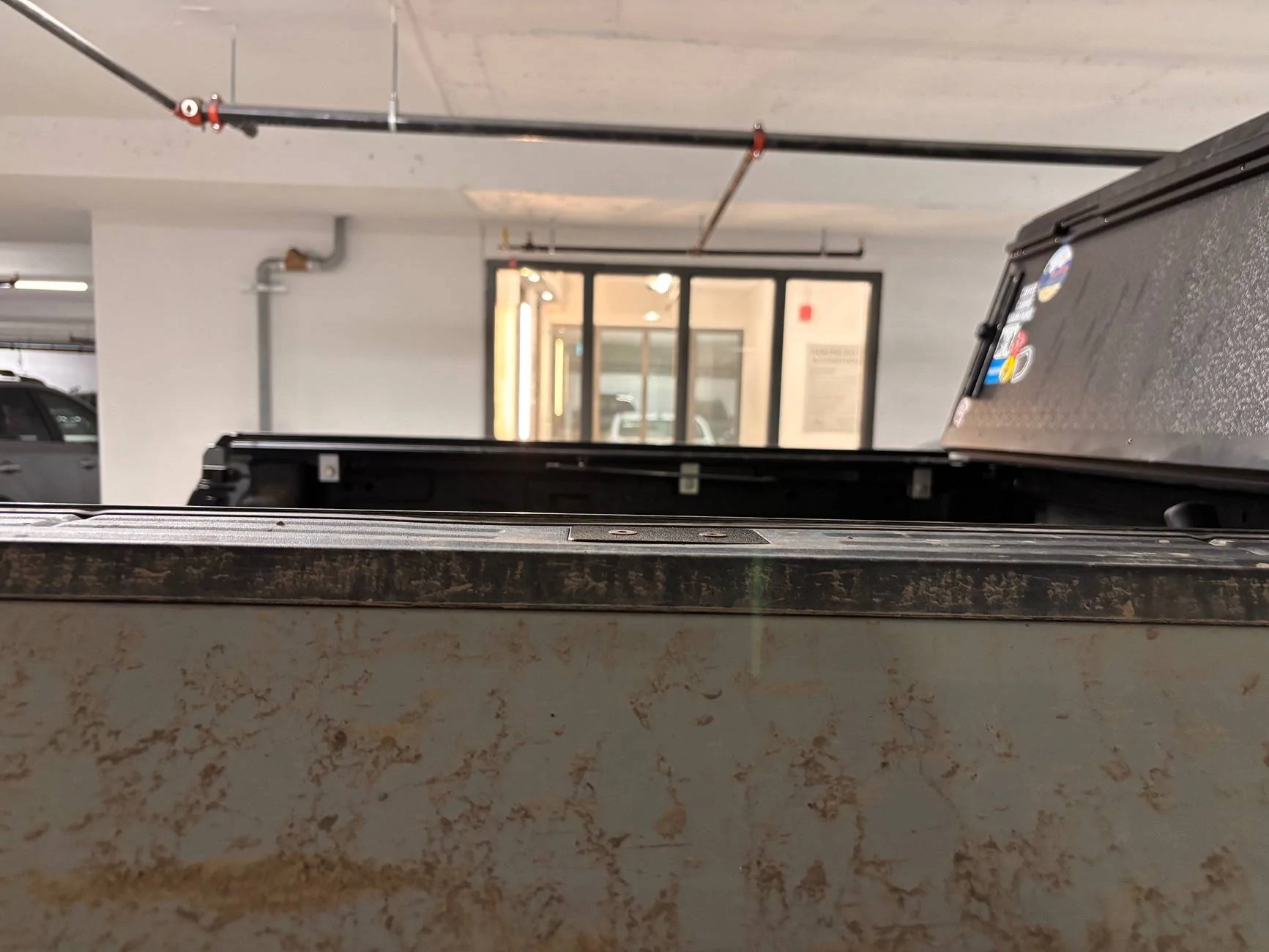

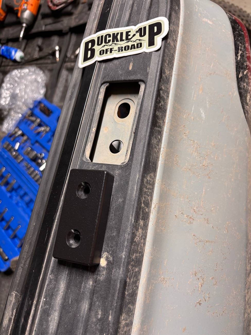

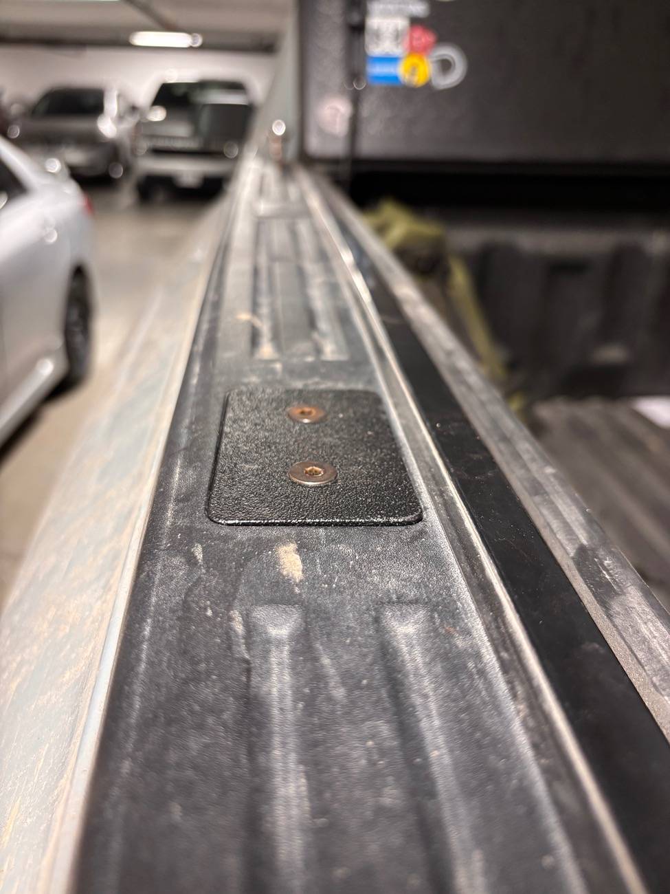

Installed the buckle up bed cap spacers today as I have a bedrack coming next week. Solid product to fix the hollow bed cap spots. They sit pretty flush except for the middle one.. cause apparently my bedcap is already slightly bent. Good peace of mind for the bedrack mounting though.

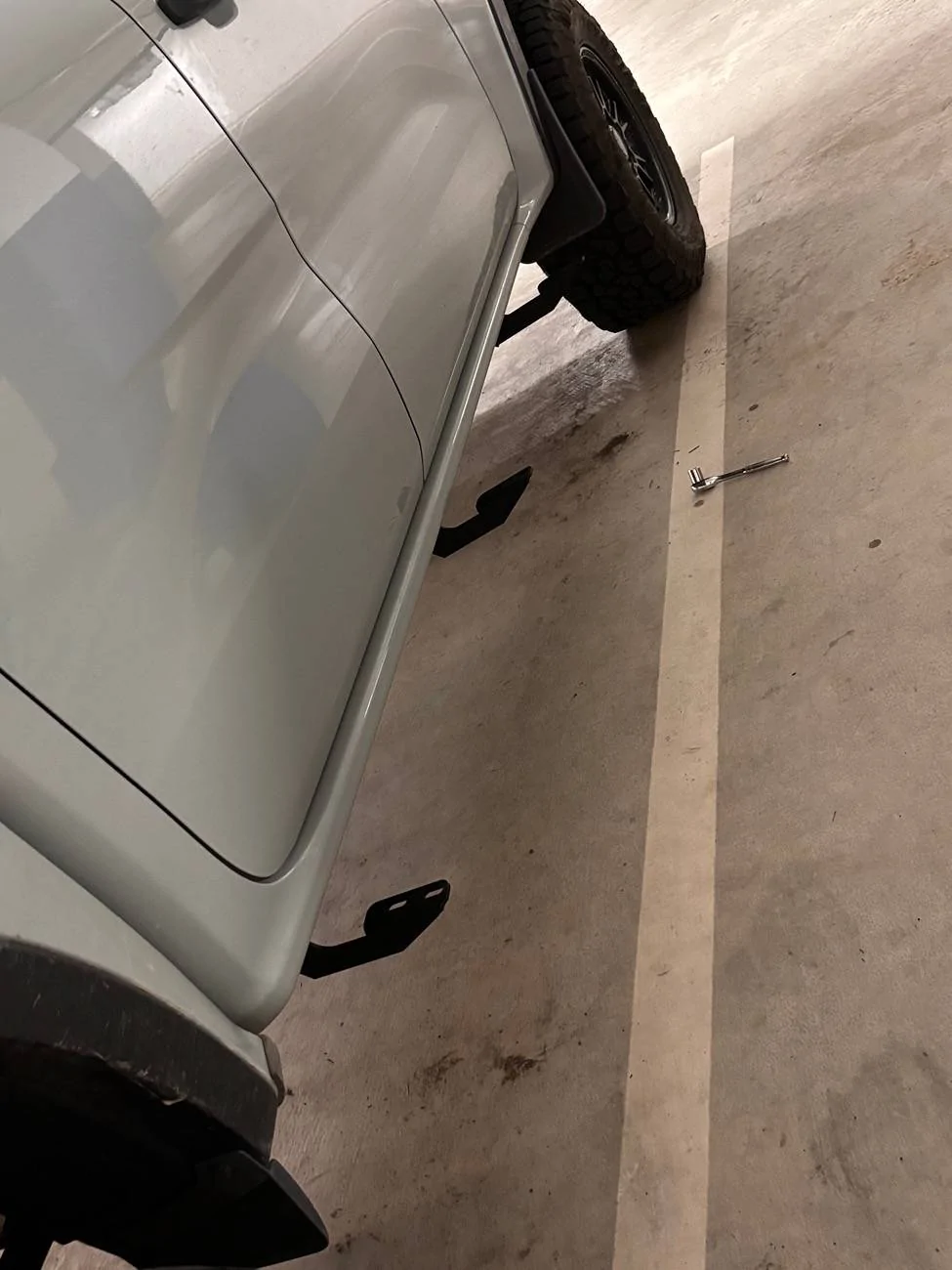

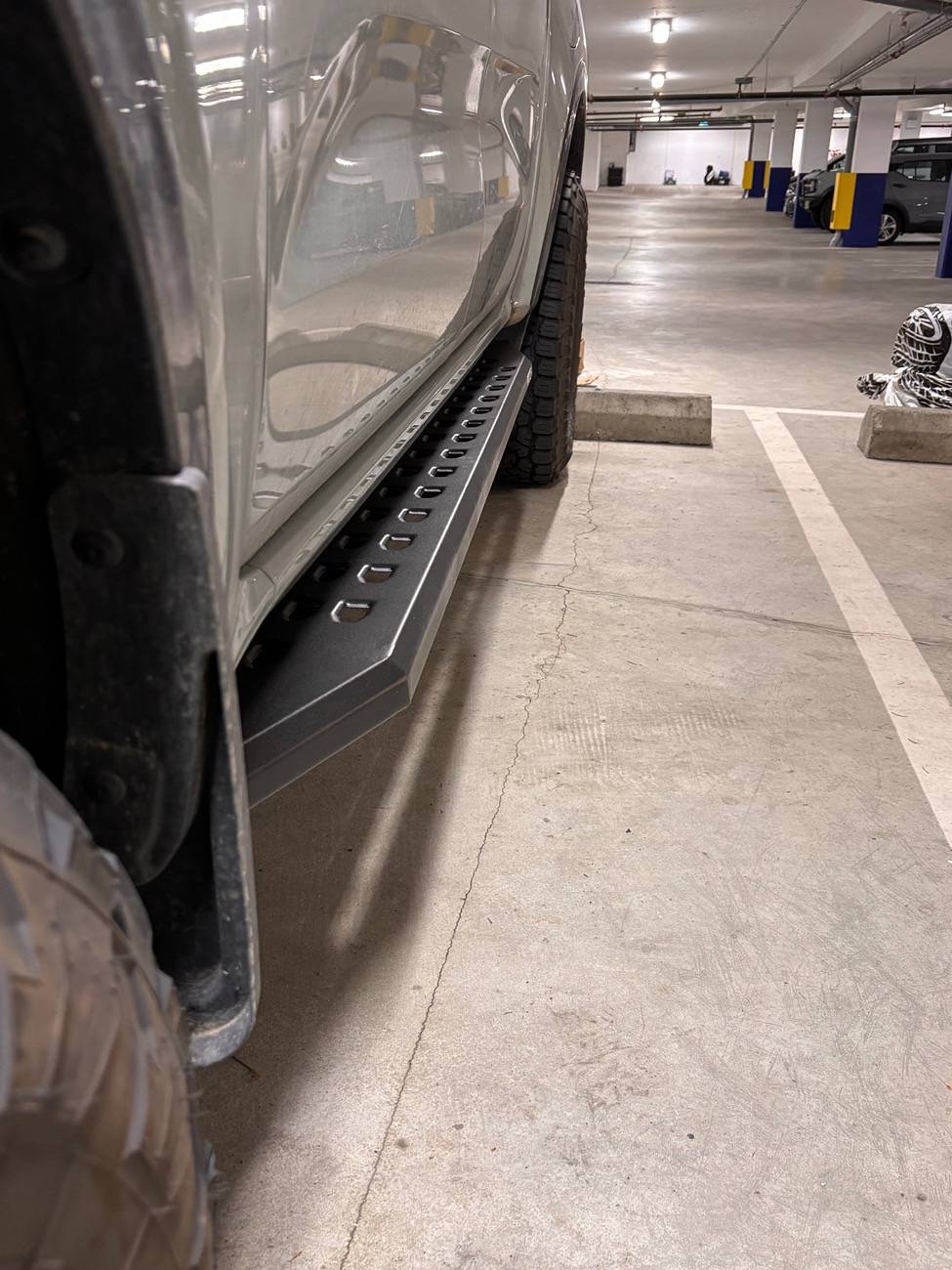

Went for the RB20 Slim side steps.
Fairly easy install minus the instructions in a different language.
They fit up nice and tight, I wish it would be even tighter, so I may see if I can add a plate on the bracket to left them up 1/4 inch or so.
Overall think they look great, and very sturdy!

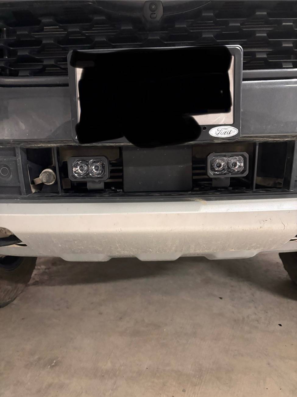

Next is an idea I’ve had for a while. I’m going to put 2 diode dynamics SSC2 spotlights in the bumper. I found some UTV pod light brackets that fit beside the ACC sensor. I’m going to drill a new hole and cut them a bit to get them closer to center the lights, but I think it’s going to look sweet. Went with the SSC2, White spot light, amber backlight which I will tap into the marker lights.
