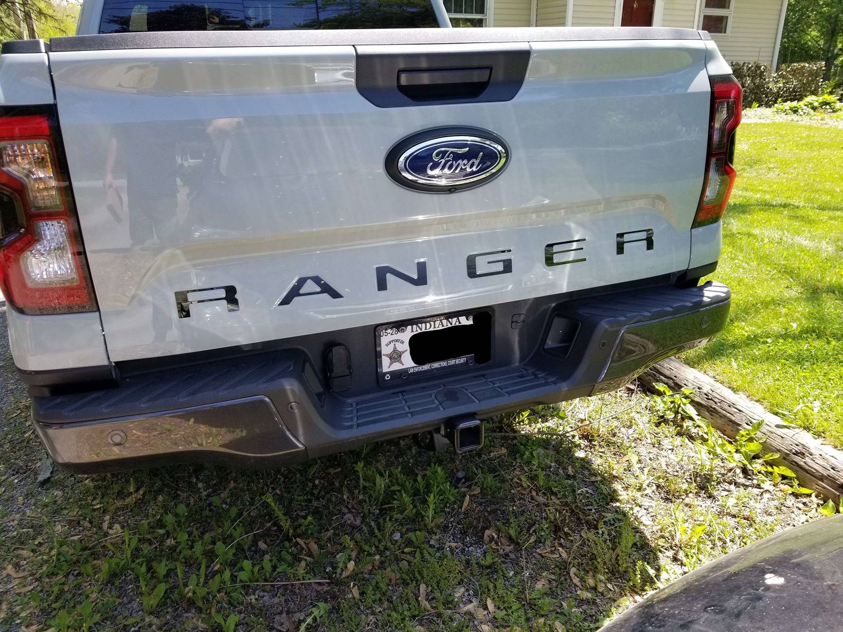

Just redeemed some points to get the tailgate lettering. Looks better then I thought it would!

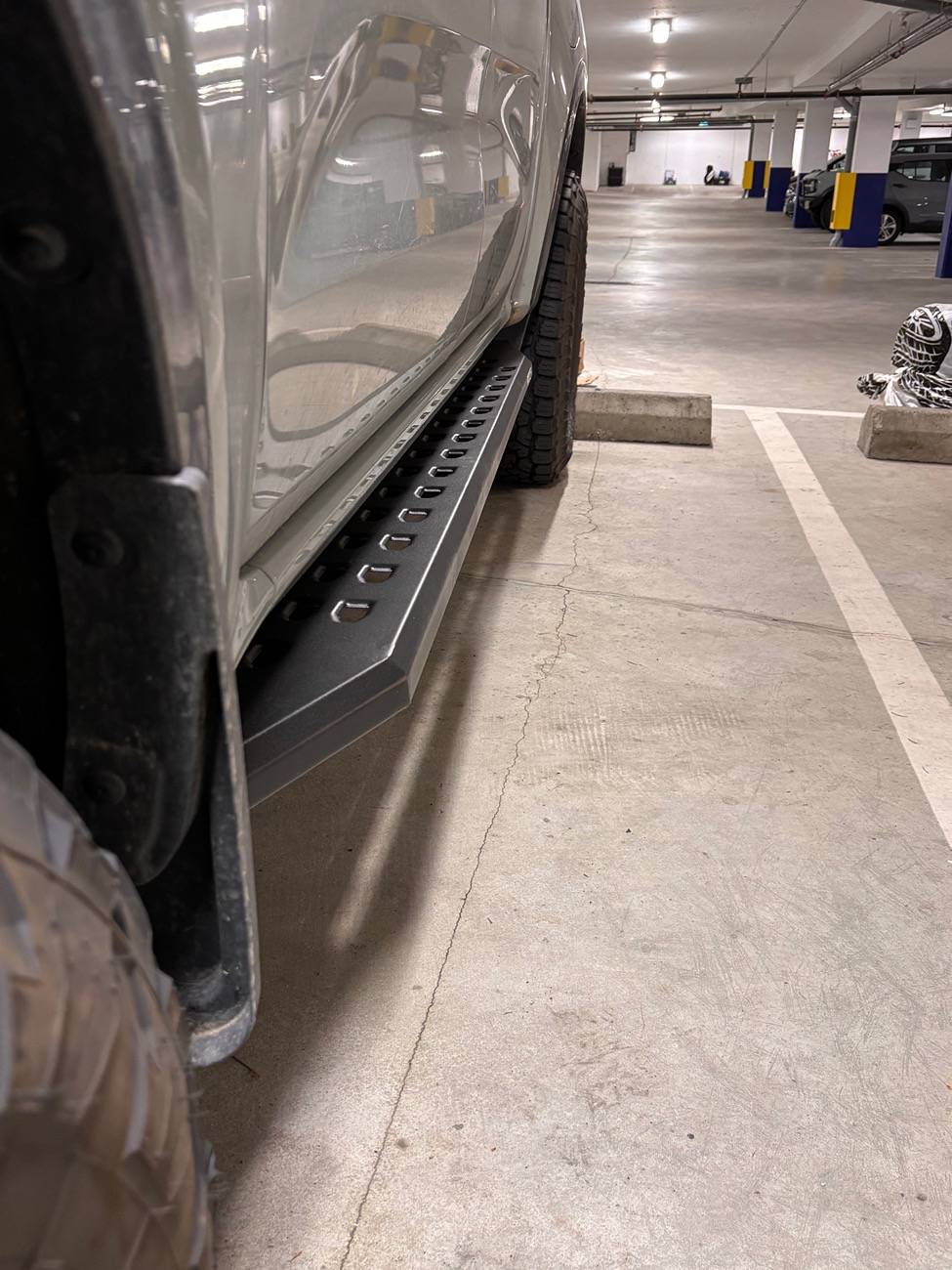

Some new stuff added.
Went for the RB20 Slim side steps.
Fairly easy install minus the instructions in a different language.
They fit up nice and tight, I wish it would be even tighter, so I may see if I can add a plate on the bracket to left them up 1/4 inch or so.
Overall think they look great, and very sturdy!

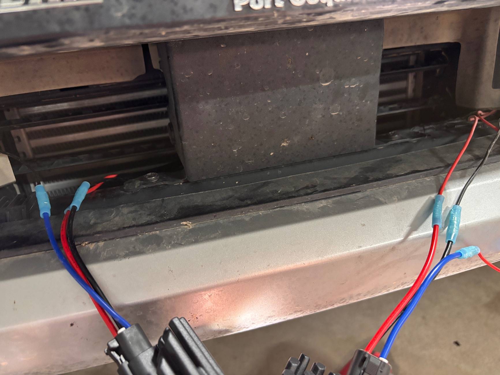

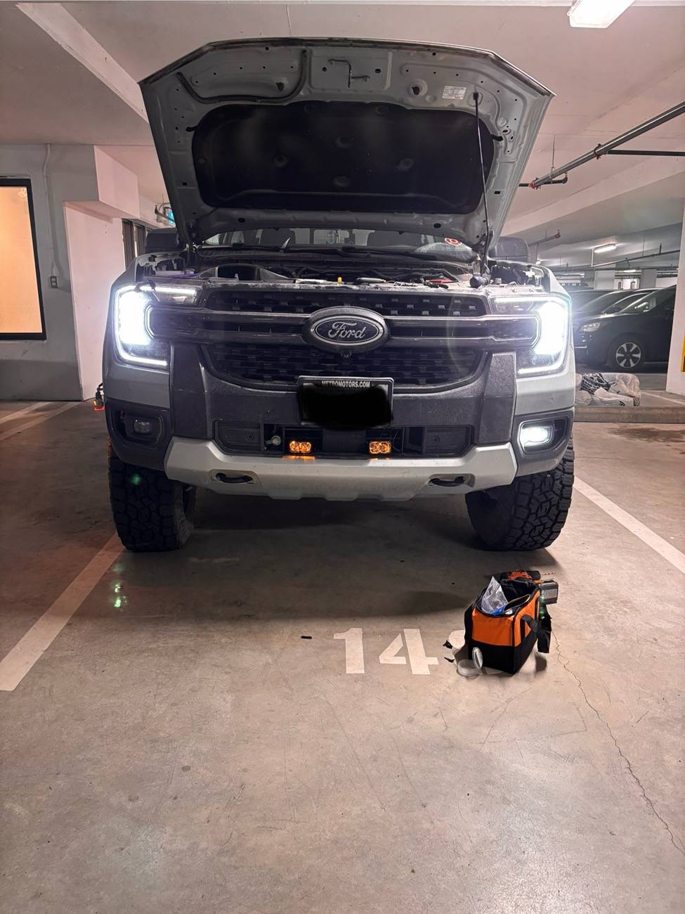

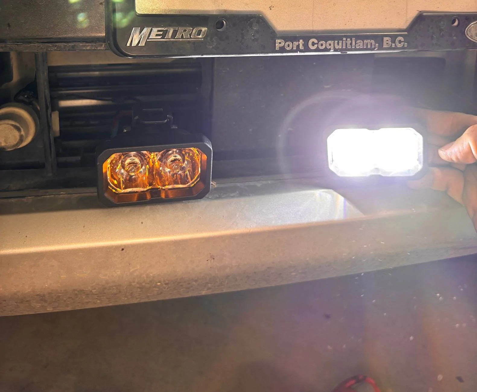

Next is an idea I’ve had for a while. I’m going to put 2 diode dynamics SSC2 spotlights in the bumper. I found some UTV pod light brackets that fit beside the ACC sensor. I’m going to drill a new hole and cut them a bit to get them closer to center the lights, but I think it’s going to look sweet. Went with the SSC2, White spot light, amber backlight which I will tap into the marker lights.

How much more tuck/clearance do you get with those running boards vs. stock? Do they mount to the frame or the oem mounts? I know they offer a bedliner finish vs stock. Assume yours are stock - are they slick at all? Was going to get the 5” boards.

They mount to the OEM spots. They still feel super solid though, not a slider by any means but would probably take a bit of a hit. These tuck up a lot more than the OEM ones. I’d say they are in line with the bottom of the pinch weld. However, the brackets do hang down a little
AI mockup
Any chance you have a link to those brackets or close up pics? Was going to mount some lights there too and finding something off the shelf would make my life much easier!
Did you have to remove the grill or bumper to get at those bolts or could you leave it all assembled?

I didn’t have to remove the bumper of anything. I used the 2 existing bolts that hold the ACC sensor down.
I did have to do some modifications to the brackets though so the light would be center, and shoot straight. Basically the opening is 5 inches wide, and to line the light up you’d need the screw hole to be about 1.5 inches from the mounting hole for the light, as the screw is 1 inch from the sensor. The bracket itself is fairly long so I cut a few inches off with a grinder.
I’ll get ya the link and some pictures in a bit here. In the process of getting the lights on but having an issue with one of the pods…..
Gonna be sweet when complete though!
