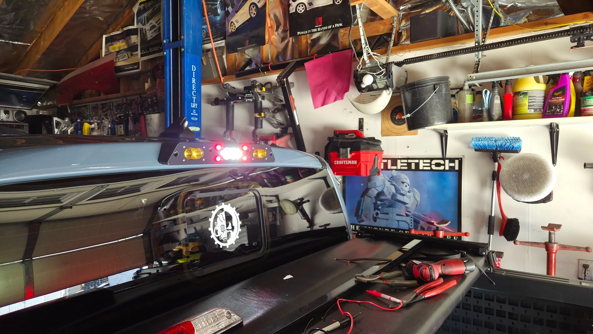

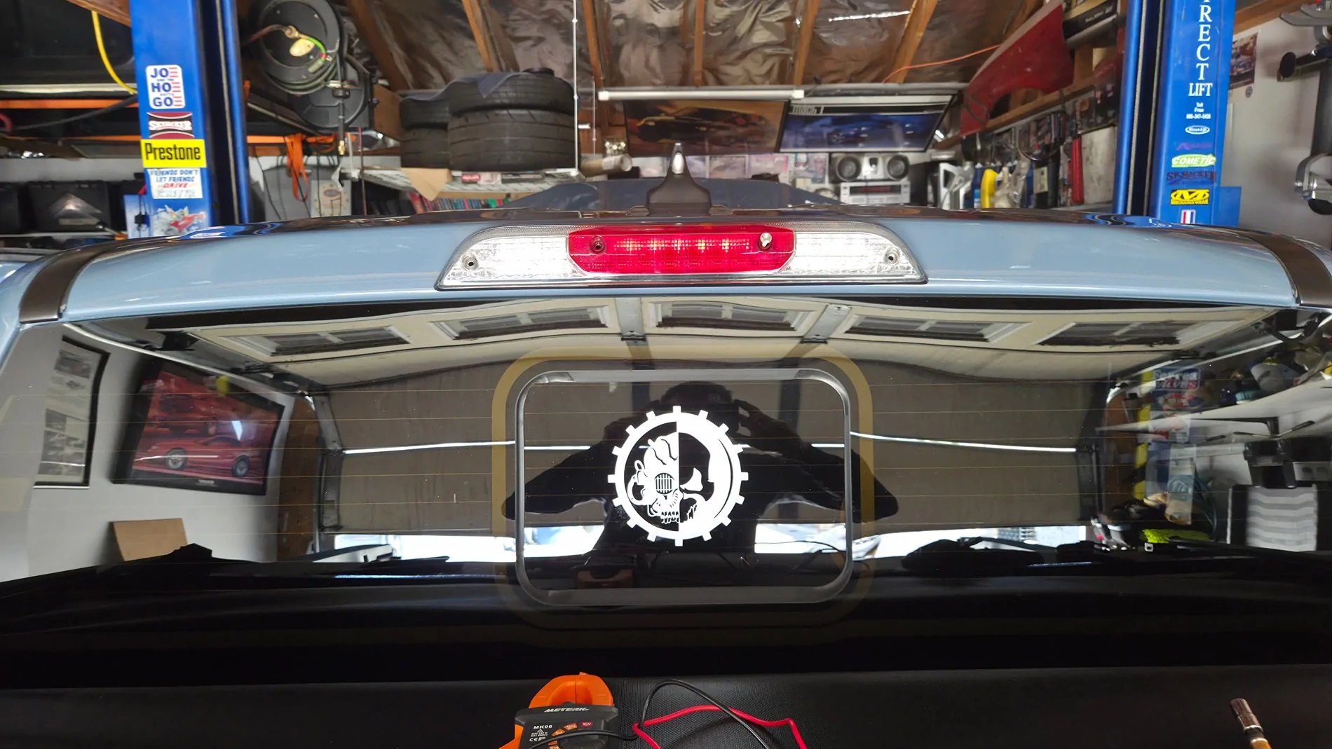

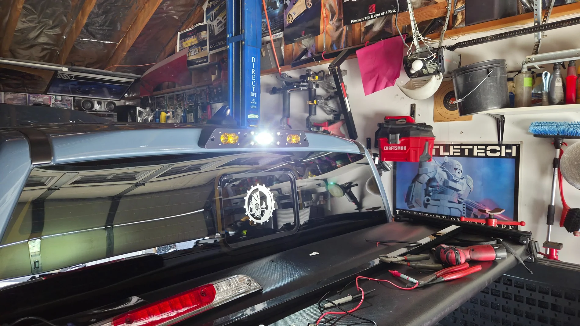

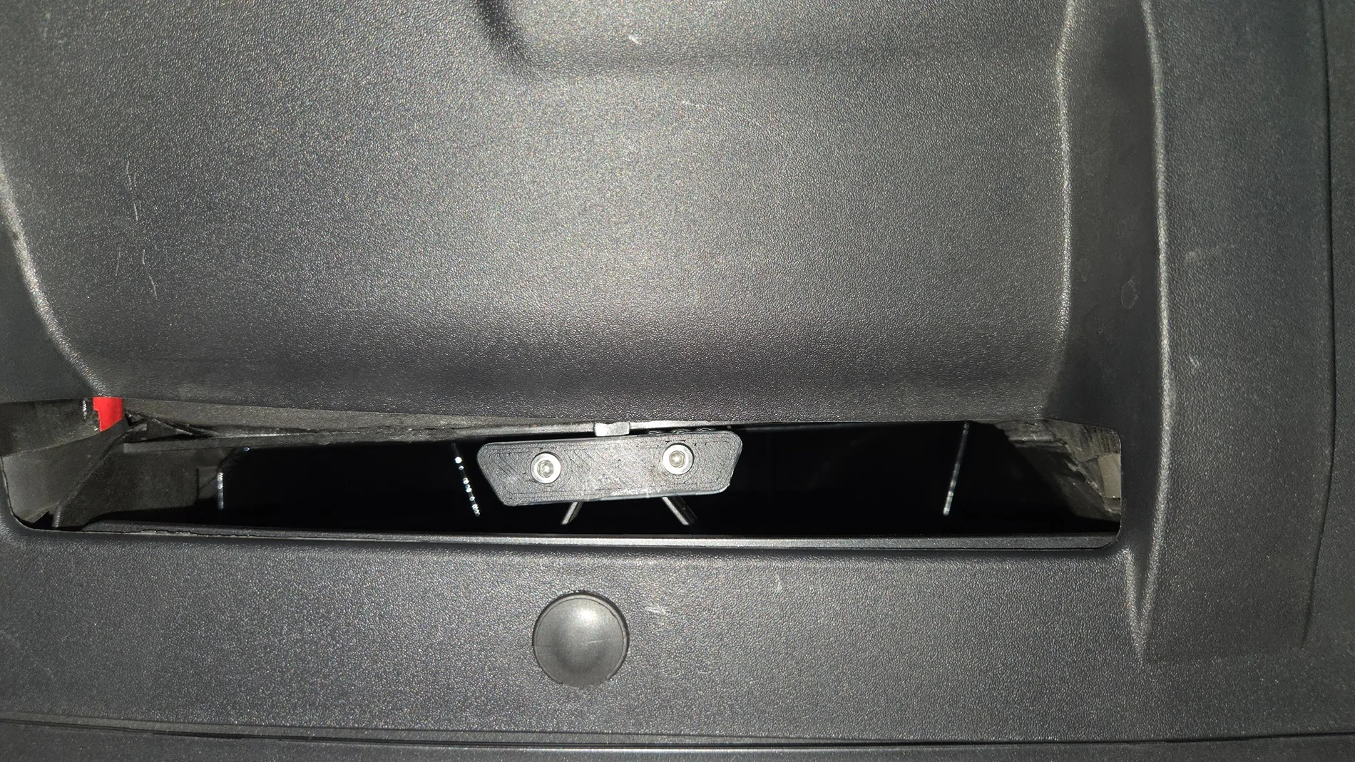

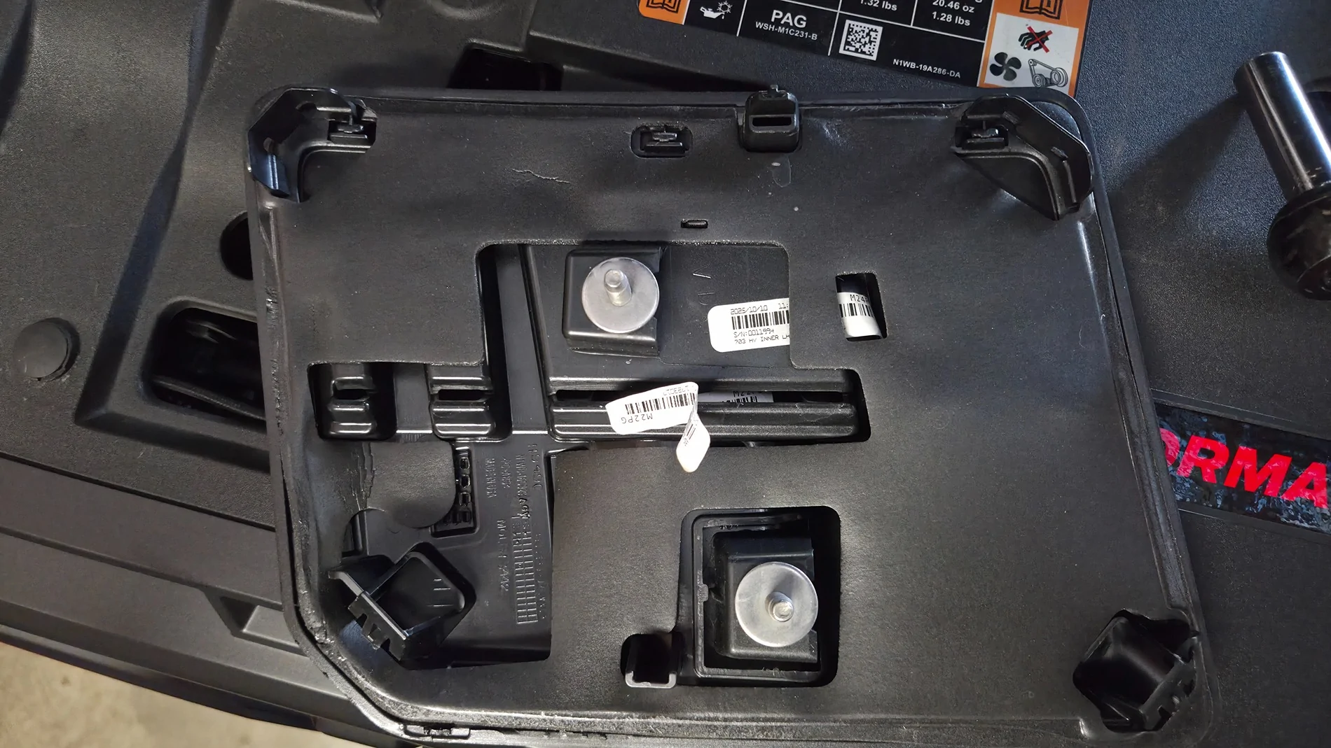

Integrated third brake light chase lights.
the light looks real good did it come as kit ? I did the glovebox light works real nice it should have come with it
what is the make/model of the 3rd brake light
thanks in advance!

It's a 3D printed unit complete with the lights. It's a pretty cheap setup but it does stick out quite a bit. I can't say compared to other ones or there but I'm guessing it's similar in size. The optional gasket they sell doesn't look like it seals a 100% so, I'm going to add a foam style one as well. I might even see if that alone works better.
https://printineeredlightingco.com/products/2015-2020-f-150-third-brake-light-chase-light

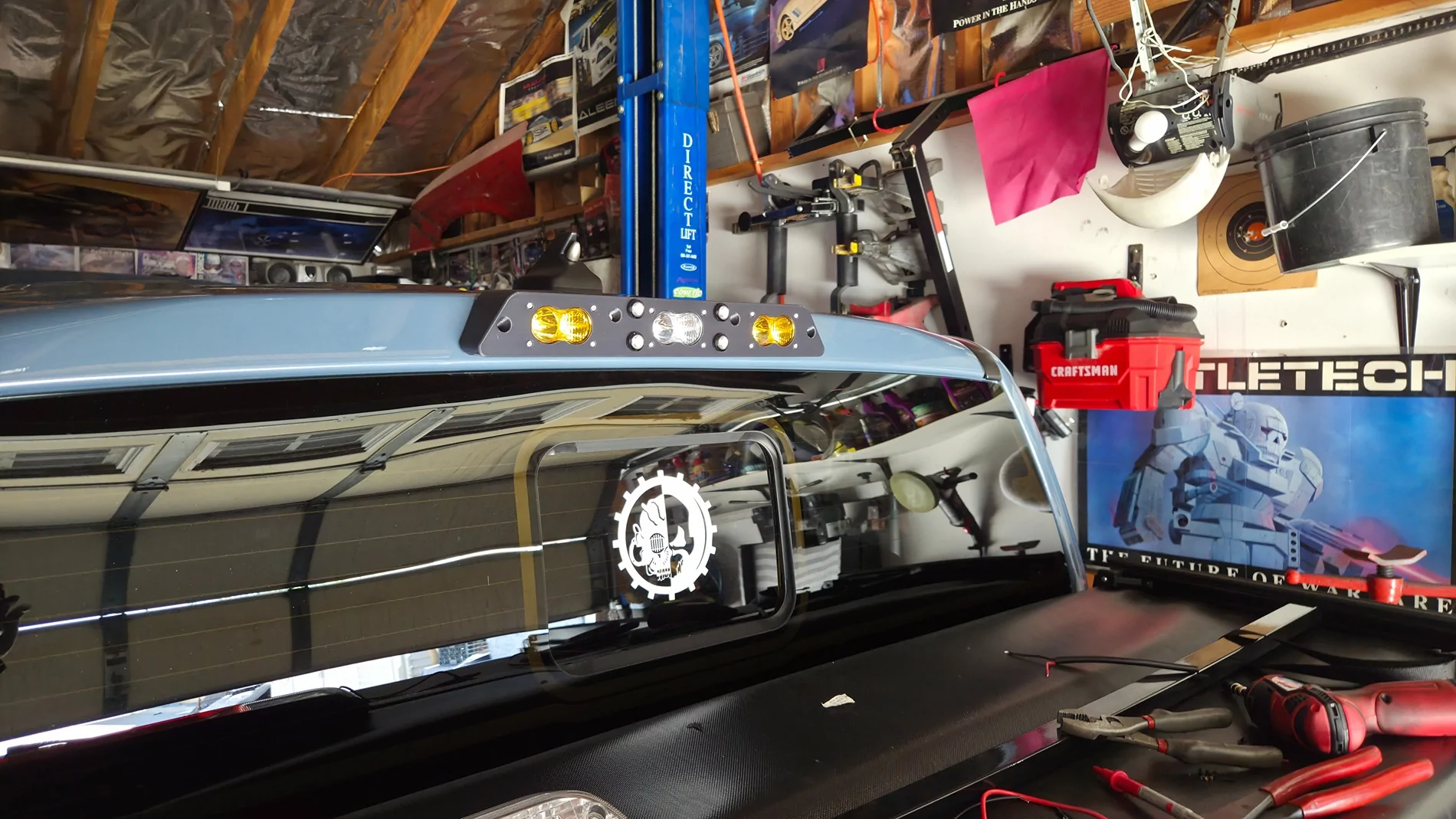

Lumens/candela/watts etc. what are the specs? Not listed on their site. They look like BD’s.
OK, I don't know. They are pretty bright even in daylight is what i can tell you. I'm pretty sure if you reach out to them they could tell you.

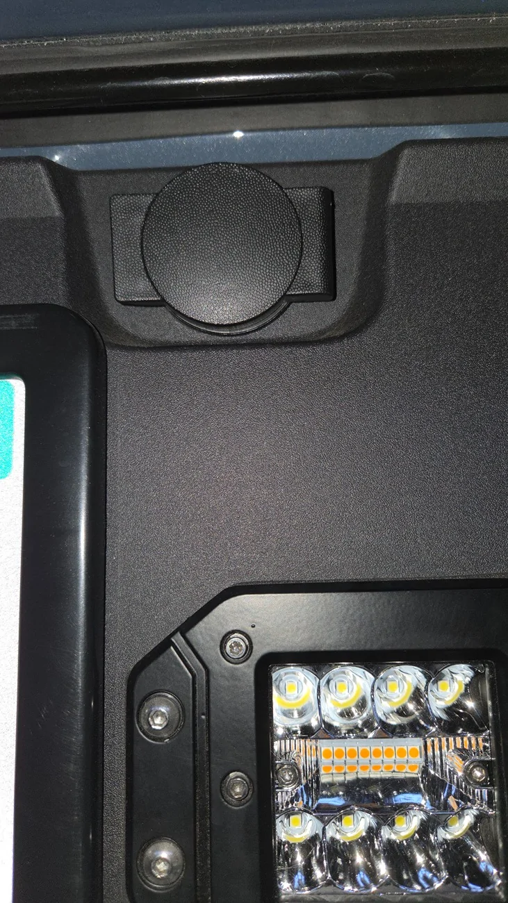

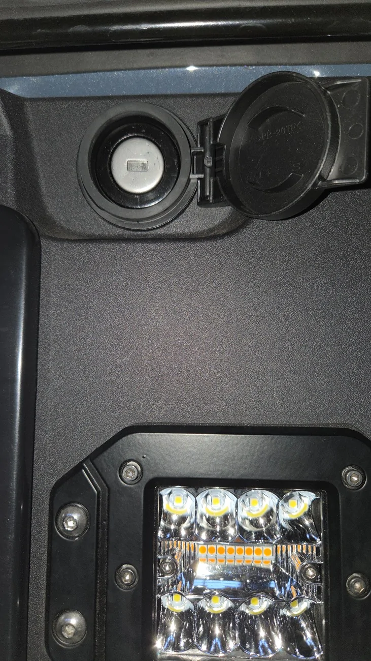

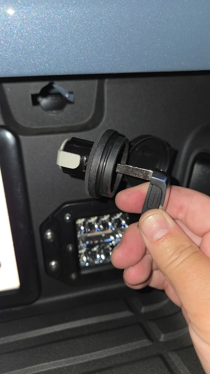

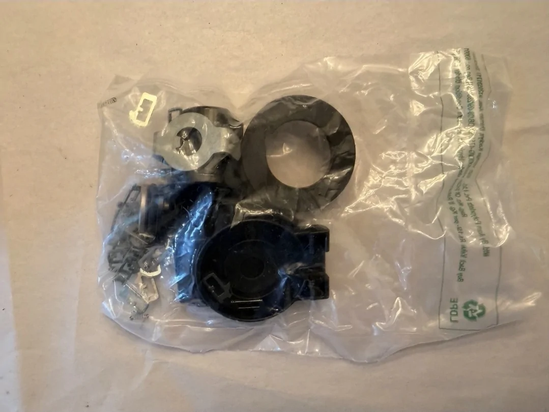

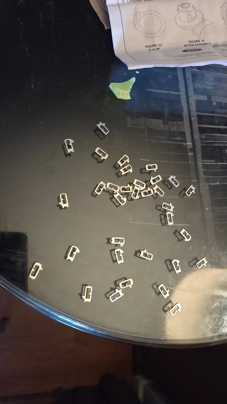

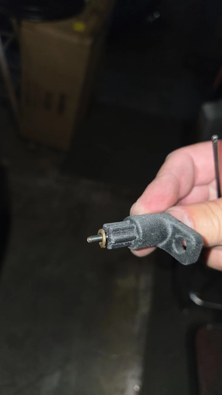

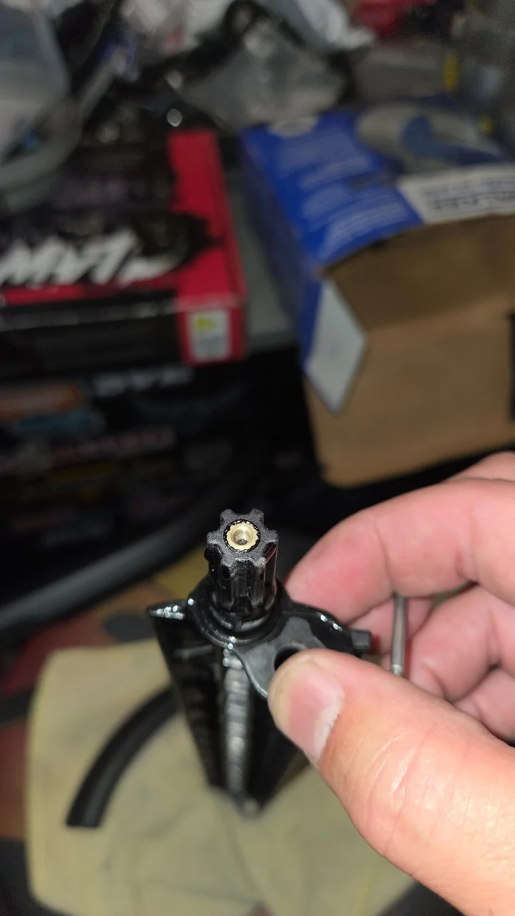

Found a rare key it yourself spare tire lock set. You can only find one that come pre-keyed with another key instead of using the one already in your key fob. Now i know how to key these lock cylinders.

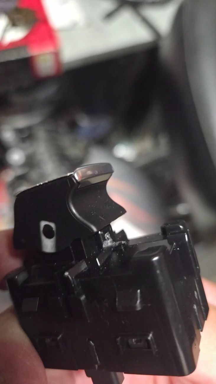

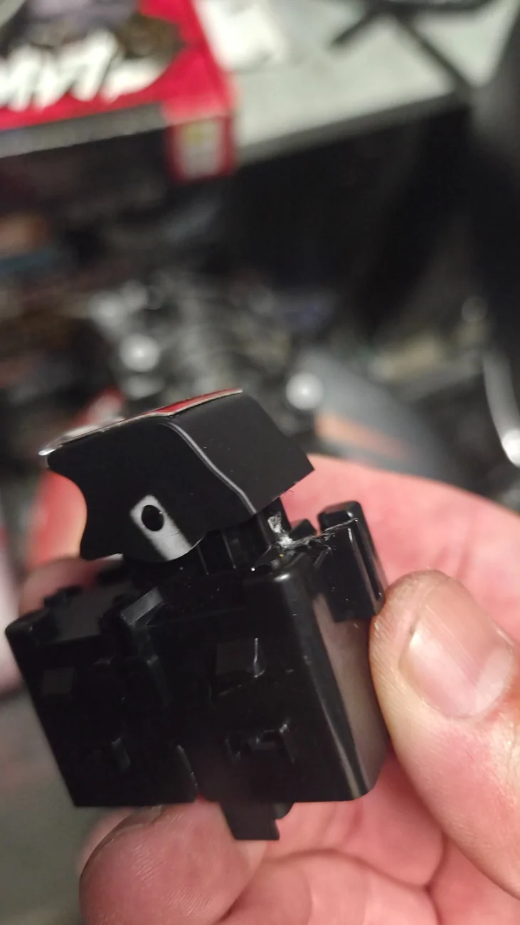

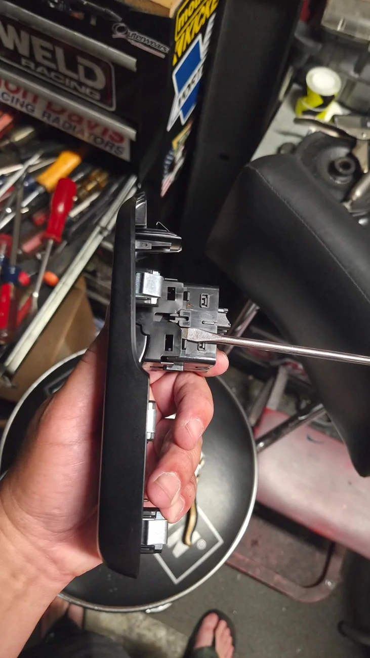

Credit to @Gman10 for discovering the one touch auto windows for the rear was just removing the stops on the switch. I was able to do it without removing the switch covers. I went all the way and did the rear switches as well. You use a screwdriver to pry the 4 retaining tabs while pushing the switch in for the rear. The front is held on with 3 small torx screws.

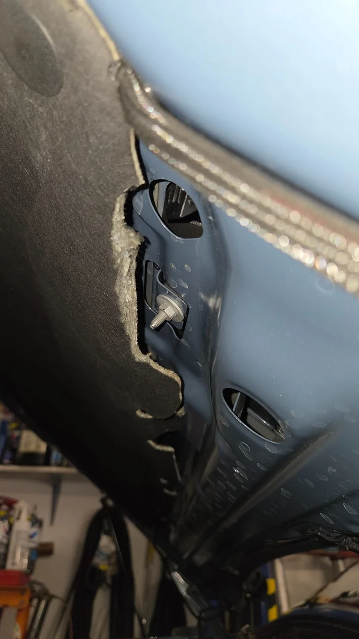

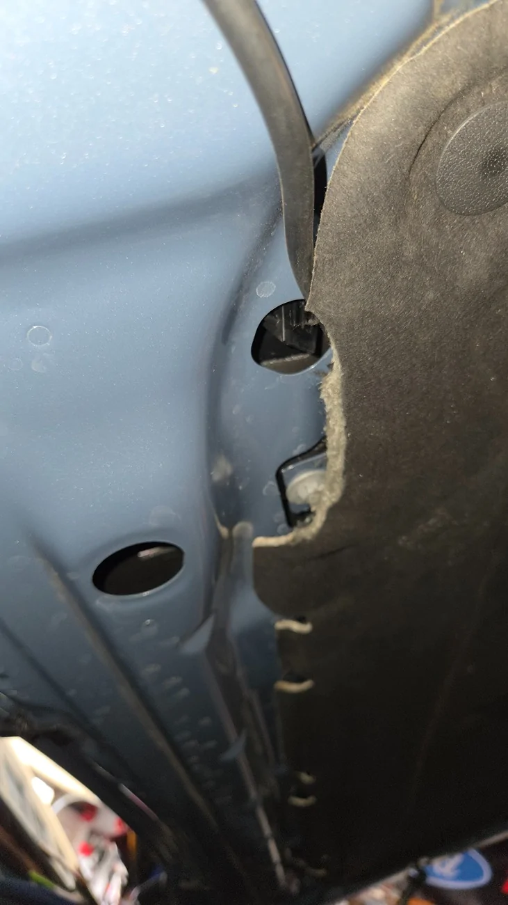

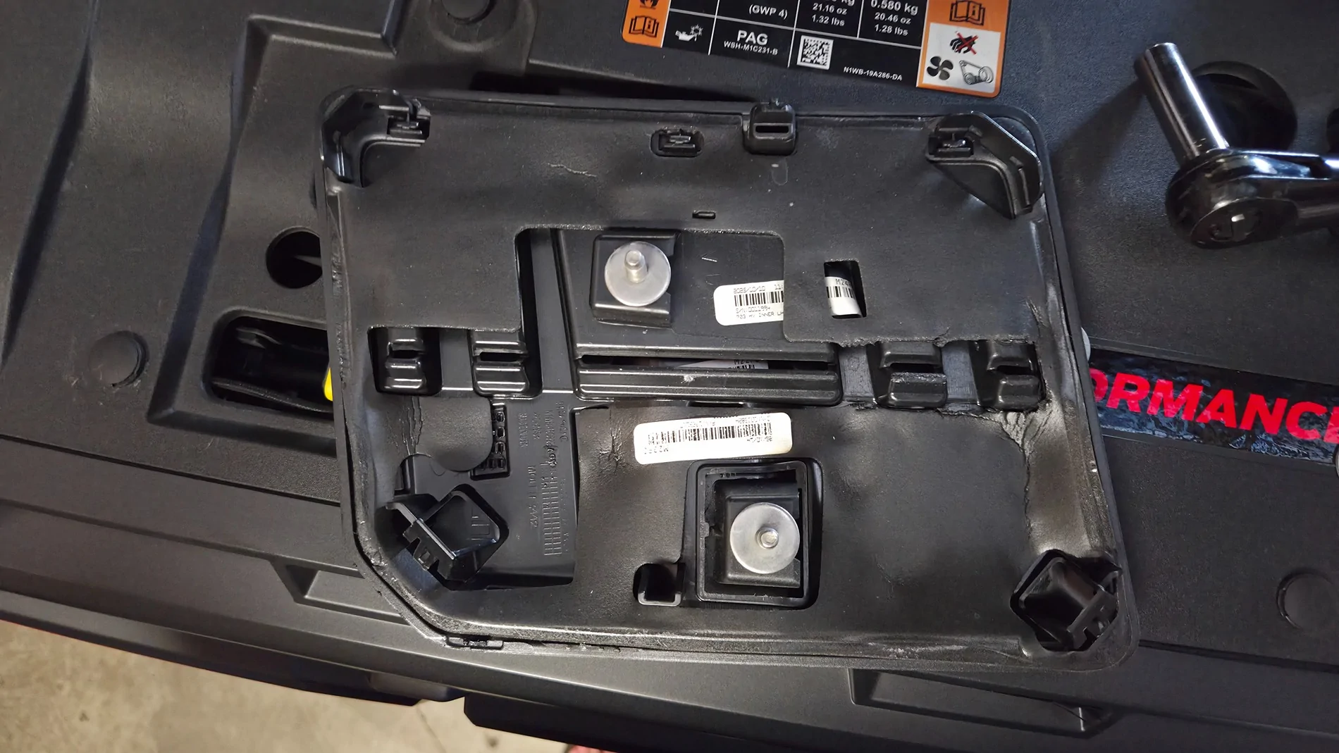

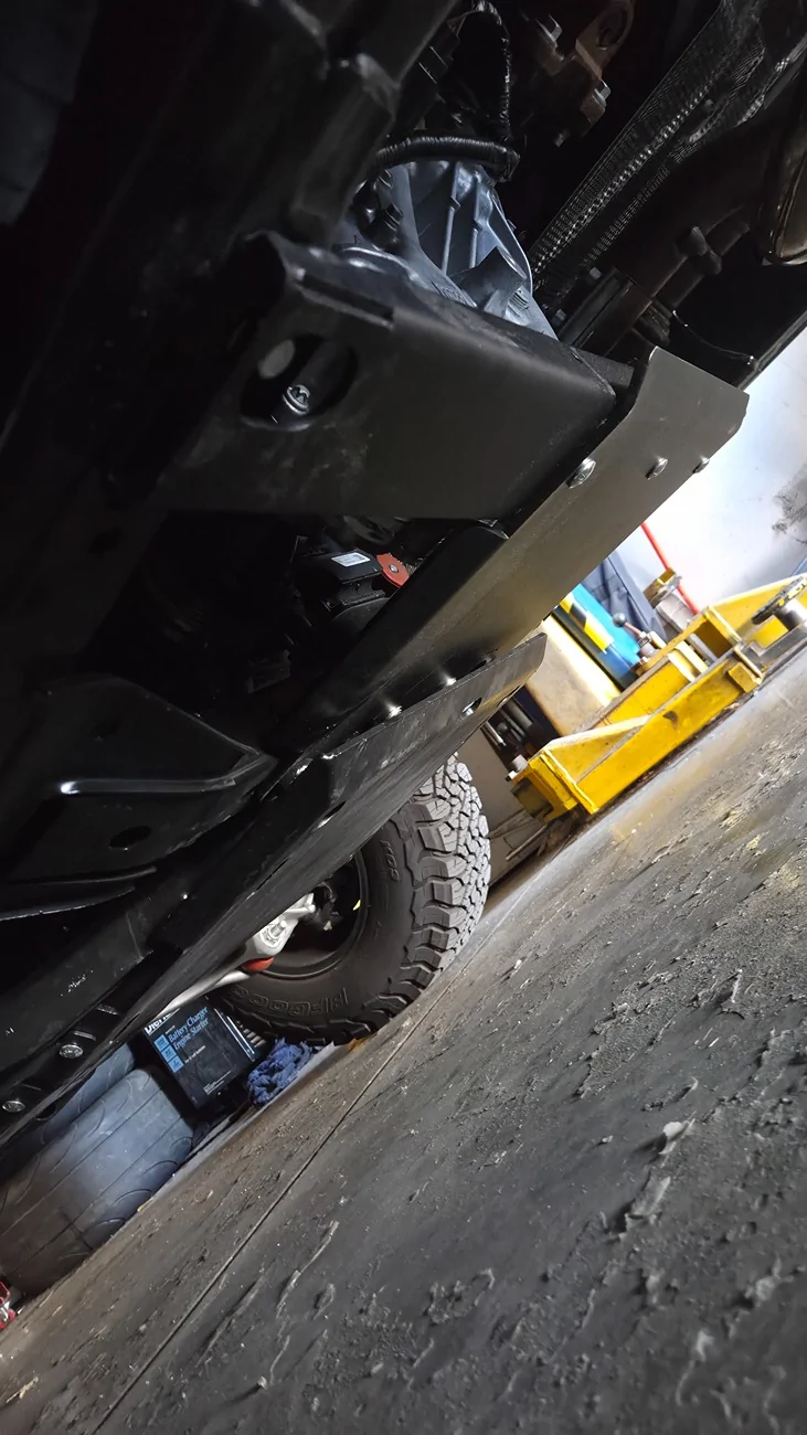

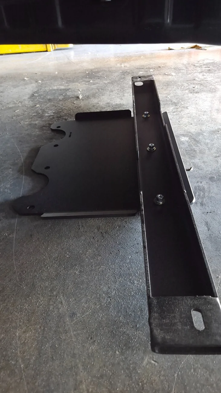

Already knew the hood heat extractors were functional but turns out a quarter of them are blocked by the foam. Opened up the hood liner insulation to help more of the heat get drawn out of the engine bay without any water intrusion.

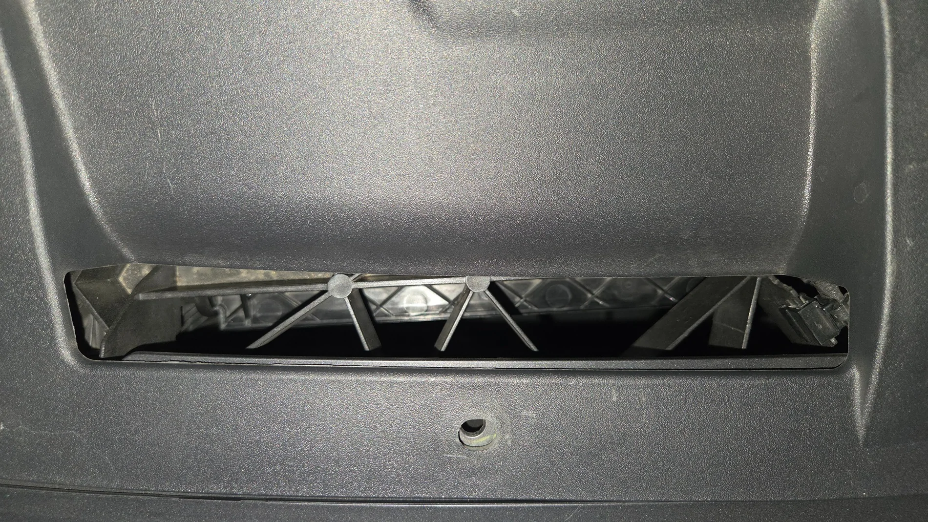

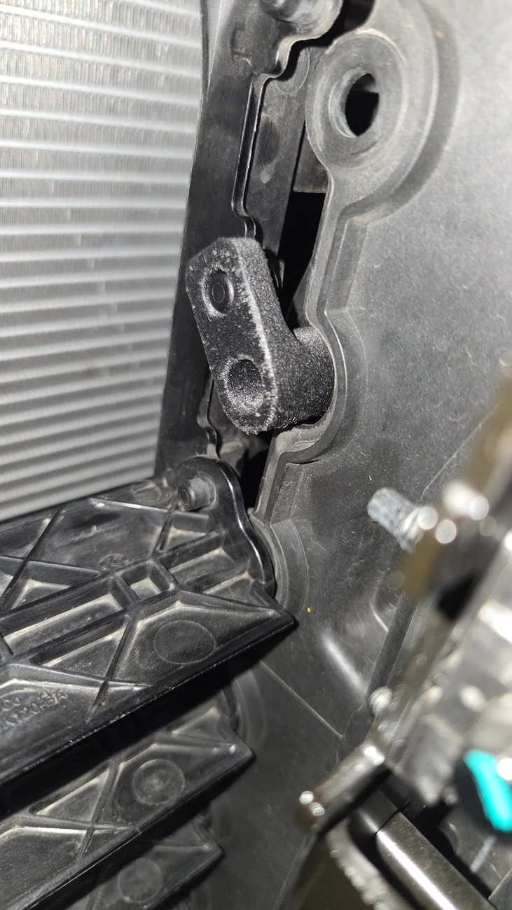

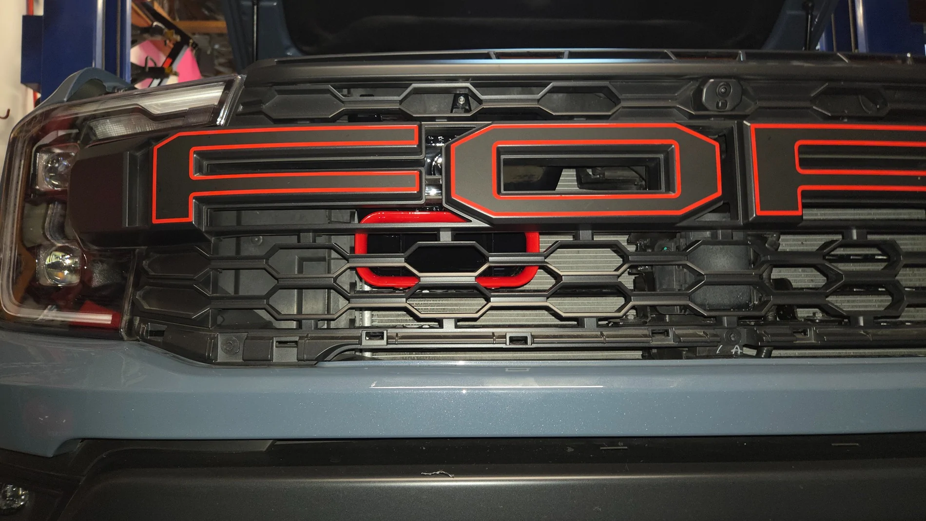

Velossa Tech Design Intake Scoop. Removed a few of the reinforcements to remove obstructions. Added some weatherstrip to seal and keep the air more directed to the intake. Added a couple washers to the shutter simulator so it doesn't bind and allow for free opening and closing of the shutters. This should lower the intake box temps and possibly increase mpg a bit like on my last Ranger and Fusion.
