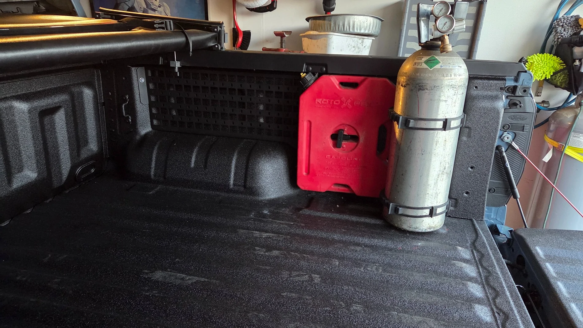

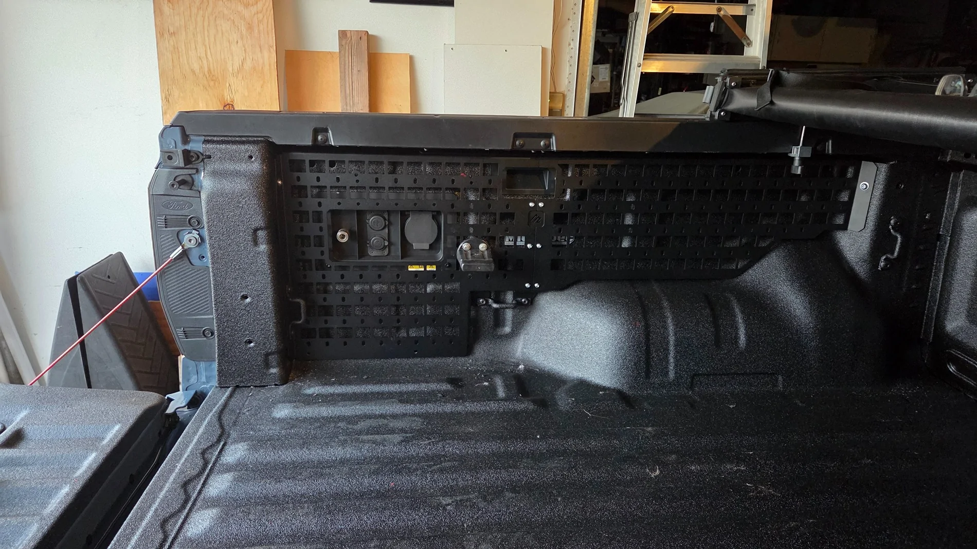

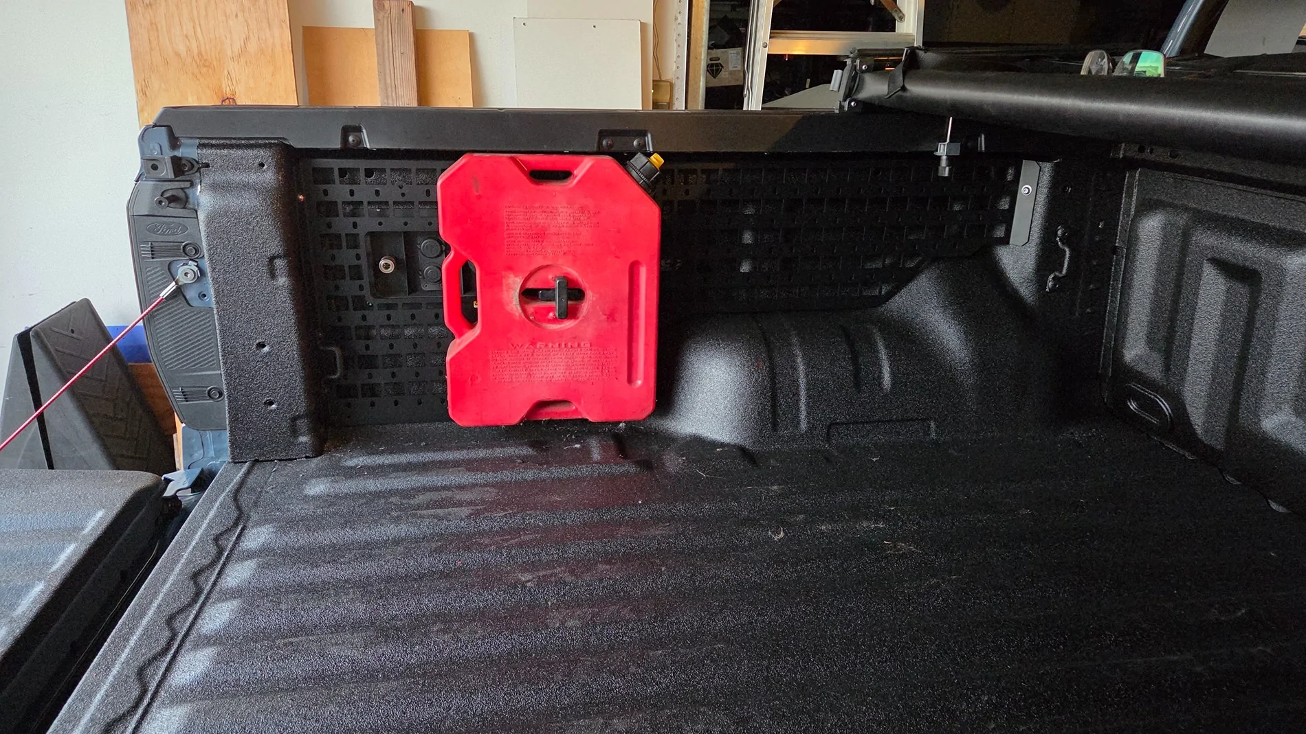

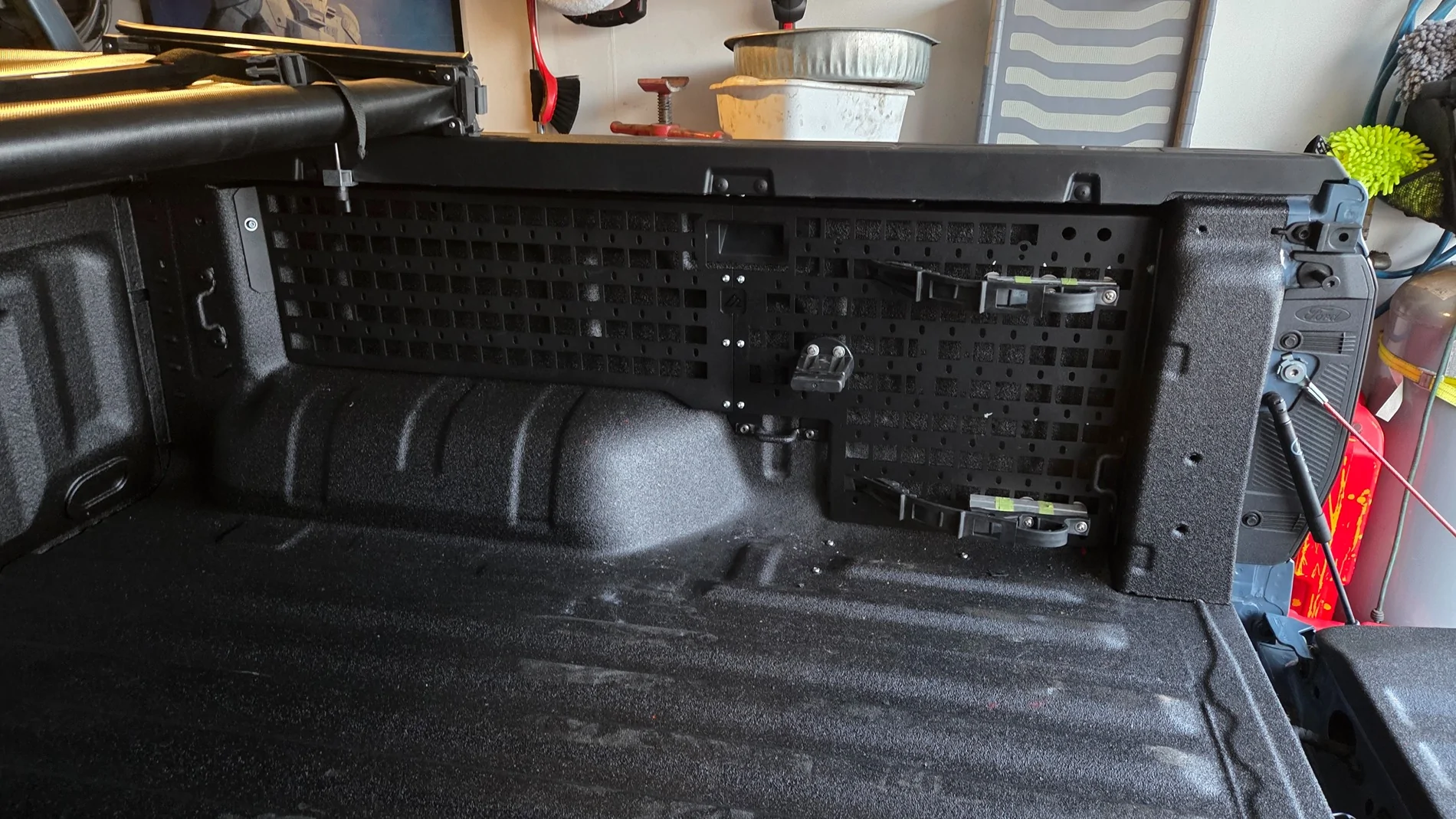

@AdventureLab Molle panels installed. Mil-Spec were kind enough to remove the tie down hooks for me. Fuel pack and CO2 tank mounts installed.

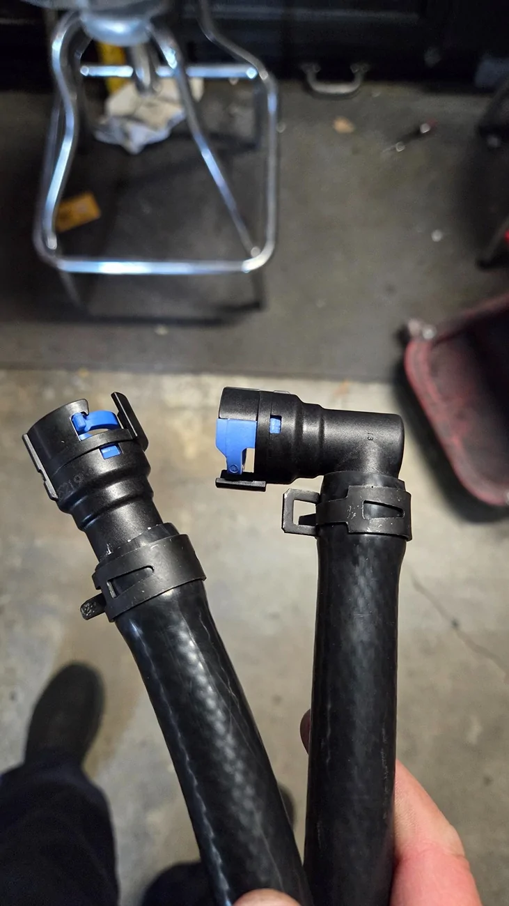

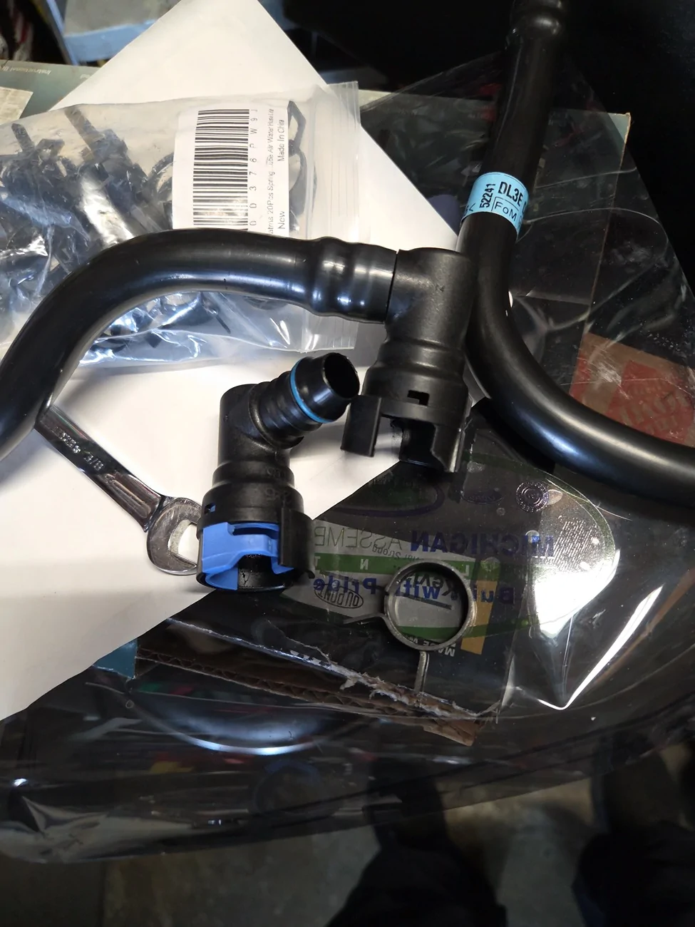

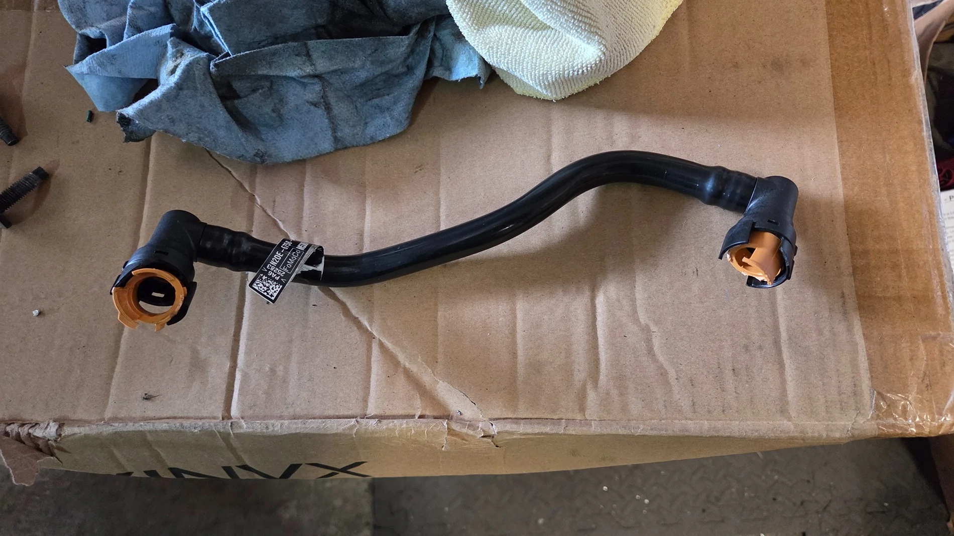

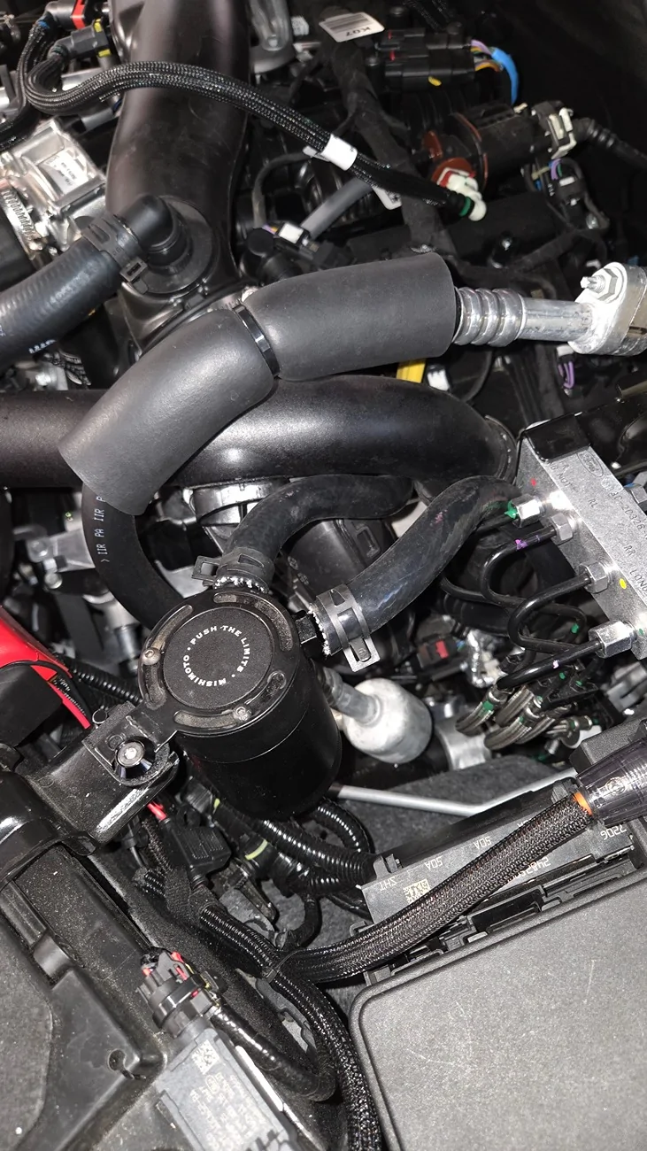

Clean side oil catch can. Had to remove the one time use crankcase line and replaced work PCV serviceable fittings.

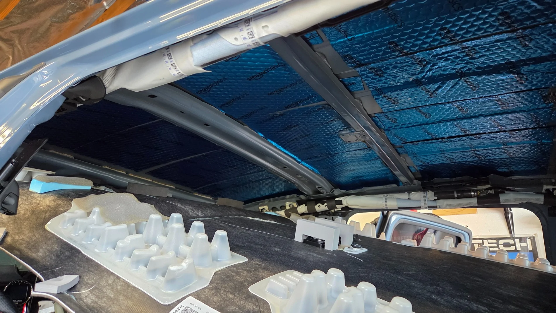

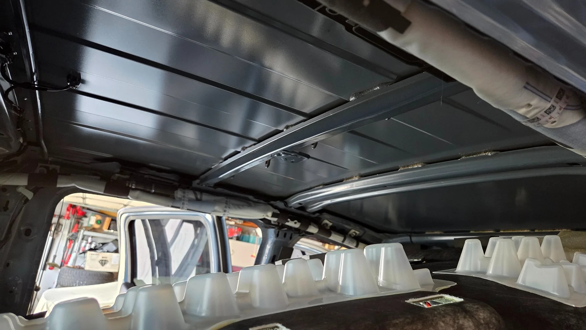

Before and after sound insulation on the roof.

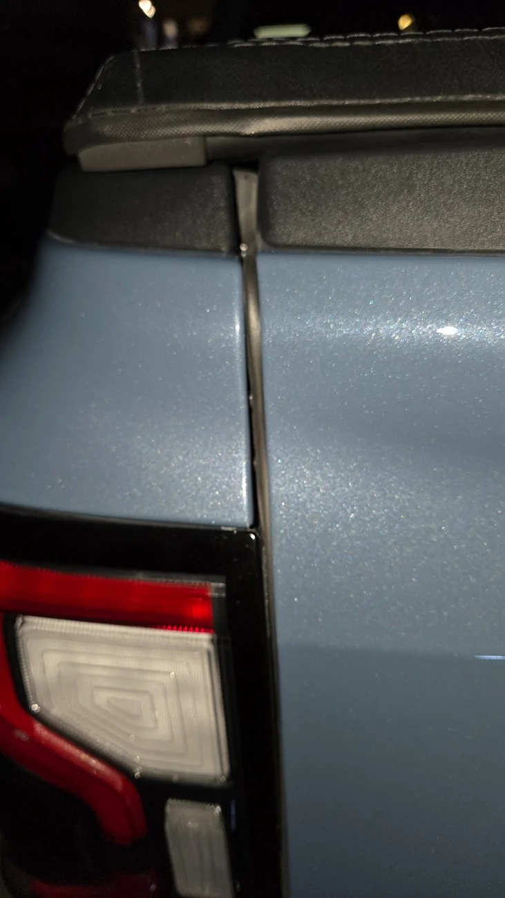

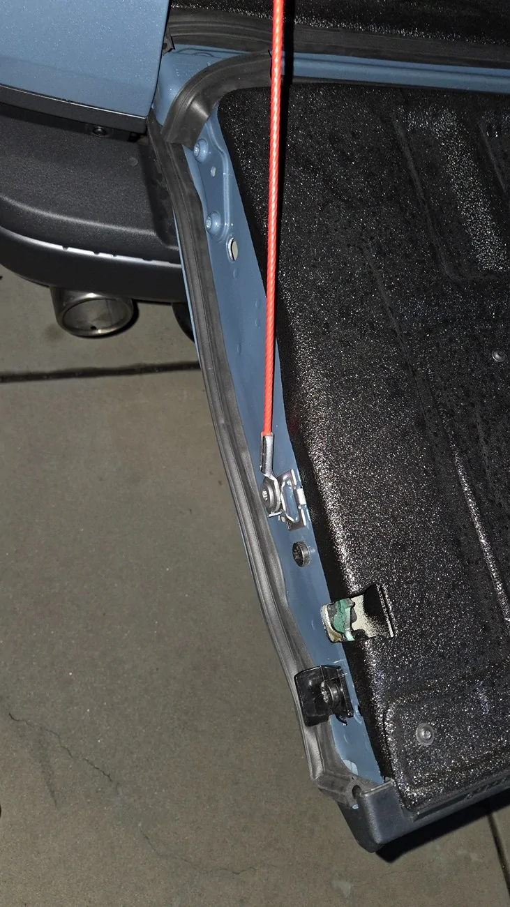

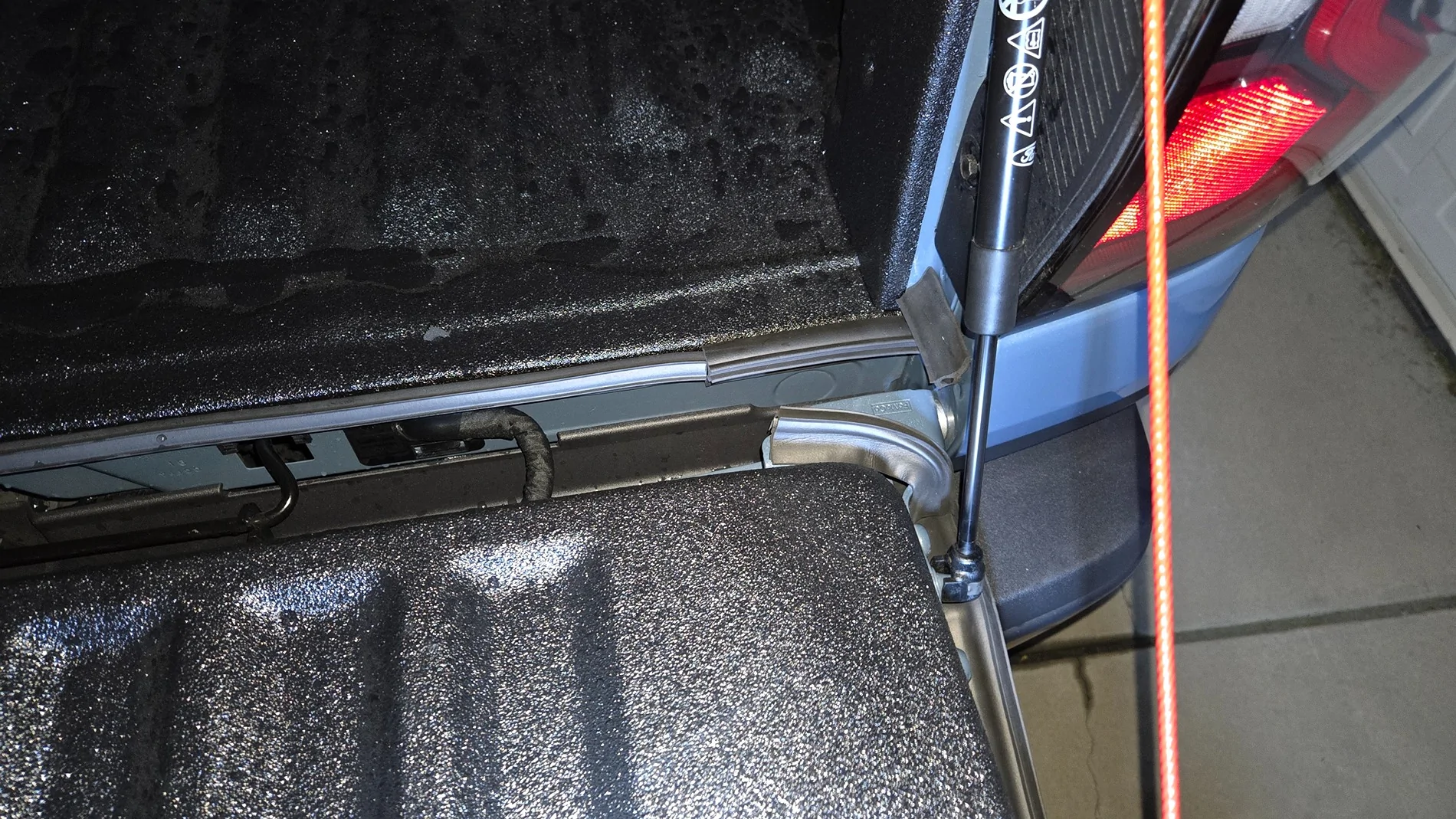

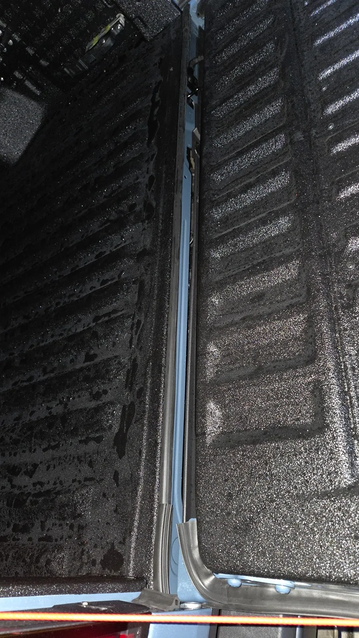

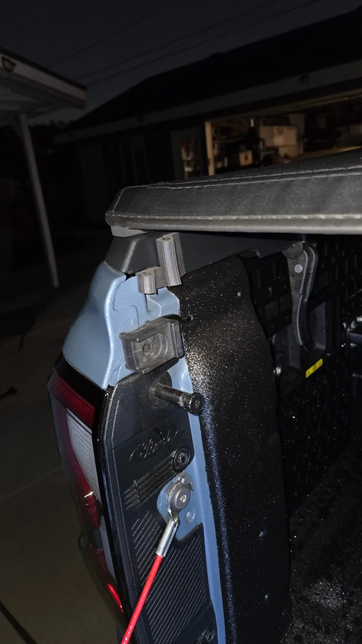

Tailgate seal.
Ford Ranger RC MUSTANG Azure Gray Raptor Build 20260214_181733
Ford Ranger RC MUSTANG Azure Gray Raptor Build 20260214_181746
Ford Ranger RC MUSTANG Azure Gray Raptor Build 20260214_181752
Ford Ranger RC MUSTANG Azure Gray Raptor Build 20260214_181801
Ford Ranger RC MUSTANG Azure Gray Raptor Build 20260214_181831
Ford Ranger RC MUSTANG Azure Gray Raptor Build 20260214_181843

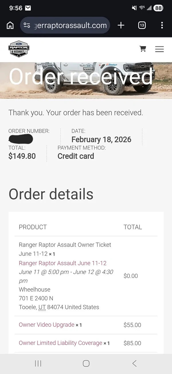

Got dates locked in.

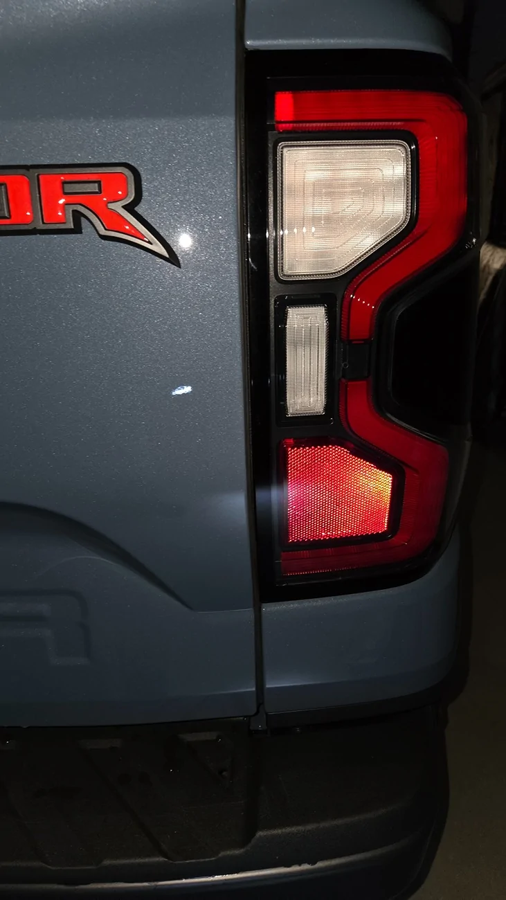

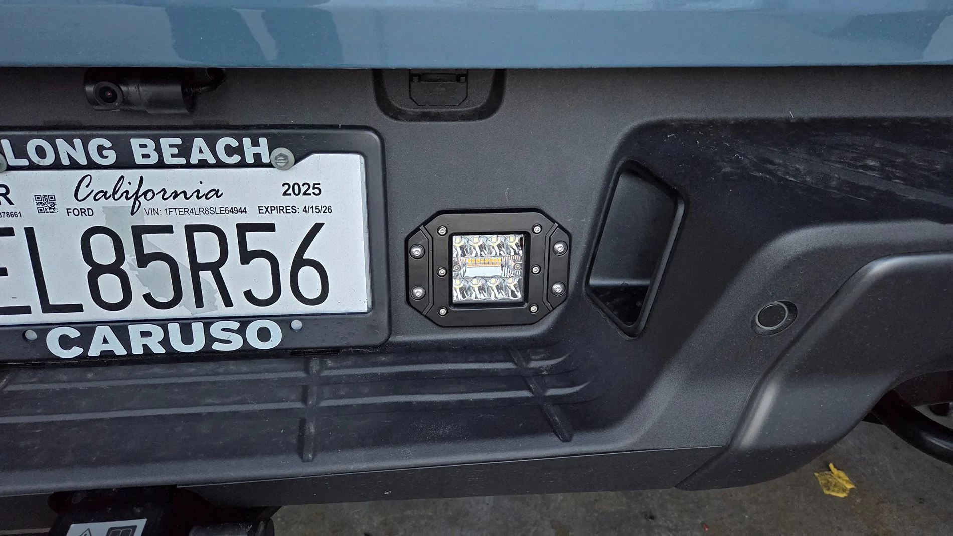

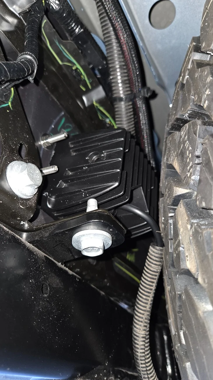

Added Aux backup light. Perfect fit.
Ford Ranger RC MUSTANG Azure Gray Raptor Build 20260218_173851
Ford Ranger RC MUSTANG Azure Gray Raptor Build 20260218_173913

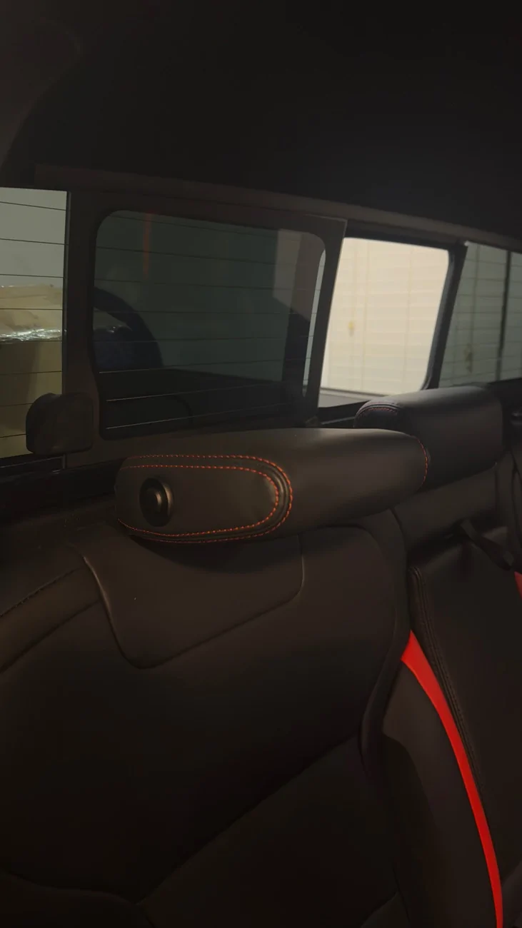

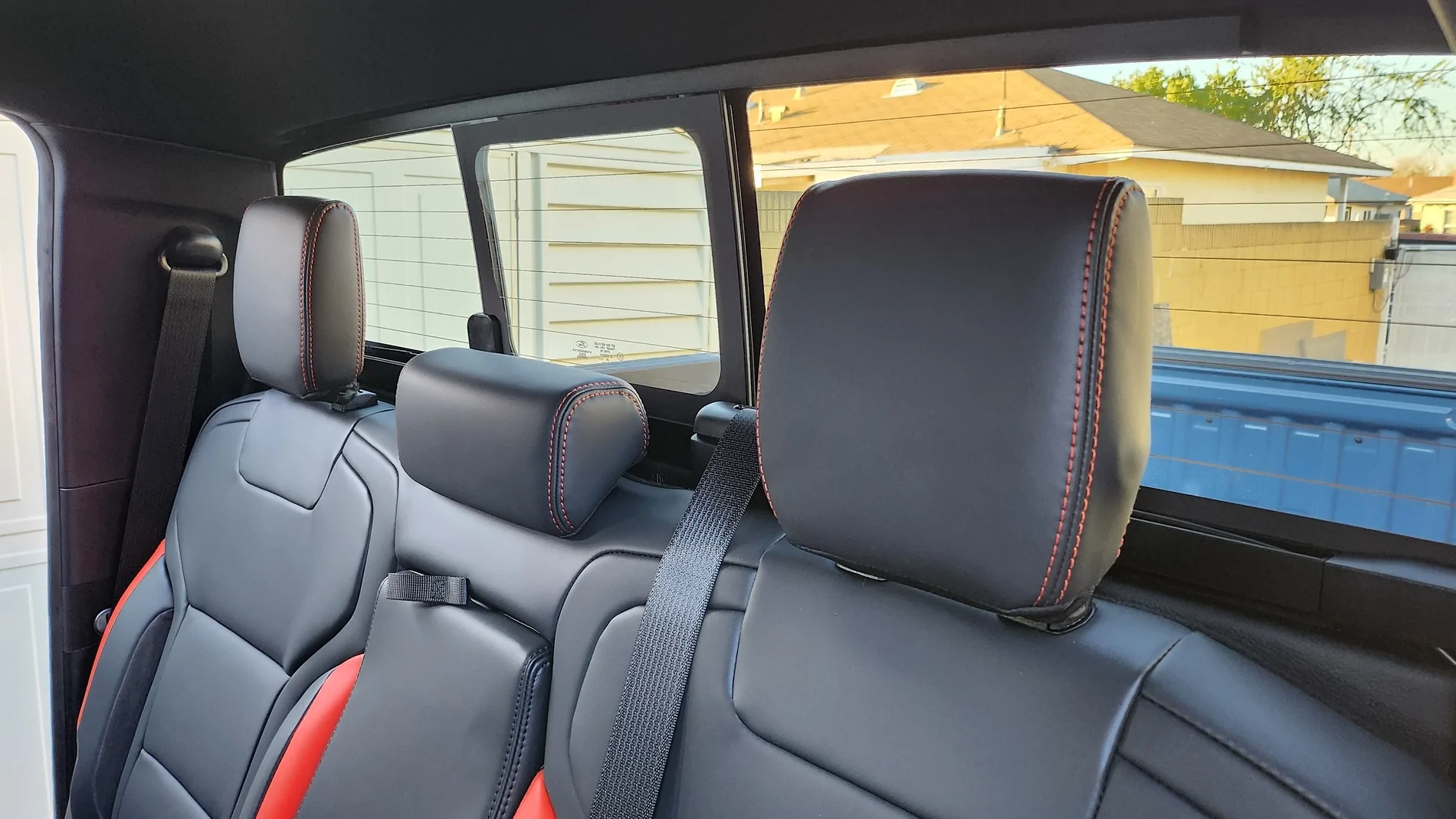

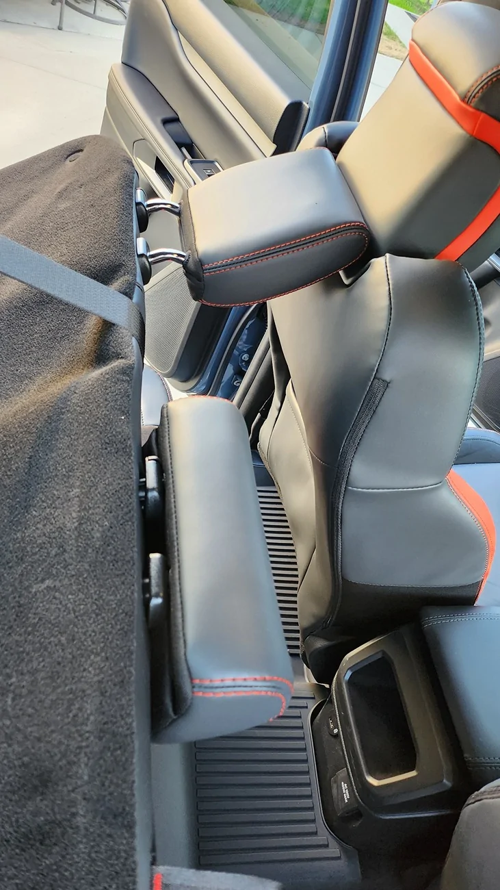

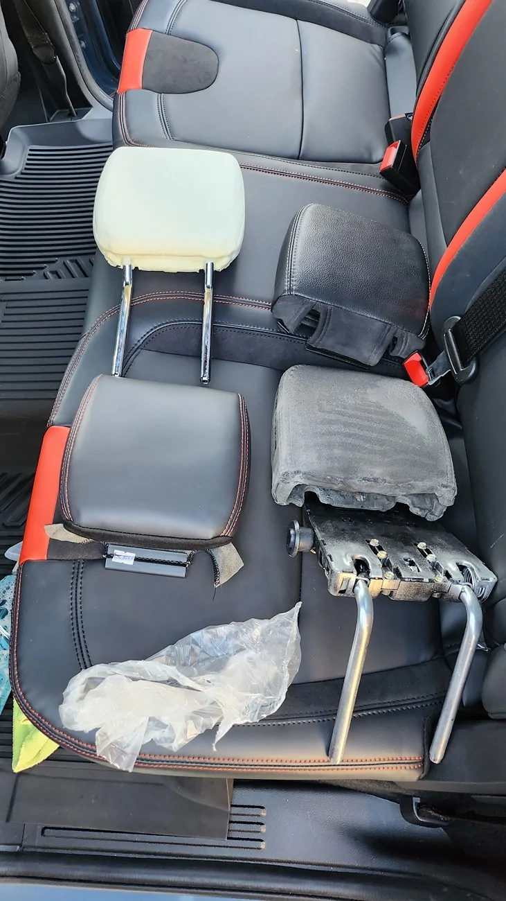

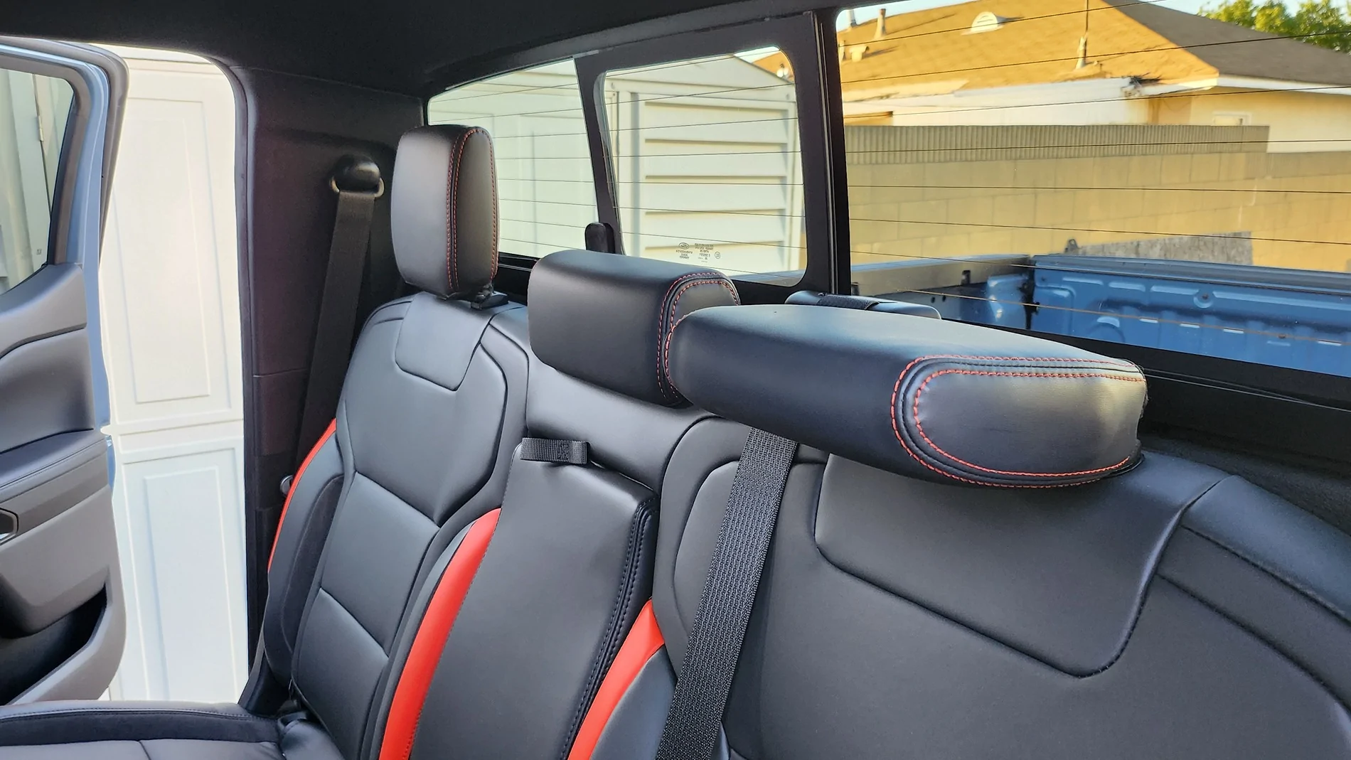

Some of you have been looking for a solution to the folding rear seat. Well, here it is. You can't fold down the seat back unless you move the front seats forward or remove the rear headrests. Took a set of folding headrests from the previous gen and swapped the covers. I might cut the hole open for the button in the future.
Can you talk me through the swap? I’m at the point you have in the pic, but the foam on the 5g is wider than the 6g.
Did you use the 5g foam with the 6g cover?
RCMUSTANG
RCMUSTANG
Ray
Jan 22, 2019
1,539
571
Los Angeles
1989 Mustang 2017 Fusion
Correct. It's a tight fit but It will fit in there. Cutting a hole for the button is optional. I did install the foam first and then the plastic part button side first.
srv256ss
Aug 21, 2025
48
2025 Ford Ranger Raptor
Thanks!
Getting the buttons on the outside was as easy as using a razor blade around the push button, but inside the bezel ring. Pushed it through. Can’t see the razor blade cuts.

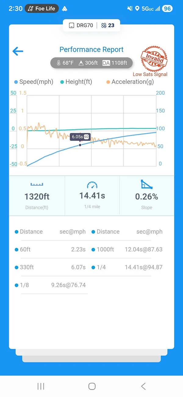

14.41 @ 94. Sport mode 4H spinning all 4 tires stock engine with no performance mods.

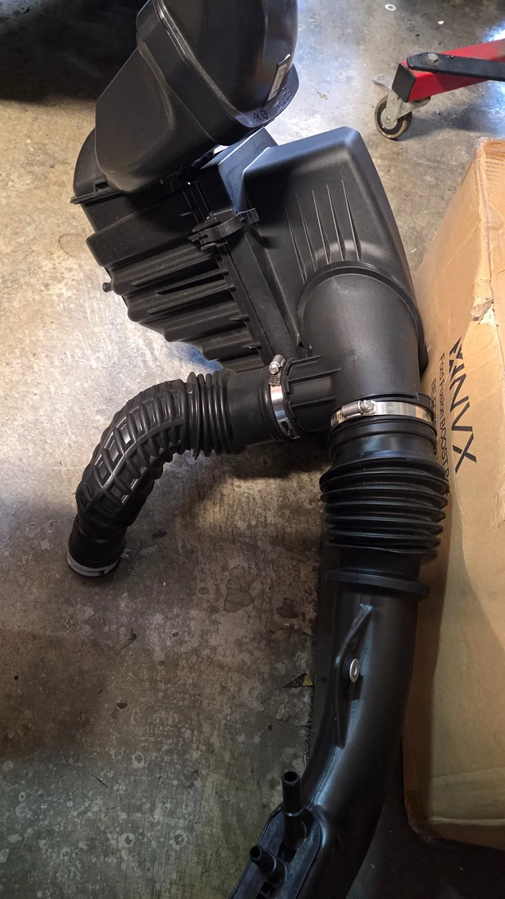

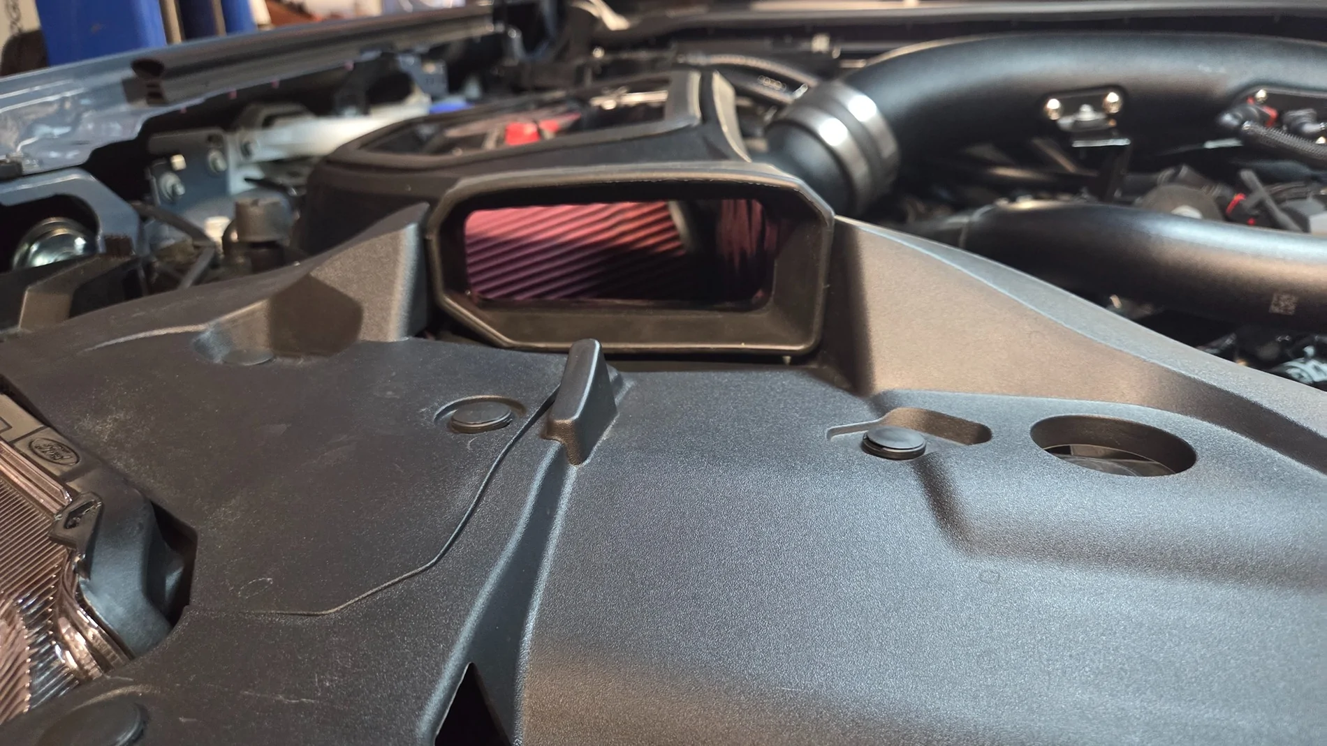

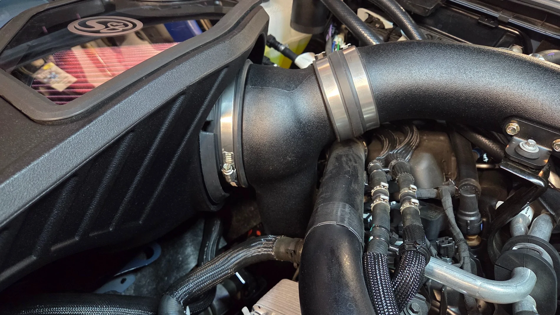

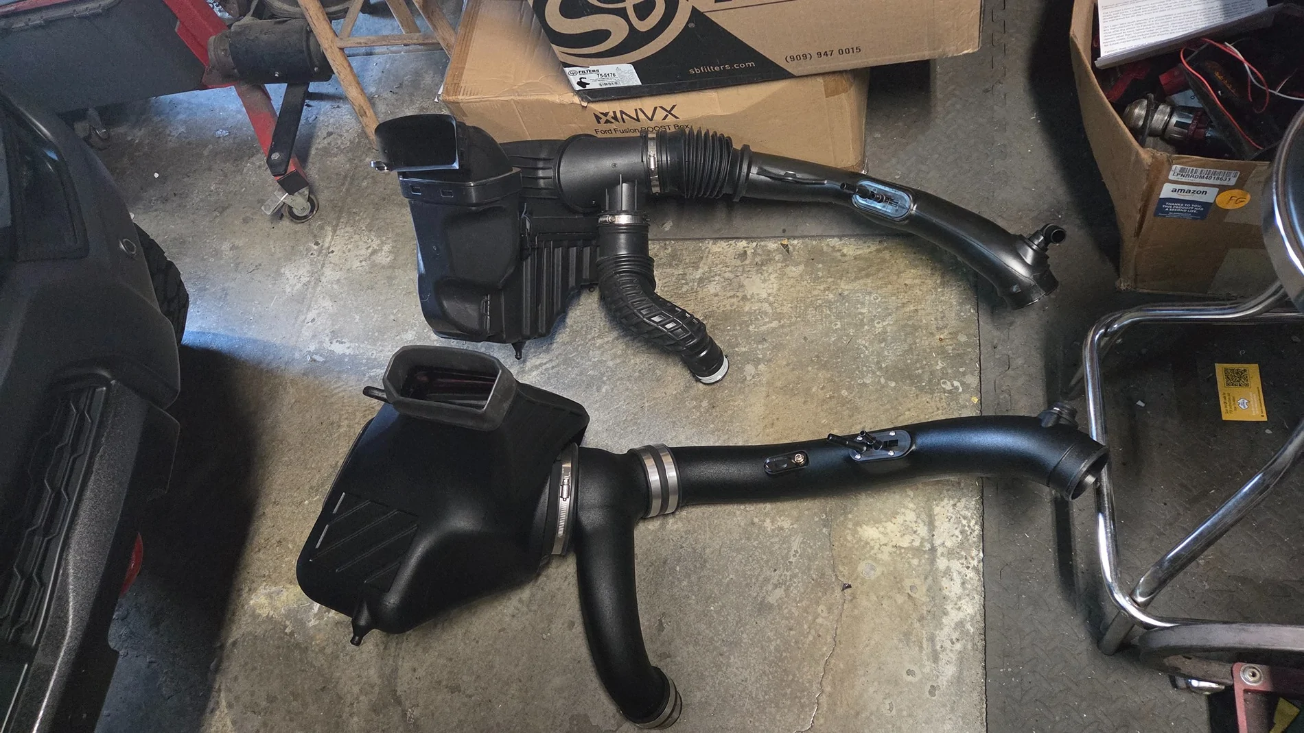

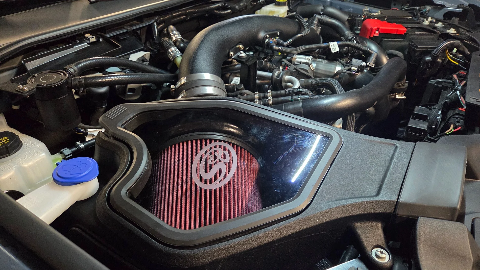

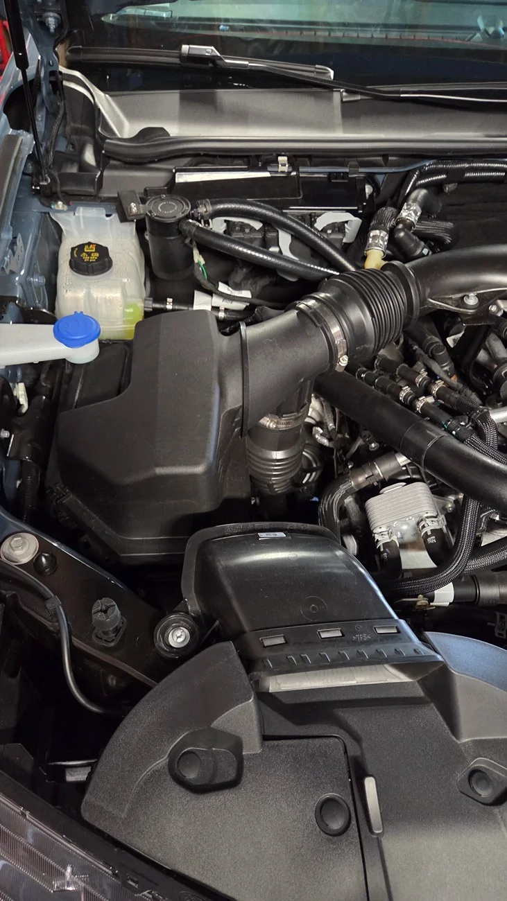

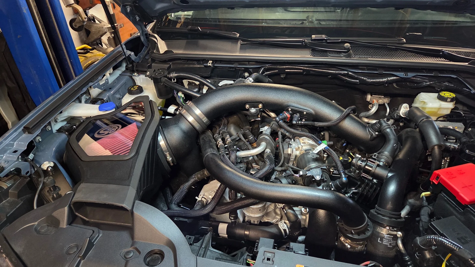

Air intake system. Puts the stock one to shame.
Ford Ranger RC MUSTANG Azure Gray Raptor Build 20260225_162330
Ford Ranger RC MUSTANG Azure Gray Raptor Build 20260225_162339
Ford Ranger RC MUSTANG Azure Gray Raptor Build 20260225_163846
Ford Ranger RC MUSTANG Azure Gray Raptor Build 20260225_164234
Ford Ranger RC MUSTANG Azure Gray Raptor Build 20260225_170151
Ford Ranger RC MUSTANG Azure Gray Raptor Build 20260225_170156
Ford Ranger RC MUSTANG Azure Gray Raptor Build 20260225_170203
Ford Ranger RC MUSTANG Azure Gray Raptor Build 20260225_170207

I do like that intake and SB has a great paper filter. My only issue would be water, dirt/sand and mud would hit that filter instantly when off road. Wonder if a baffle could be made to divert the air down and away from the filter like the stock system. But I bet that defeats the benefits of this box. Love following your progress.

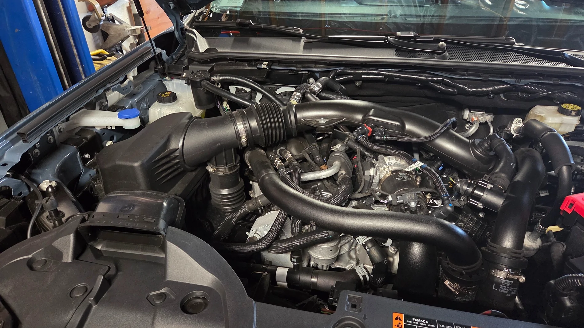

As on my previous truck i run the pre filter when I actually go offroad. It's water repellent and filters to a smaller micro. So, I don't worry about that. Even if it's raining it's hard for water to get up and in there. If you look at the path it would take to get there ford already designed it so things won't go directly into the filter.
From yoiur pictures it looks like a straight shot right to the filter. Nothing like the factory setup. What am I missing? And what is this pre filter?
