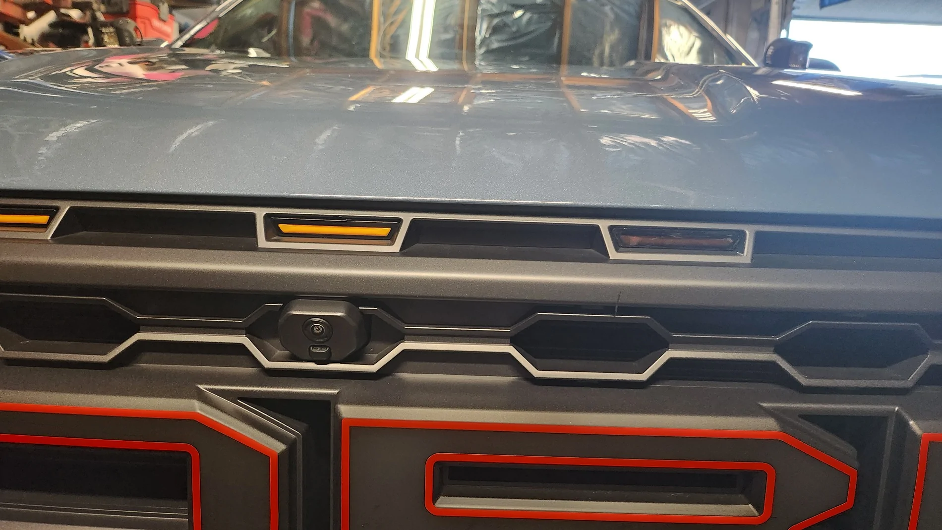

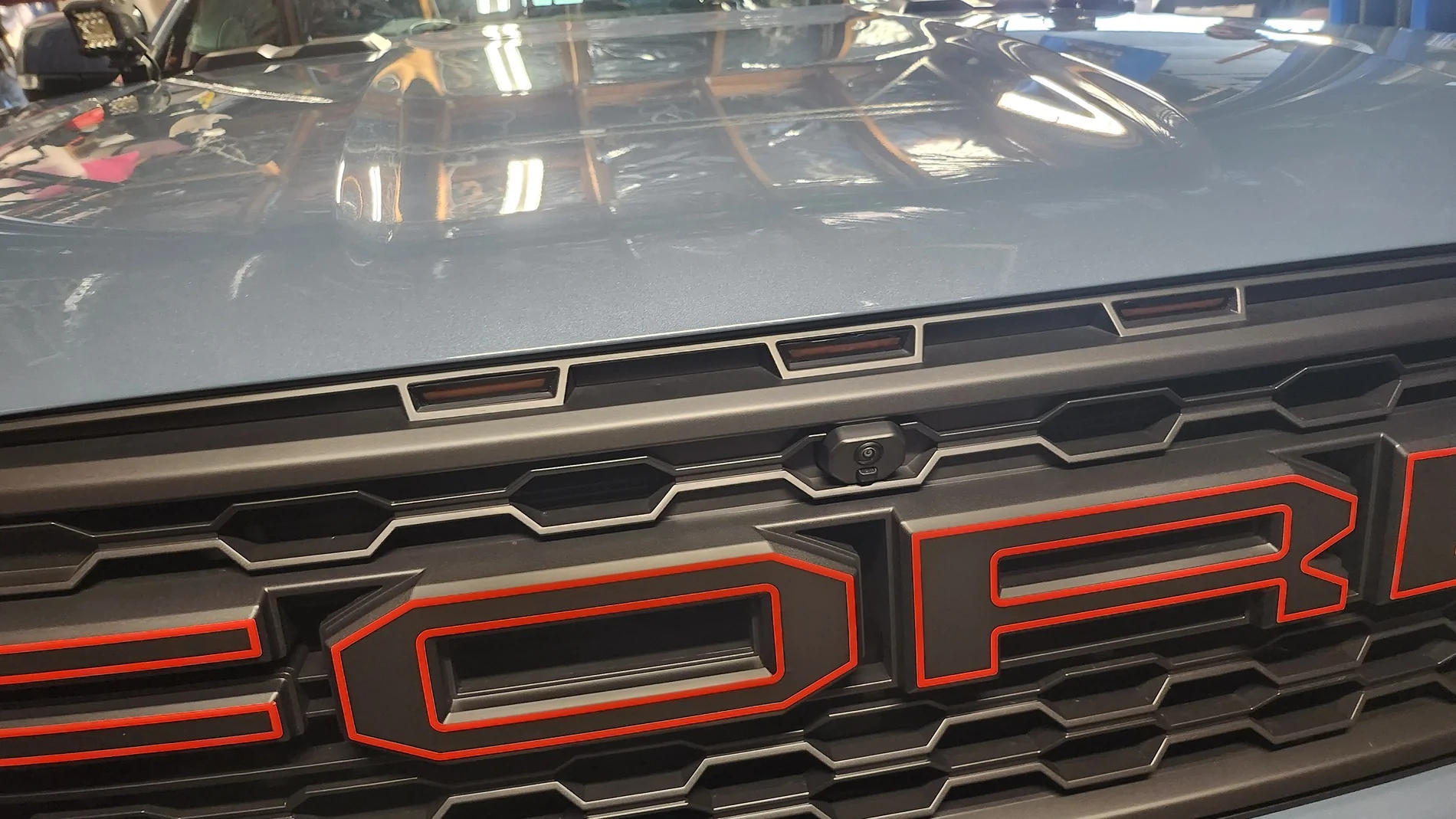

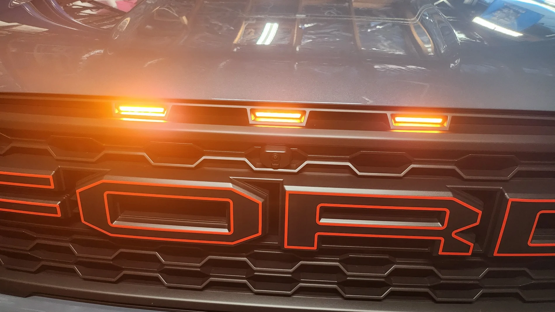

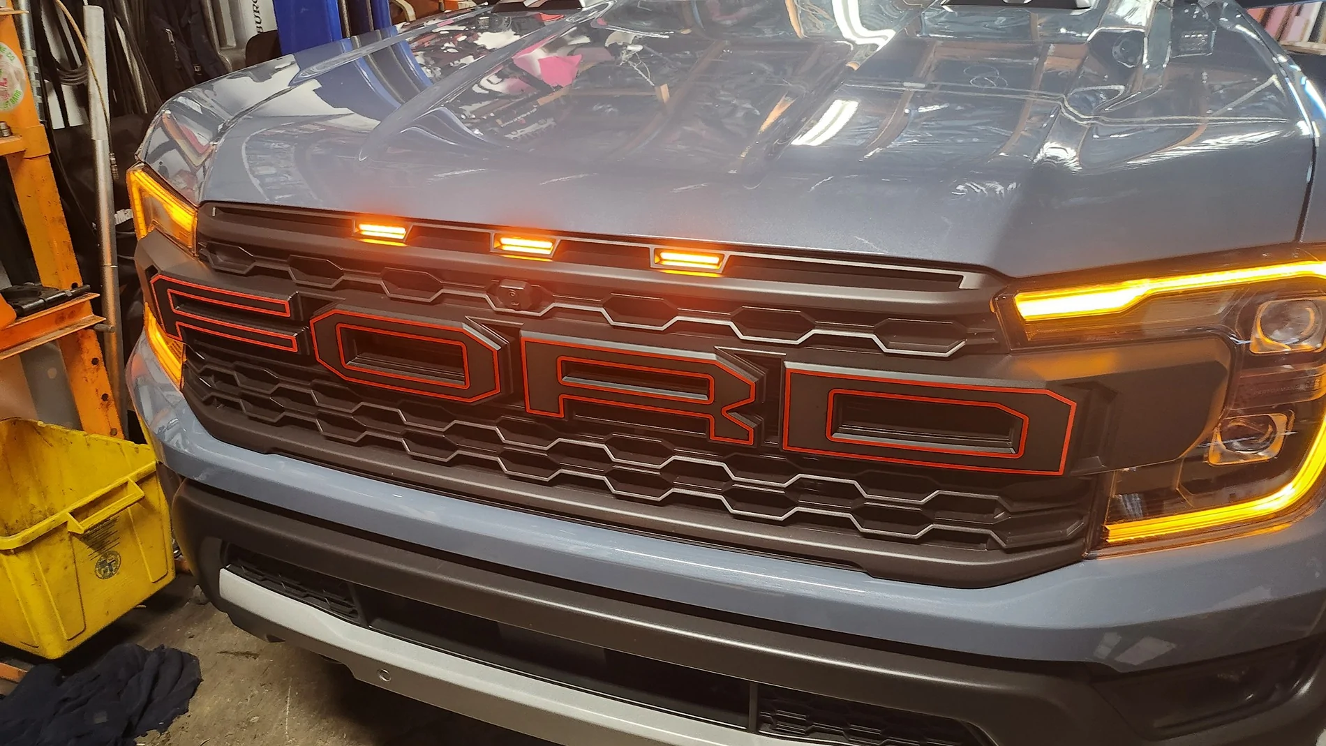

Smoked out the grille lights a bit. They were way to bright compared to the C lights. Plus even off the yellow lenses stood out too much.
Ford Ranger RC MUSTANG Azure Gray Raptor Build 20260126_164309
Ford Ranger RC MUSTANG Azure Gray Raptor Build 20260126_164838
Ford Ranger RC MUSTANG Azure Gray Raptor Build 20260126_165314
Ford Ranger RC MUSTANG Azure Gray Raptor Build 20260126_165341

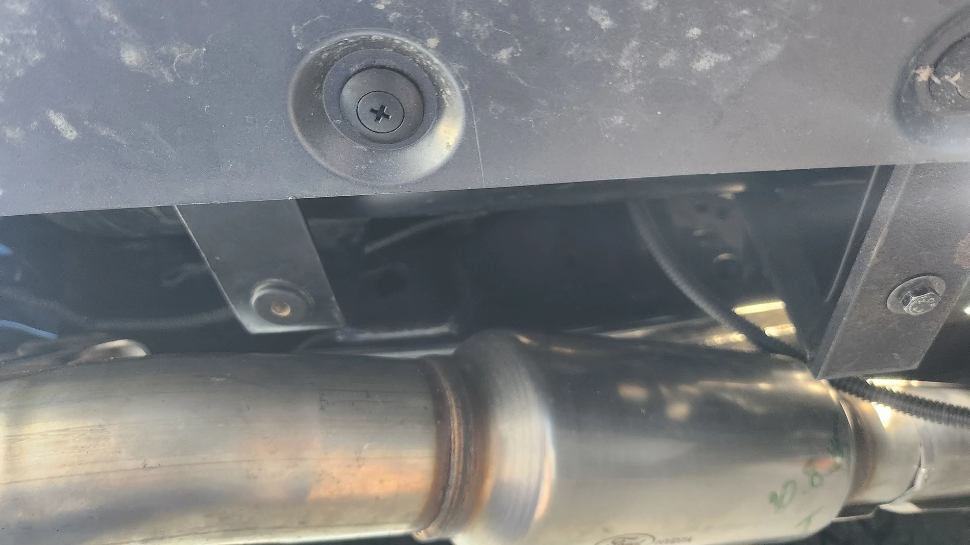

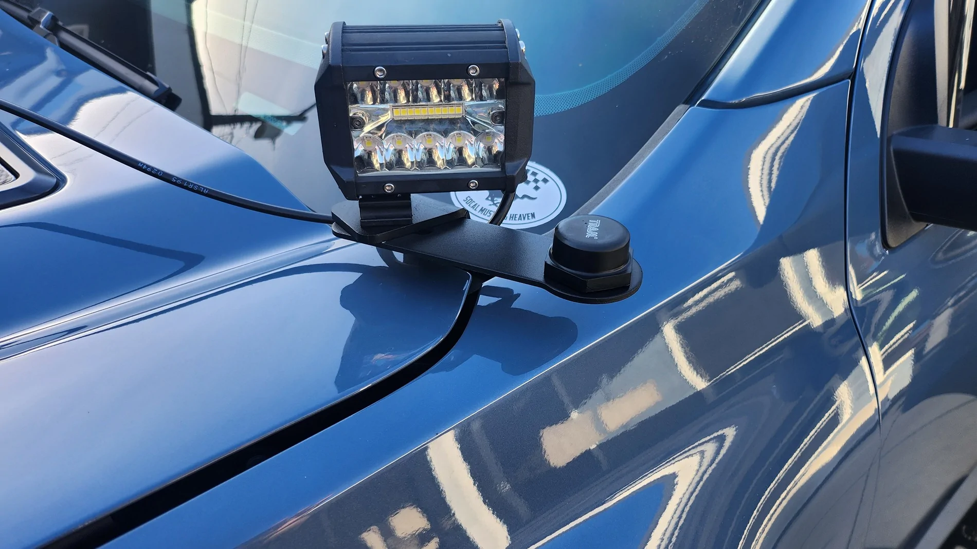

That was a tight fit. Made some adjustments and added a couple extra brackets and I was able to reuse the original brackets. Above the passenger side tailpipe.
Ford Ranger RC MUSTANG Azure Gray Raptor Build 20260127_145617
Ford Ranger RC MUSTANG Azure Gray Raptor Build 20260127_145624
Ford Ranger RC MUSTANG Azure Gray Raptor Build 20260127_145631

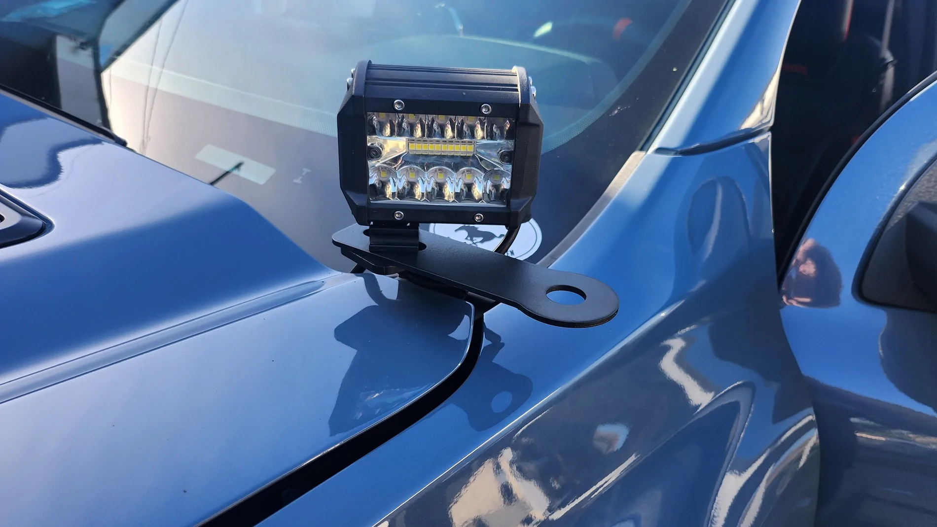

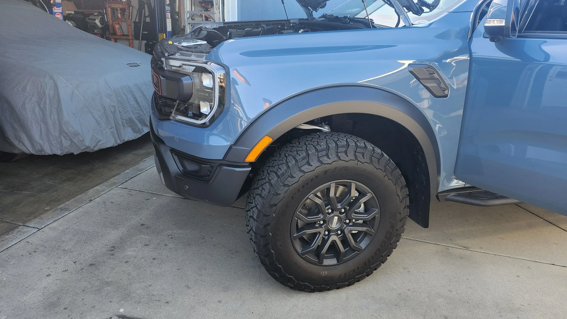

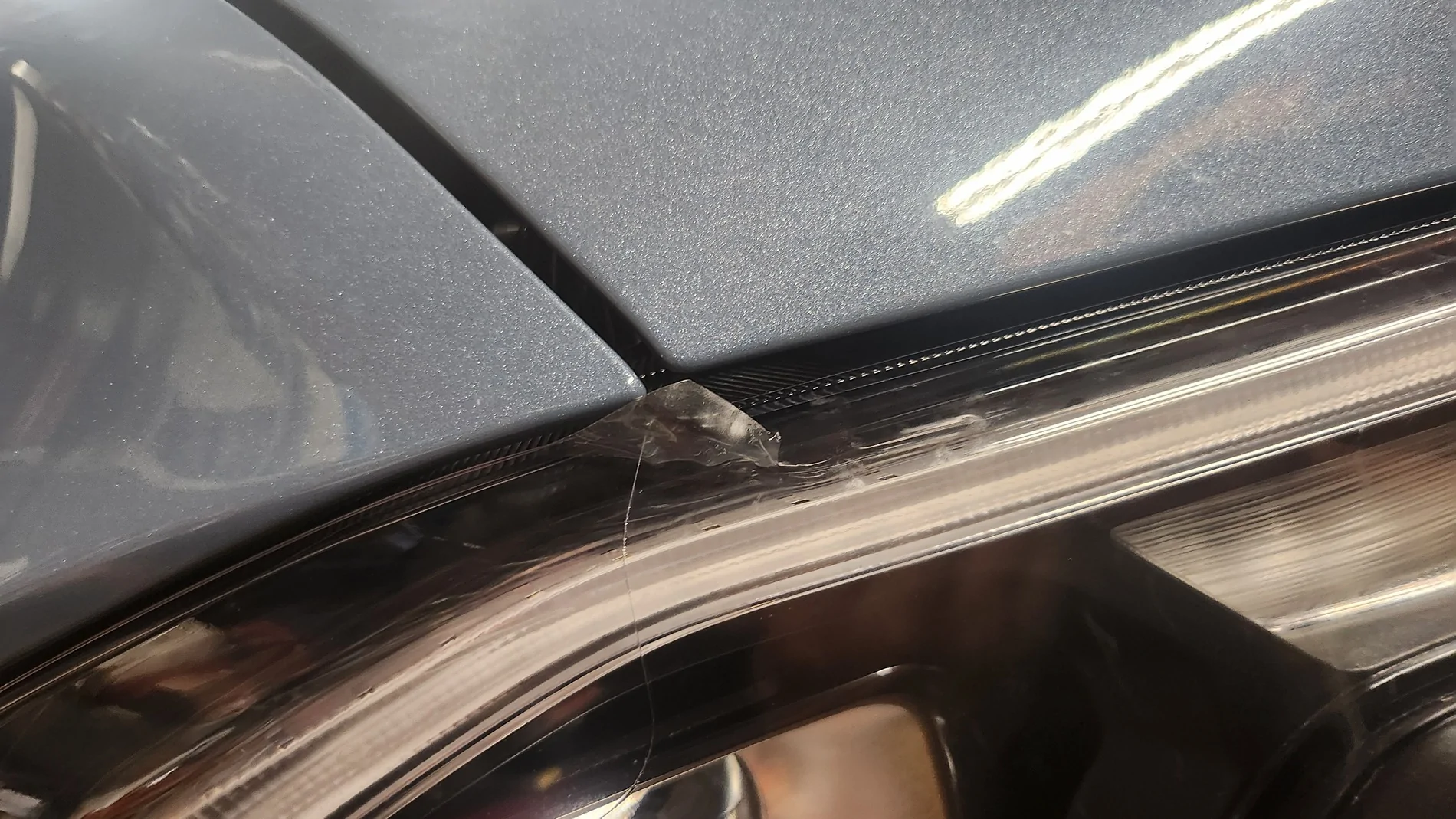

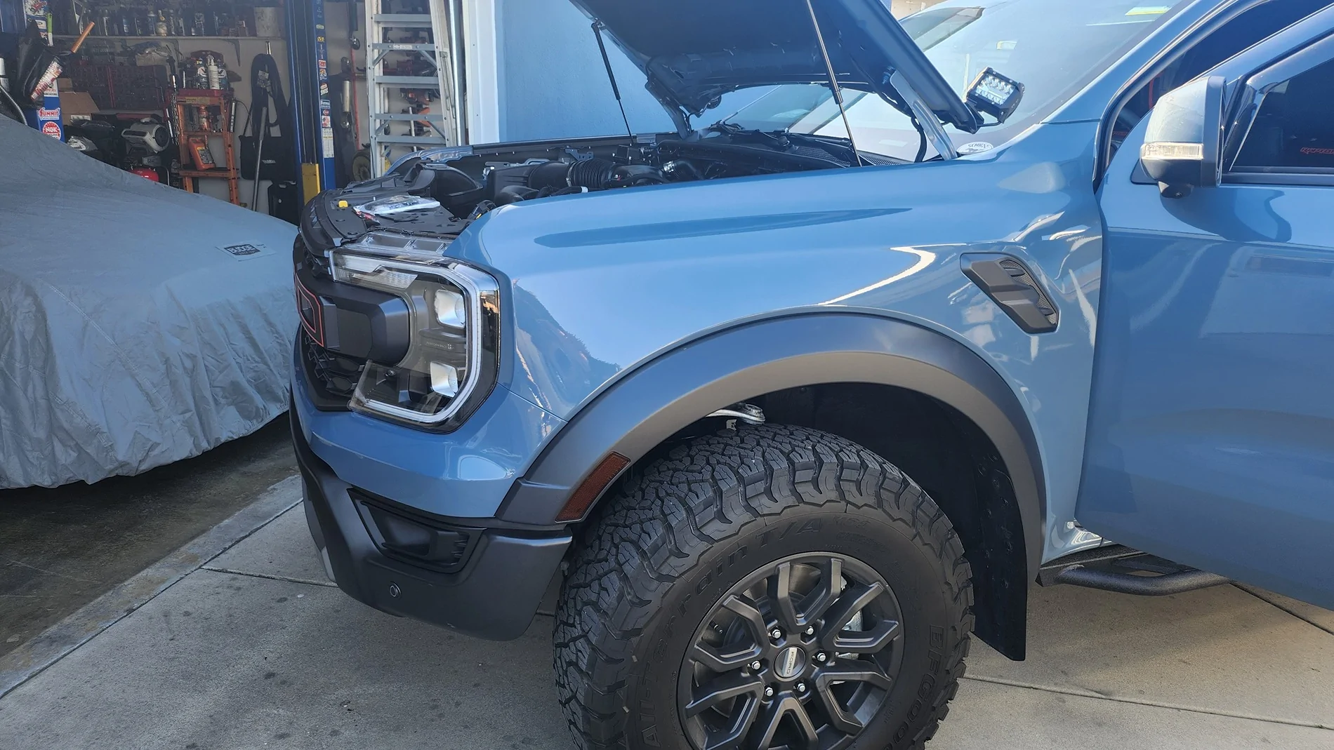

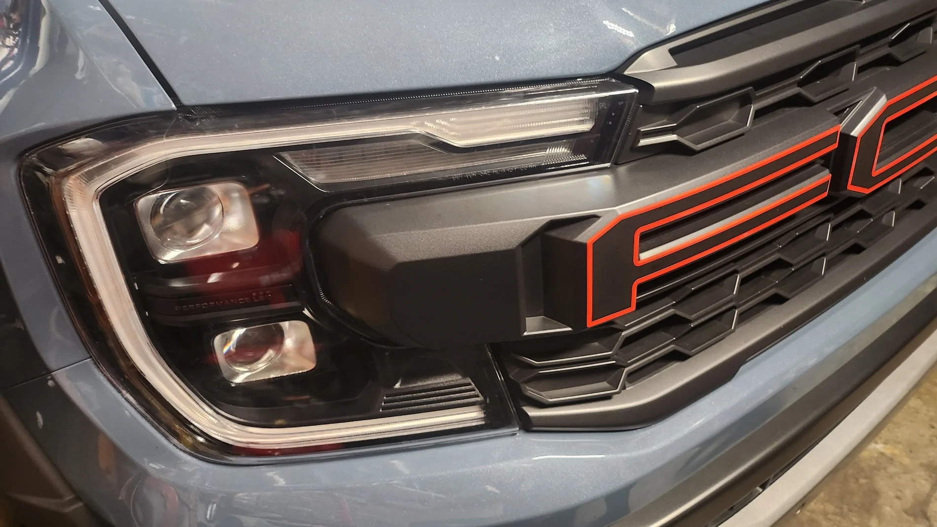

Temporary headlight protection till i get the whole truck PPF'd.

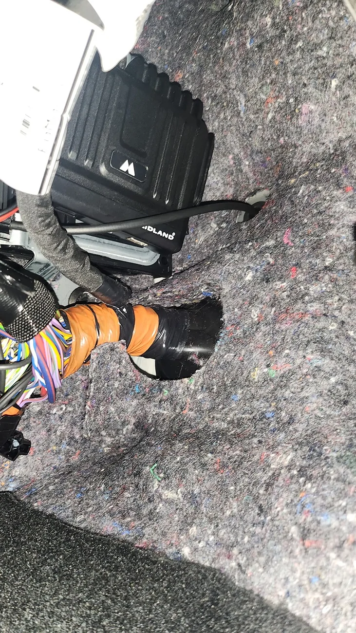

About half way done with GMSR radio install. Main unit mounted. Hardwired. Need to get a custom piece 3D printed to mount the RJ45 outlet and handset. Then run and mount the antenna.

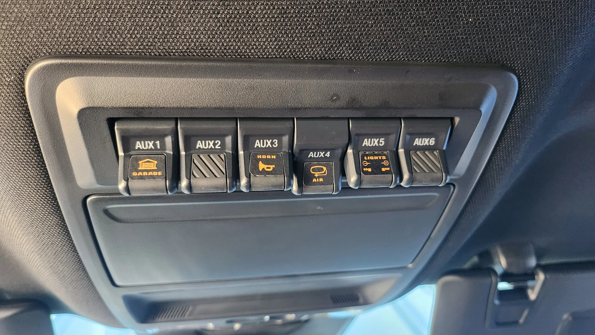

Aux switch labels.

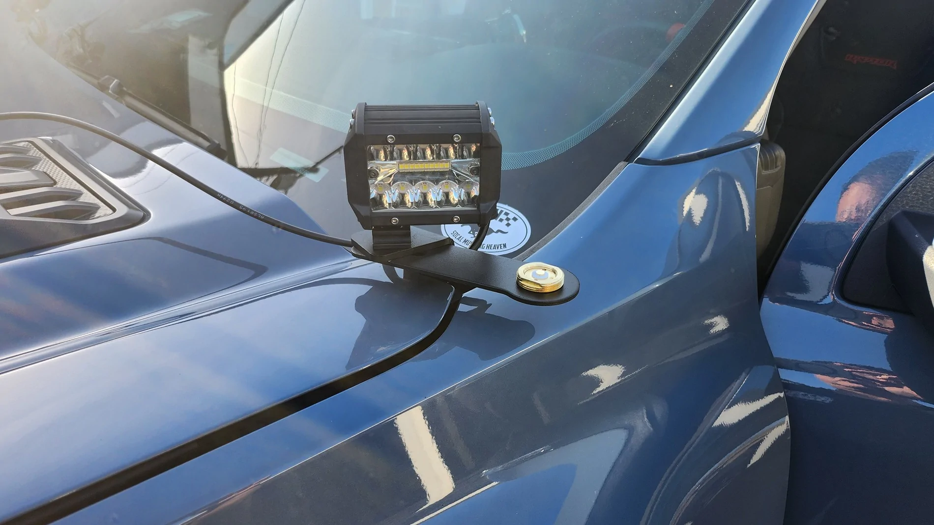

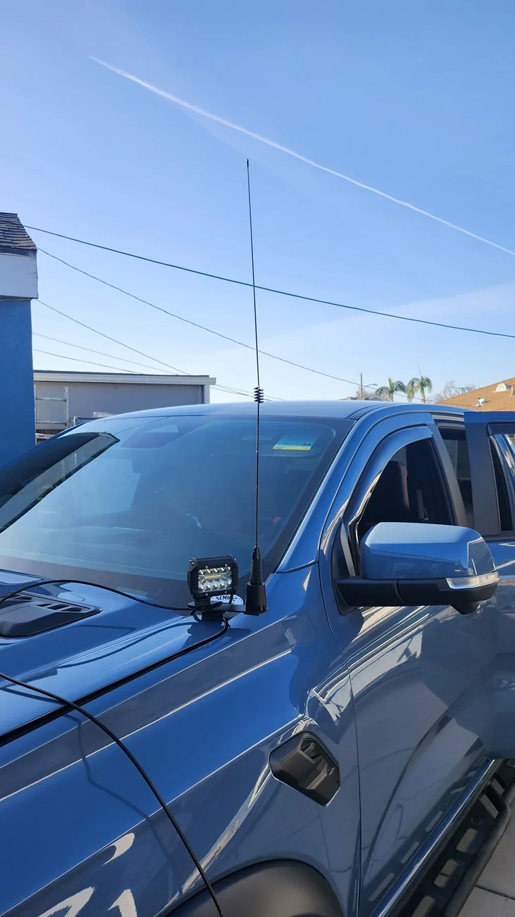

New antenna mount. The magnetic roof mount wasn't the best for the finish on the roof. Capped when not in use.
Ford Ranger RC MUSTANG Azure Gray Raptor Build 20260130_144858
Ford Ranger RC MUSTANG Azure Gray Raptor Build 20260130_150640
Ford Ranger RC MUSTANG Azure Gray Raptor Build 20260130_150704
Ford Ranger RC MUSTANG Azure Gray Raptor Build 20260130_150924

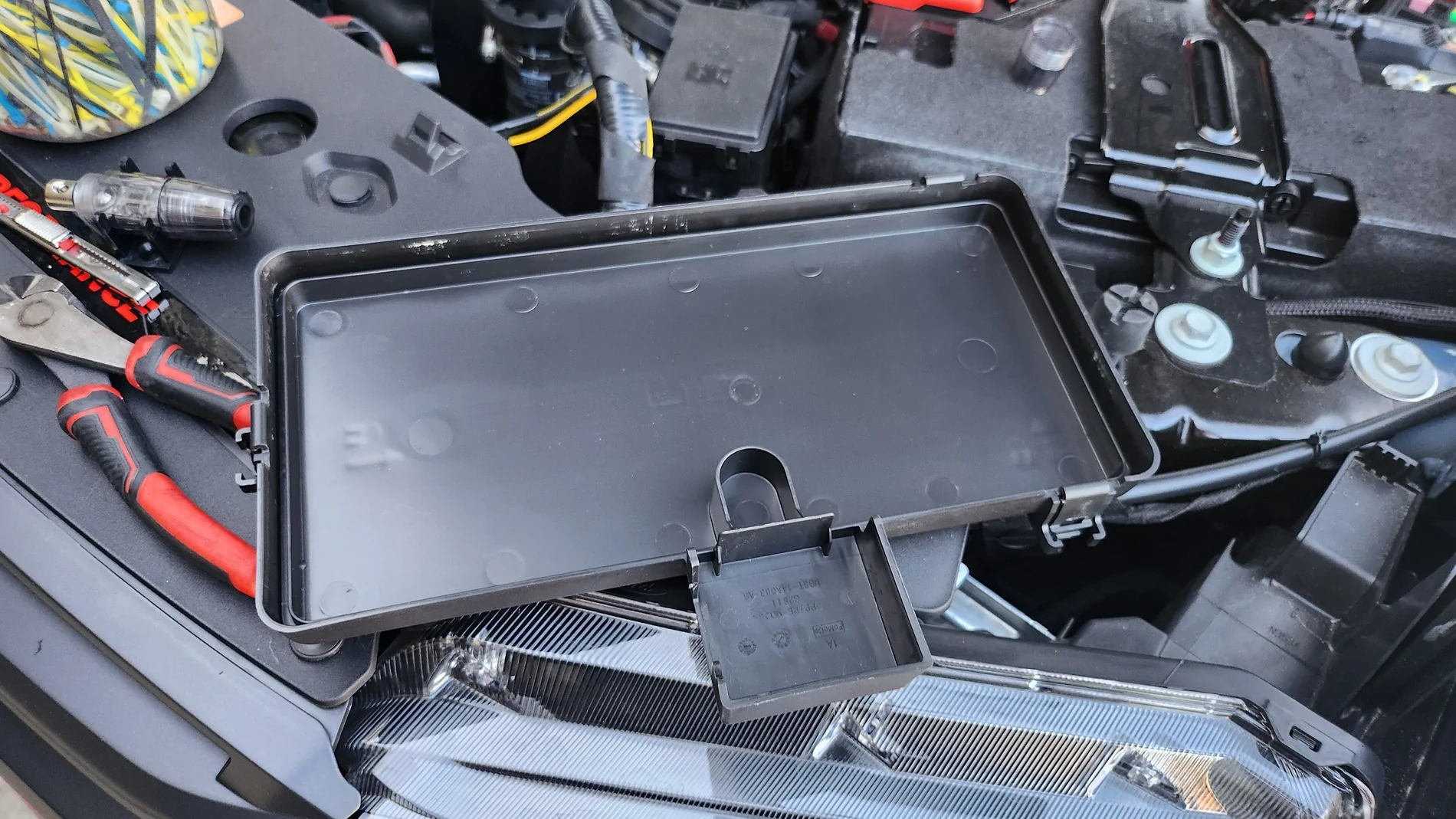

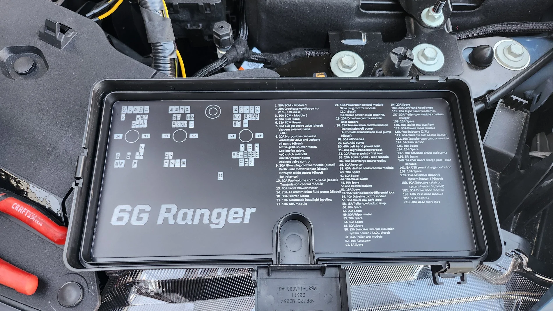

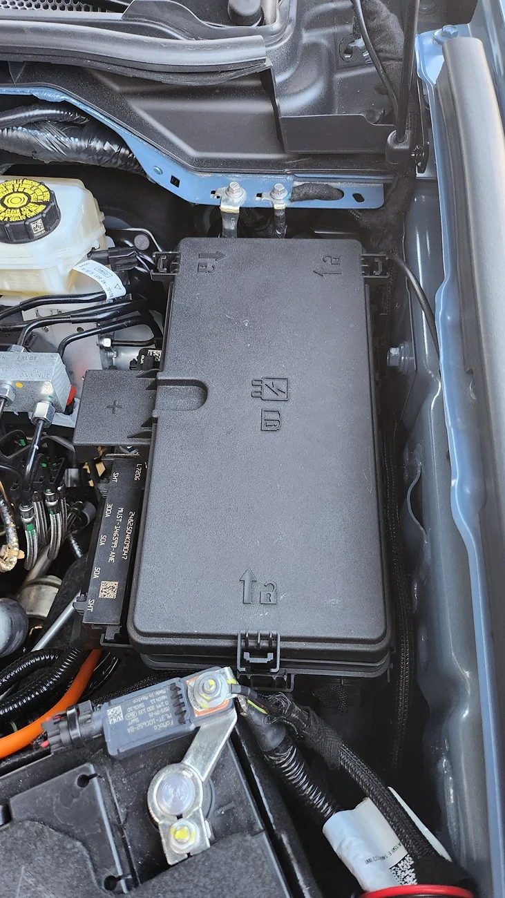

Fuse diagram.
Ford Ranger RC MUSTANG Azure Gray Raptor Build 20260130_153812
Ford Ranger RC MUSTANG Azure Gray Raptor Build 20260130_153819
Ford Ranger RC MUSTANG Azure Gray Raptor Build 20260130_154056

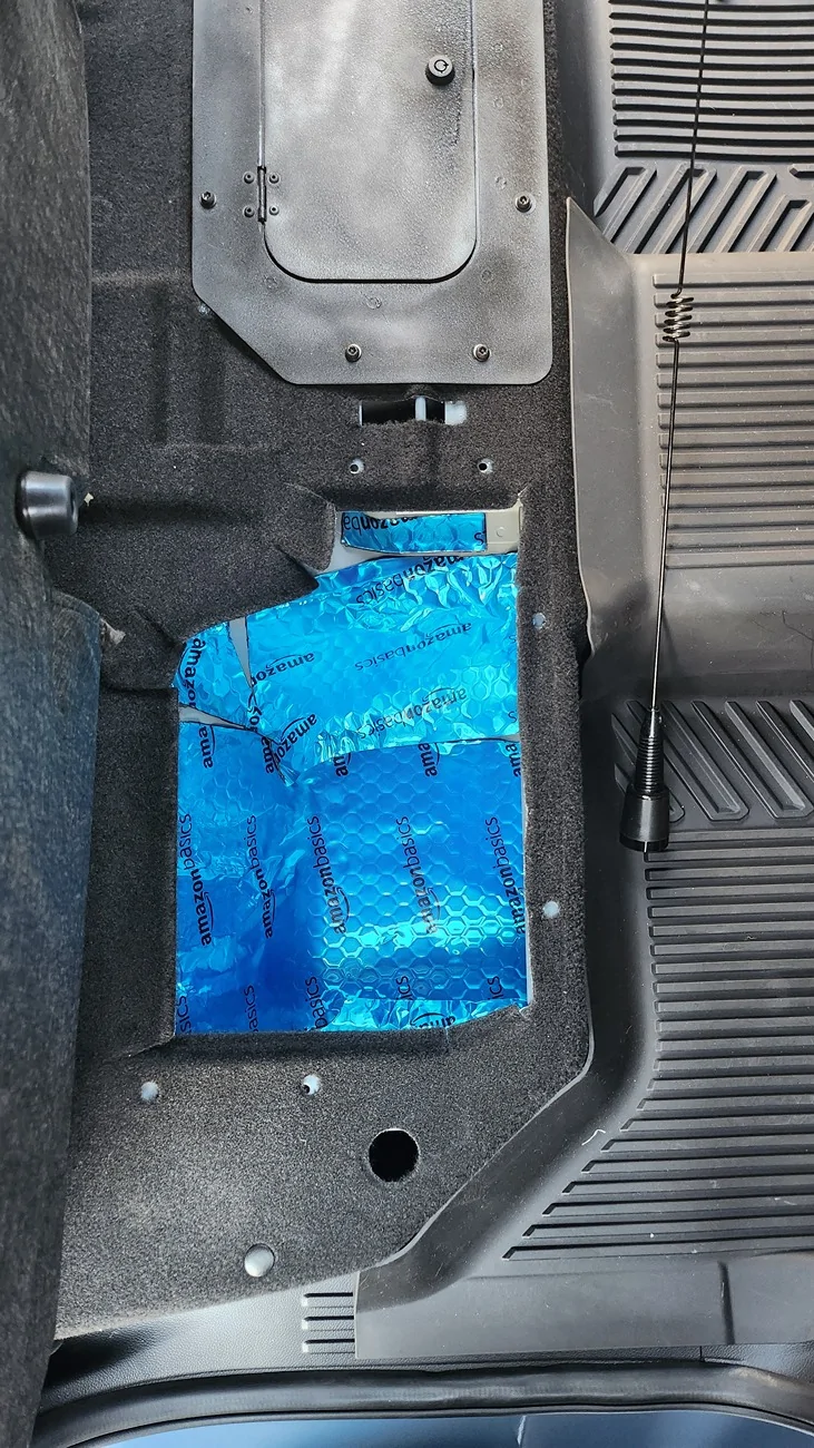

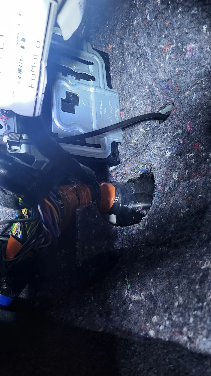

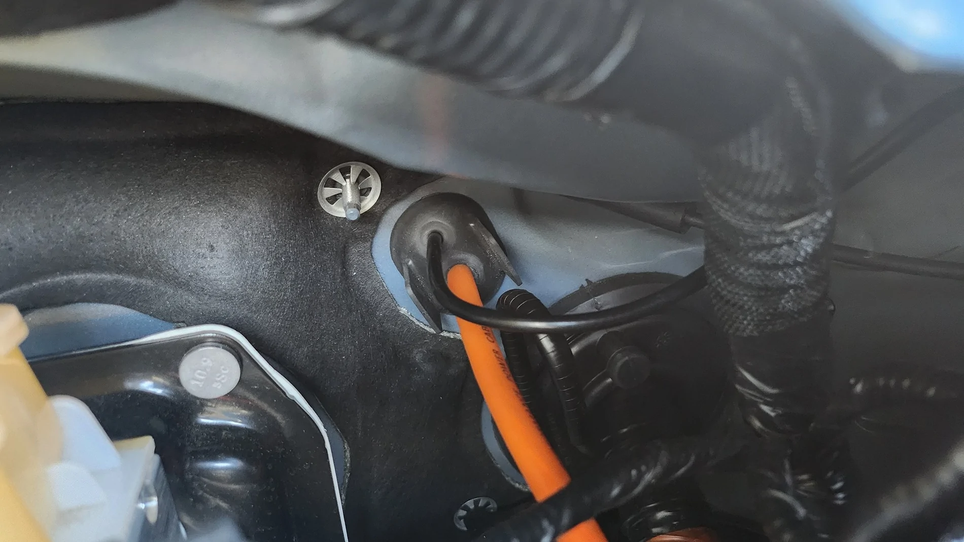

For once they made a really convenient spot to run wires into the cab.
Ford Ranger RC MUSTANG Azure Gray Raptor Build 20260130_153636

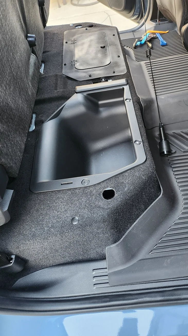

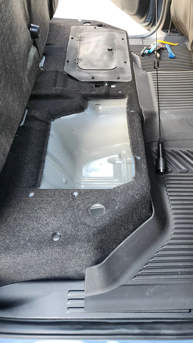

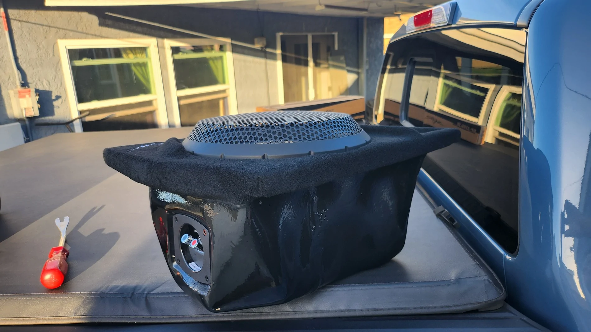

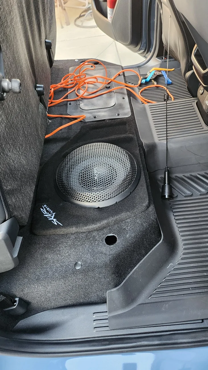

Well, the sub was decent. It barely fits under the seat. You actually have to force it down to get it to latch. The amp sucked. It started power clipping and going into protect mode around 20 mins in. 😒 Good thing I set it up to test before I mounted it.
Ford Ranger RC MUSTANG Azure Gray Raptor Build 20260130_161843
Ford Ranger RC MUSTANG Azure Gray Raptor Build 20260130_161932
Ford Ranger RC MUSTANG Azure Gray Raptor Build 20260130_163132
Ford Ranger RC MUSTANG Azure Gray Raptor Build 20260130_162049
Ford Ranger RC MUSTANG Azure Gray Raptor Build 20260130_163520
Ford Ranger RC MUSTANG Azure Gray Raptor Build 20260130_185840

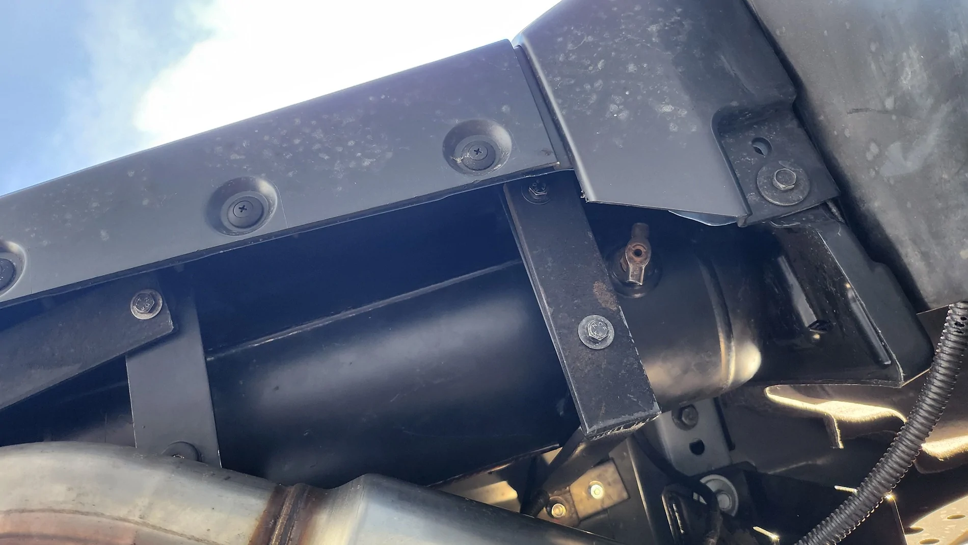

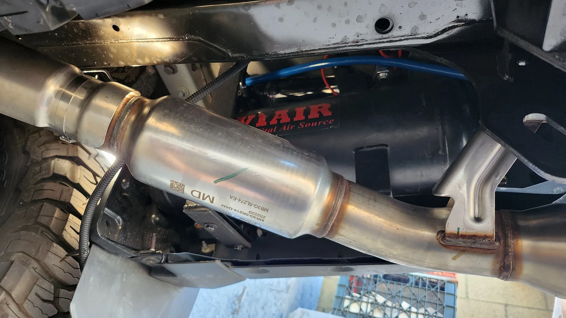

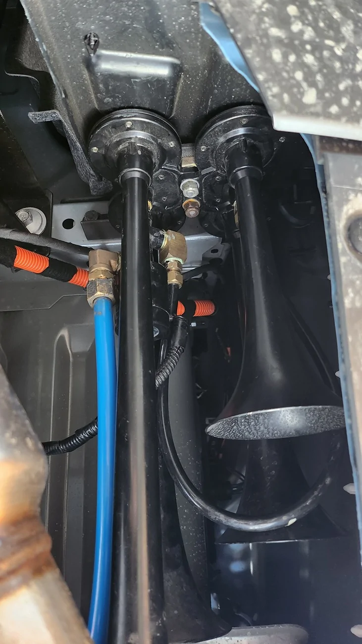

Sound measurement after trombone loop. Overall it was a bit quieter but sounds more refined. Disregard the buzz. The air tank is rubbing against the sheet metal a bit.
Stock exhaust. Loop.
Startup 79 db NA
Quiet idle 59db 62db
Quiet 3,000 RPM 71db 71db
Normal idle 62db. 63db
Normal 3,000 RPM 76db 75db
Sport idle 69db 64db
Sport 3,000 RPM 81db 80db
Baja idle 69db. 65db
Baja 3,000 RPM 84db 81db

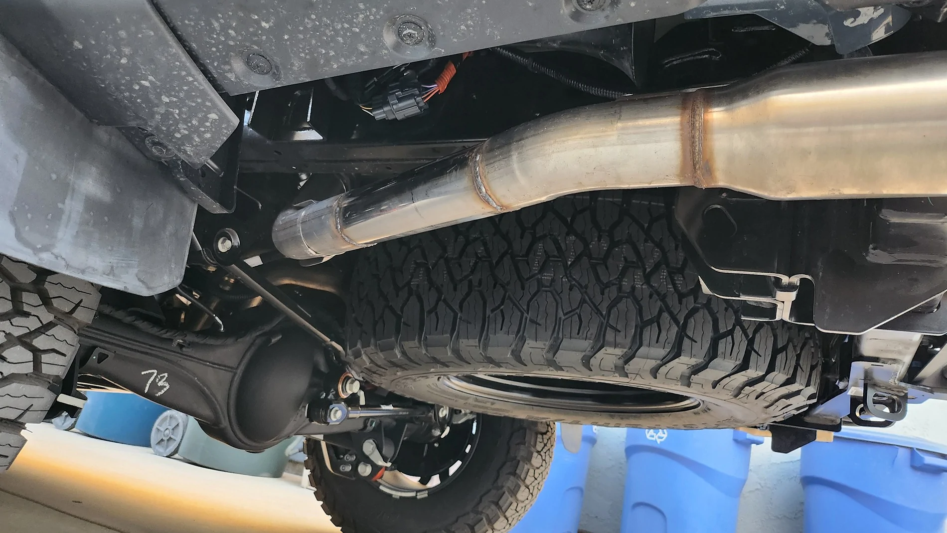

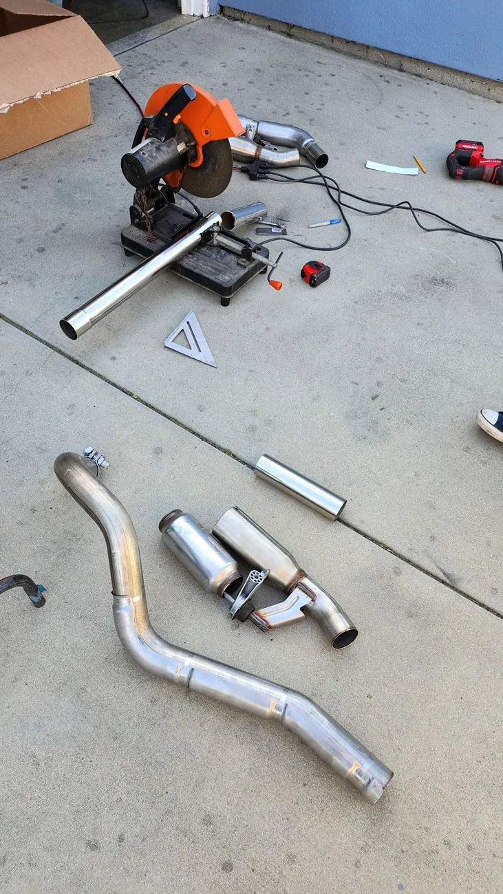

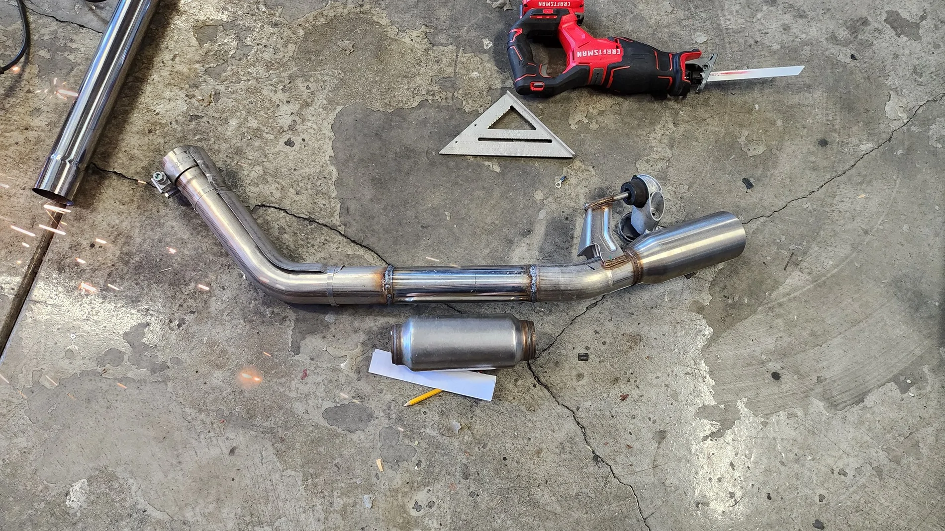

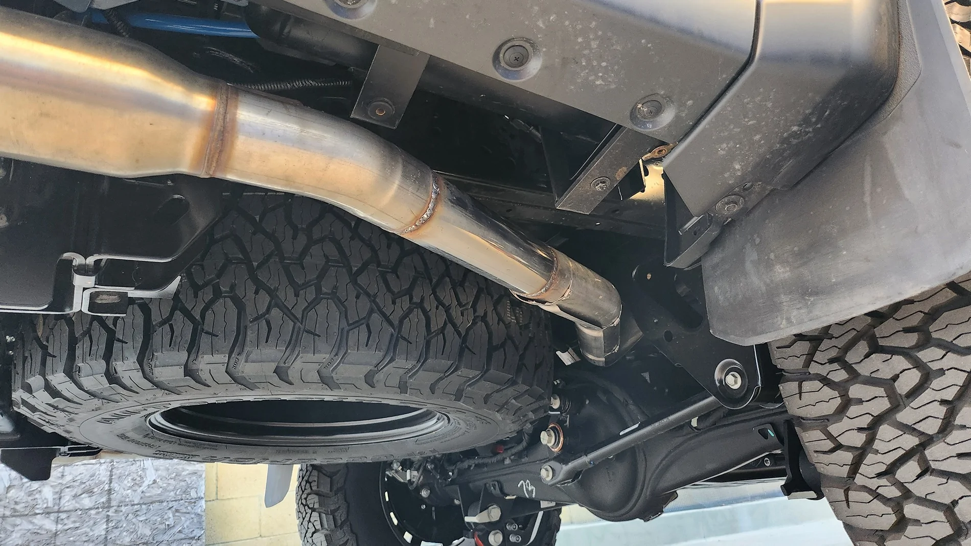

Resonators deleted.

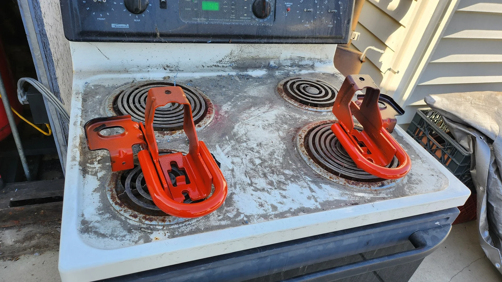

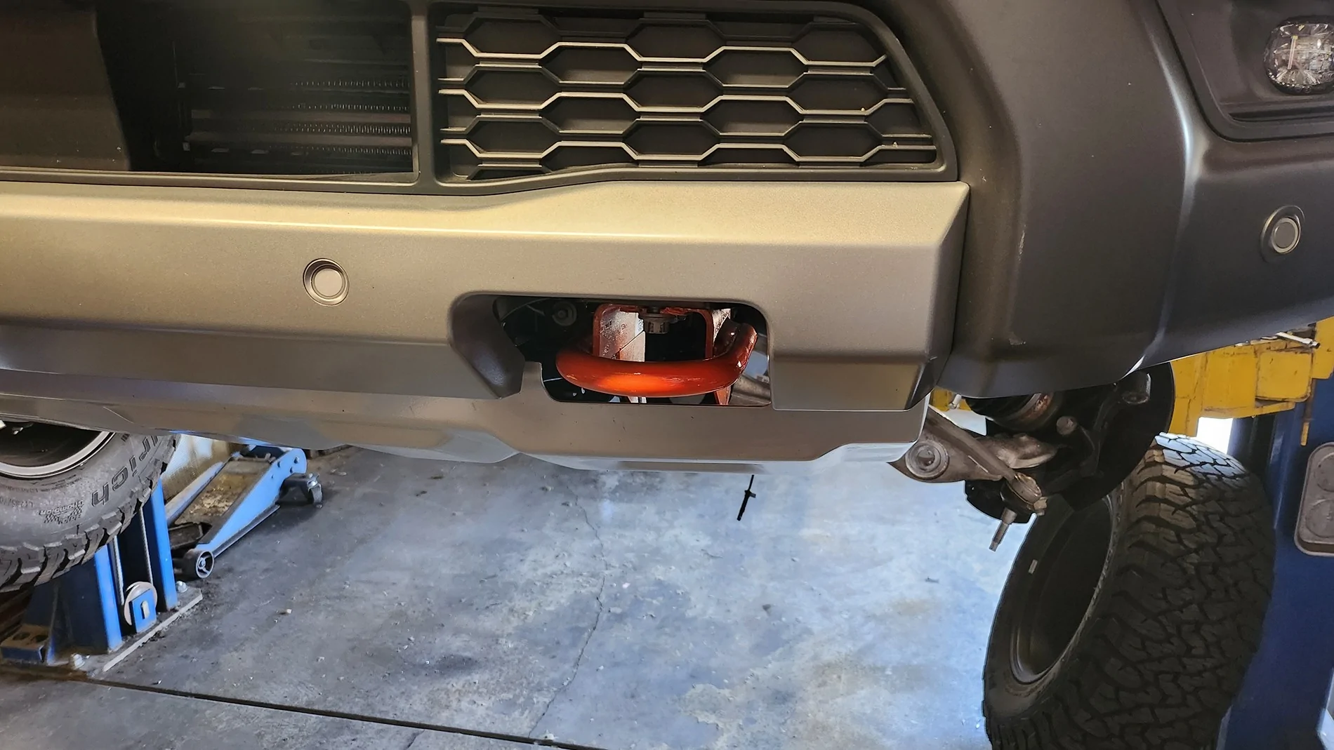

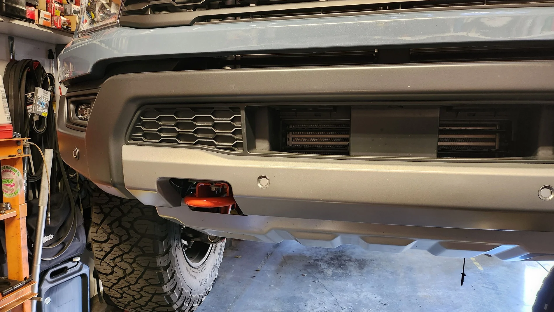

Powder coated tow hooks code orange.
Ford Ranger RC MUSTANG Azure Gray Raptor Build 20260201_114357
Ford Ranger RC MUSTANG Azure Gray Raptor Build 20260201_133639
Ford Ranger RC MUSTANG Azure Gray Raptor Build 20260201_133644
