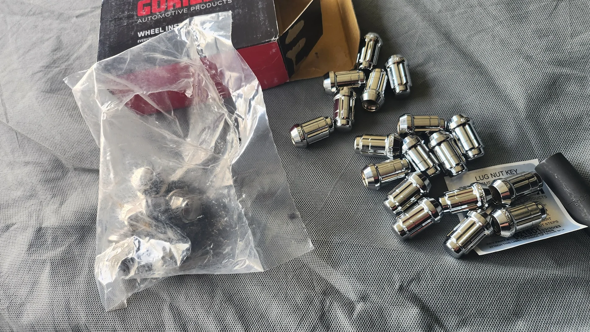

That one time I paid $3.49 for a set of 24 Gorilla wheel locks from Amazon.

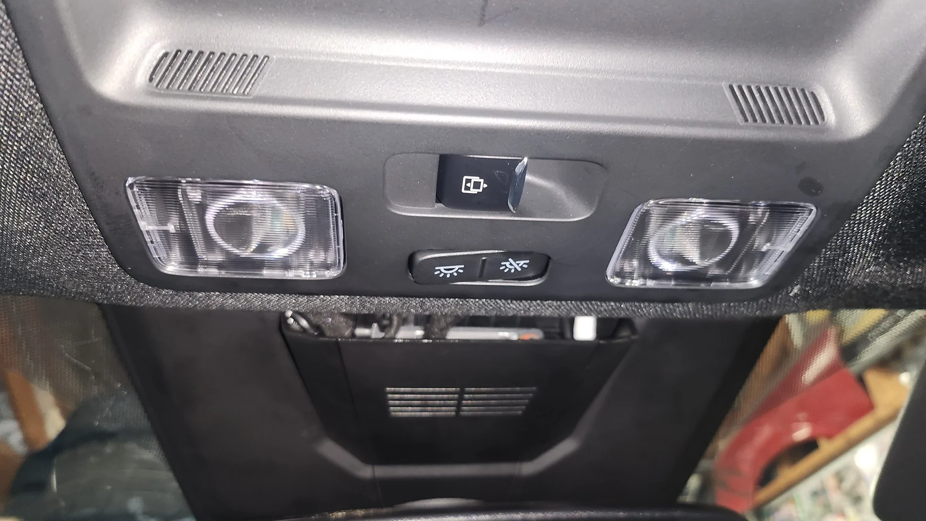

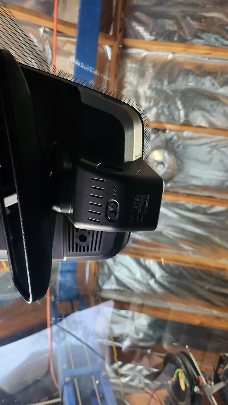

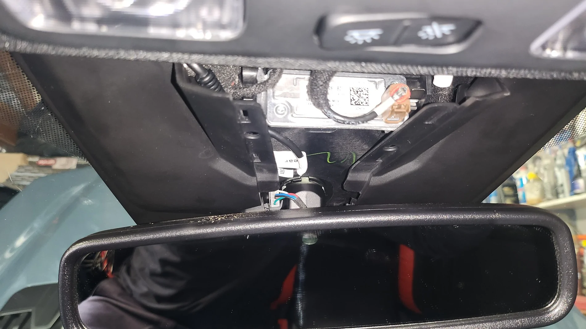

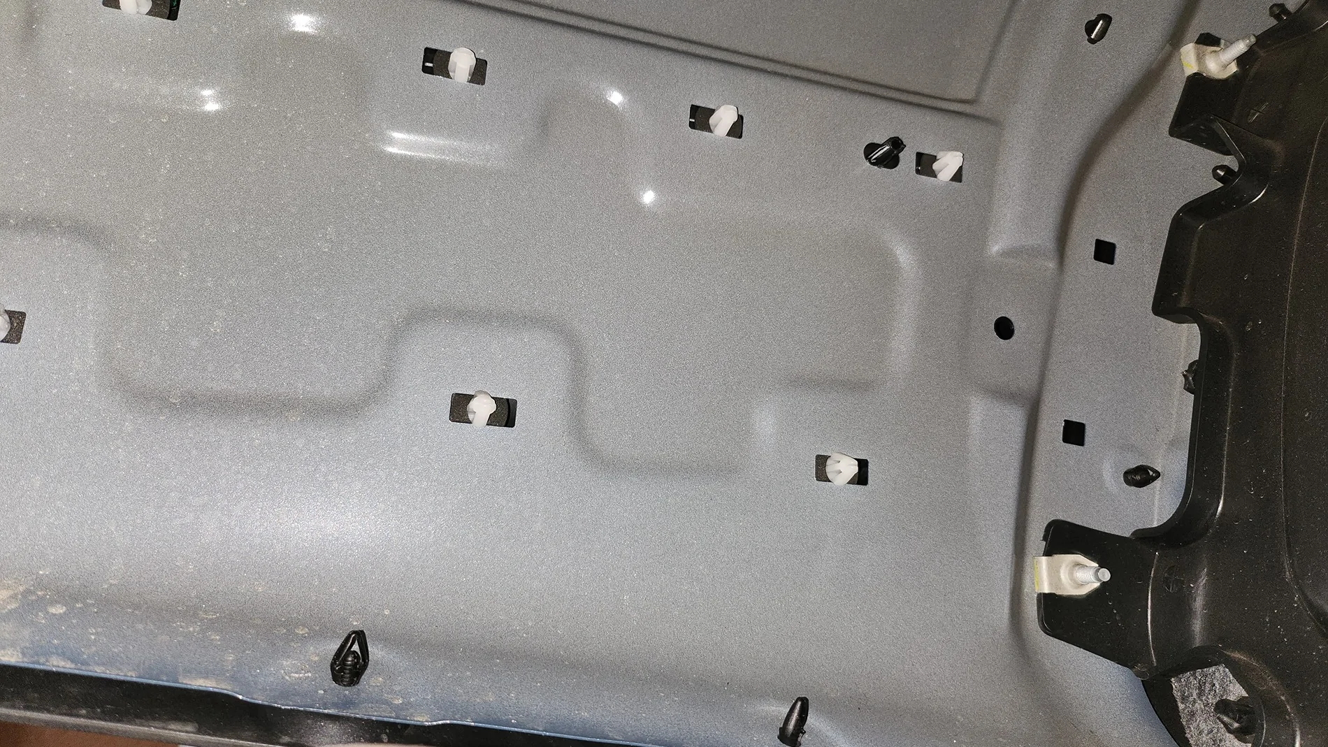

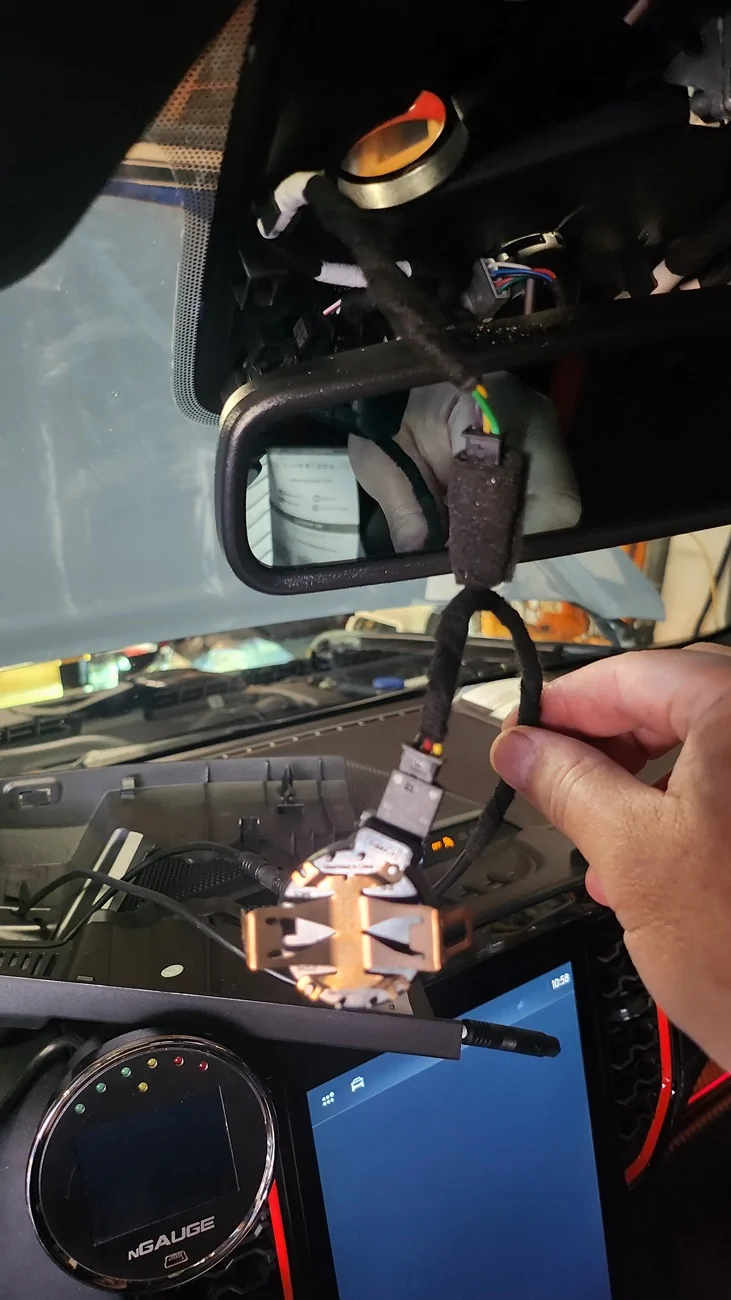

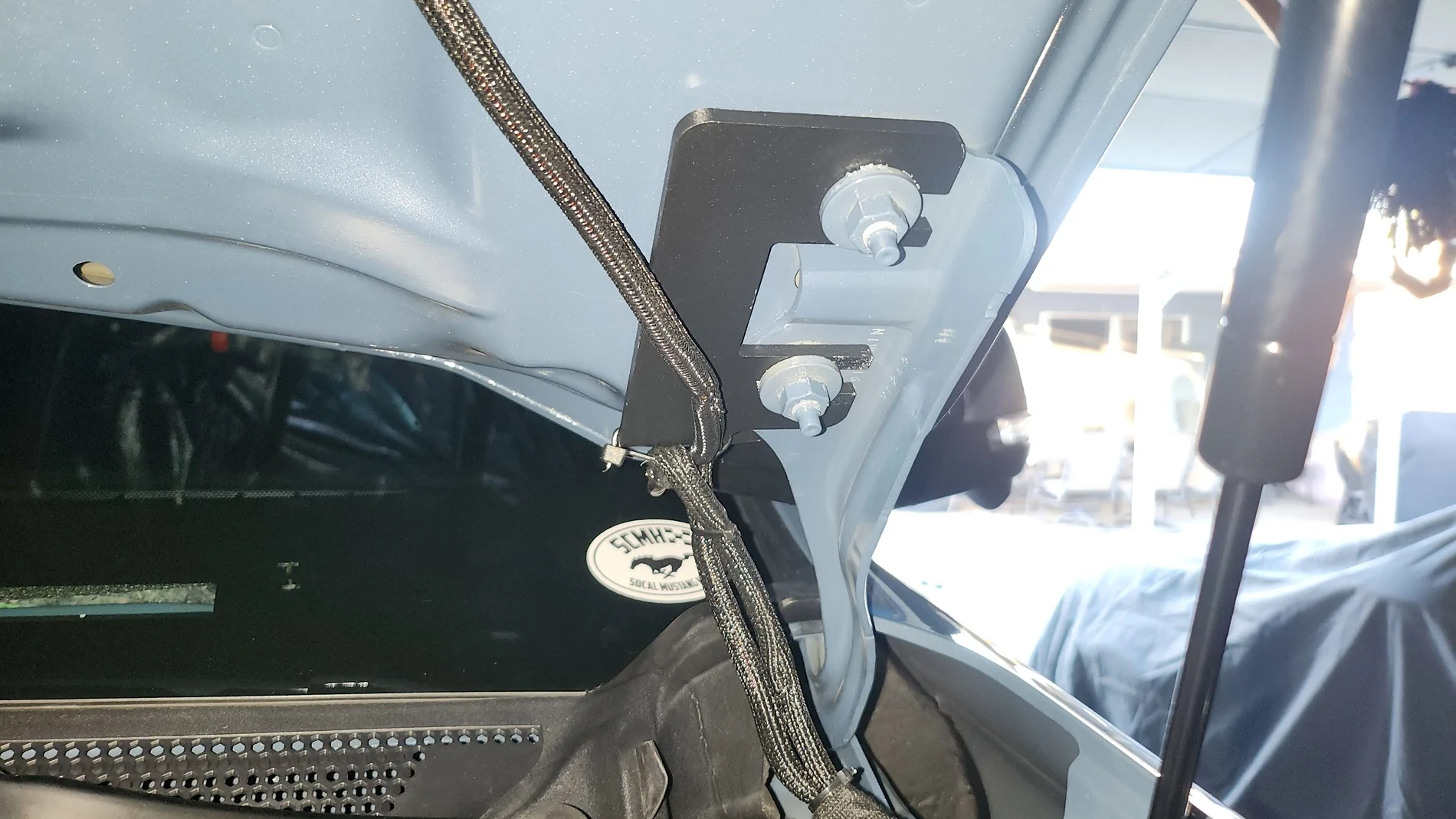

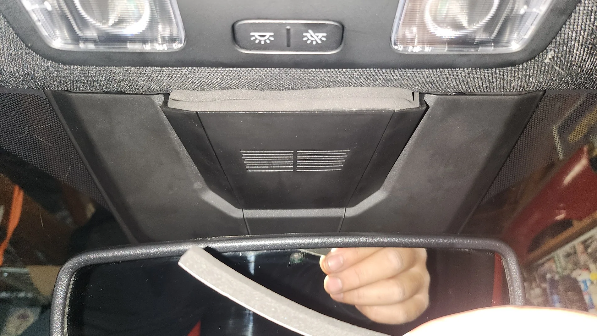

Fitcamx Dash cam. 80% fit. Front doesn't perfectly clip in but it's secure and the harness plugs right in. There is a gap at the rear where it should meet the headliner. Added a couple straps is foam to fill the gap. I'll sort out the rear camera later as the included one isn't water resistant and I want to mount it near the rear bumper area.
Ford Ranger RC MUSTANG Azure Gray Raptor Build 20260120_161851
Ford Ranger RC MUSTANG Azure Gray Raptor Build 20260120_160230
Ford Ranger RC MUSTANG Azure Gray Raptor Build 20260120_162045
Ford Ranger RC MUSTANG Azure Gray Raptor Build 20260120_162751
Ford Ranger RC MUSTANG Azure Gray Raptor Build 20260120_161846

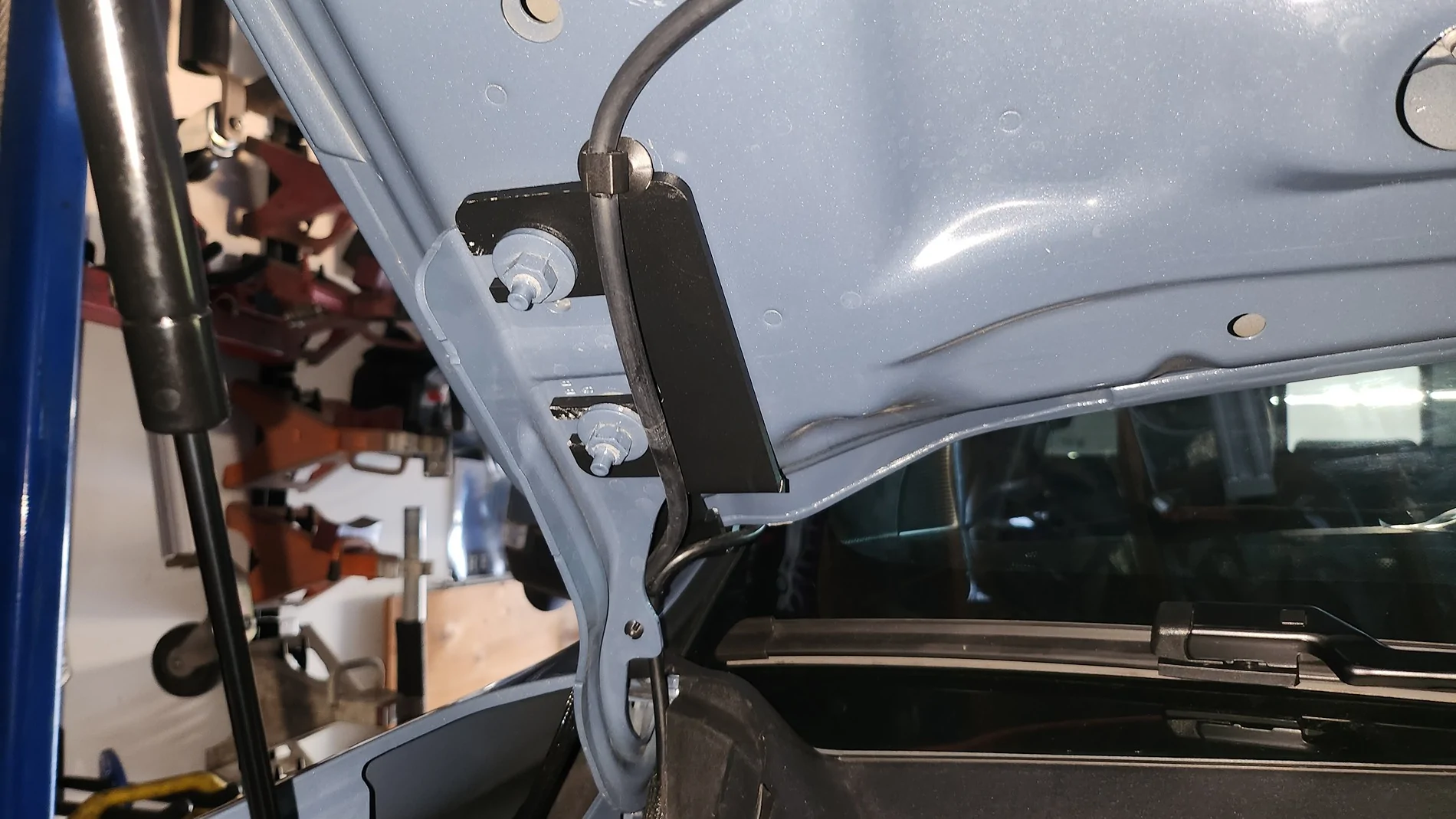

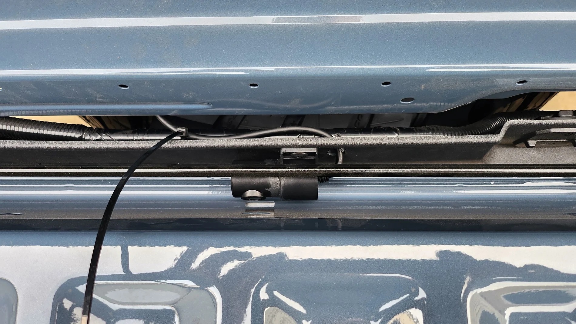

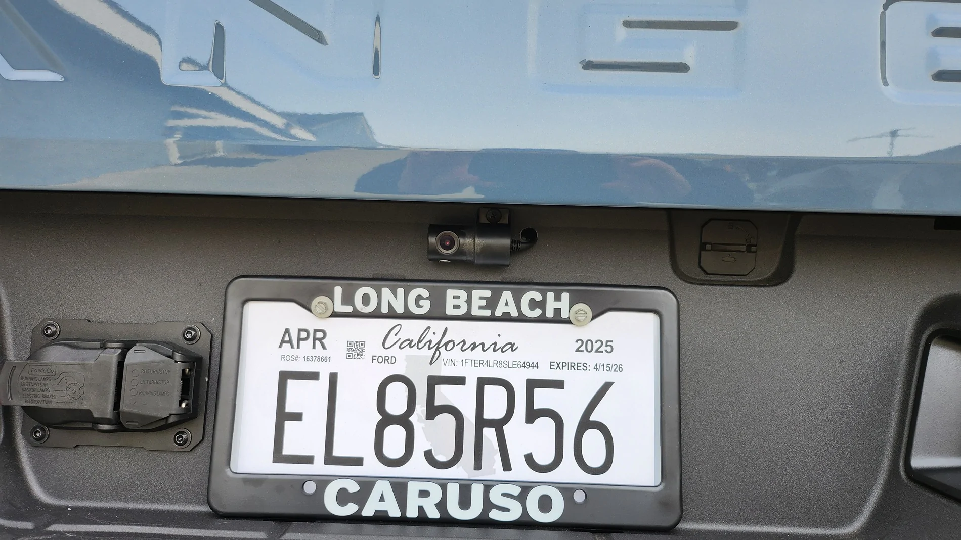

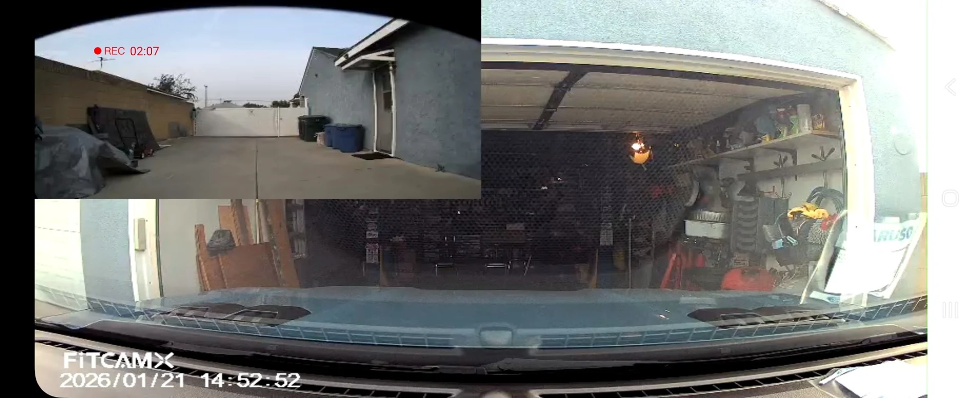

Perfect spot for the rear dash cam. Tucks perfect even with the tailgate down. Cable was just long enough. Had to try and waterproof it but running silicone around the area where cam joins the main body as it was meant for inside mounting. Let's see if it works.

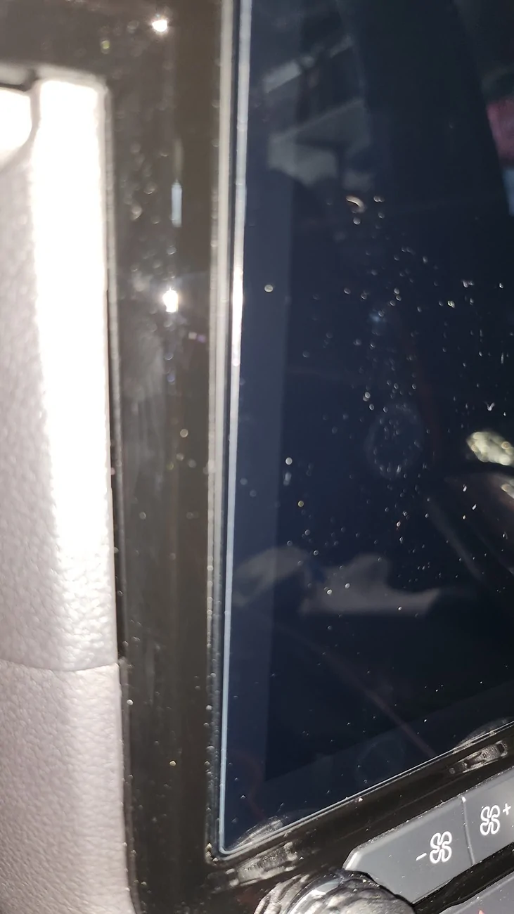

Tempered glass screen protector.

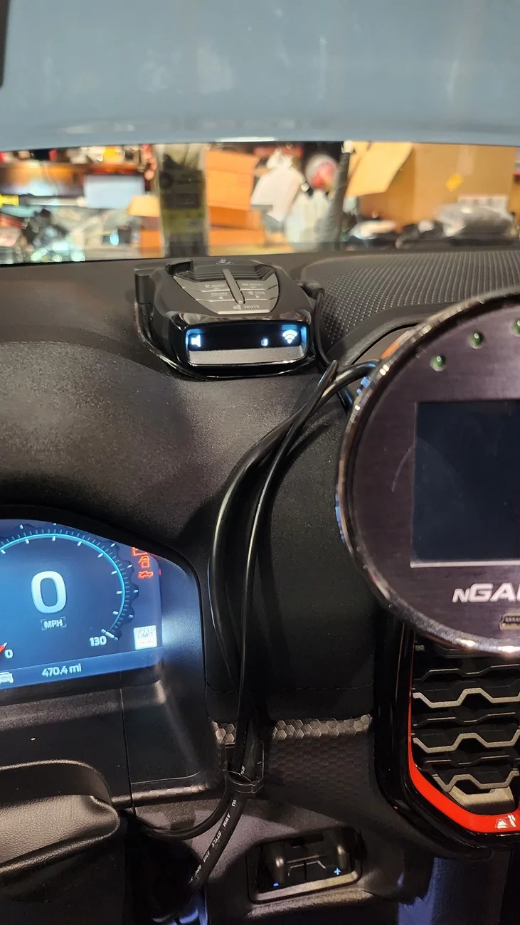

Radar detector hardwired.

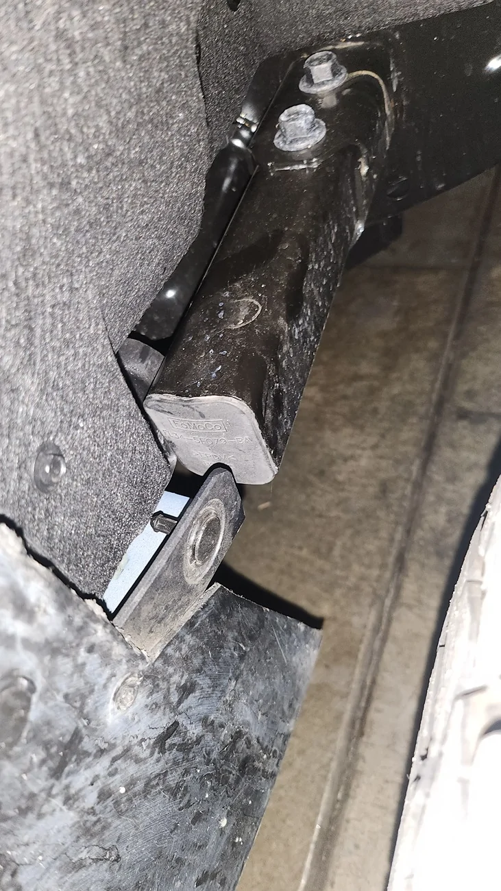

Was able to reuse rear crash bar plugs. Should keep the moisture out.
Ford Ranger RC MUSTANG Azure Gray Raptor Build 20260122_154644
Ford Ranger RC MUSTANG Azure Gray Raptor Build 20260202_100846
Ford Ranger RC MUSTANG Azure Gray Raptor Build 20260202_100921

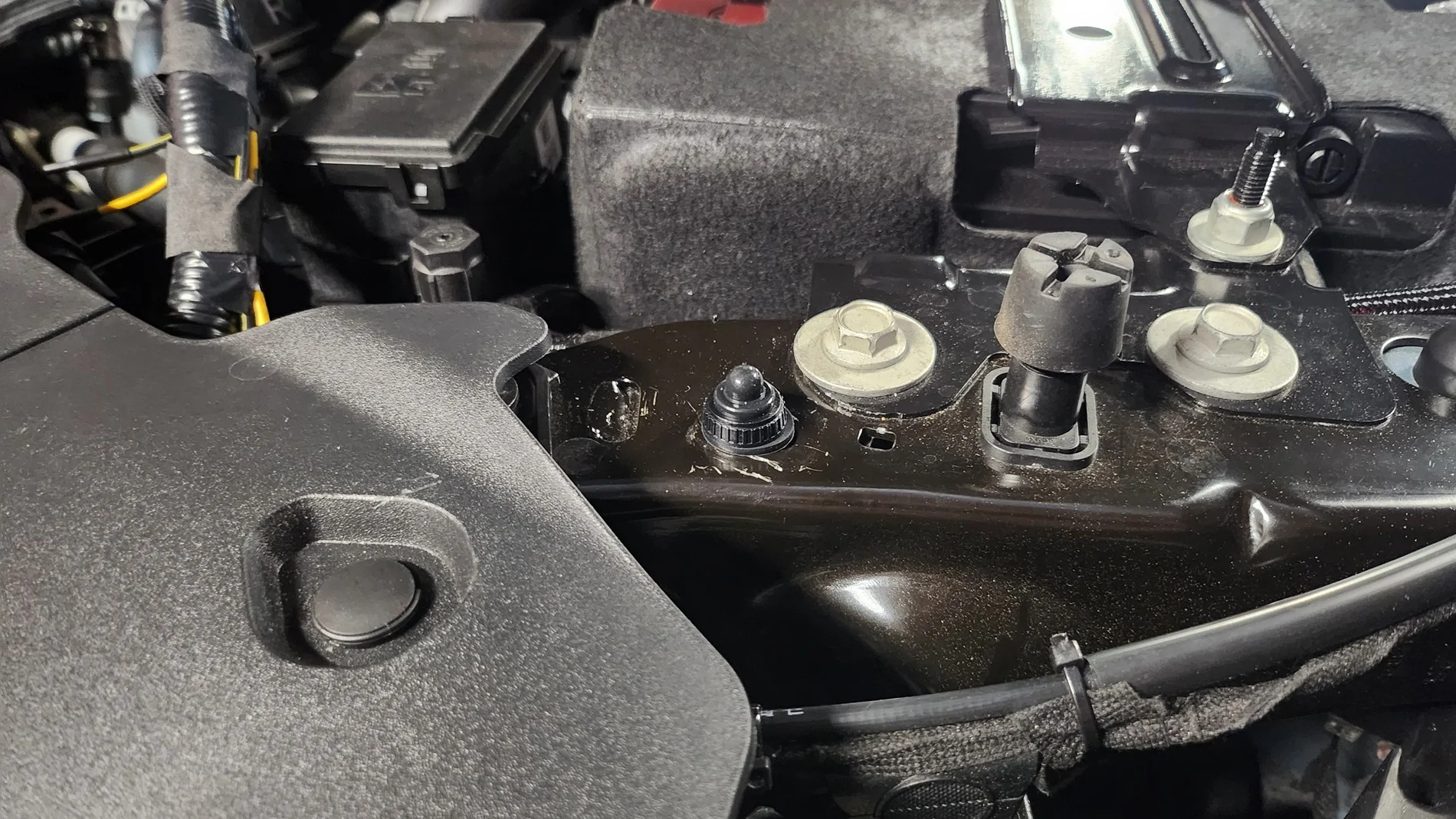

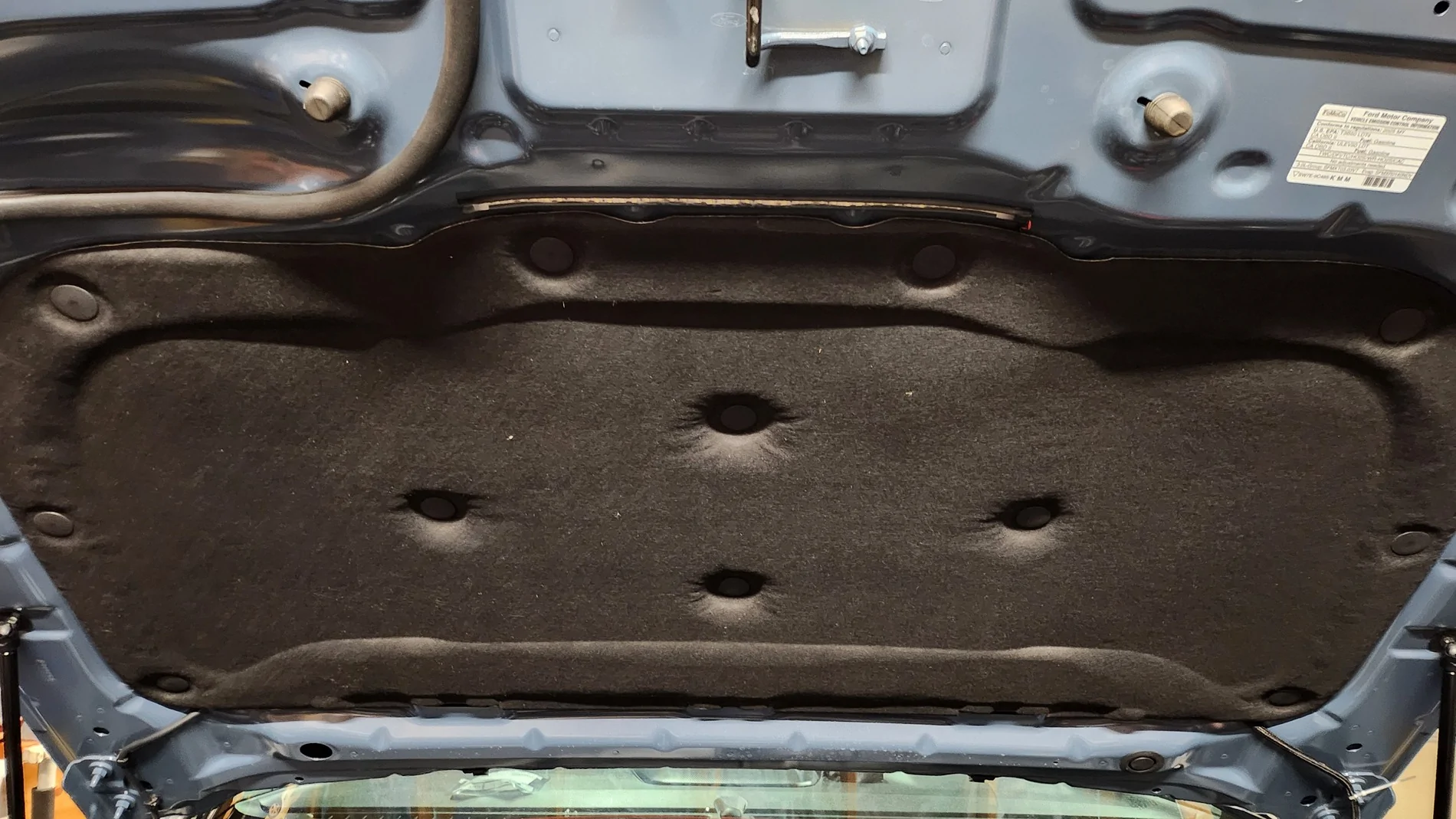

Under hood light. Just need to order another switch. Can't find the one I took off the 2019. 😒

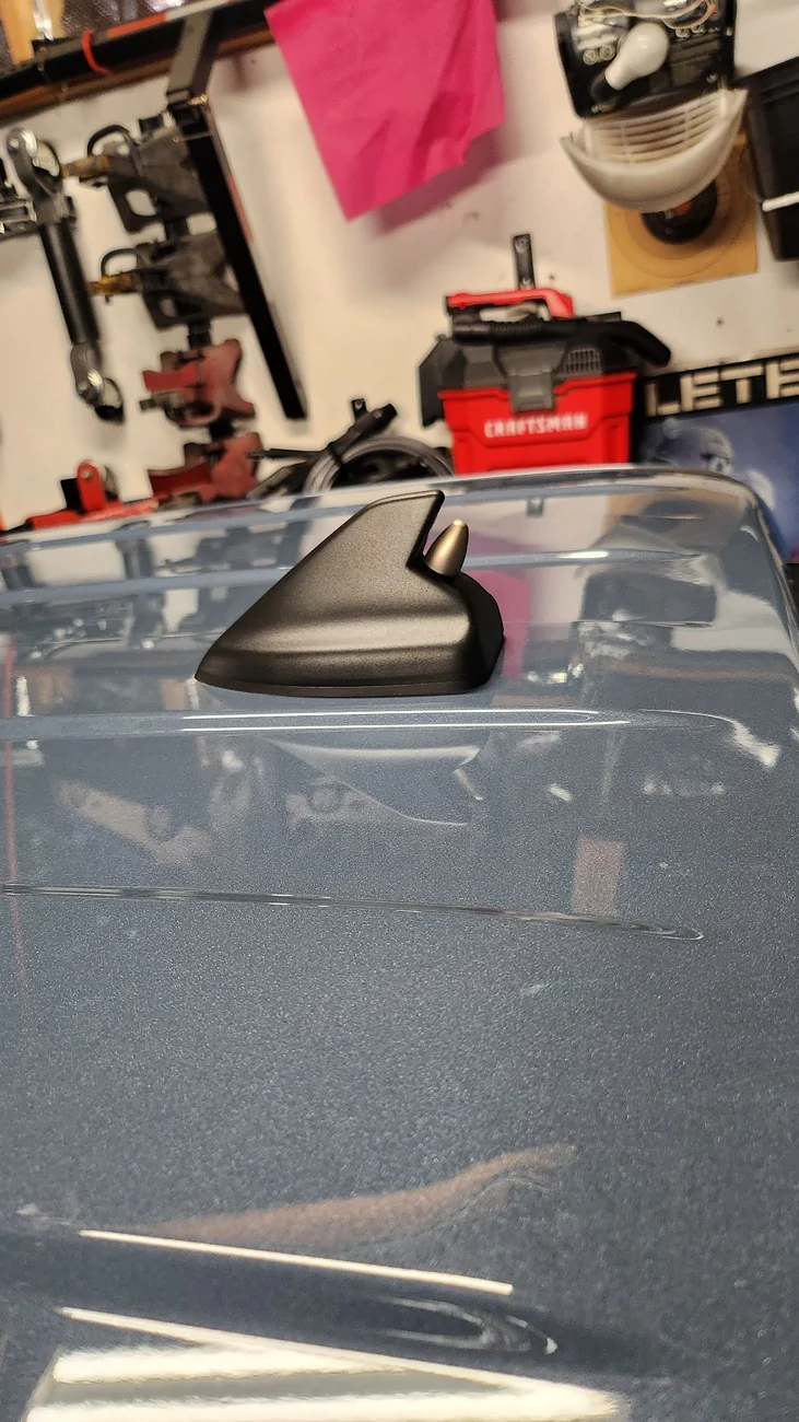

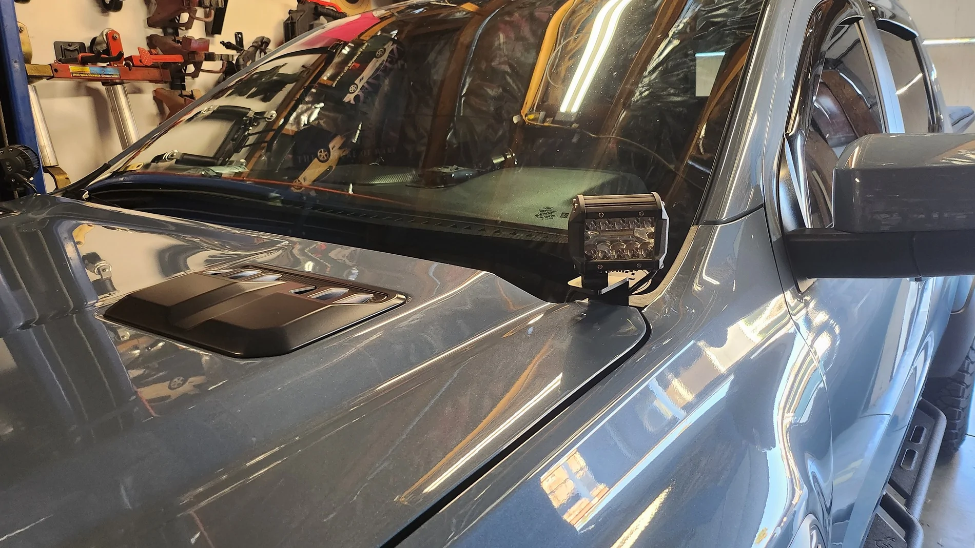

Ditch lights done. Connected to Aux switch 5. Have to say the driver mirror is so big I can't see much of what's lit on that side. 😂

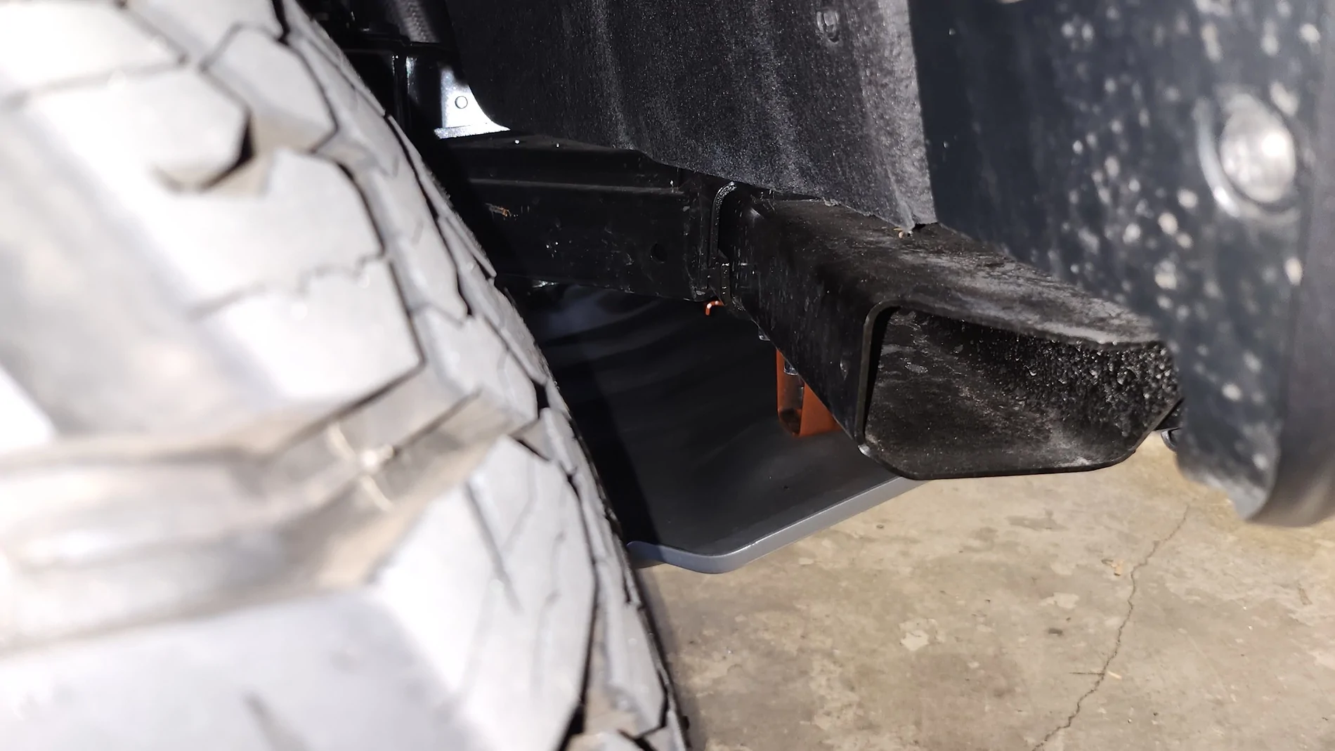

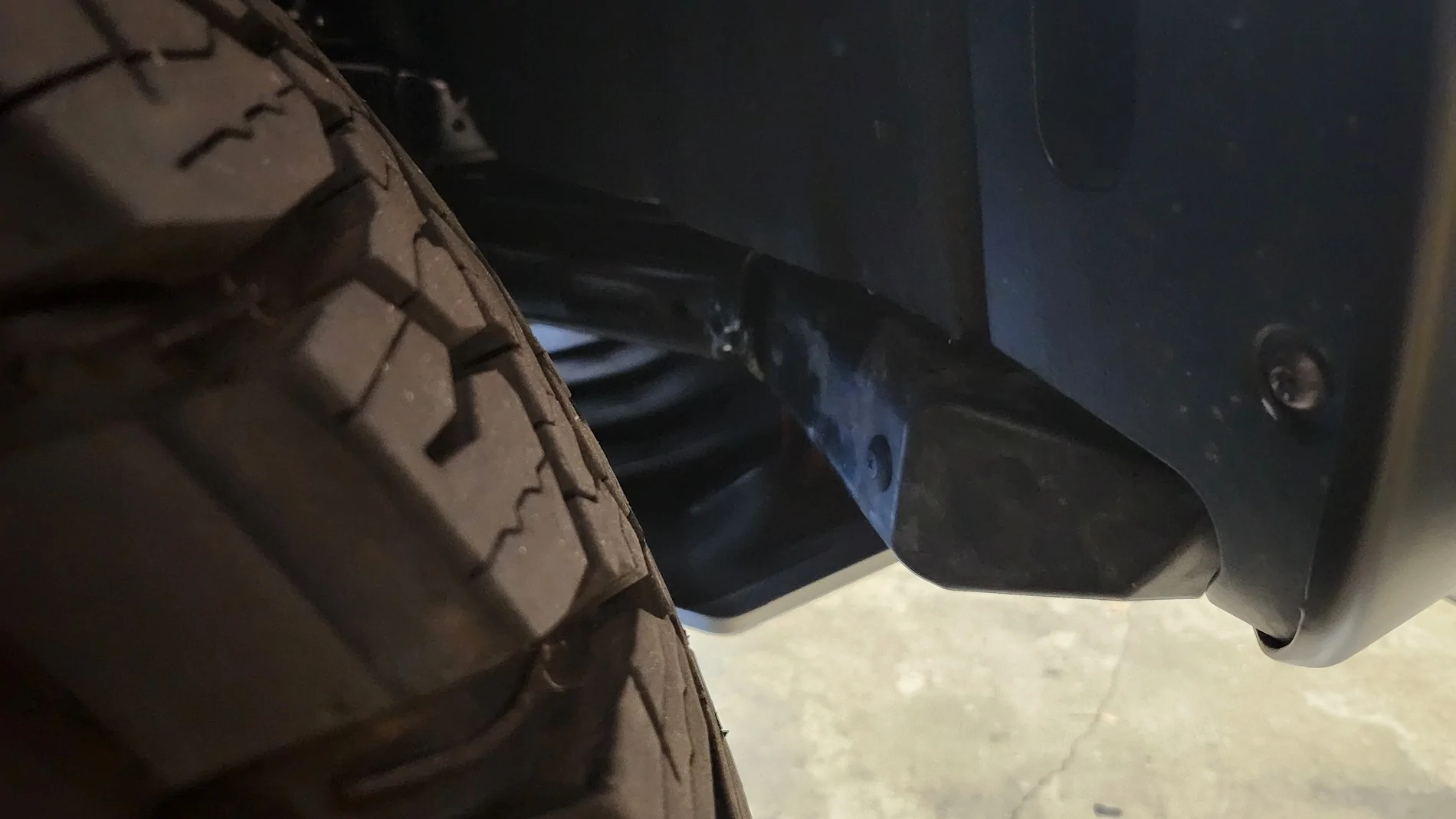

Bad news for Raptor owners. Unless you want to cut sheet metal out bedside steps are not an option.

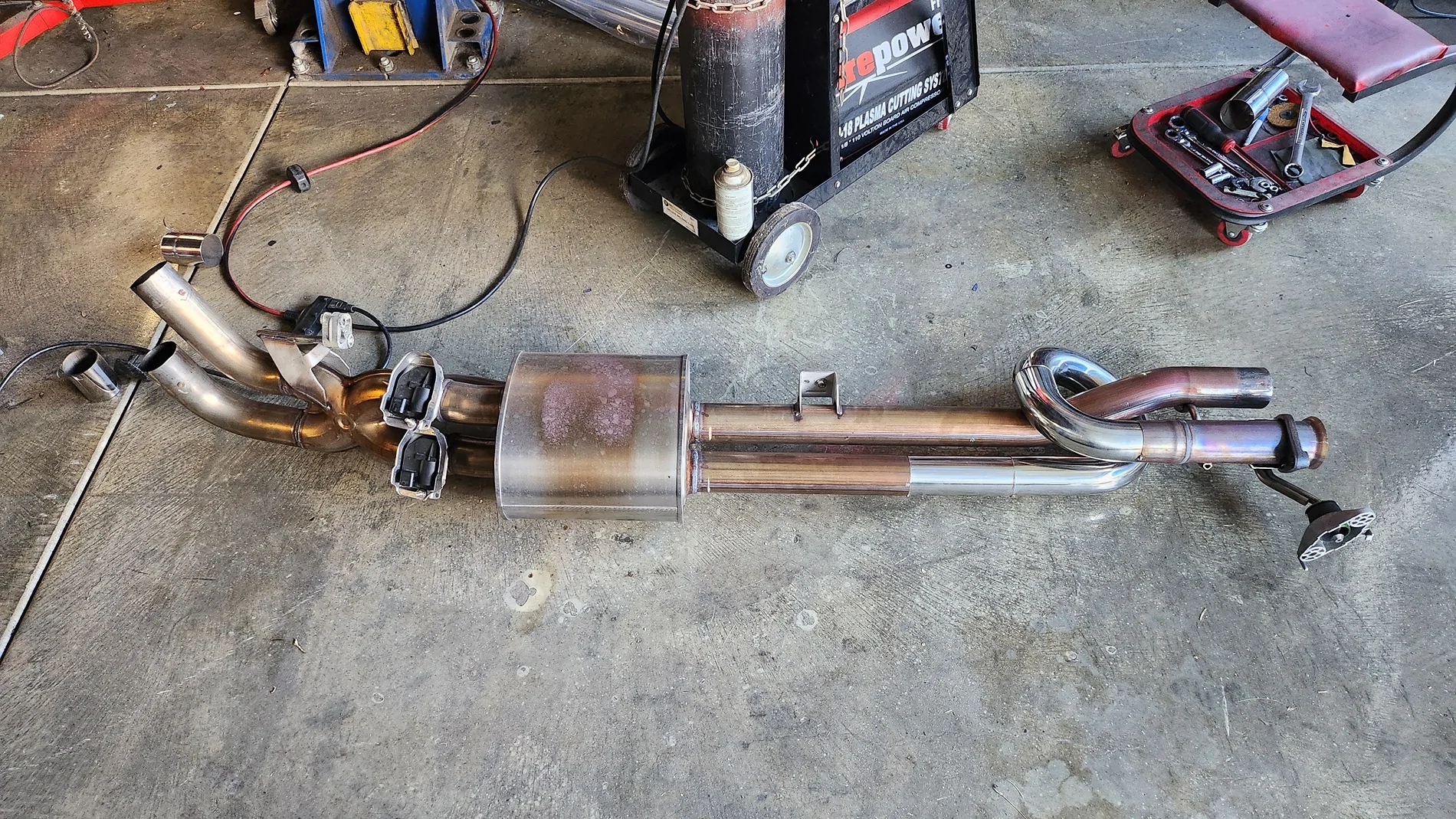

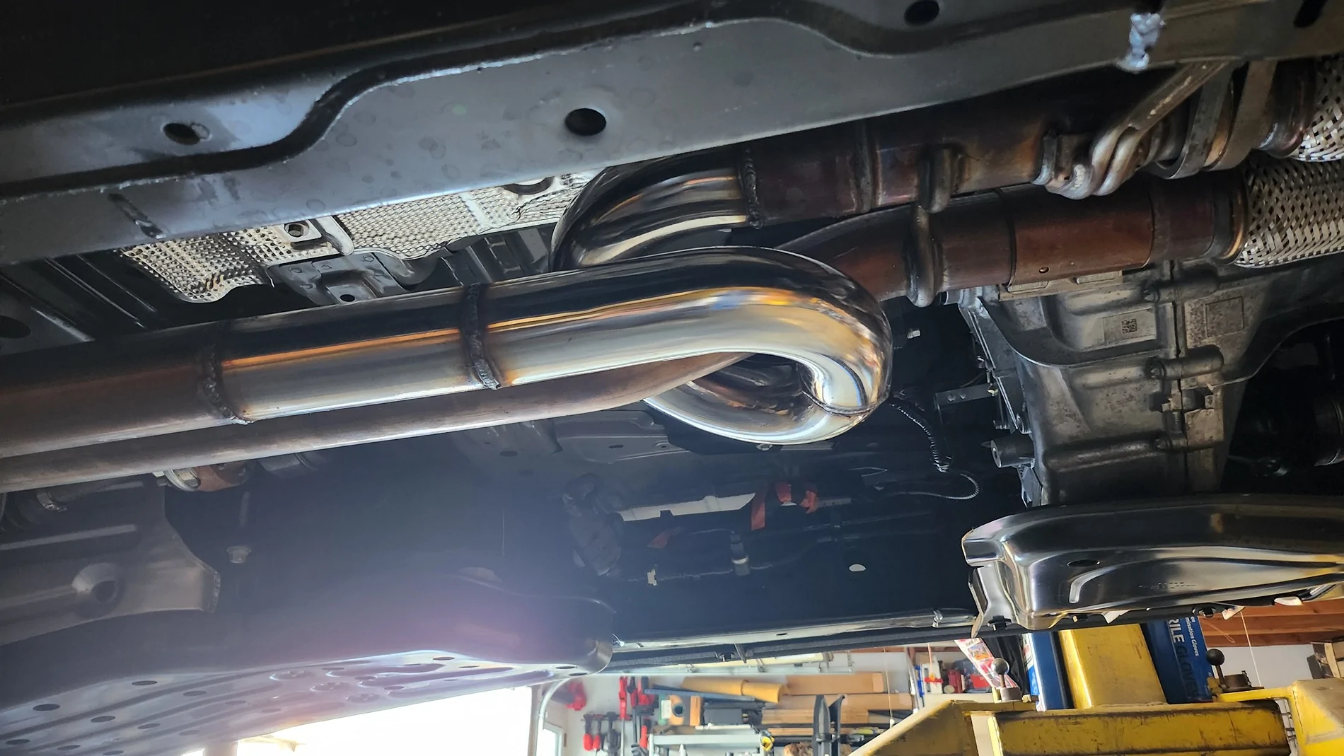

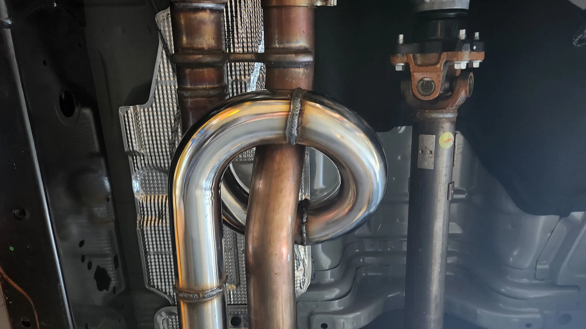

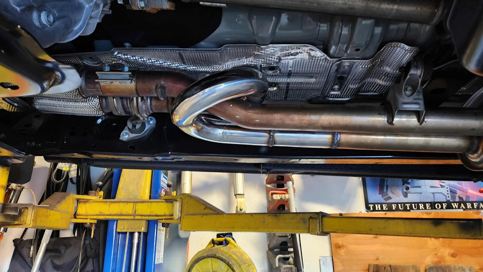

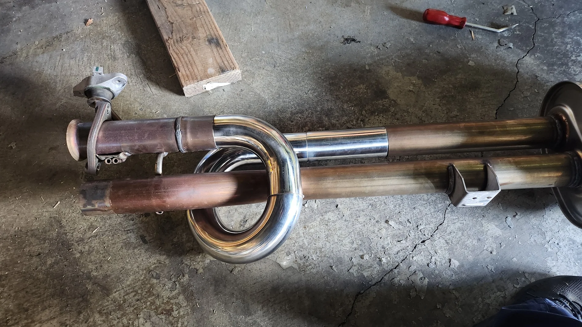

One trombone loop added. Within an inch or two of being the same length on both driver and passenger exhaust into the muffler. Should have a more tuned sounding exhaust note now.
Ford Ranger RC MUSTANG Azure Gray Raptor Build 20260124_161435
Ford Ranger RC MUSTANG Azure Gray Raptor Build 20260124_161422
Ford Ranger RC MUSTANG Azure Gray Raptor Build 20260124_161408
Ford Ranger RC MUSTANG Azure Gray Raptor Build 20260124_144156
Ford Ranger RC MUSTANG Azure Gray Raptor Build 20260124_144124

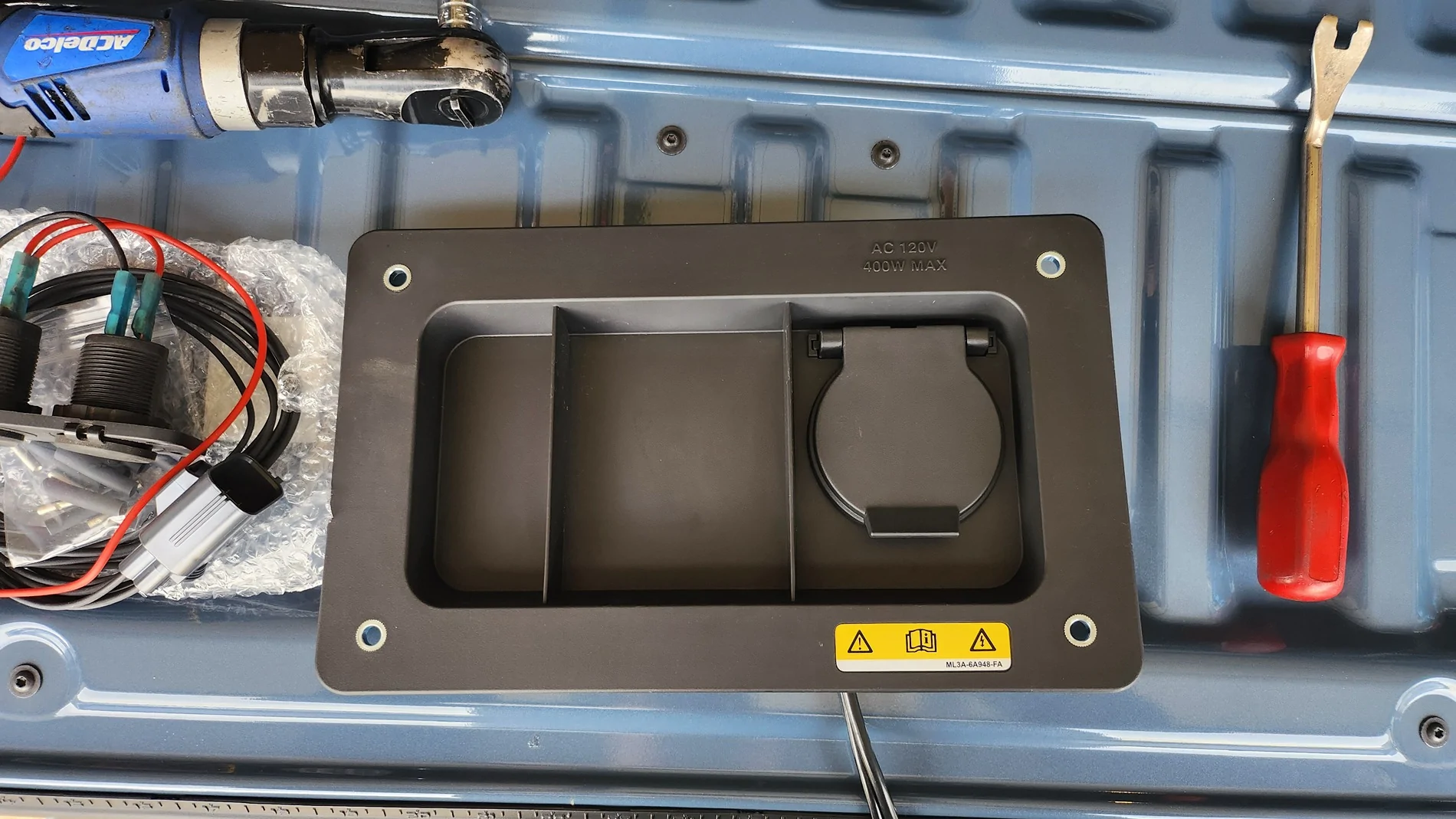

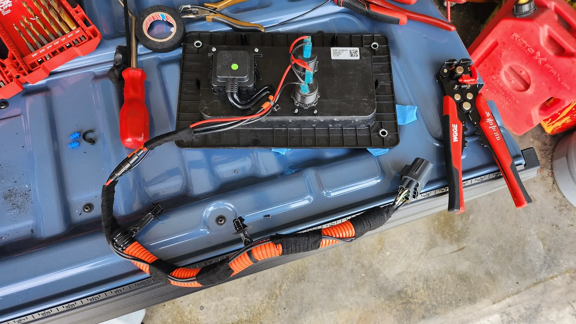

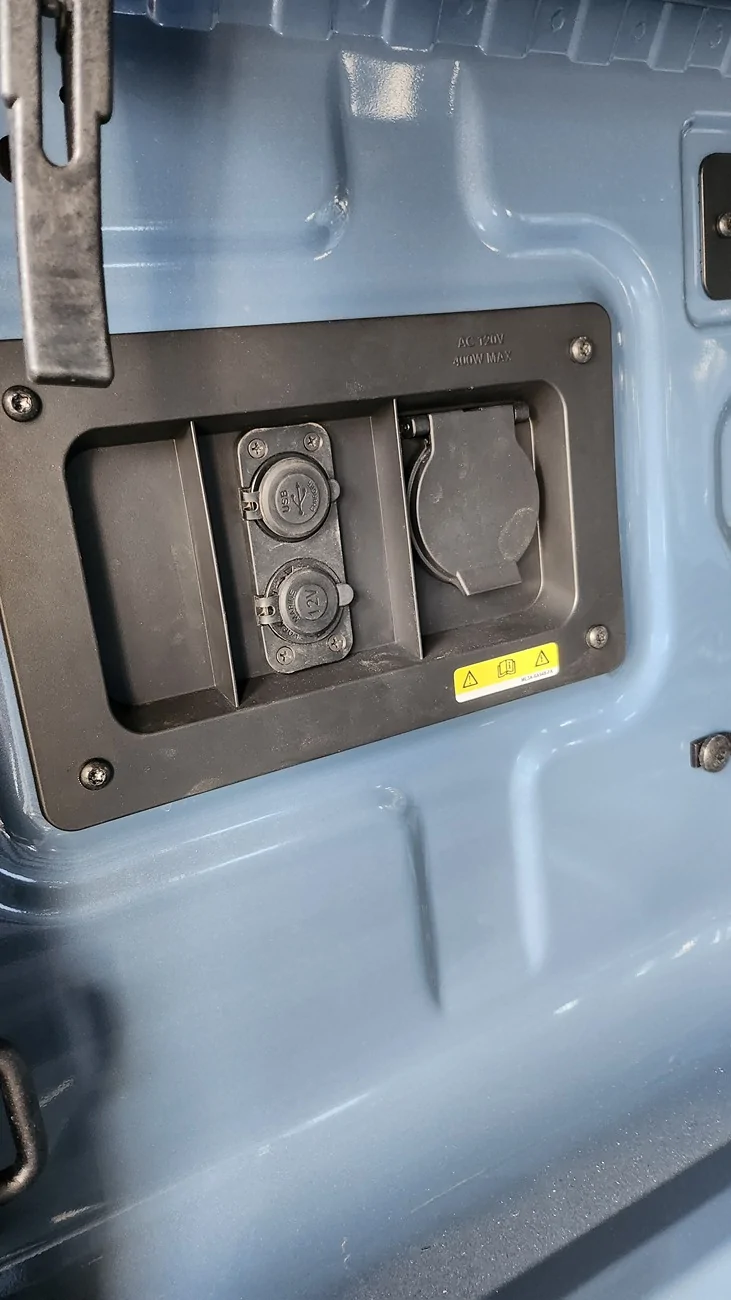

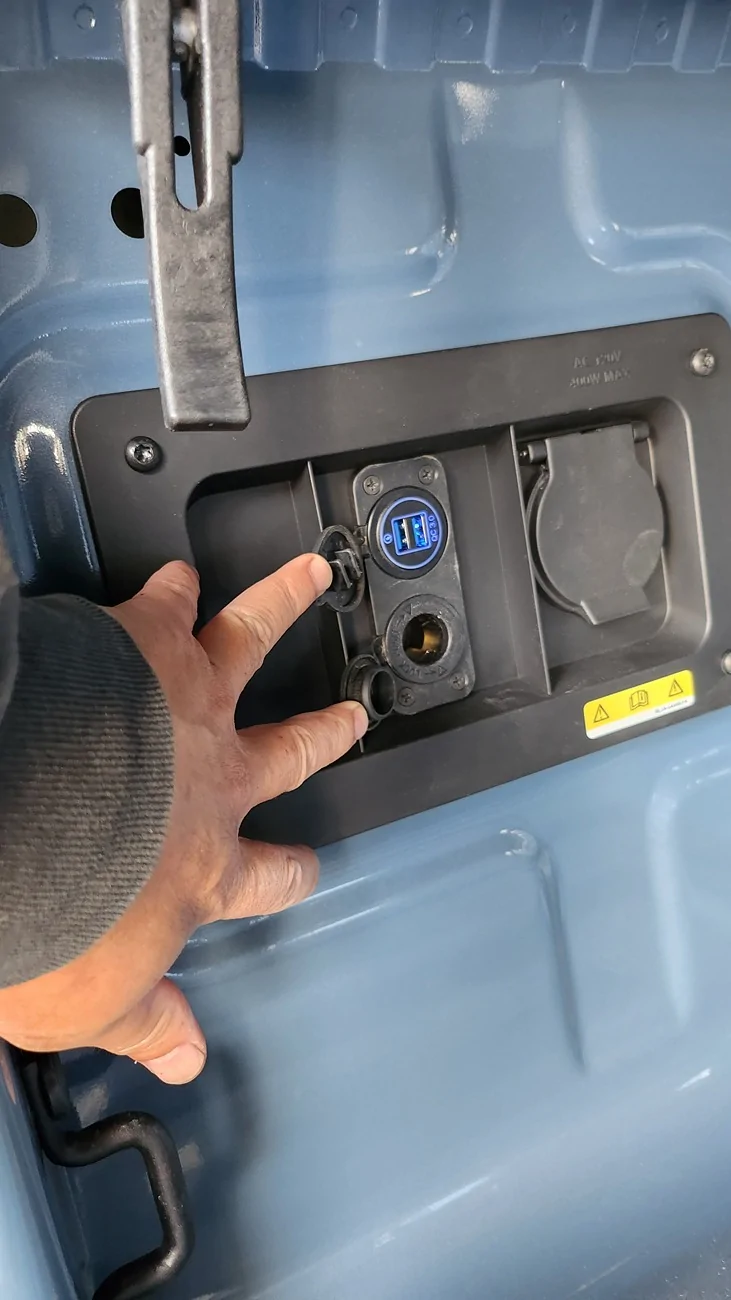

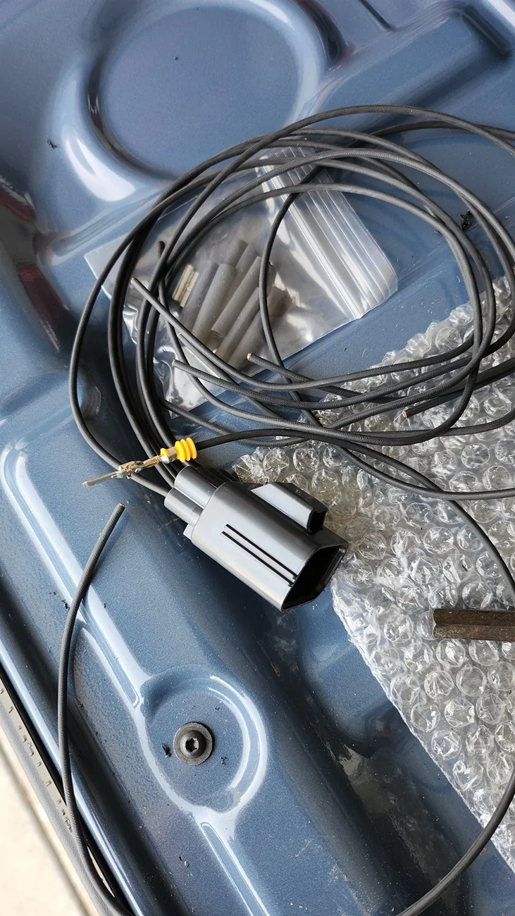

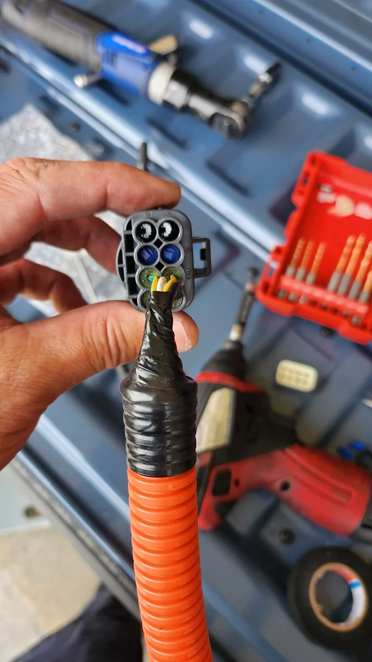

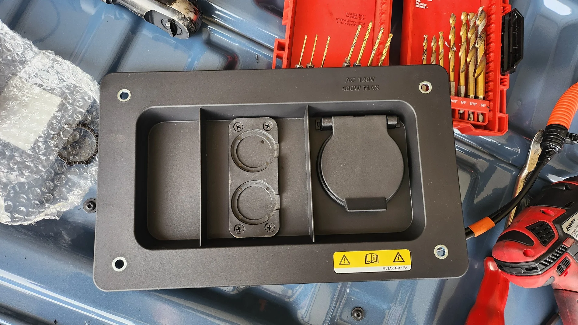

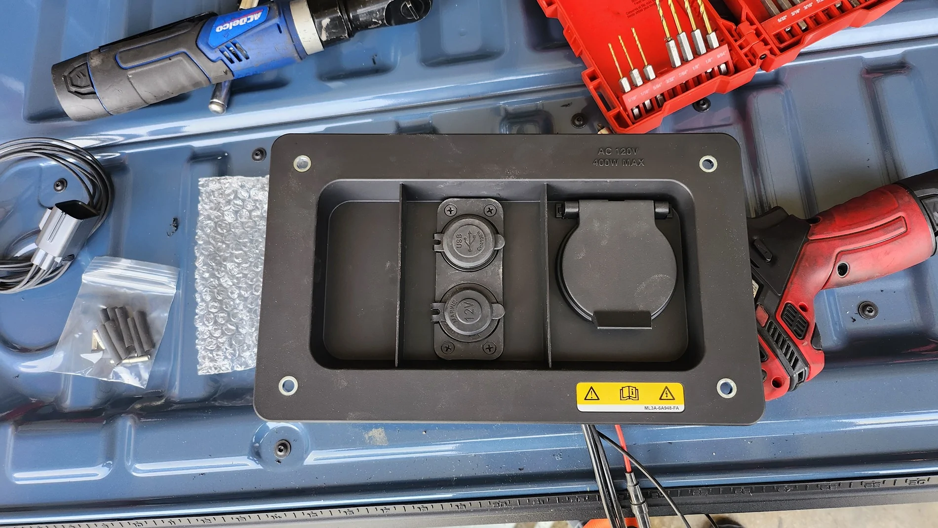

Installed 12 volt and USB outlets. Bought the complete pigtail for the terminals pre-crimped.
Ford Ranger RC MUSTANG Azure Gray Raptor Build 20260125_102002
Ford Ranger RC MUSTANG Azure Gray Raptor Build 20260125_103609
Ford Ranger RC MUSTANG Azure Gray Raptor Build 20260125_104703
Ford Ranger RC MUSTANG Azure Gray Raptor Build 20260125_105613
Ford Ranger RC MUSTANG Azure Gray Raptor Build 20260125_105928
Ford Ranger RC MUSTANG Azure Gray Raptor Build 20260125_111125
Ford Ranger RC MUSTANG Azure Gray Raptor Build 20260125_132120
Ford Ranger RC MUSTANG Azure Gray Raptor Build 20260125_132125
