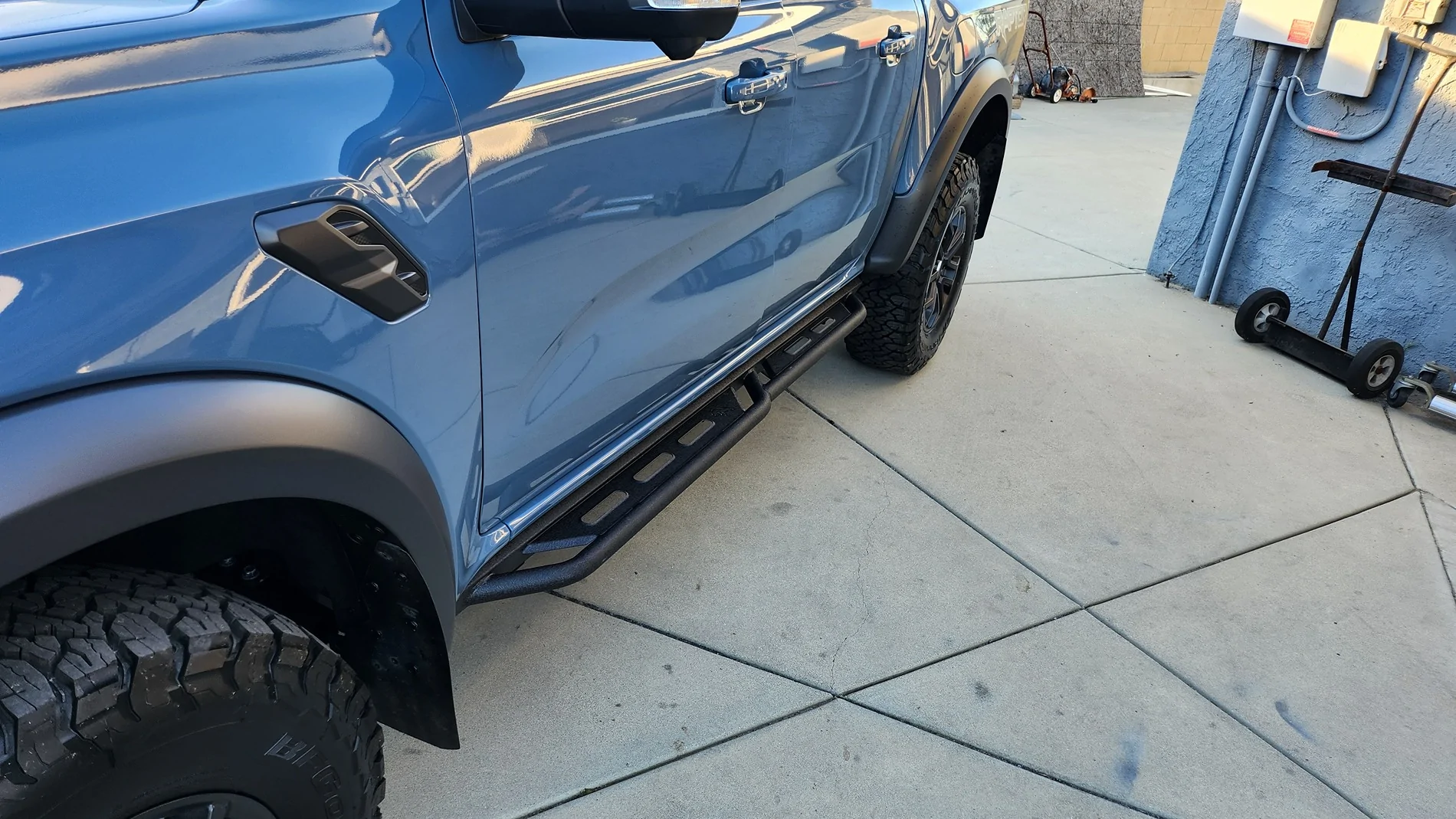

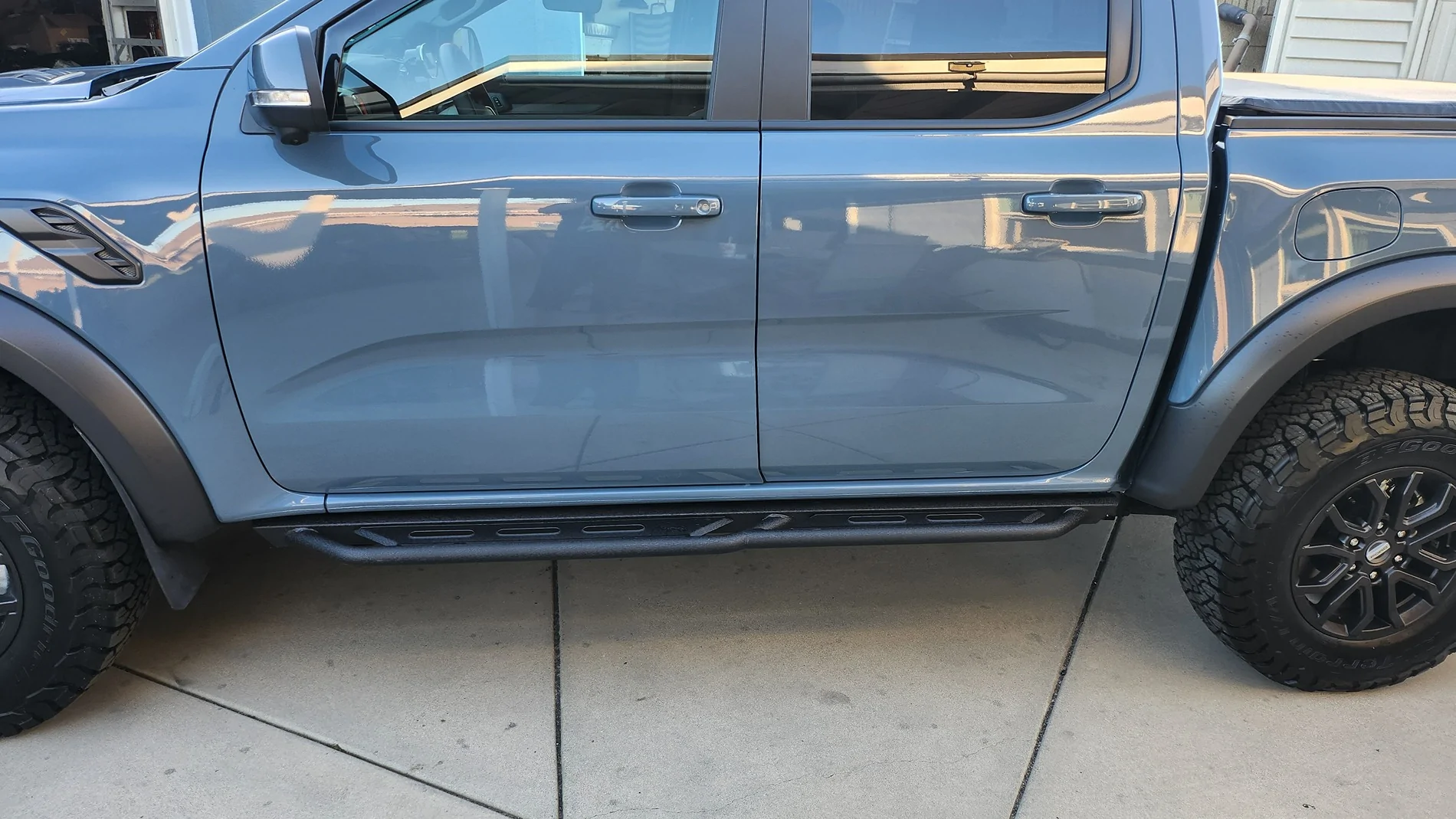

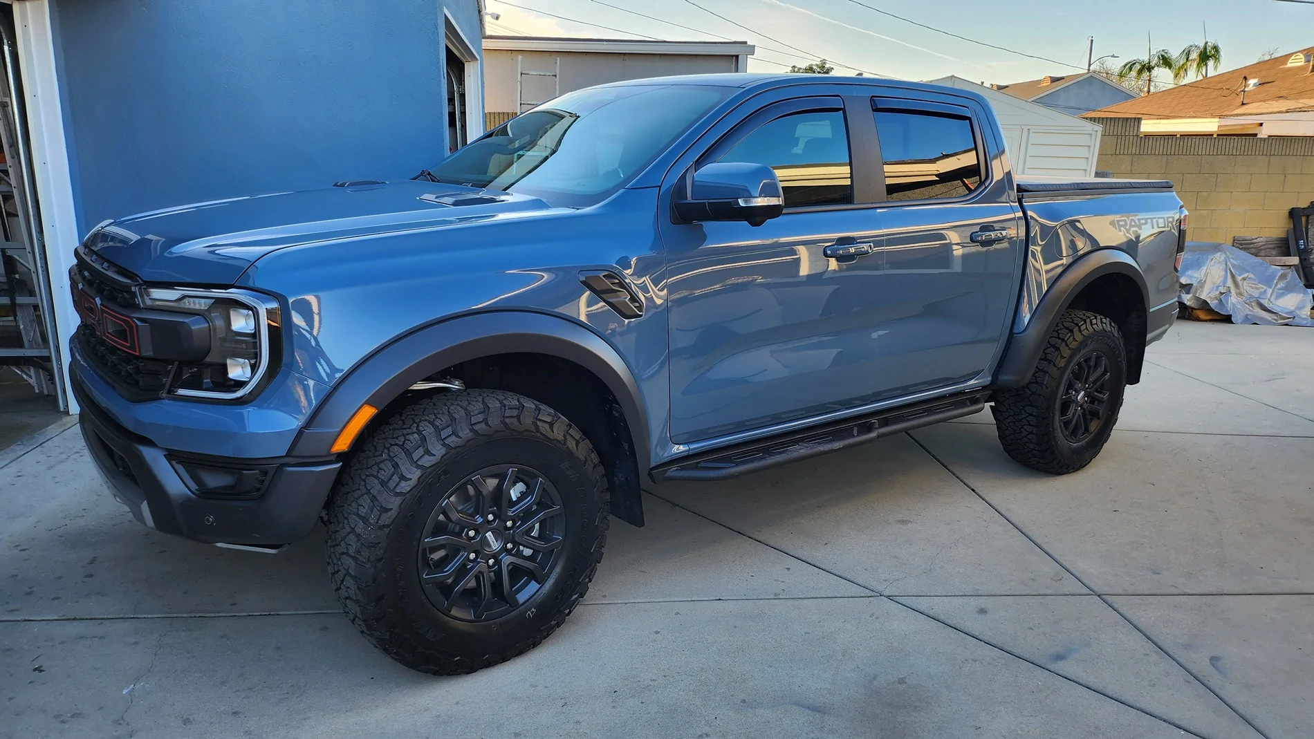

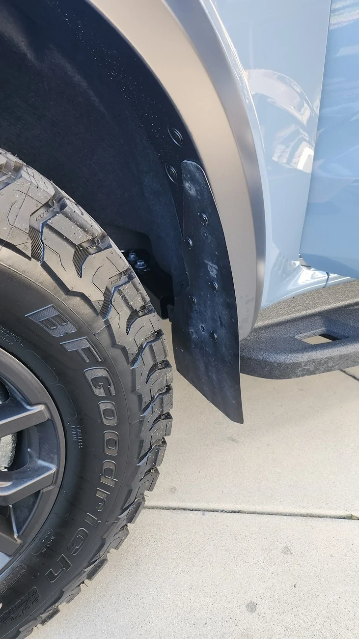

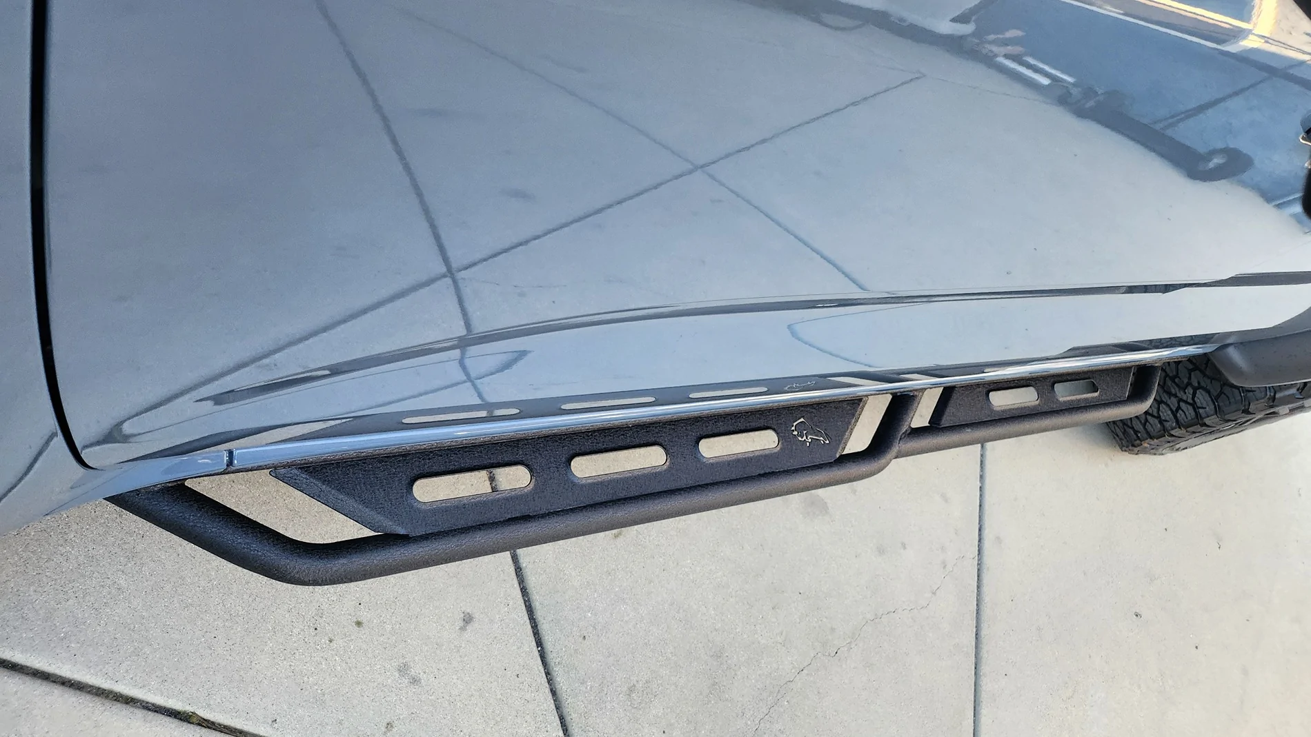

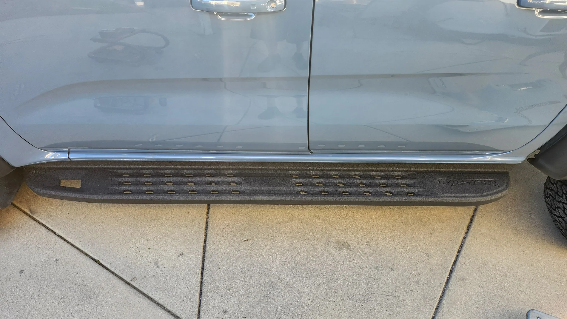

Recycled the mud flaps from the 2019. With the mud flaps I shouldn't have to worry about rock chips along the doors and the needed extra protection of the surfboard sized stock steps. Upgraded up these tubular ones for more clearance and better look.

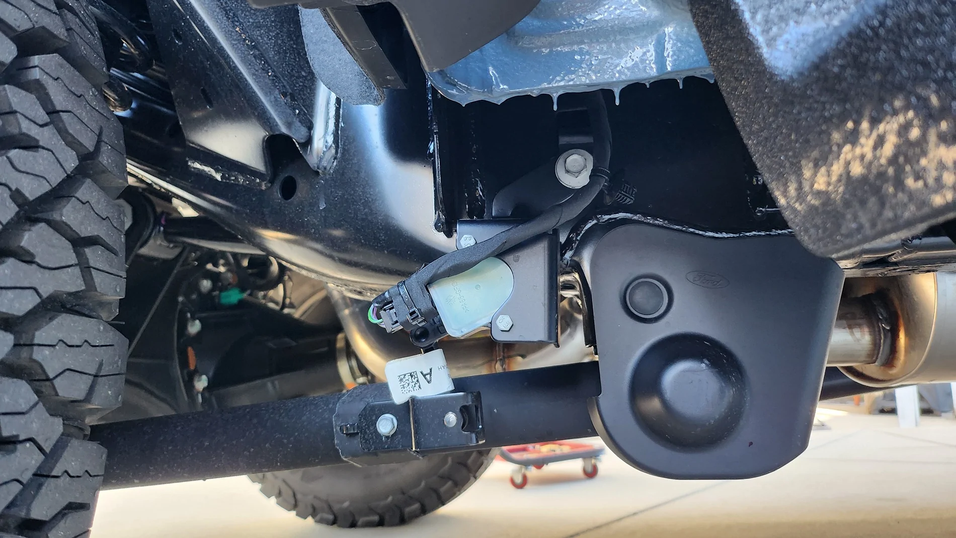

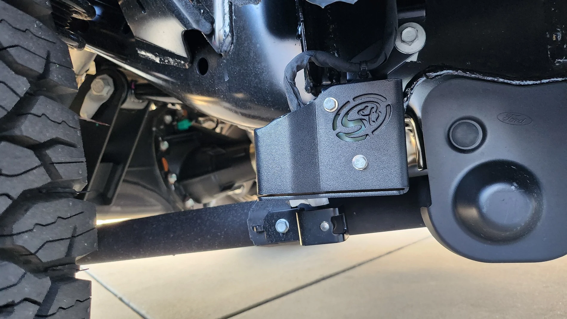

Ford decided to leave these ride height sensors just out there. A good blast through water can pop the connector off. S&B sensor guards.

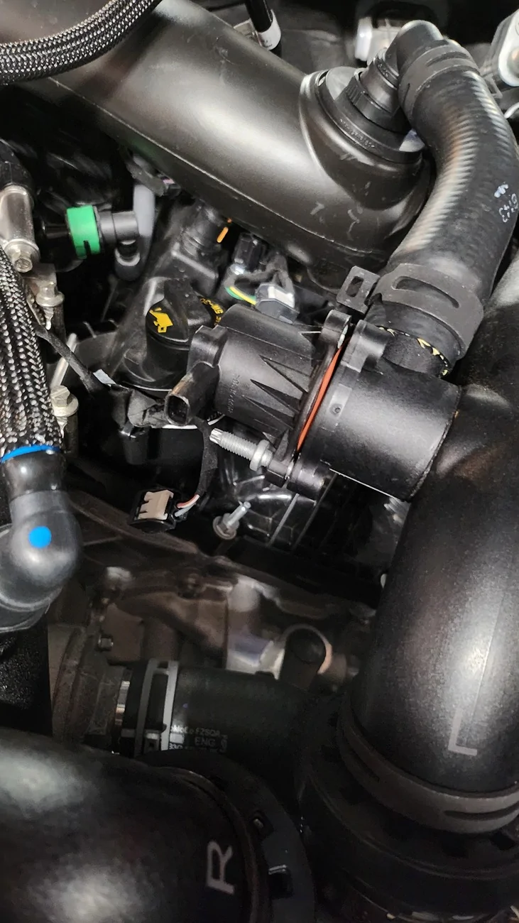

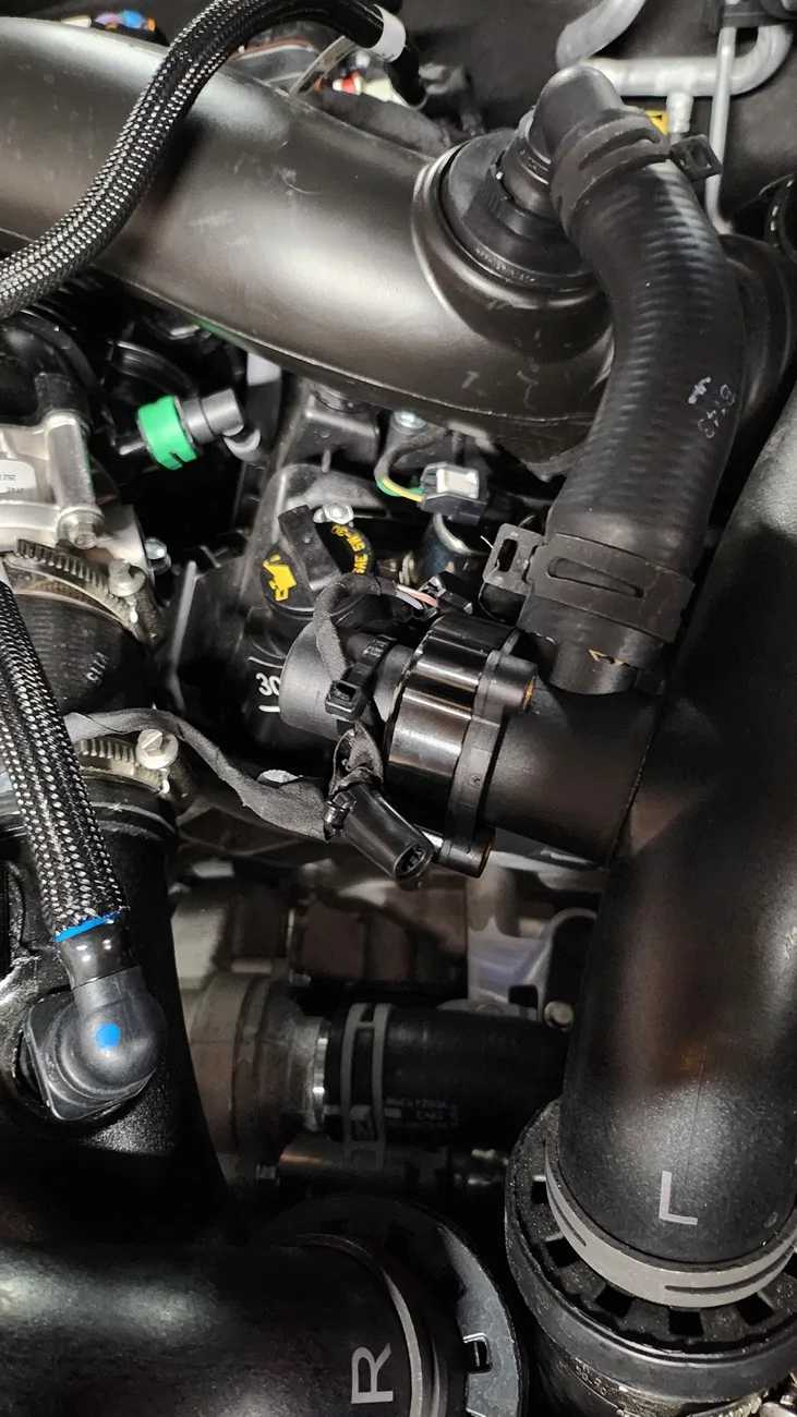

GFB progressive bypass valve. Quicker boost recovery over the stock on/ off operation and no boost leakage. Makes drivability much better.

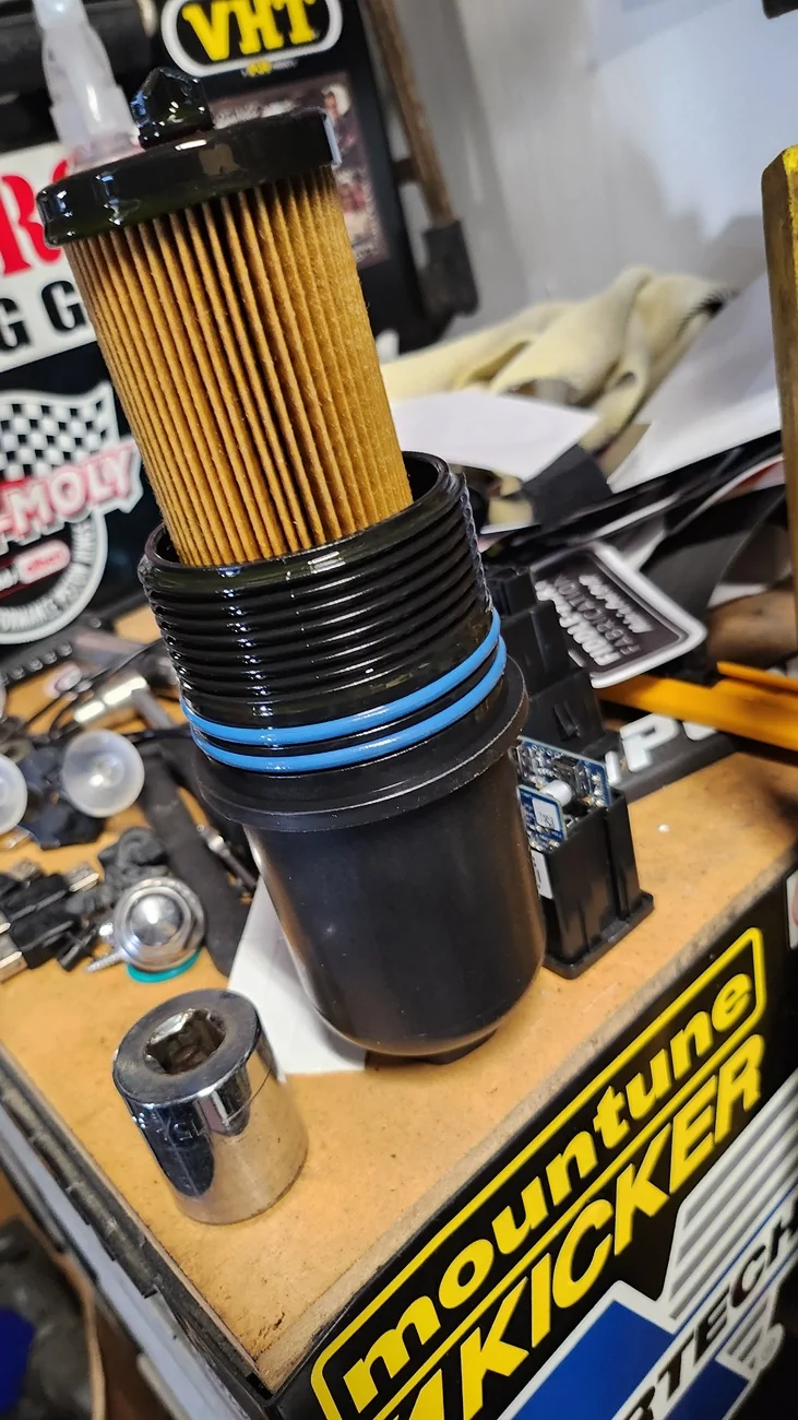

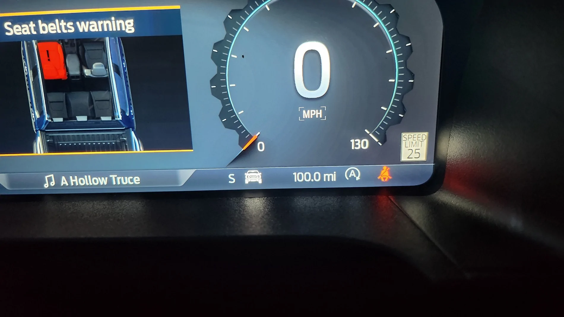

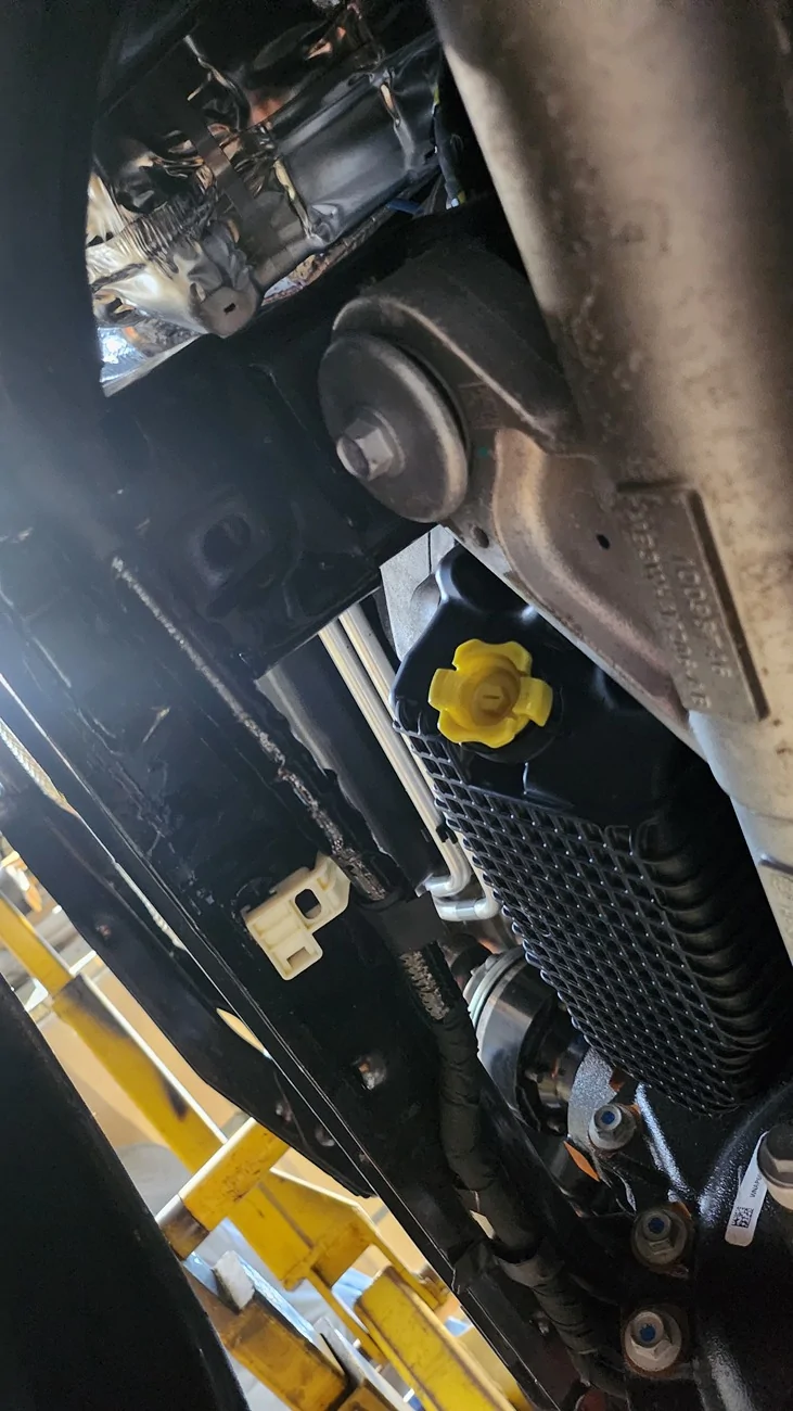

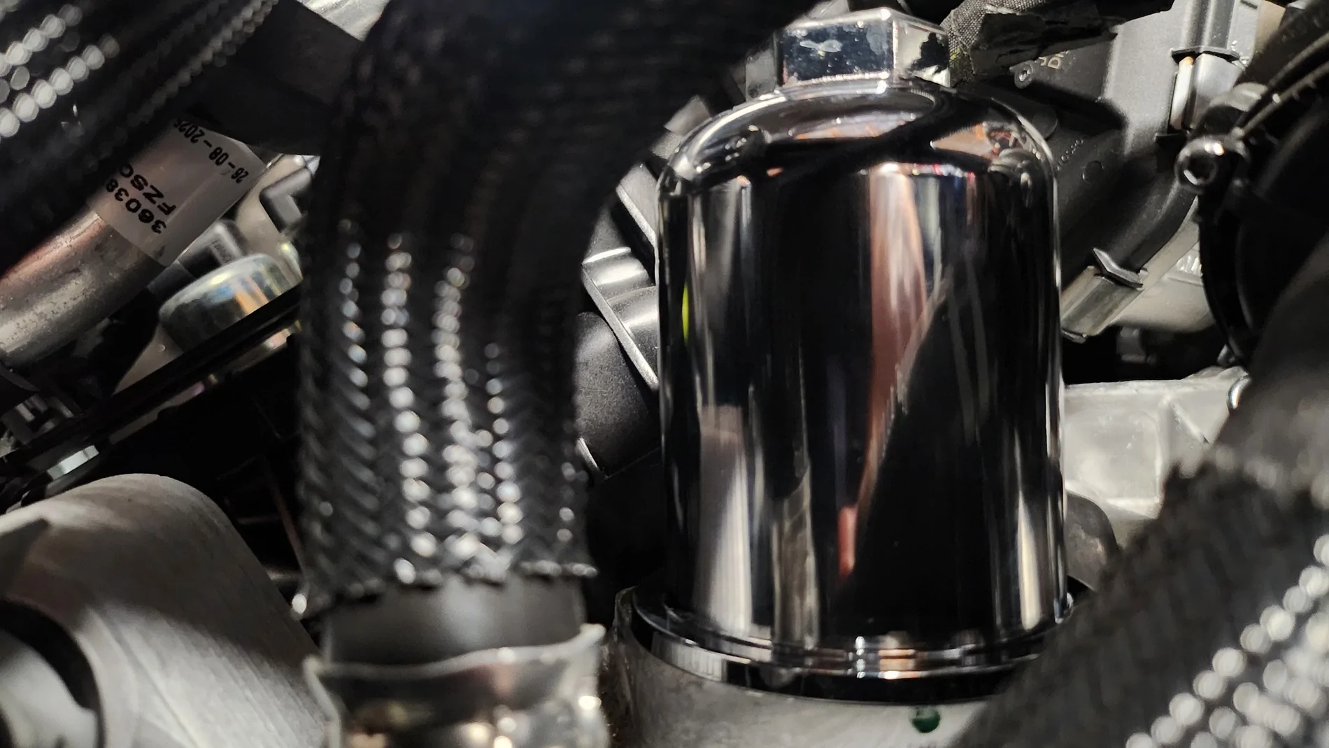

100 break in oil change. Replaced the plastic filter housing with an aluminum one while i was there.

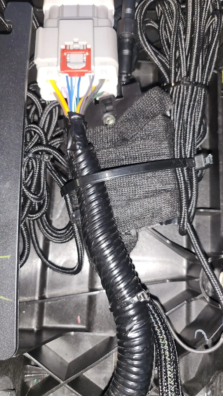

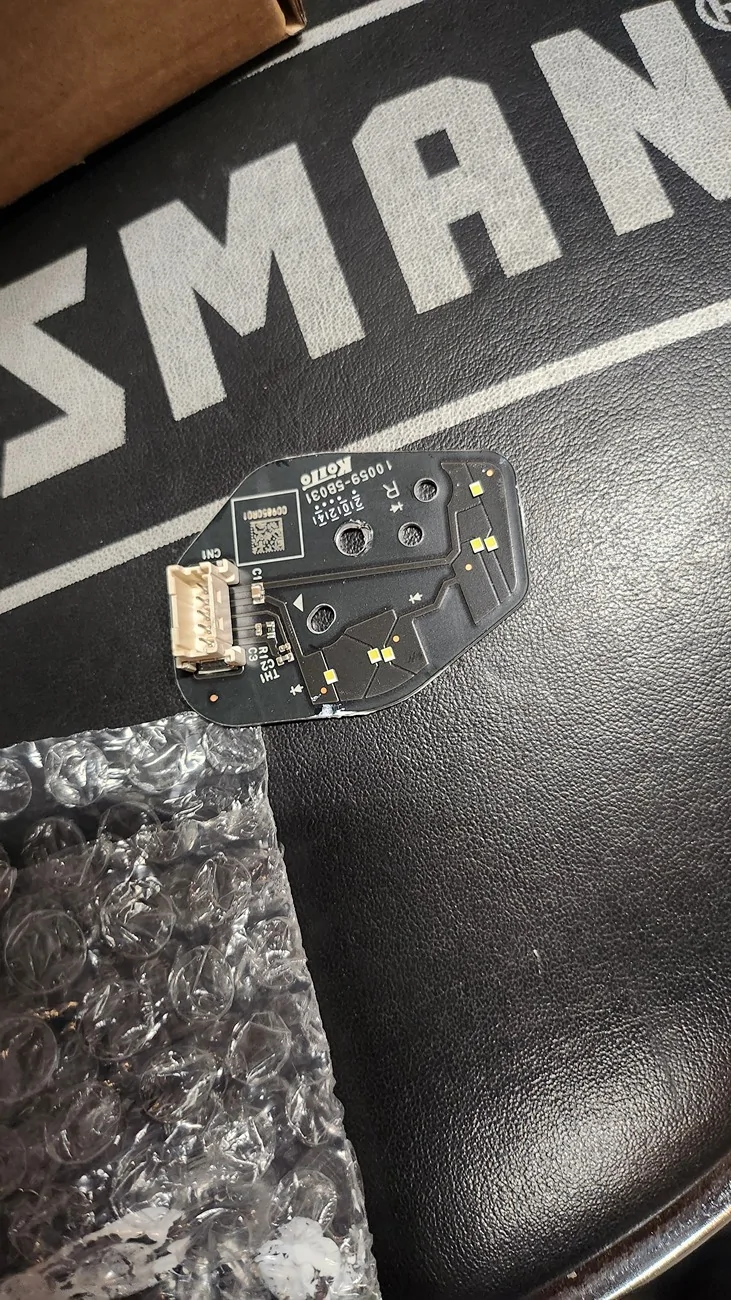

4th garage door opener hooked up to Aux switch 1. Remote module sourced from ford visor.

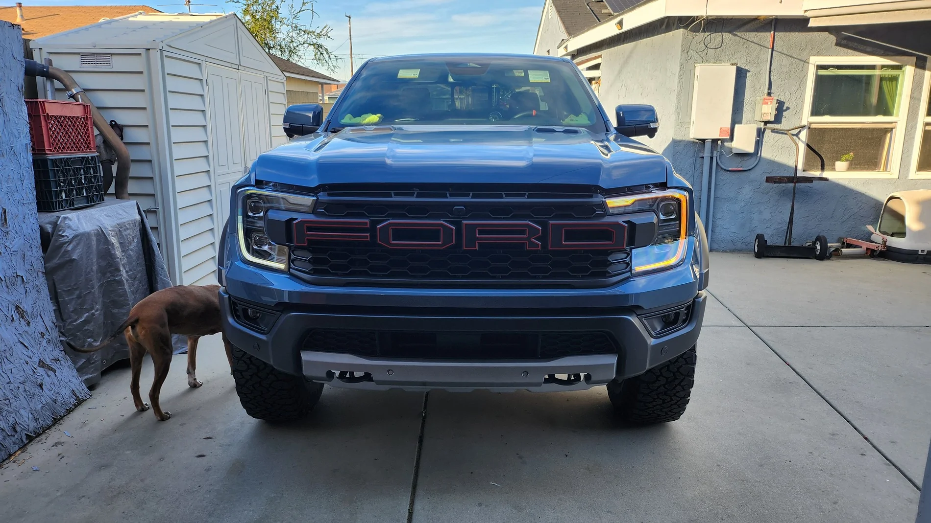

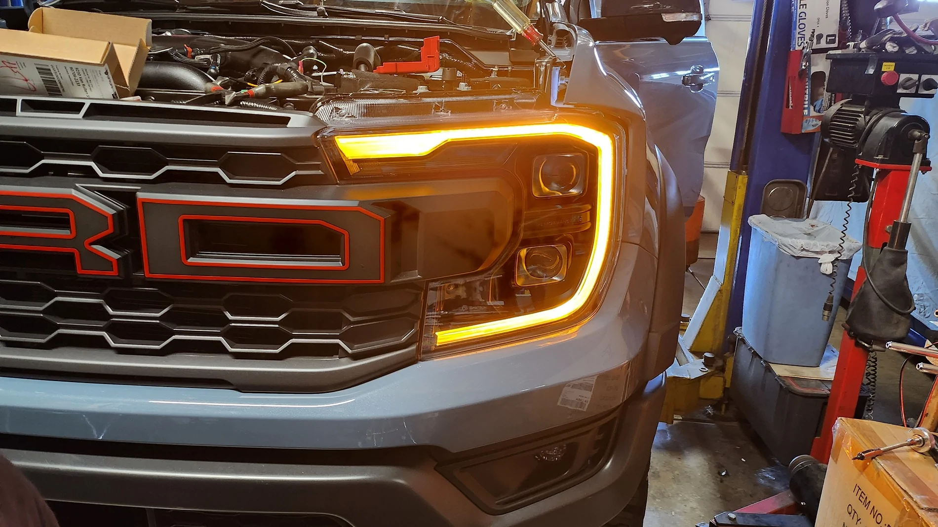

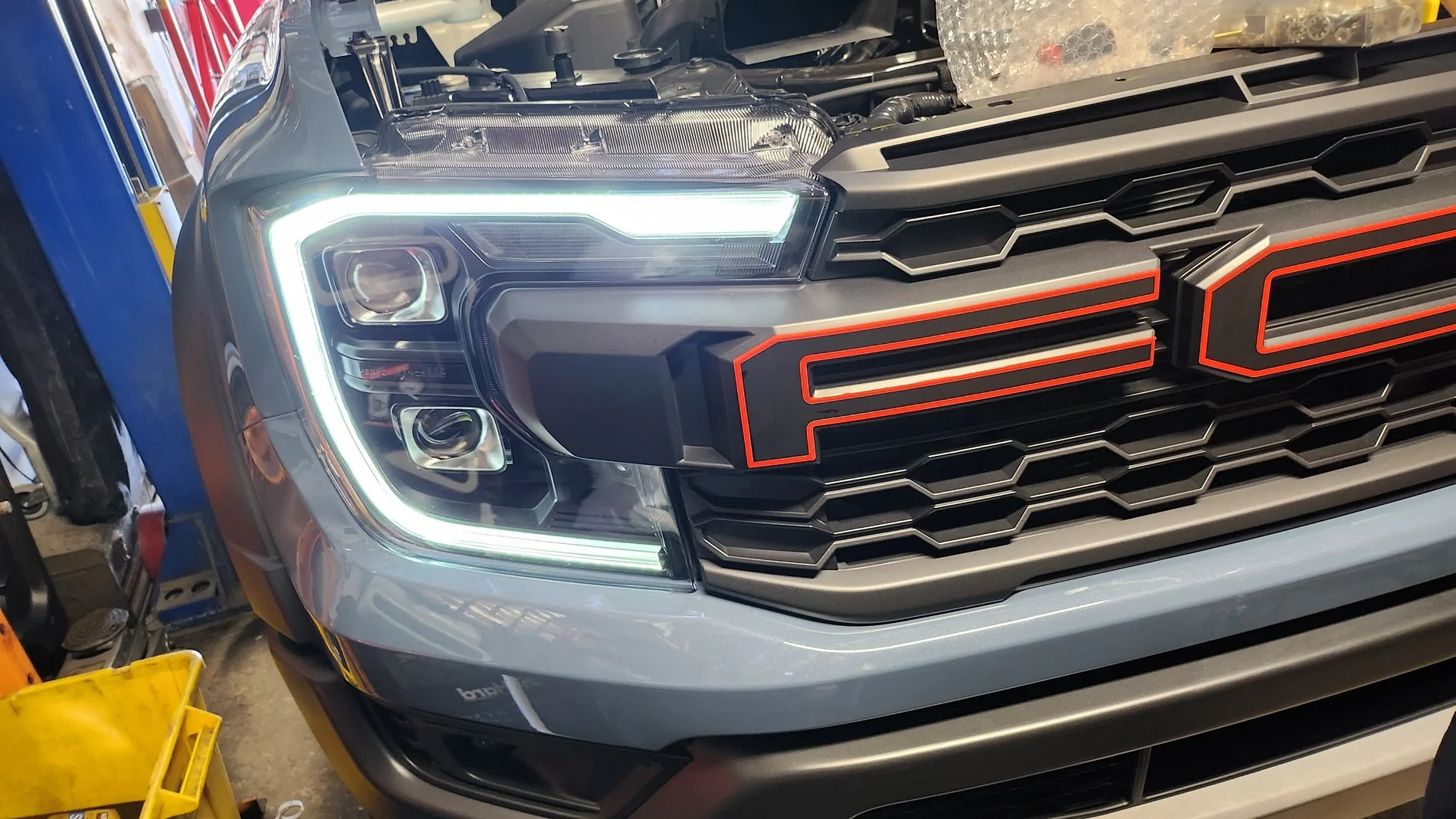

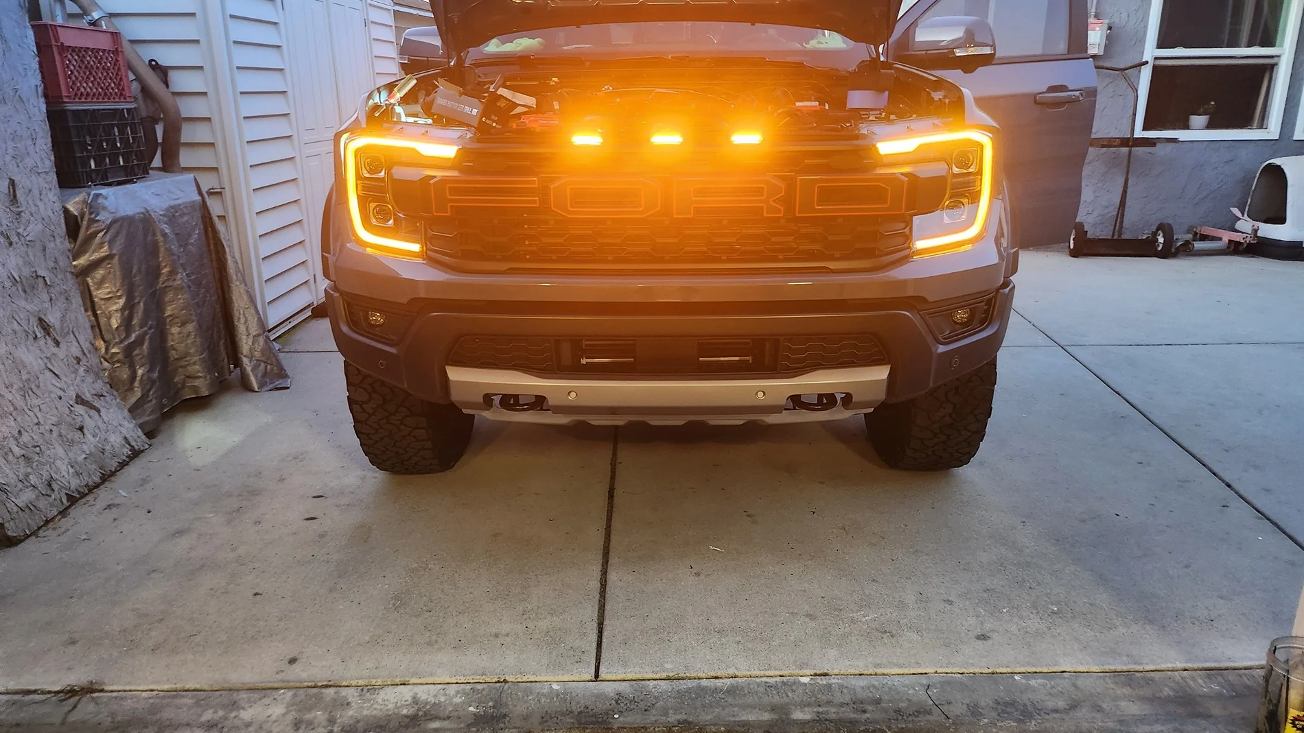

Grille lights installed and DRL changed to amber.

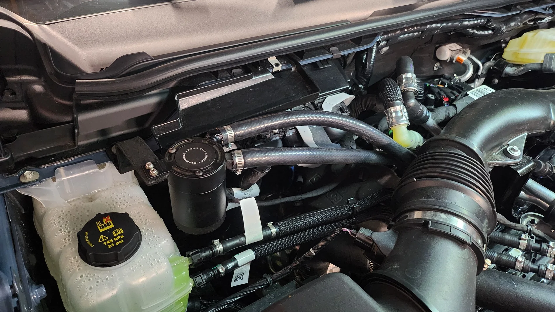

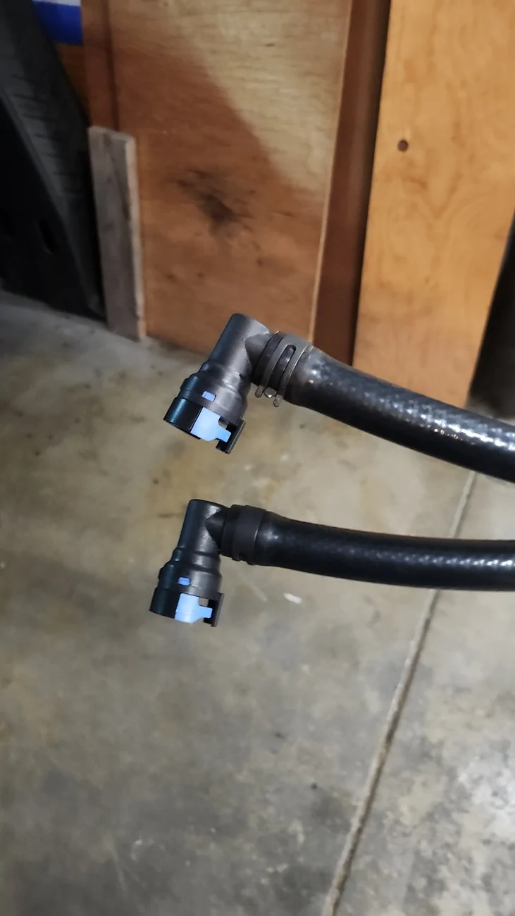

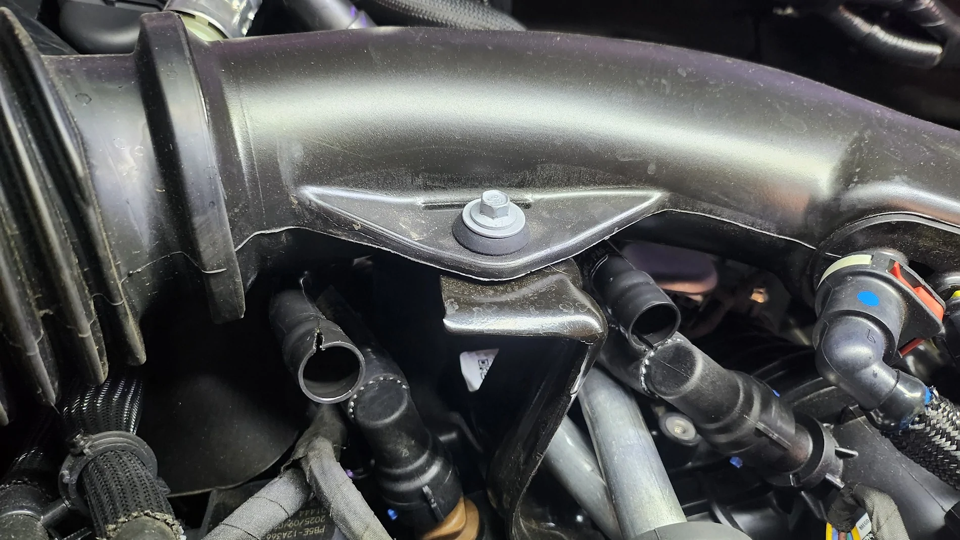

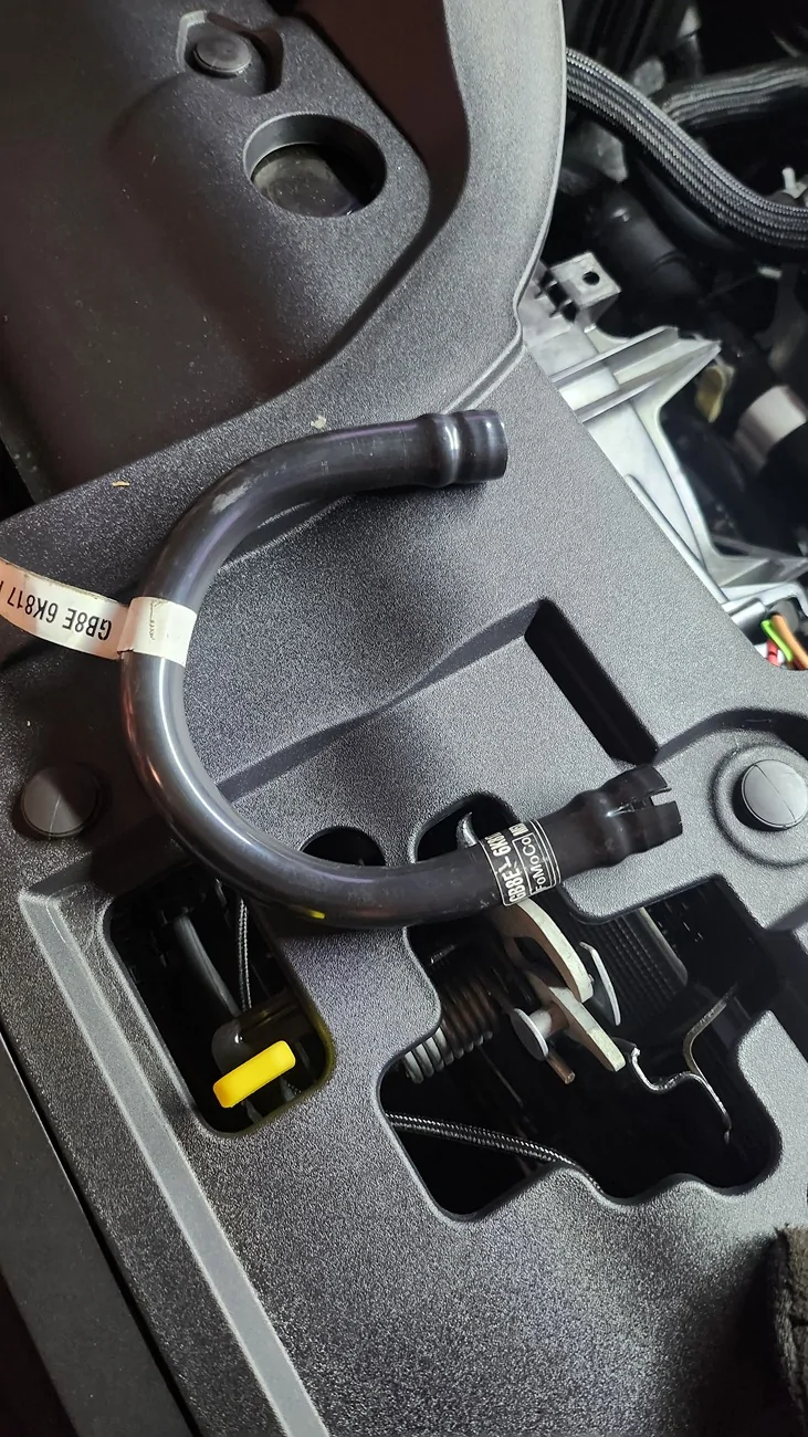

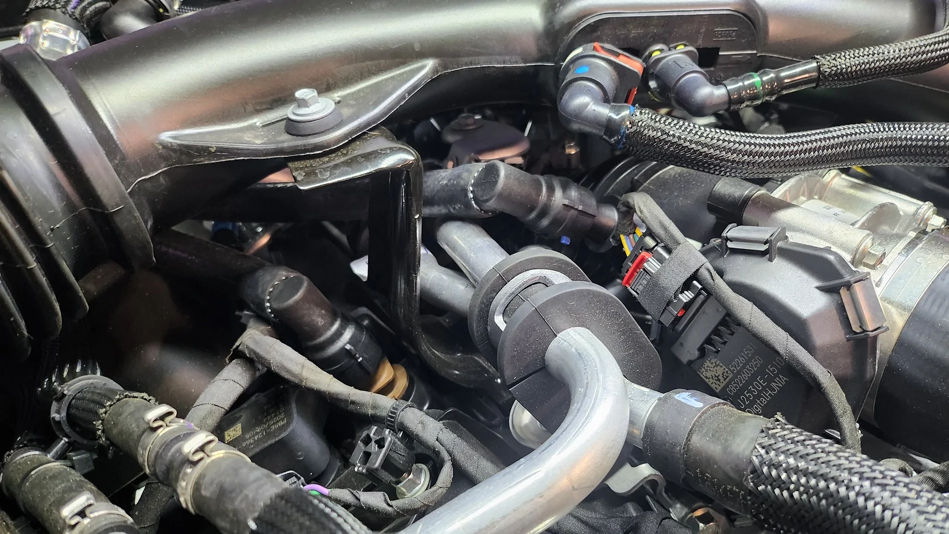

Recycled the oil catch can from the 2019. Fabbed up new bracket and hoses.

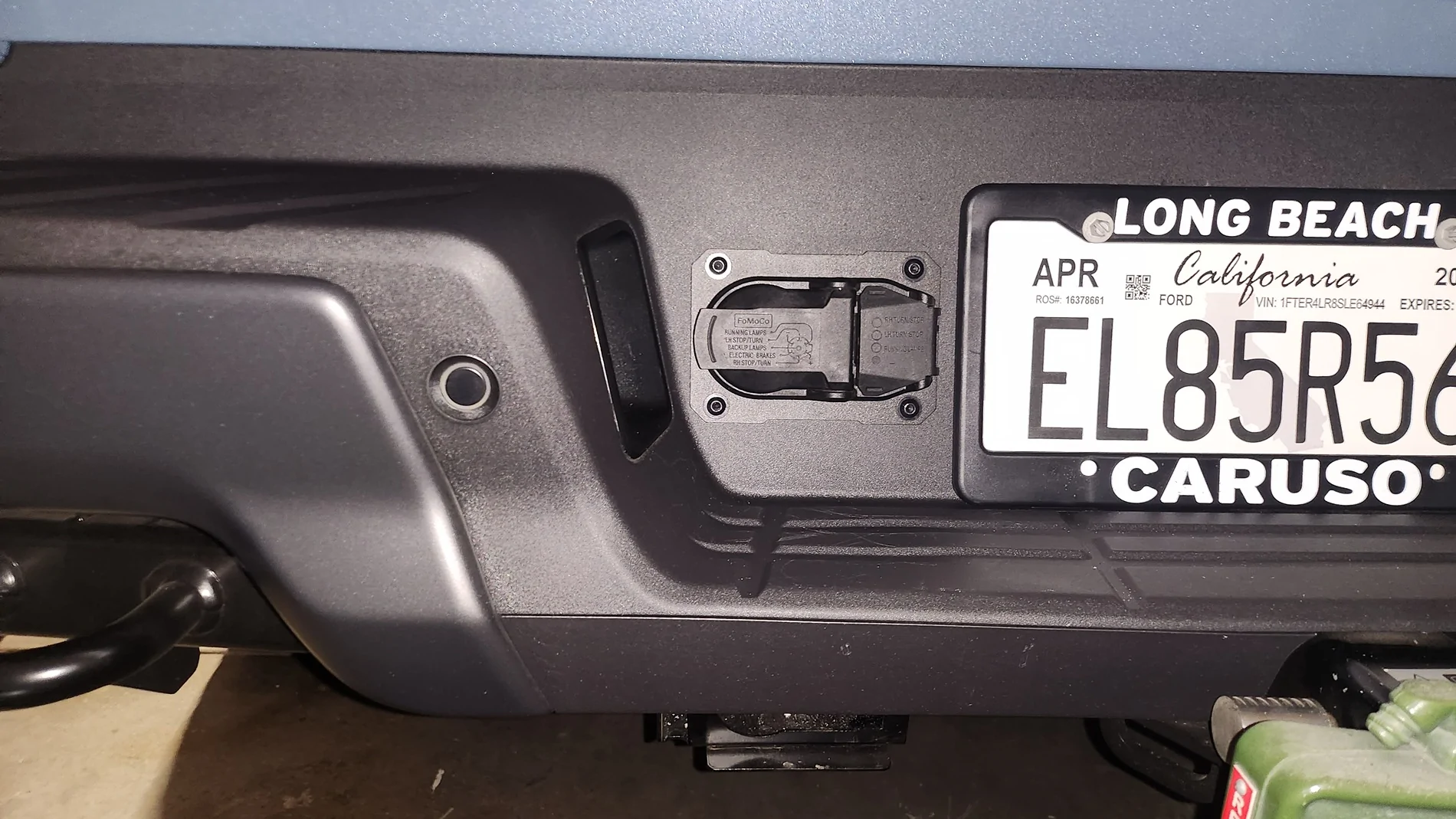

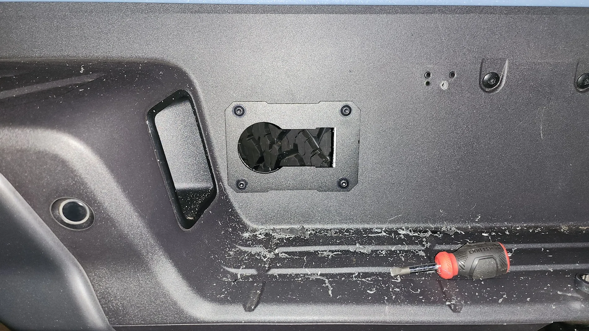

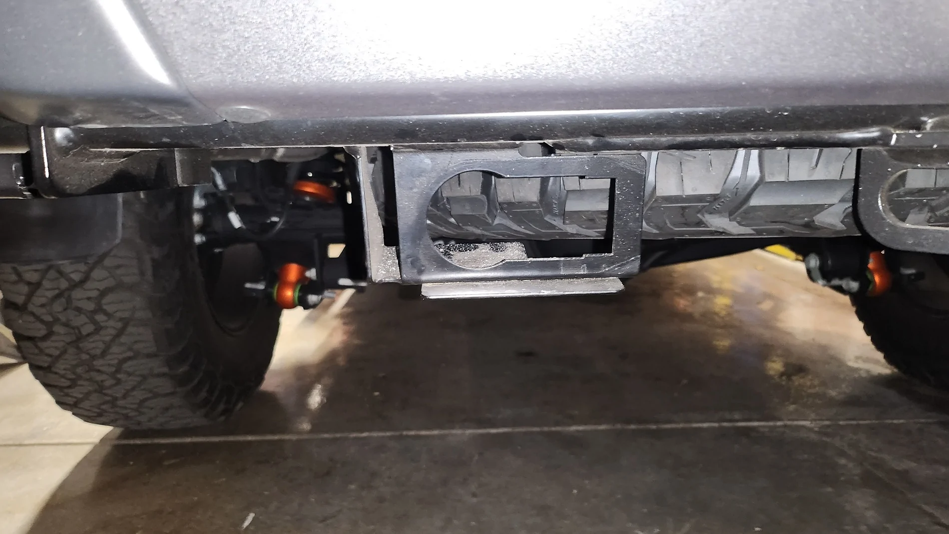

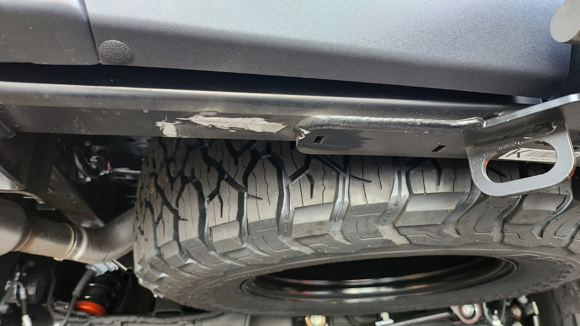

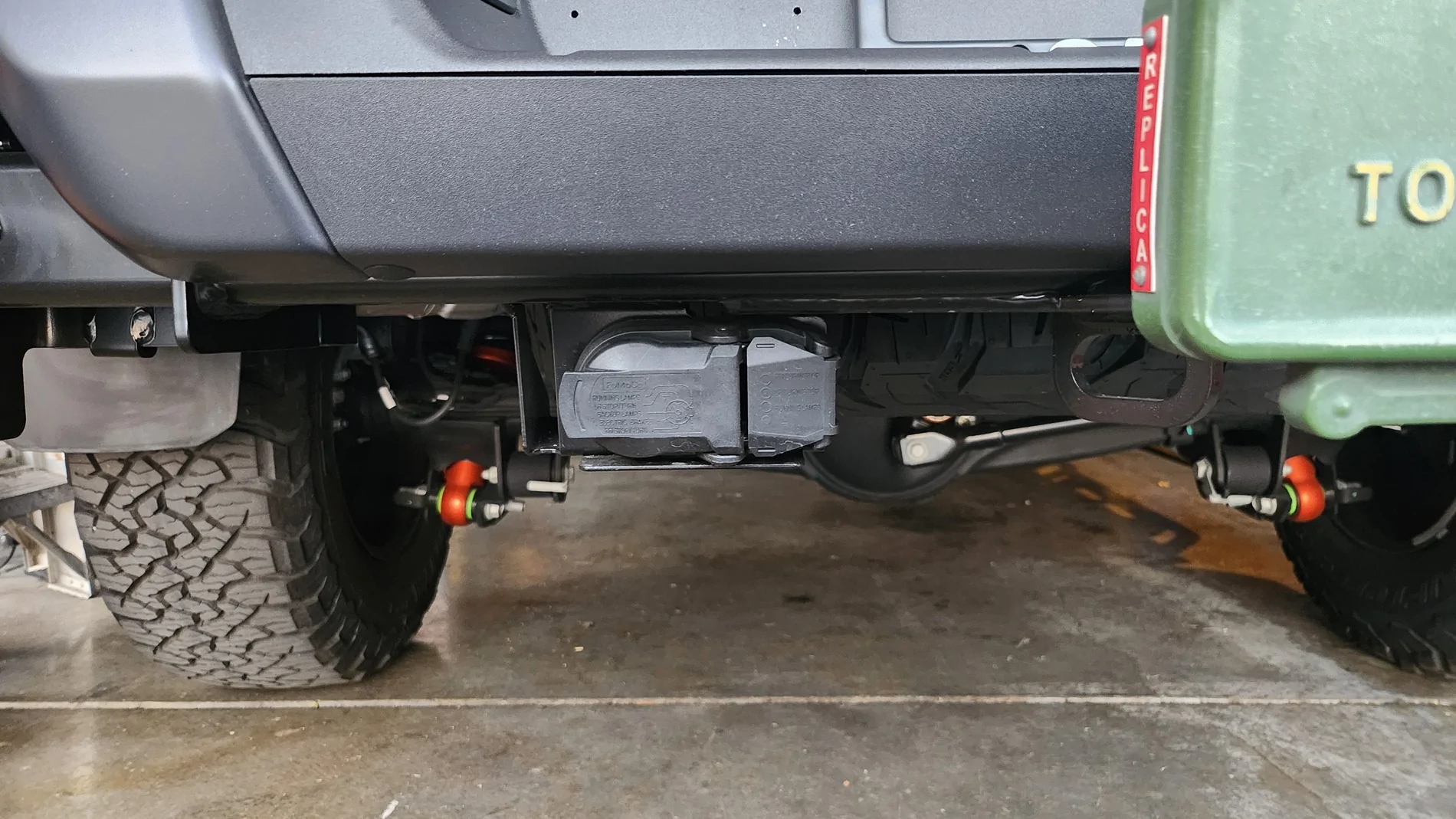

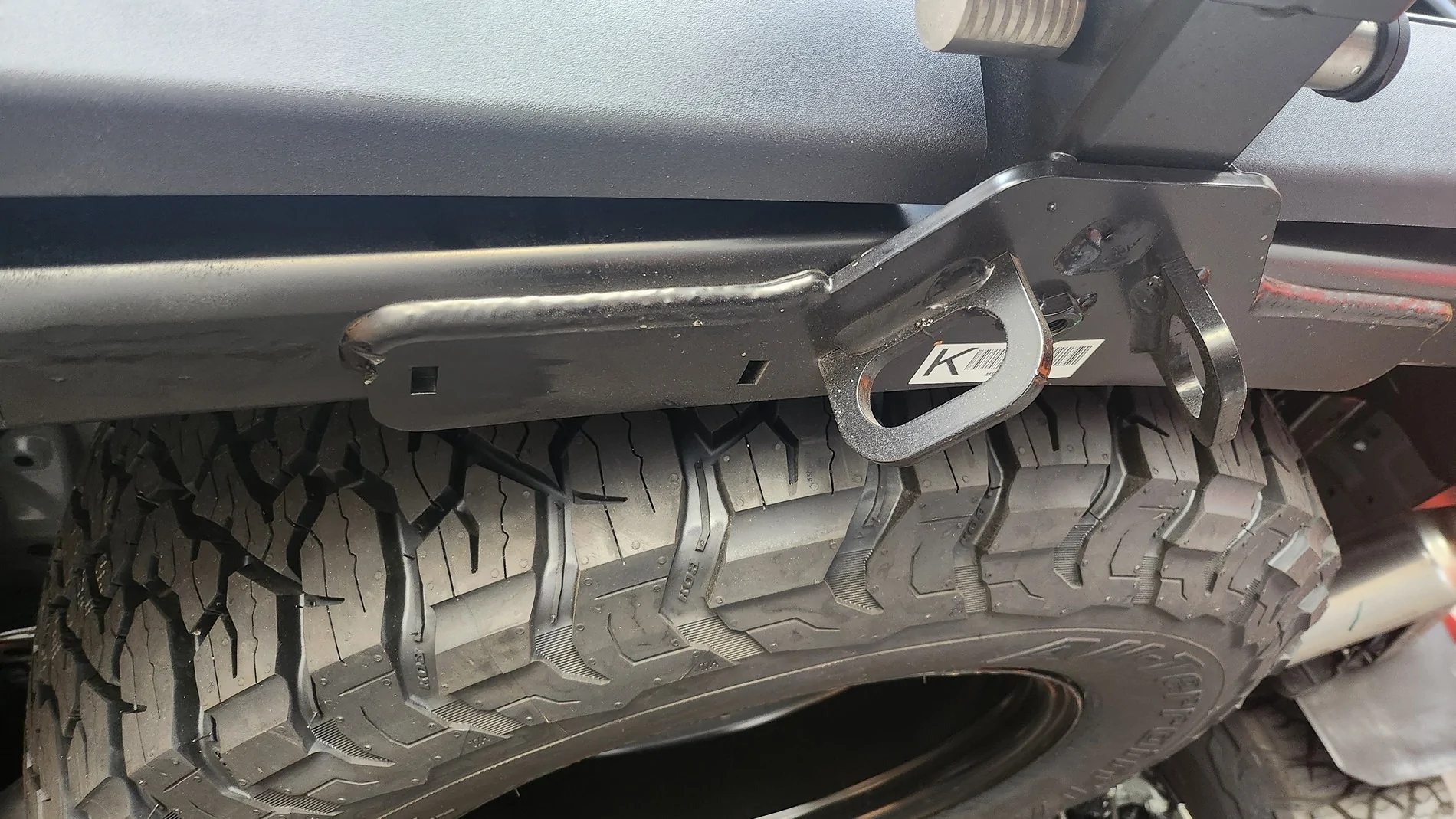

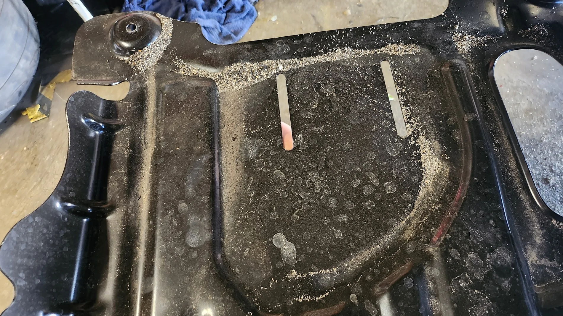

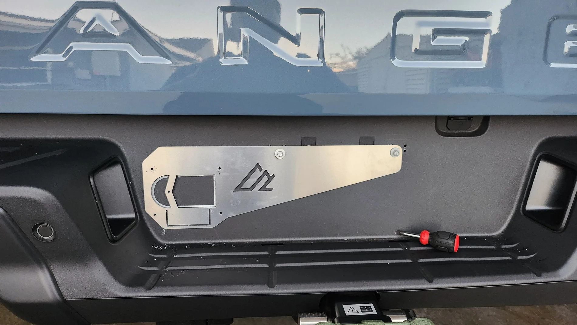

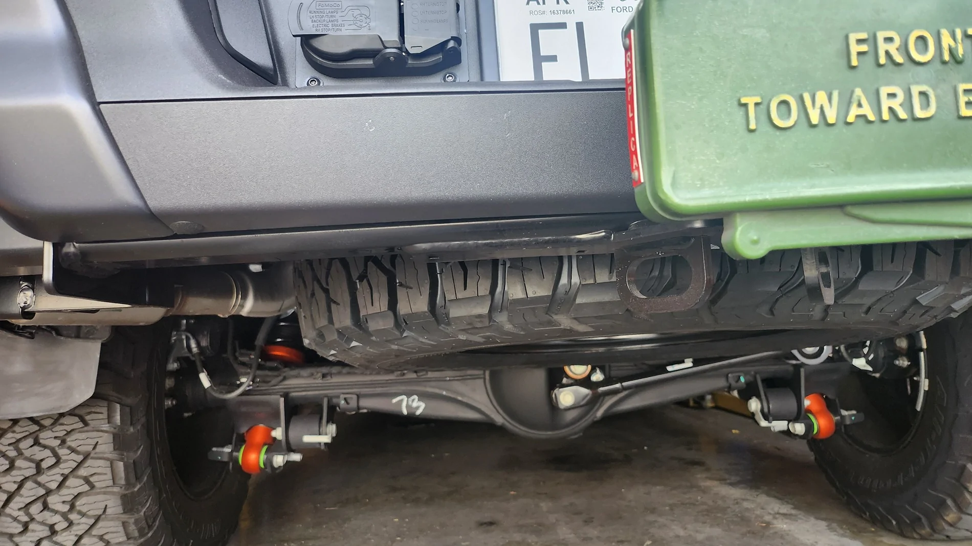

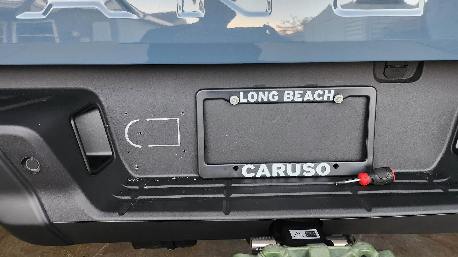

Why Ford decided to put the trailer plug as the lowest part of the dedicated offroad truck no one will know. The stock bracket will be removed at a later date.

Like it was never there.
