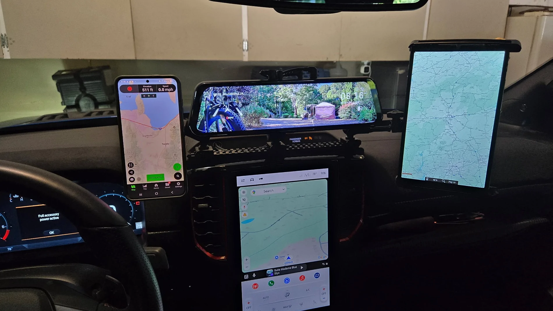

I have the same base in my 2025 Ranger. What is the arm that you have there with nothing on it?
4,116
4,009
looks just like a camera mount, like a go-pro or ghost camera mount

Many possibilities for sure!
I have the phone mount and want to get the gopro and DD switch mount. The iPad mount is awesome but I'm not sure if I could stand the iPad in my field of view.
That was when I first install the mount and threw everything up there. I have tablet now lower plus I'm tall so not much issue. Dashcam mirror vibrated to much mounted on the oem mirror. Does much better on the tackform

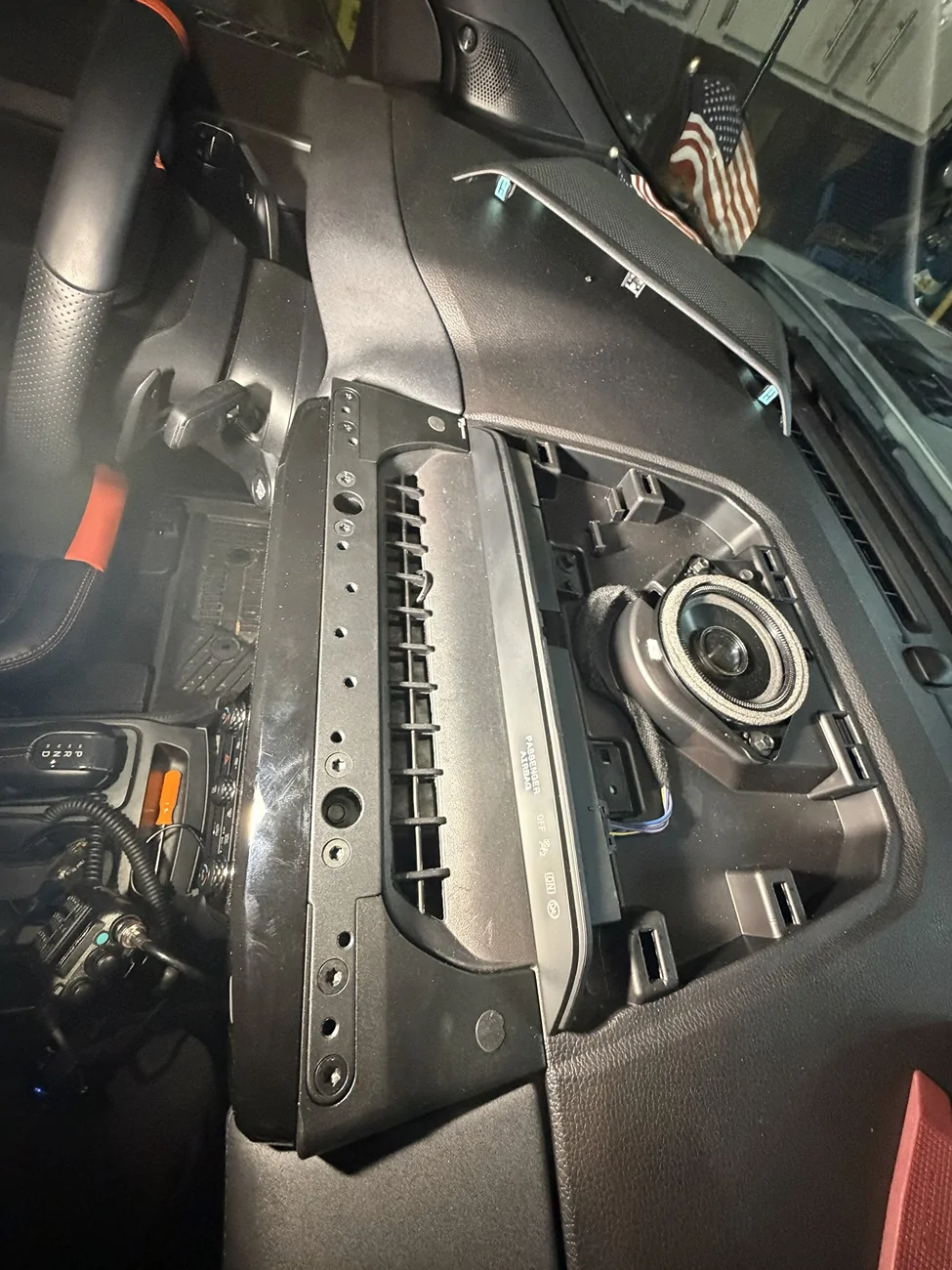

Is there a way to run the power cord for the cellphone behind the dash out of sight?
BrrRaptor
Scott
Jul 2, 2024
350
387
Raleigh Nc.

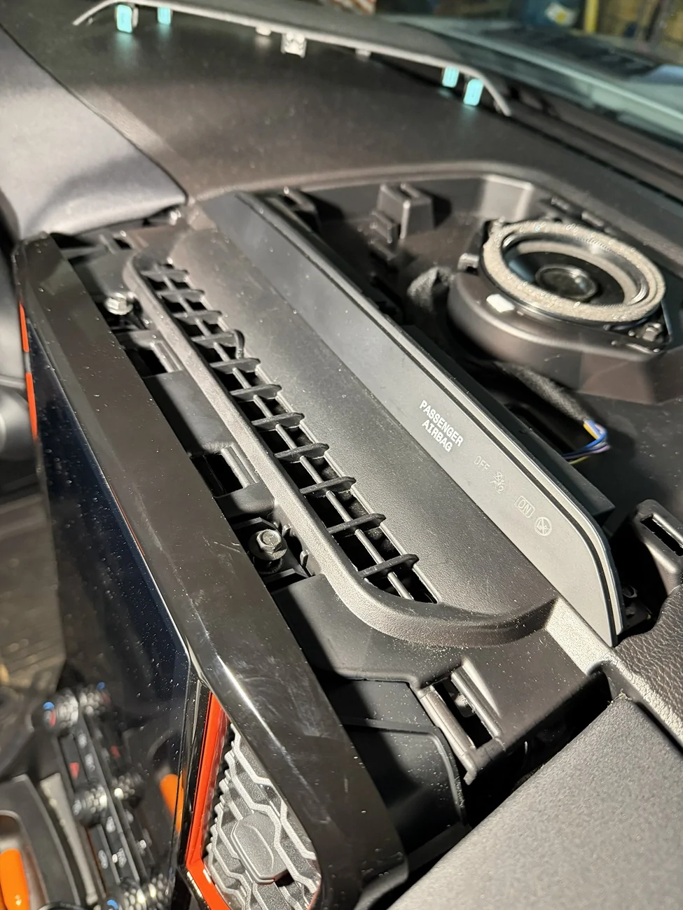

Yes, take out the center dash speaker and you can run wire down towards the gas pedal and connect at fuses.
