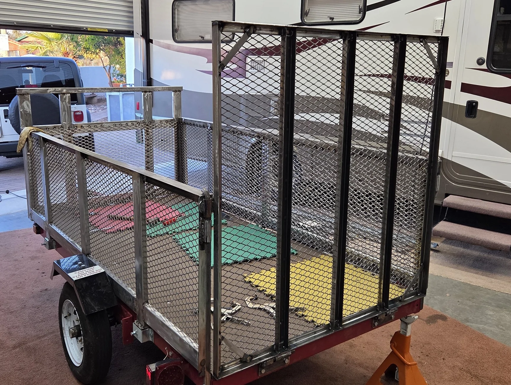

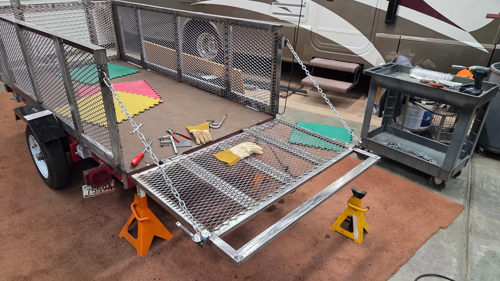

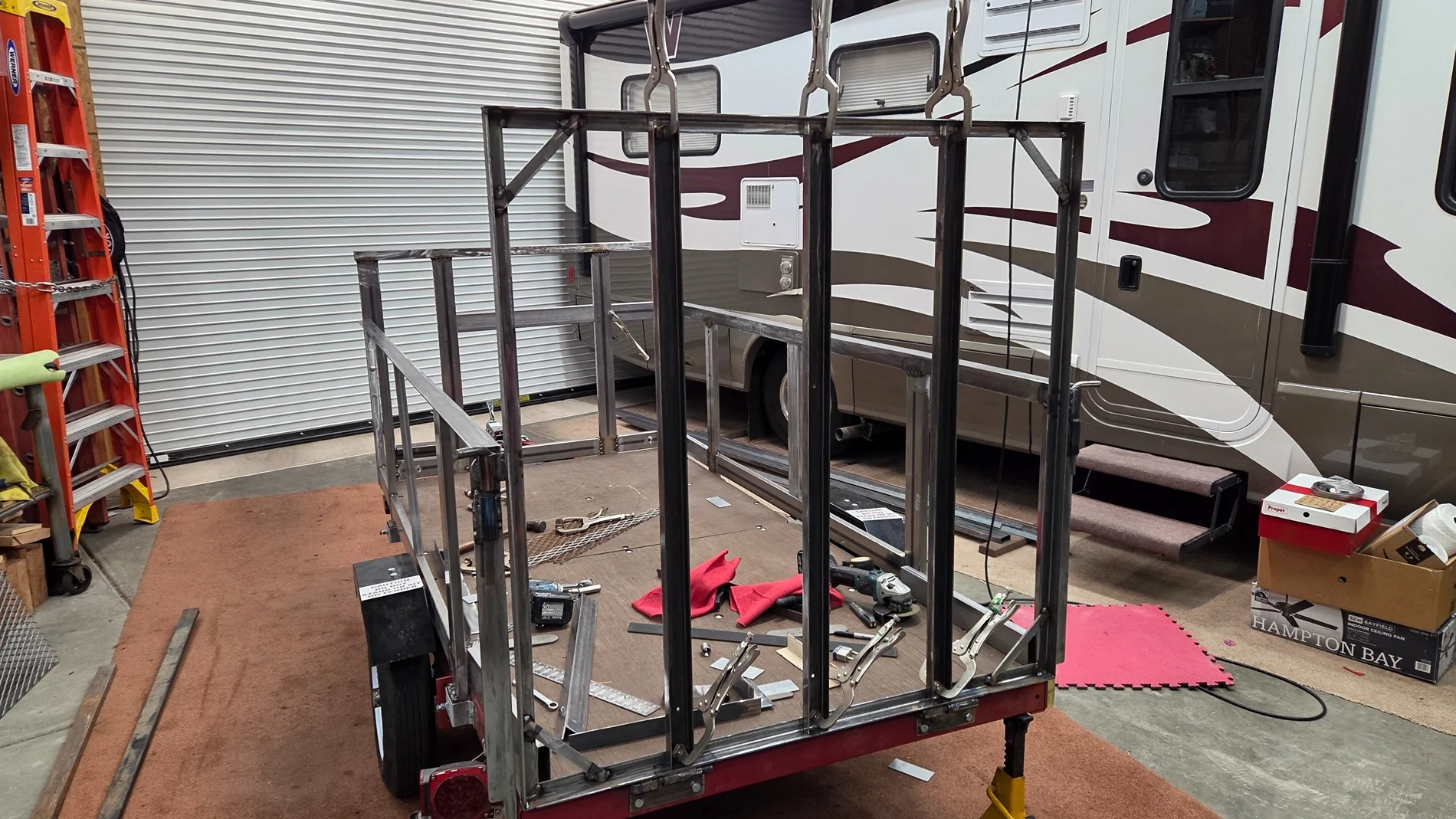

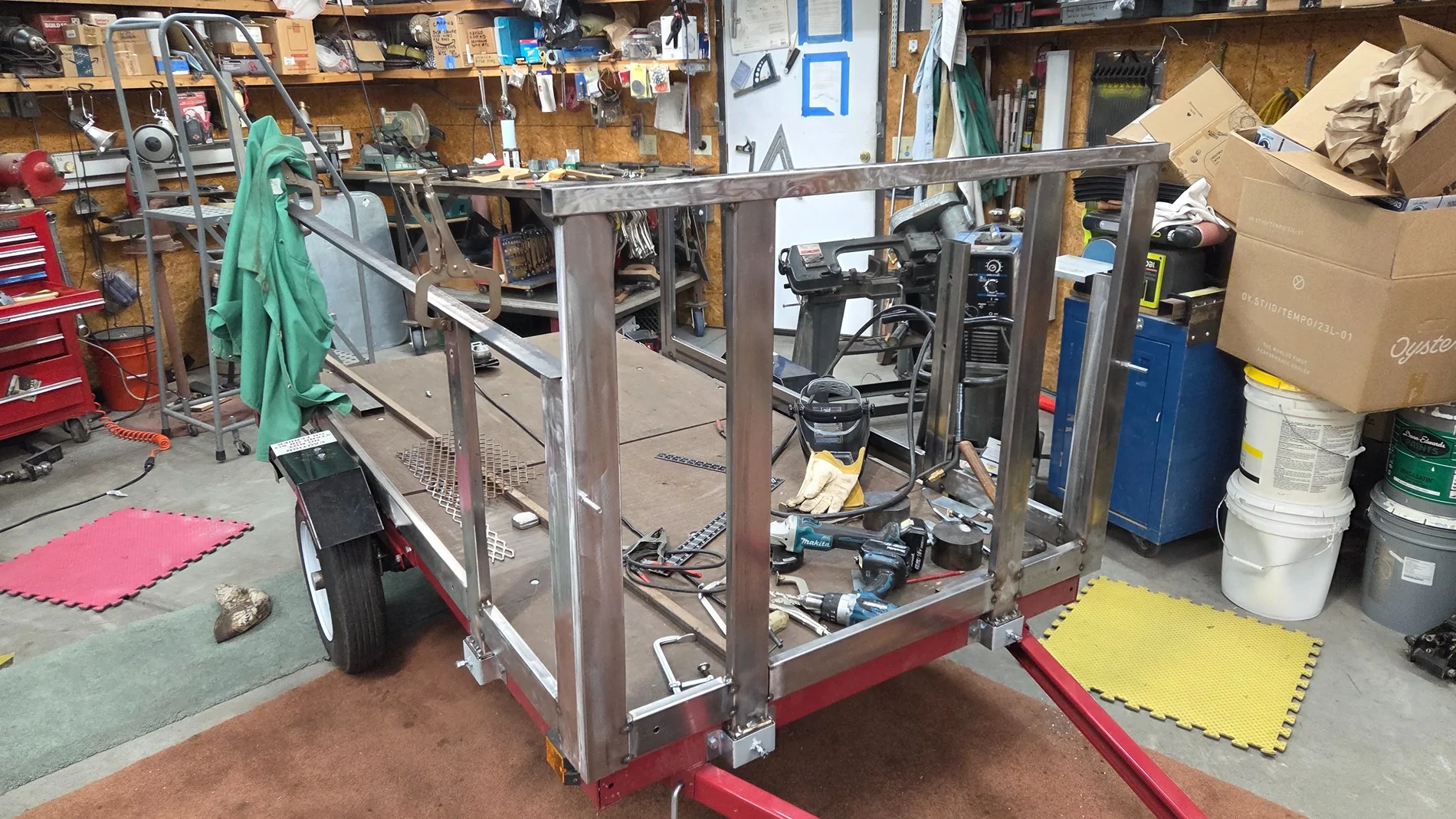

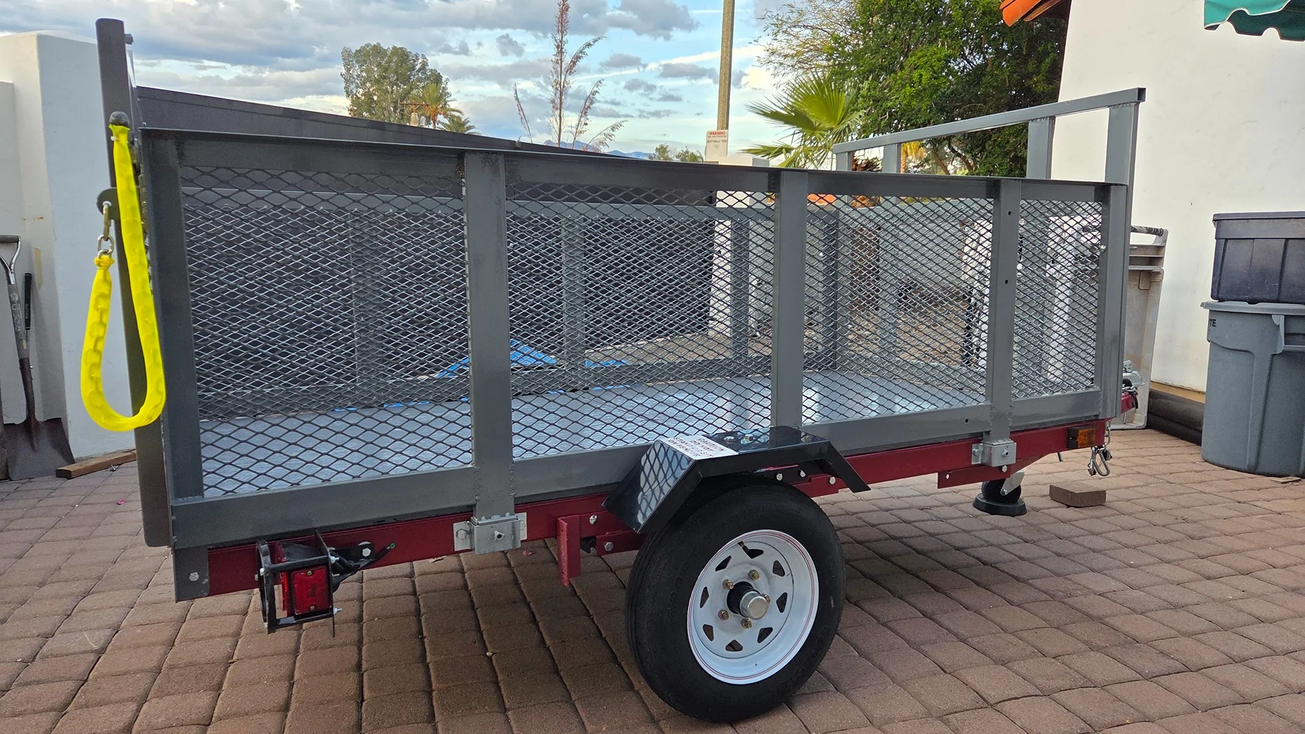

On my F350 I installed a Curt front receiver hitch, then a couple tracks on the topper with Thule bars. I built a 2" pipe rack that would plug into the front receiver. I could carry 20 foot lengths of pipe and structural steel, in smaller amounts. No longer need to carry stuff that long anymore but but funny I just decided this afternoon I do need a couple 20 foot sections of schedule 40 PVC to avoid glue joints under a patio but Home Depot is only a 15 minute walk so the wife and I will go get it on foot.
I did just finish a HF 4x8 trailer to replace the 8 foot bed when I sold the F350.
I built 2 interchangeable tailgates, one is a heavy duty ramp and the other is for every day use. They swap out in seconds with no tools but can't come off when closed and latched.

That's what I call a HF trailer now! Used them several times to modify for a certain use even made one a tilt trailer for my Son! Nice Job!! :like::sunglasses:

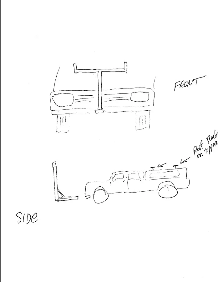

Got any pictures of the F-350 rack?
Sorry, I don't. When I got the Ranger I cut it up and kept the useable 2x2 sections. I made a crude sketch below to show how I made it. It would slide right into the front hitch and I had a couple threaded holes in the receiver so I could tighten two 3/8" bolts into it to keep it solid. I added bracing at the 90, I made a couple upright pieces to clamp to my roof bars to keep the steel centered on the camper shell rack. Then I would bungee it in the "wishbone" on my home made front carrier. It would easily hold 20 footers but I was careful not to overload it weight wise.
Now when I buy steel I have to plan more so I can cut some of it at the supply yard to get it home, but I don't do much steel work anymore. When I built the trailer I cut the 20's into 12 & 8 and flatbedded them home on the trailer chassis with tiedowns and red flags.
