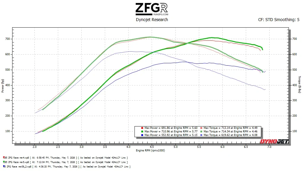

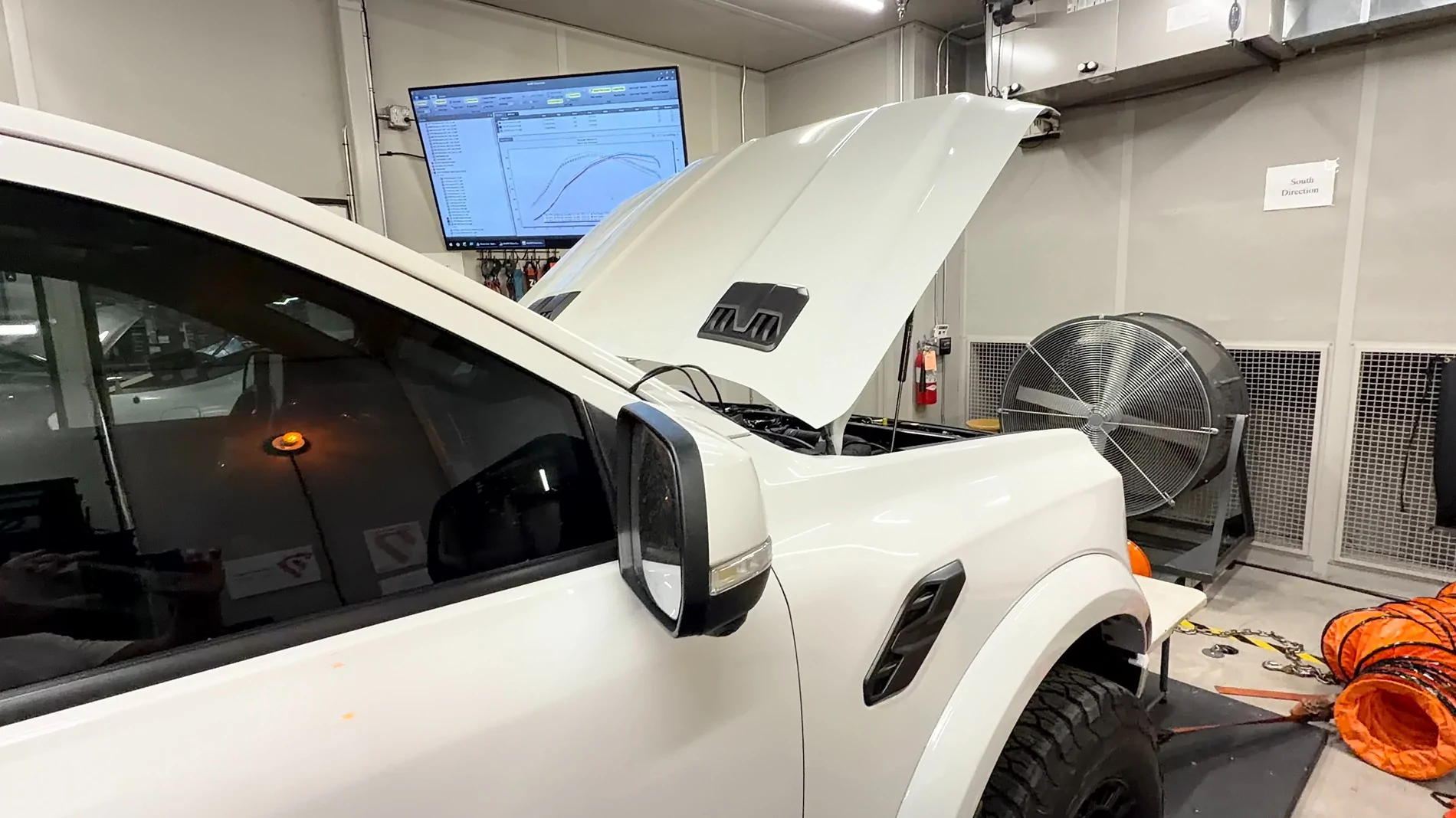

🚗💨 Exciting news! @DirtDerrick's Snow White is back on the dyno! This time, we had Matt @turbobay upgrad the off the shelf Garrett PowerMax turbos compressor to a bit bigger than the standard Power Max, but smaller than the previous setup that hit an 715 rwhp.
Our mission? To regain some spool and boost that torque figure. And guess what? We’ve hit the target with a fantastic 710 rwhp and 714 ft-lbs on an E85 tune (with E75 in the tank)! We also tested with 93 octane (E10) and saw a solid output of 552 rwhp and 619 ft-lbs.
Stay tuned for a full breakdown on our YouTube channel, where we'll discuss the upgrades and the compression of this turbo to the larger turbo setup!

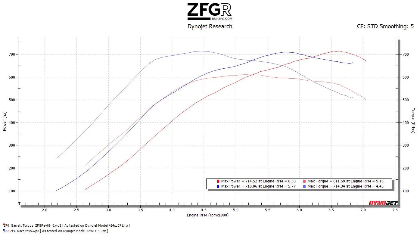

Quick comparison to the old turbos. I'll explain more in the video! But you can see we lost some of that hp above 6000 but gained 1000 rpm in spool and usable torque not to mention the extra 100 ft-lbs!

That reminds me is really need to over lay this turbo over the stock. I really don't think much was lost spool wise maybe a few hundred rpm if that which is impressive for a turbo that can support an extra 200hp worth of air.

Sorry for the delay here is the video and the stock turbo comparison
