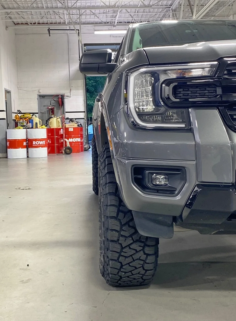

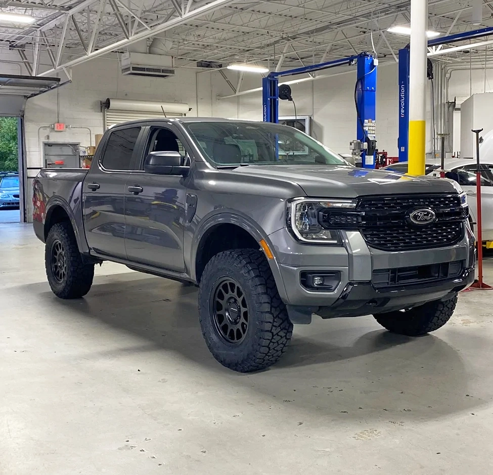

Hey guys just wanted to share my 25 fx4 2.3l with Fox 2.0 lift front and rear, 285/70/17 and +35 offset Method wheels in Toyota hub size with hub rings. Ford sells the same wheel for the broncos. No trimming required. Rides pretty nice.
Ford Ranger 2025 Ranger FX4, FOX 2.0 Performance series lift 96332-c9036bc78a434625aa1dc3fdb5312da
Ford Ranger 2025 Ranger FX4, FOX 2.0 Performance series lift 96334-708bf30e4e951425f92cf486900ee1a6

Following this, I’m also curious about ride comfort, overall lift from stock, other modifications required to make it fit?

They are stock uppers alignment all came in spec but the eccentrics are maxed out on the lowers for alignment adjustment.
The ride comfort is good, more responsive, less bounce and fluff over driveway things like that. No harshness though. I’d say it’s stiffer but in a responsive way. The factory shocks bottomed out just coming out my driveway. I’ll be taking it off-road hopefully soon. I didn’t have to modify anything. They fit like a glove, no rubbing. Perfect fitment. The +35 is the best offset for the ranger it seems. This exact wheel is available through ford performance in a hub centric version. I got the Toyota version and used an aluminum hub ring.
