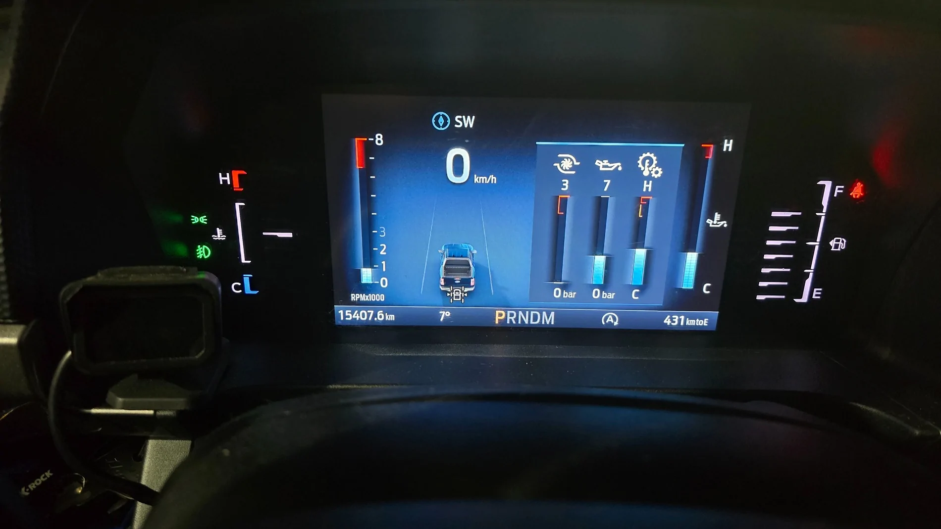

there is an rpm guage, you have to go into the instrument cluster settings and turn it on. and mine is a 25 xlt sport 2.3 with the fx4 package. the non fx4's(or terrian management add on(if available sepperate)) dont have the dial.

my xlt sport with the fx4 package has the dial. no button for me, but thats because the fx4 package adds the terrian management settings for mud,sand, etc.
