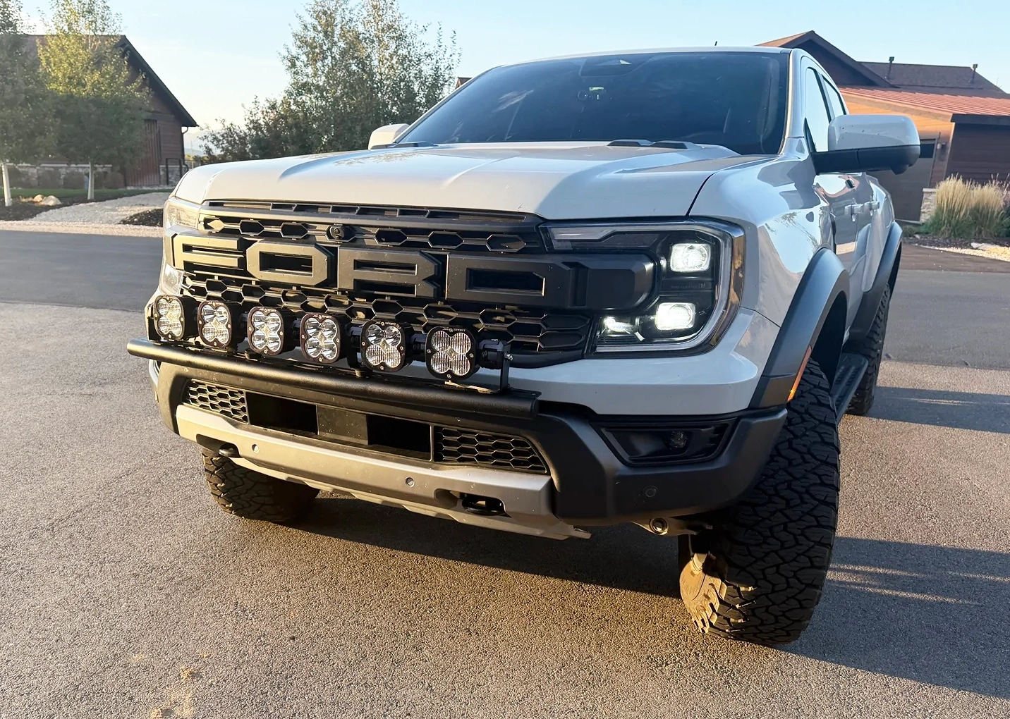

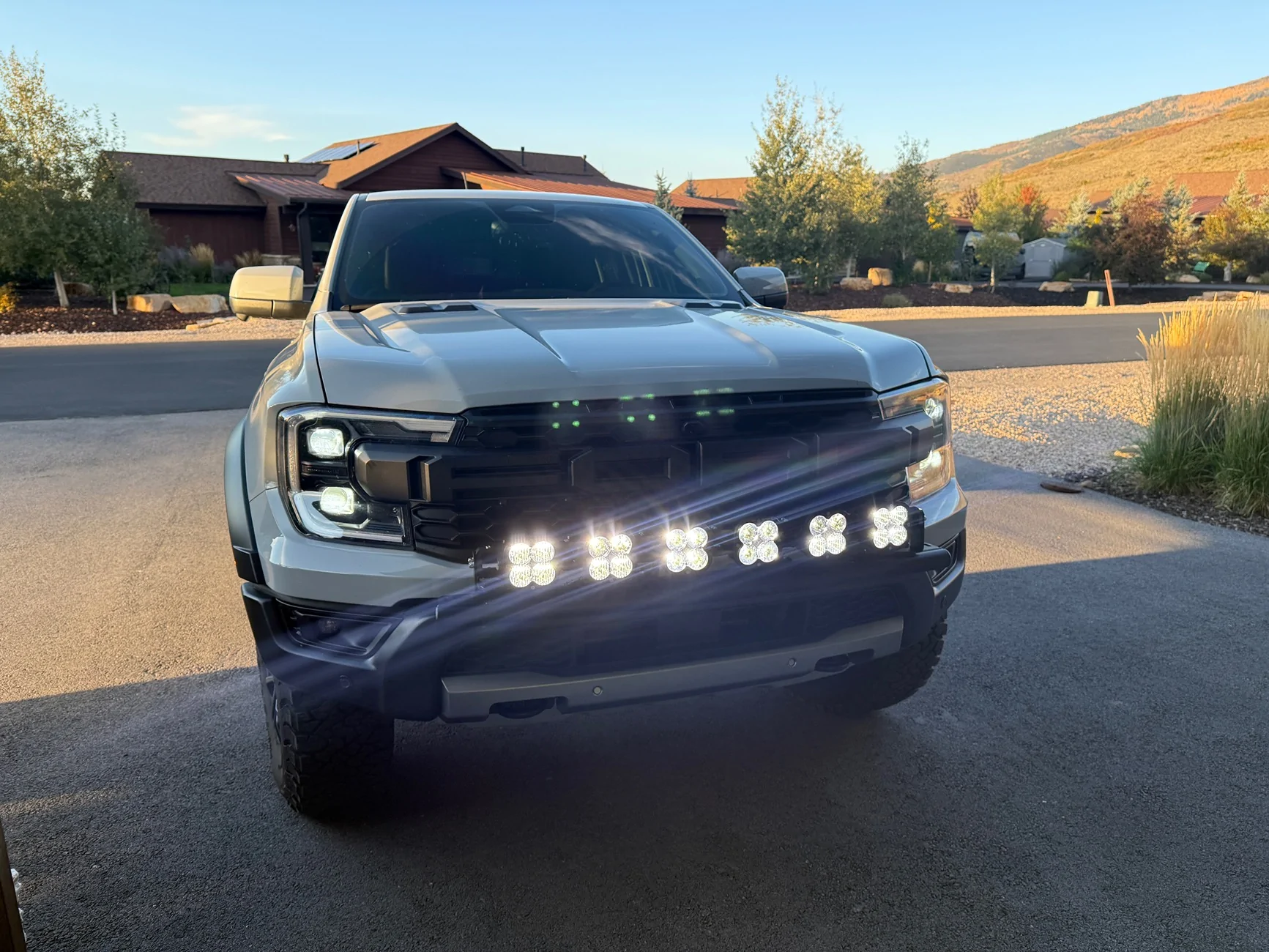

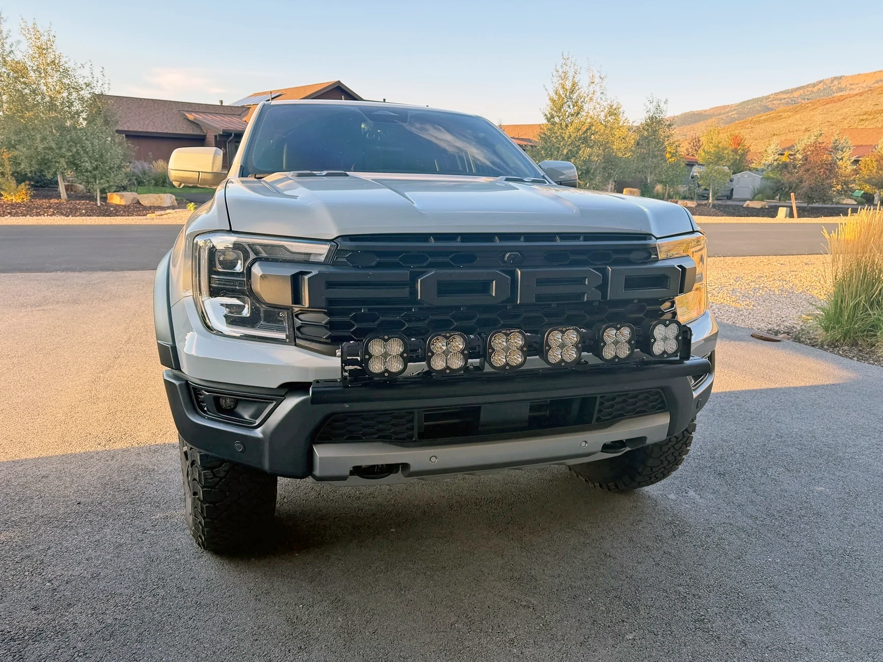

I traded in my crappy 21 First Edition Bronco for my 26 RR. I kept the Baja Designs XL Linkable bumper light kit. I had to do some adjustments to the curve, but fully adjustable and it fits perfectly with the Foutz bumper light mount (by @GregFoutz). I’ll probably add another XL since there is room for it.
I’ll add some additional insight/steps with installing the Foutz bar that will save time if you’re installing one. Their instructions should be better!
