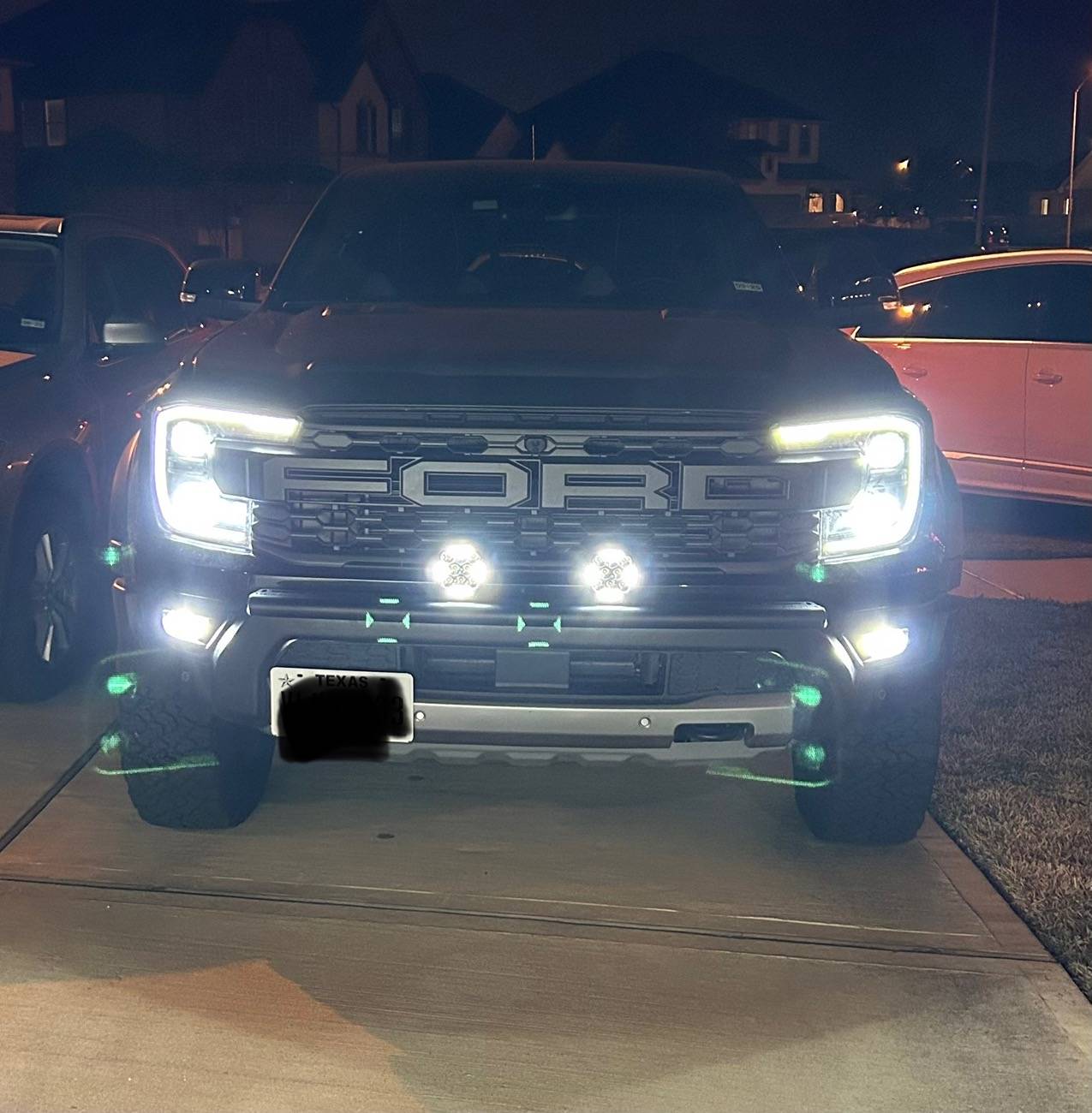

What are your connections? Are your red cables going directly to the battery?
Used spade connectors, was able to run DLRs to aux 1 wire, main positives to aux 6 (yellow) and negatives/grounds to aux 6 (black and yellow).

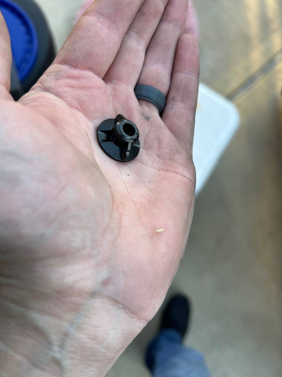

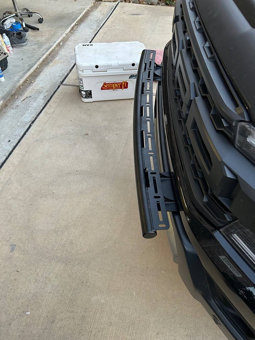

I don’t think I removed those bolts, but I do think you should remove the plastic bumper, disconnect the parking sensor harness, and set it aside, the actual bumper after the 6 big screws are out, you will need someone to help you hold it steady on something unlesss you have a jack or cherry picker thing. That wiring harness to the fog lights and other stuff cannot come off and is awkward to hold lol. If one of these little guys pops off when you’re taking the bumper off, it holds the threaded plate lined up with the 6 bumper bolts. But yea, fun install and very rewarding aftermarket setup.

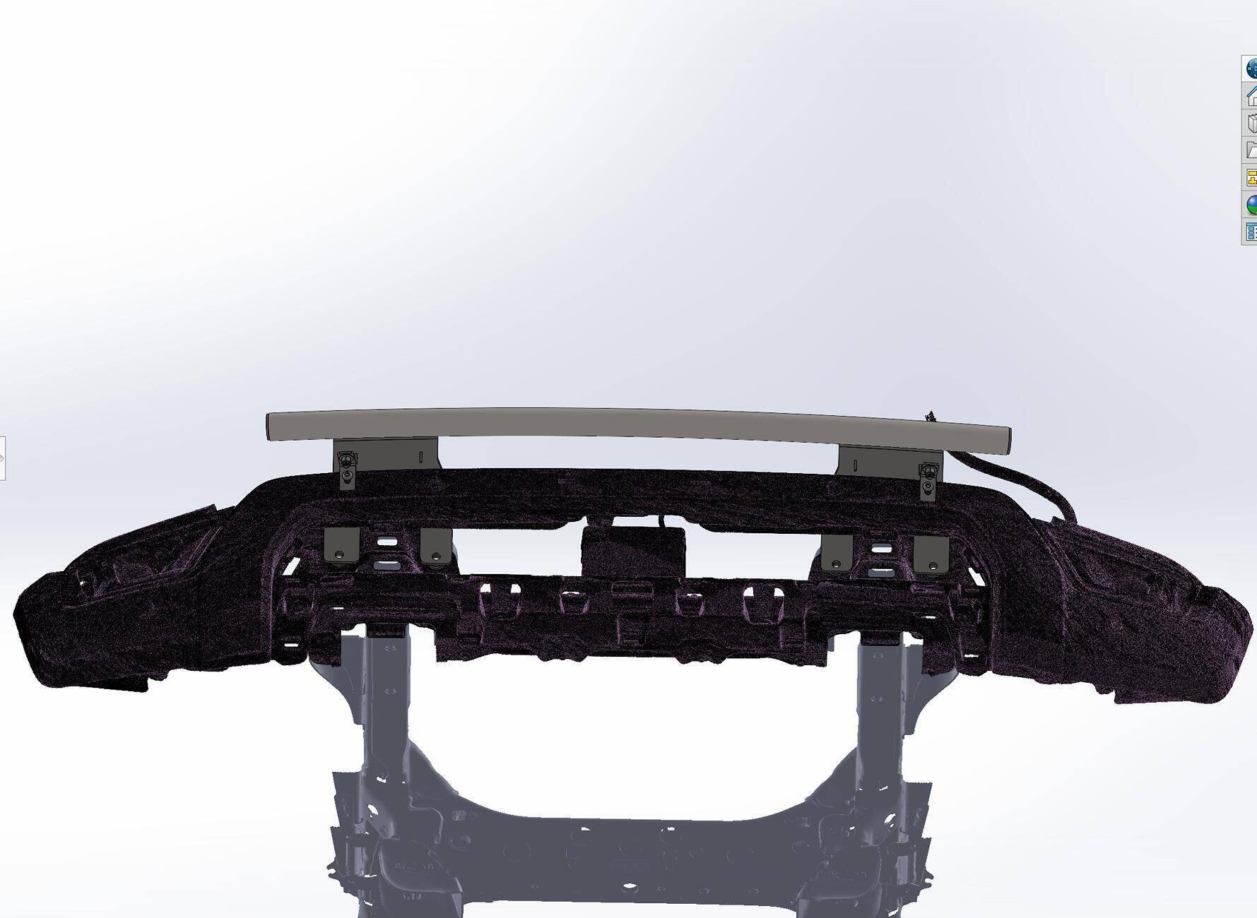

It didn’t mention what the 4 bolts and l bracket were for/used. Any ideas?
the 2 L-brackets and bolts are for extra support if you put on super heavy lights you can add those to the mount but it requires you to drill 2 holes in the front of the stock bumper. you can see them in this CAD screen shot. There are 2 holes in the base brackets on the light mount that you match up the L-bracket with.
I will get that info added to the install guide and also the note about the heater core wire mount also.

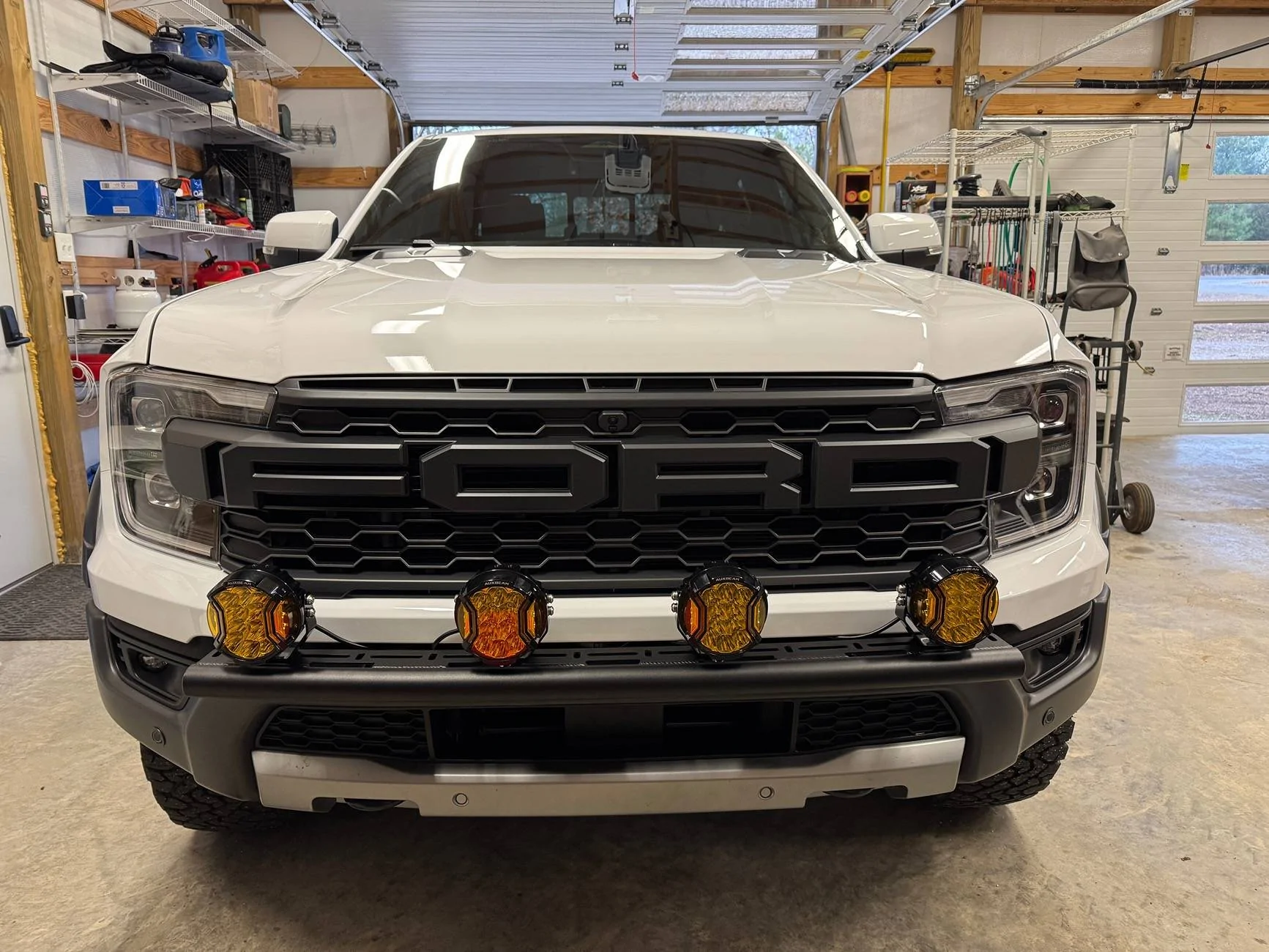

Ford Ranger Ranger Raptor Front Light Mount Kit by Foutz Motorsports 1735067341774-n2

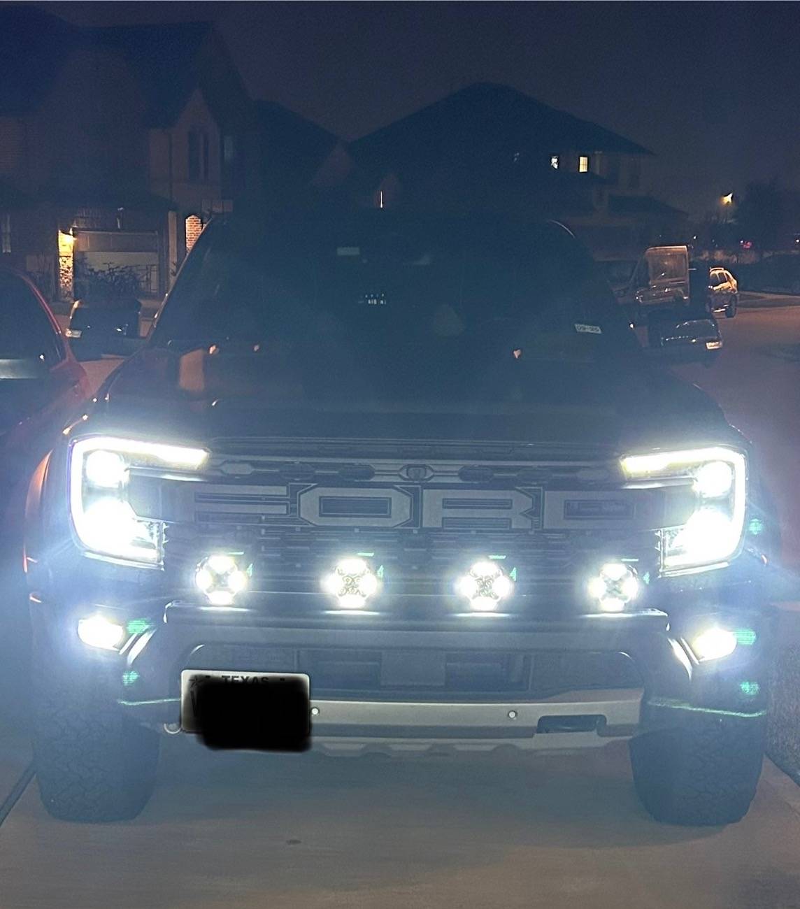

Does anybody have experience with mounting the Nacho Grande offroad LED lights? I know they were mounted in one of the images on the Foutz mount website, but I’m having trouble with connecting the lights and getting power even with direct attachment to the battery.

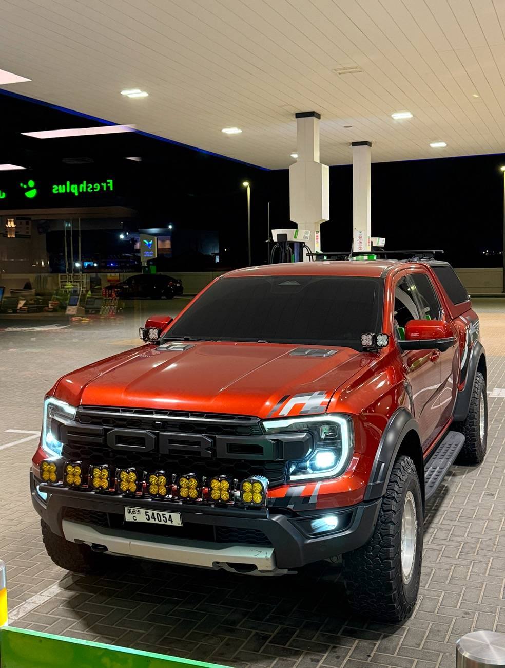

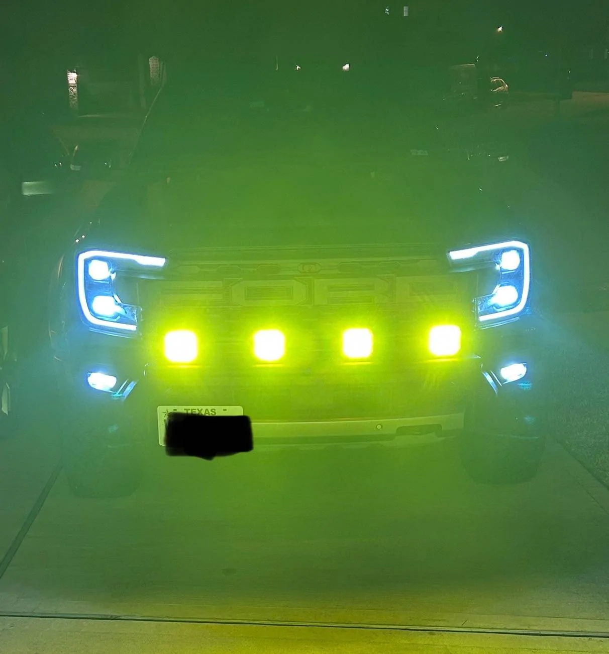

No trouble seeing you coming :crackup:
Mainly went with that amount of lights because of the tint on the front window.
Now you can definitely see me and I can definitely see you !!!!
