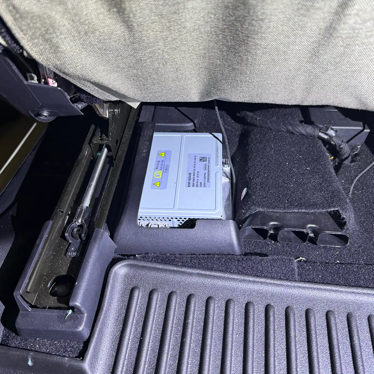

The inverter, at least on my truck, is under the drivers seat. The outlets are one behind the center console and one in the bed.
Looking at it, I don't think it would be such a big deal to upgrade it. However, Ford already indicates in the manual that output could be limited when in gear to 300 watts, so there may not be much extra power from the alternator.
I added a USB-A and C charging port in the bed in addition to the 120V existing outlet. Even though ford removed the 12V outlet in the bed for 2025, they still ran the 12V to the back connector that feeds the bed outlet. So it can be added after the fact.
And I will go out on a limb and say, even the new 2025s without the convenience package have that wiring. And you could add in 120V afterwards.
What I am seeing now, is a lot of things charge with USB-C. Like in my case, I have a small sprayer that I use to clean up after going to the beach and it charges while I drive. And I am probably going to get a small air pump that will be USB-C recharged.
The nice thing about AC outlets is you can plug in chargers and while 400 watts doesn't should like a lot, it is a lot for charging things and very convenient.
But again, the inverter is only active only when the engine is running.

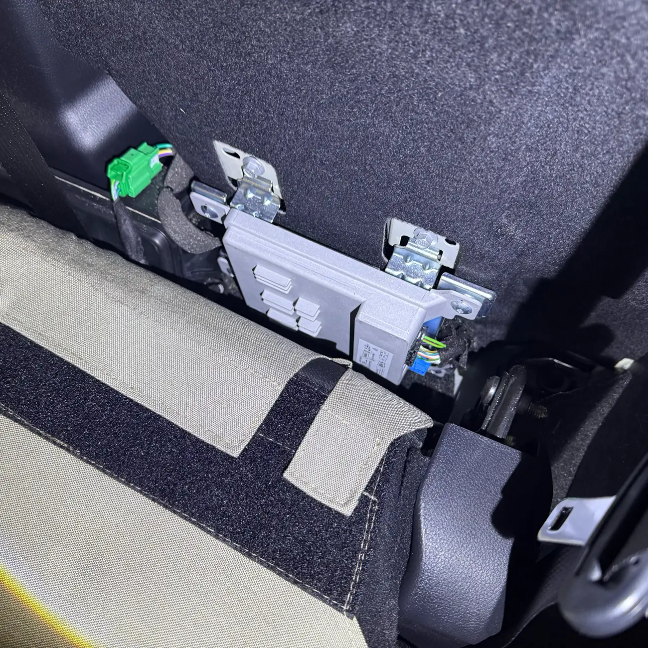

The AMP is behind the rear seat driver side.
