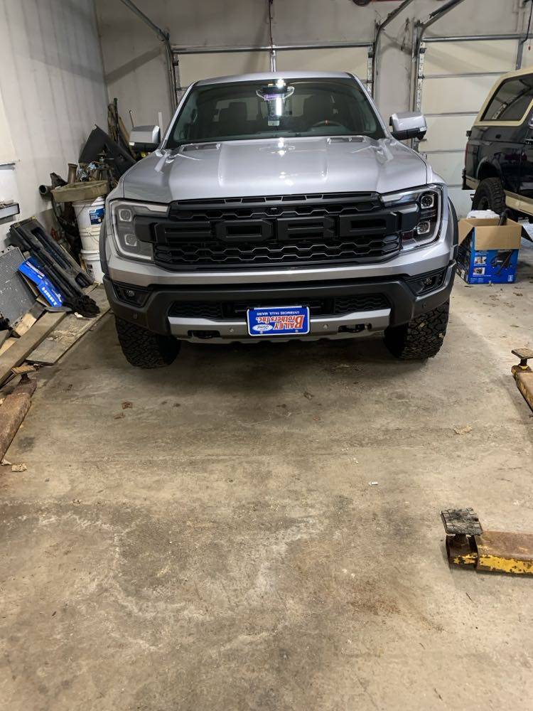

I never got that message with my license plate in the stock location. But I hated how high the license plate is mounted so I came up with a license plate bracket flip mod to lower the license plate. It looked great but blocked the collision sensor so it was disabled as well as acc.
If your license plate is in the stock location it shouldn't be blocking the sensor.

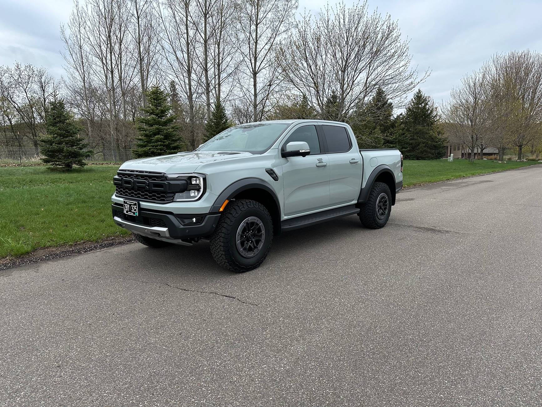

I think you might have it in the wrong place. Mine is right over the transition from bumper to grill….
this is clearly a raptor specific answer.

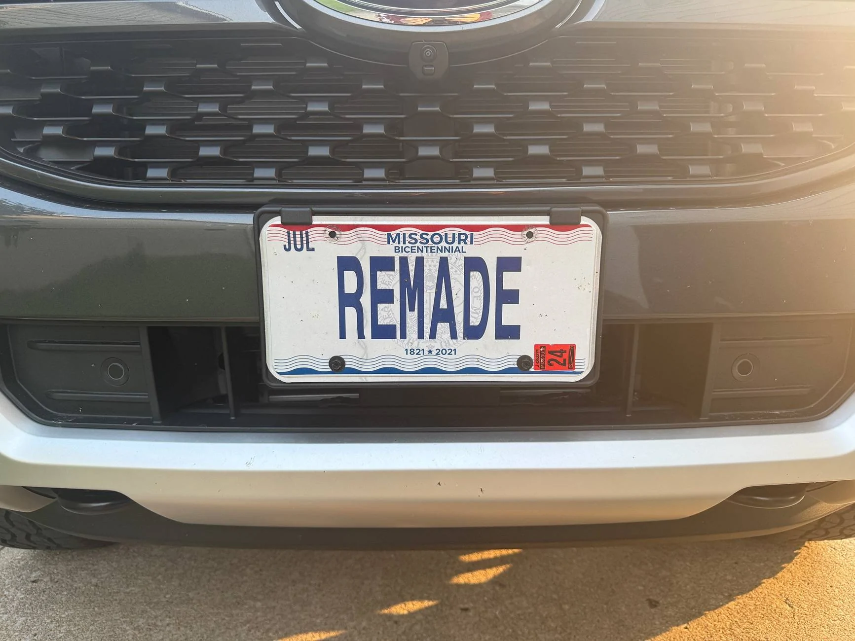

Ok, I’m fairly certain that this plate bracket is upside down.
my dealer accidentally put it on upside down and offered to flip it, but they’re 1.5hrs away.
tried taking it to my local dealer like 2 minutes away and the refuse to believe me when I say it’s upside down.
They say if I have them flip the plate it is not covered by warranty… and will charge me a 155 diagnostic fee.
But this plate is covering half of the Adaptive Cruise Control radar sensor.
I’m going to try to speak with the service department manager today.
