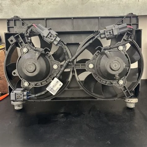

Sorry everyone,
I meant Air Charge Temperature not Intake air Temperature. Intake air temps would rise sitting still and no air movement. Charge air should benefit from fans pulling air through the intercooler. F150 Raptors come with fans attached to the intercooler.
Ford Ranger ACT Temps intercoolerfans

You will never see much air move through the intercooler core by the radiator fan on our truck. Air acts as a fluid, so it's always going to take the path of least resistance unless forced. The radiator fan can't move the type of air a moving vehicle can, so the air it draws mostly goes around the IC at idle and low speeds, before being pulled through the radiator core.
You hit on a good question. Should those of us who do a lot of slow speed trails consider adding an intercooler fan to our truck? I'm going to say yes. An IC fan kept core temps down on my Tbird while idling in the staging lanes between passes, keeping heat soak at bay. I don't see how it couldn't benefit our trucks as well, but I have no idea if any of the current IC options leave enough room for a fan(s).
