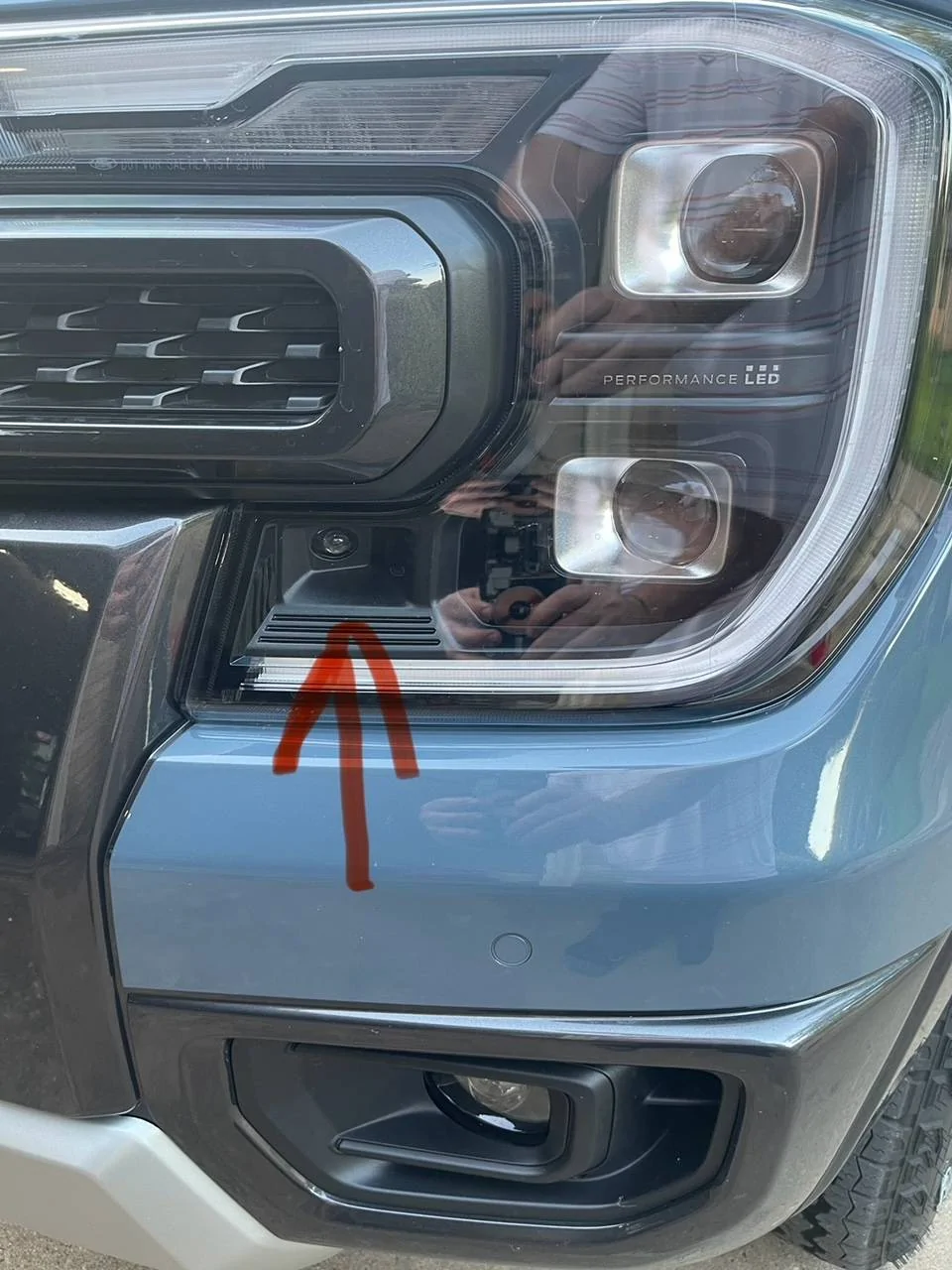

I had this pop up on me today. The right turn signal would blink faster than the left, even though I could see it come on. All headlights were working, no matter how many times I turned the truck off and back on again it would keep coming up. After leaving the truck off for about 4 hours the error didn't show up when I started it back; however, I also noticed these lights aren't coming on at all...I'm assuming they are part of the zone lighting? I swear I got a dud with all the issues I've had so far

That arrow is pointing to a camera.
Thank God…that does not even remotely look like a camera lol. Still had the errors popping up tho

The arrow is pointing to lights. You could call them cornering lamps. LOL They only come on when headlights are on and steering wheel is turned as if you were rounding a corner.. LOL Lights up the corners of the roads.

That's a light? I thought the headlights turned on the Raptor?

It’s odd they don’t have the headlights as cornering lights since they move around when you turn the truck on. In both my st and RS the headlights turned with the car as well as having a cornering light come on

The headlights do shift as well but I don't think its the same functionality as the cornering lamps. The headlights shifting is more for when you are taking a bend on a road, the lights shift slightly in the direction you're steering to illuminate the bend ahead.
You can see it more clearly if you (safely of course) quickly jerk the wheel back and forth on a dark road, you'll see the headlamp illumination shift side to side.

The head lights do turn with steering input, the lights that are being pointed to in the picture are corner lights, they shine on to the corner in which you are turning. The headlights moving around will light up around a corner futher ahead of you, these little lights will light up the corner.
Try it at night when stationary and you'll see them fade on and off when you add lock to the steering wheel

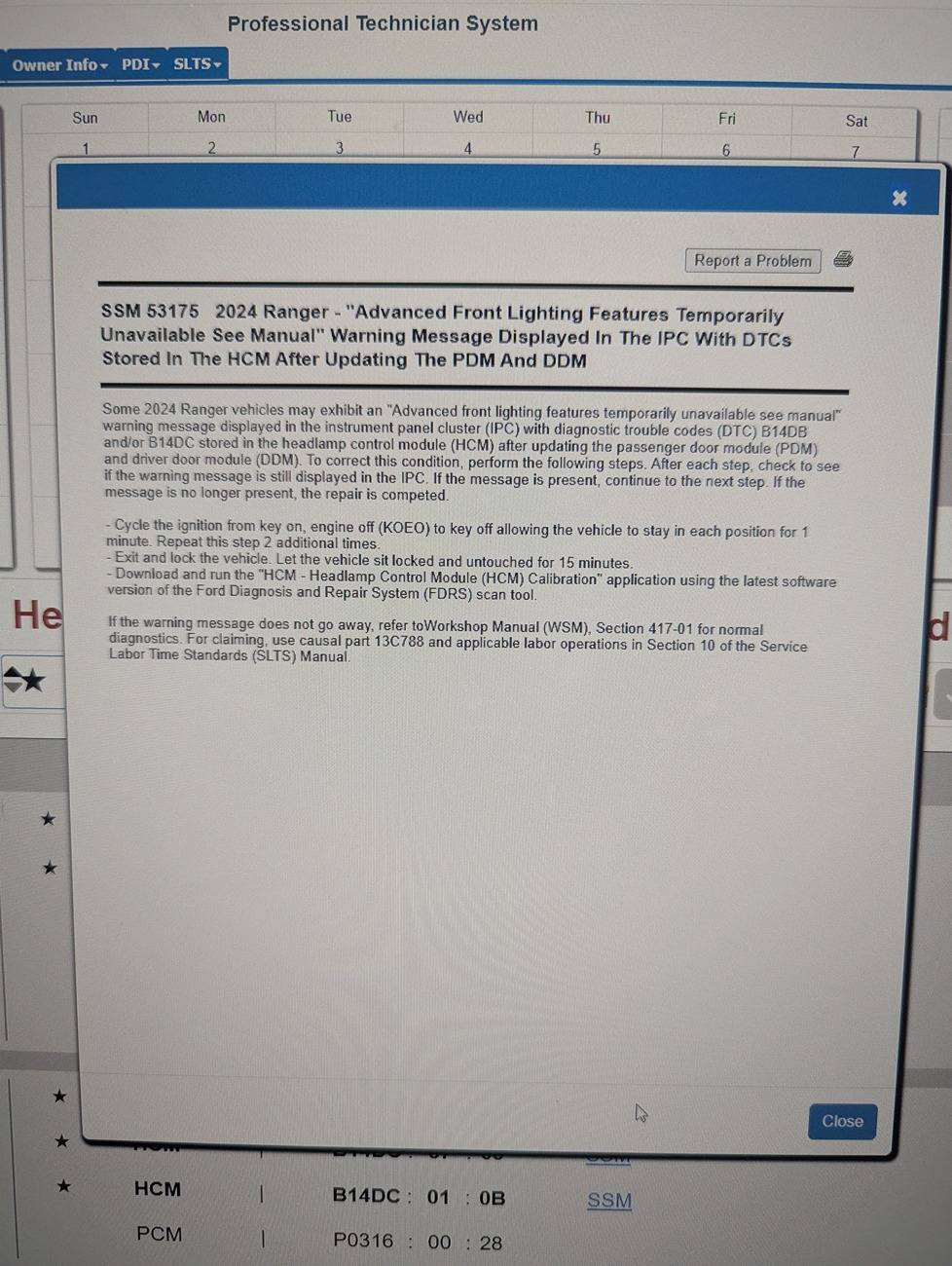

Did this issue ever come back up? I just got this warning message.
Edit:
Apparently this can happen after the DDM and PDM are updated.
