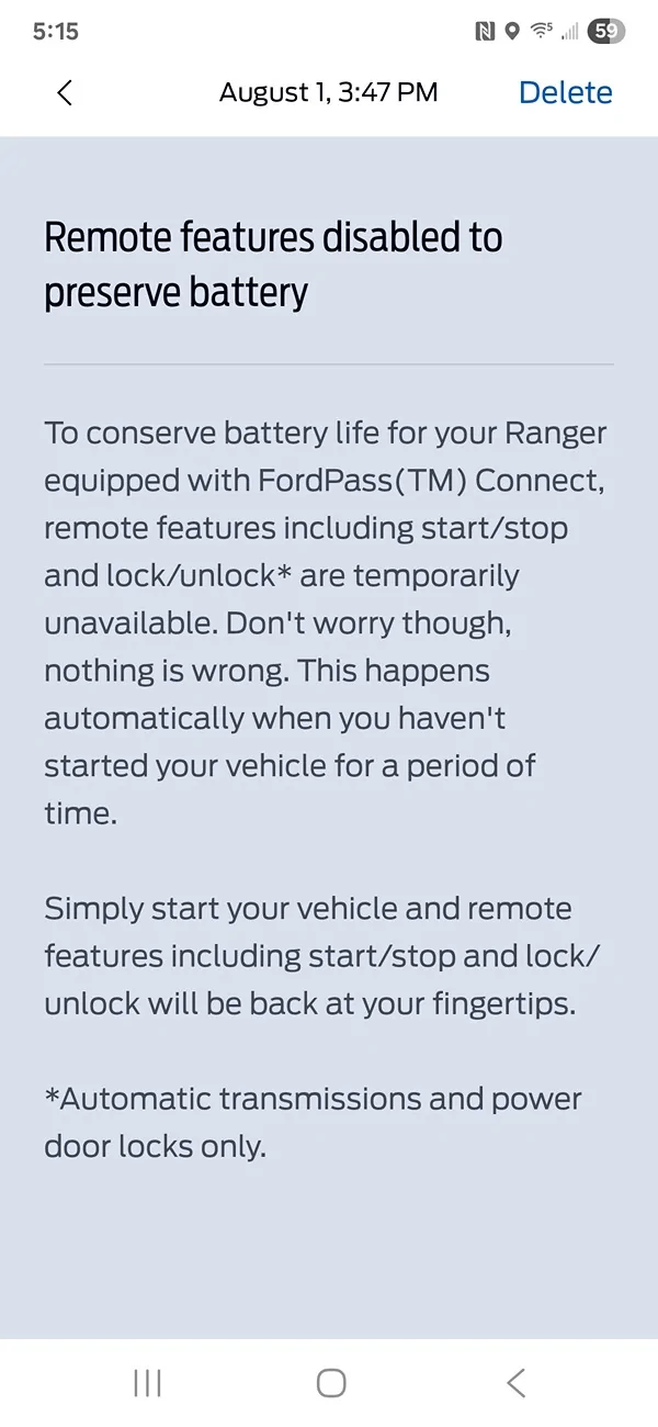

I have been getting these messages remote features disabled to preserve battery .
And need to start engine I drove the truck 2 hours ago.
Ford Ranger Remote features disabled message 1000007849
