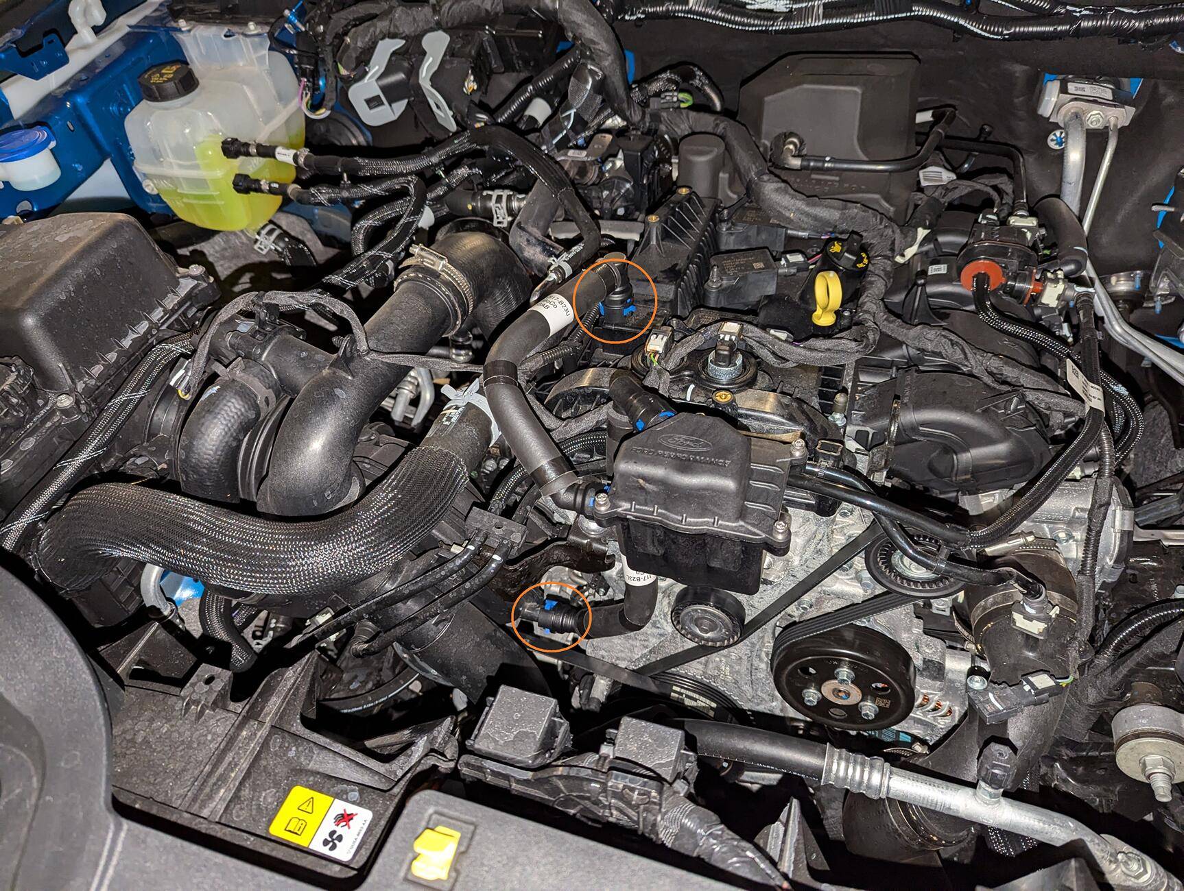

@greaserman, I don't have any pics before it was it was installed. I like how the PCV goes into the bottom and the air has to go up through the filter inside the catch can, and then out to intake. The bracket that comes with the catch can mounts to existing studs on the cam cover. The AOS comes with blue clips that are twisted to disconnect, it's much better than the orange OE clips.
*Orange circles are where it connects to the PCV and intake.

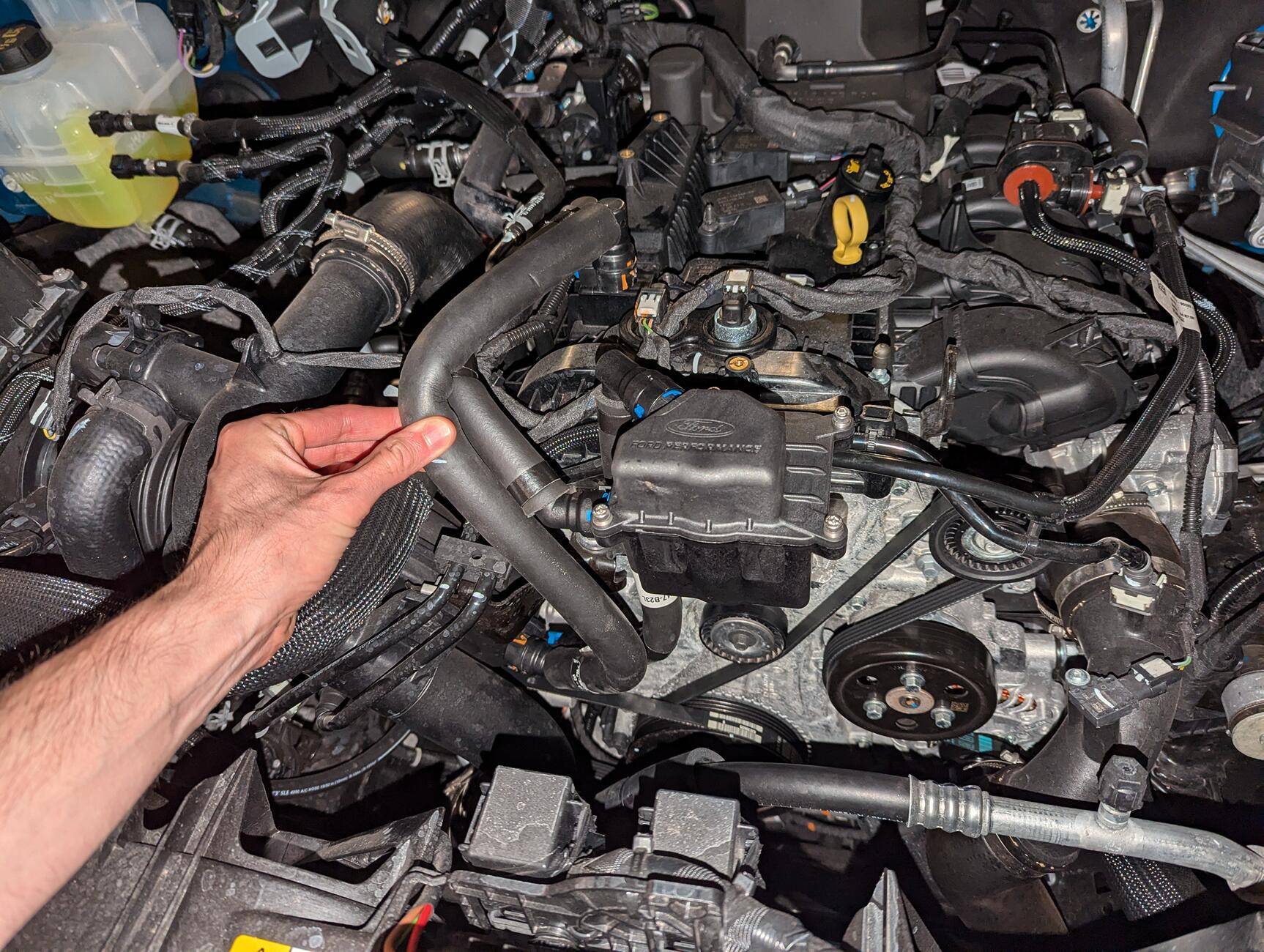

Here's the old hose for reference, notice the orange tabs that you have to break to get the connectors off:
