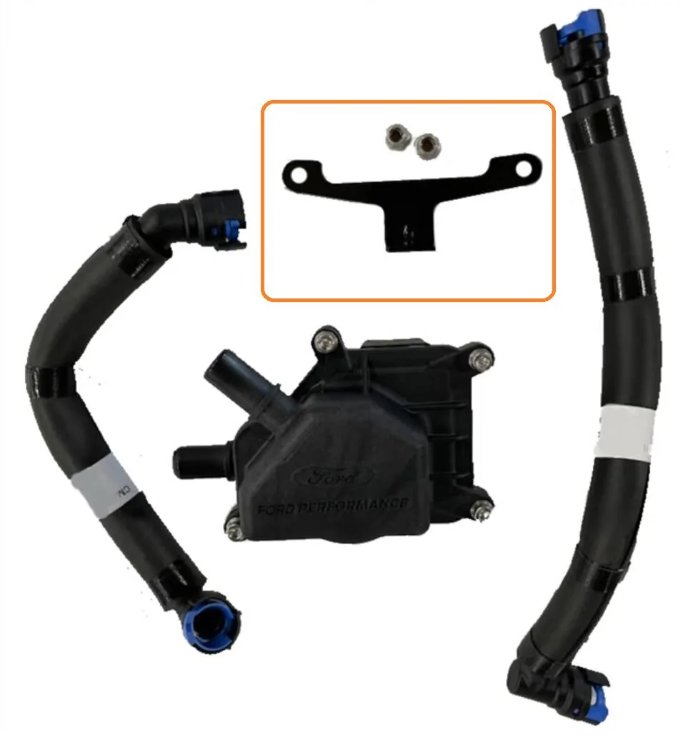

@greaserman, Yes, there is black metal bracket that goes under wires in front of the cam cover. Here's a link to the instructions. Microsoft Word - IS M-6766-B23 051923 (ford.com) and this is the bracket:
Ford Ranger Air Oil Separator 2.3 1727659735939-nd
The metal tab points up and the catch can slips onto it.

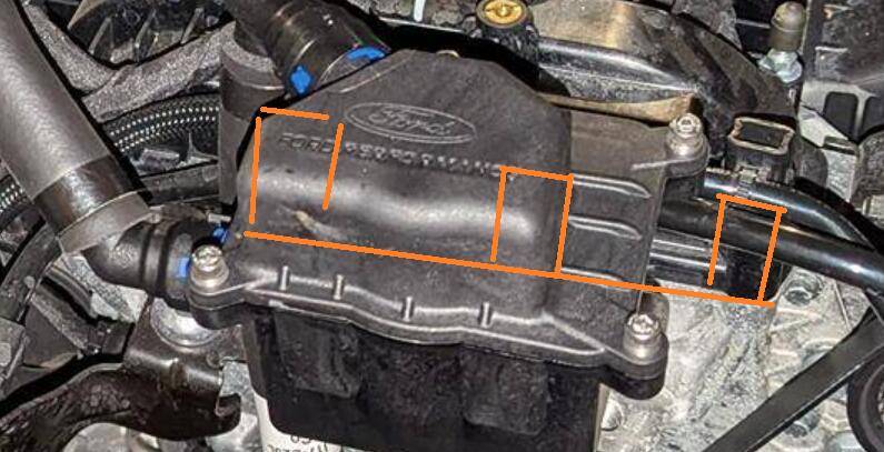

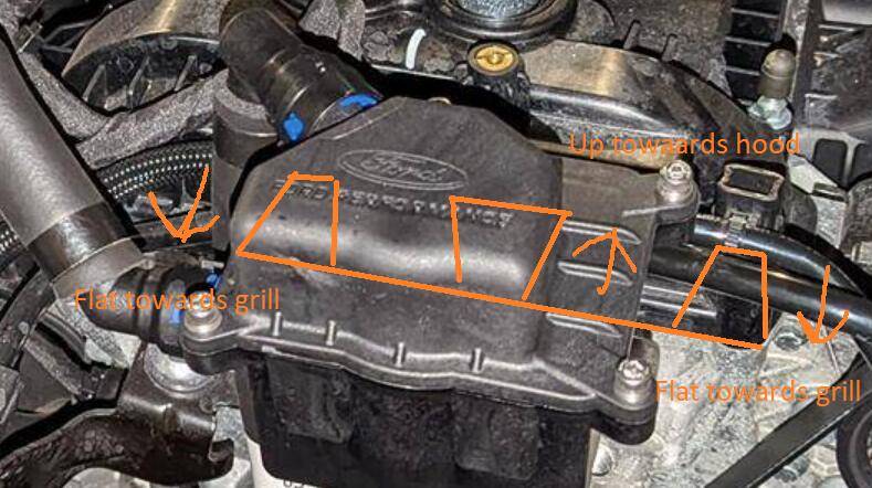

Apologies for this being a crude drawing but this is what it would look like if the catch can is transparent. The trapezoids are supposed to show what direction they are pointing. -It's bad, I know lol
Ford Ranger Air Oil Separator 2.3 1727660096545-e0
But I do hope this helps and good luck!
