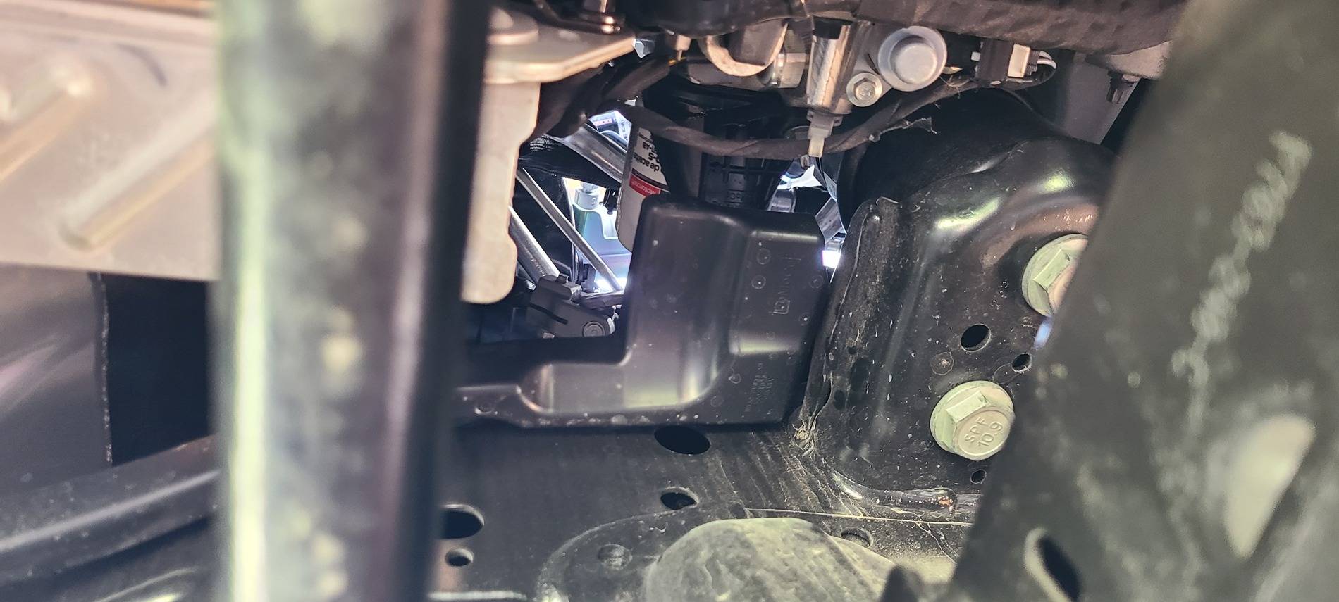

Ok, just did another oil change and did it from underneath this time. Laying under from a different direction and i saw where i could reach up and take the filter off easily. Went just like i thought and all done. Moved to royal purple this time.
Ford Ranger Oil Change on the 2024 2.3 Engine ??? 20250614_155830
See the filter above the drain try?

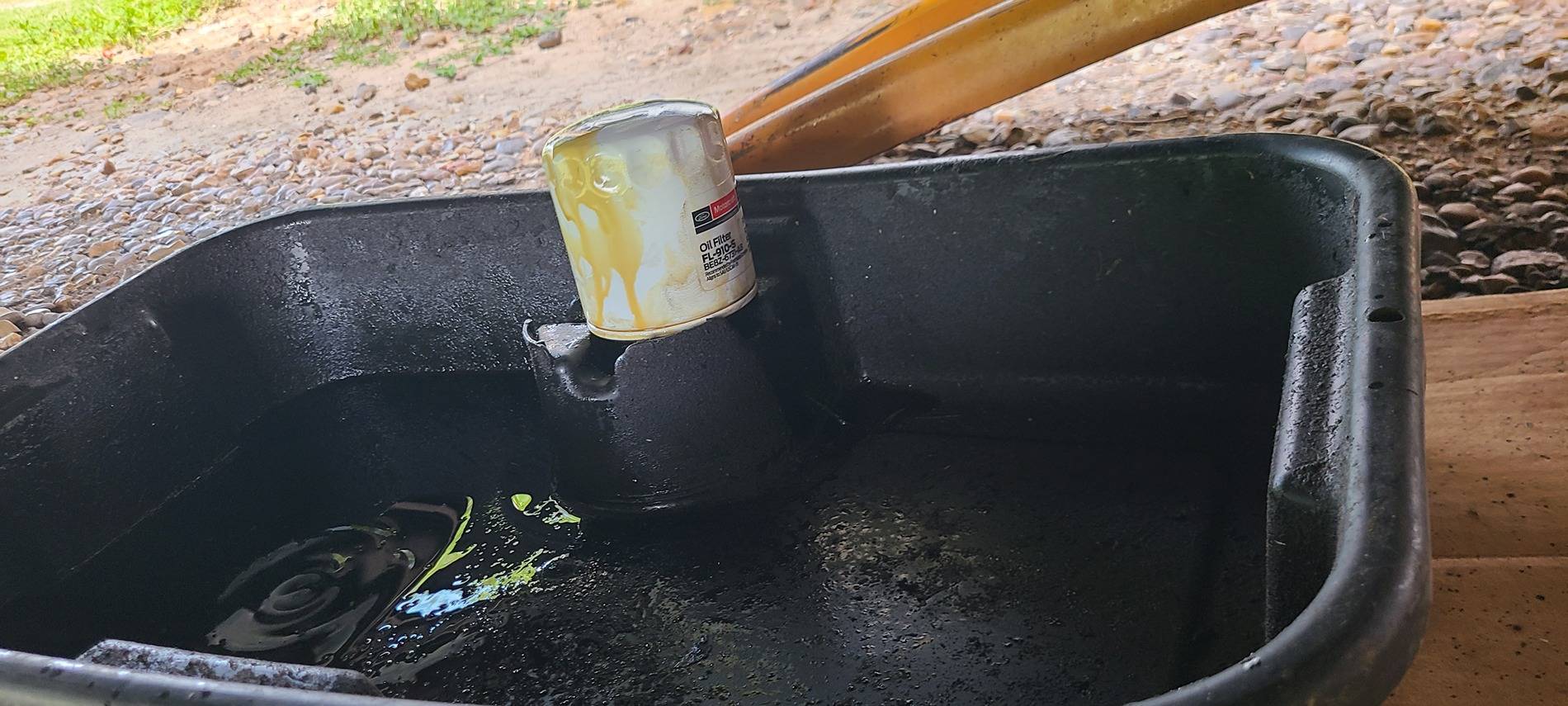

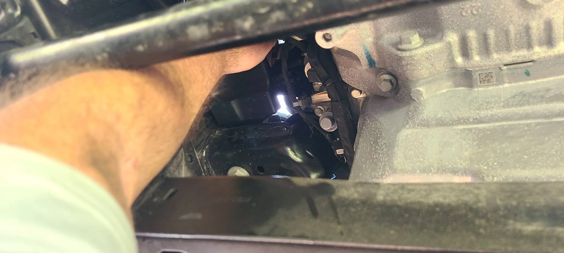

Ford Ranger Oil Change on the 2024 2.3 Engine ??? 20250614_155841
Reached between the sway bar and cross member, next to that aluminum tray looking deal and was able to grab the filter and turn it off.
Ford Ranger Oil Change on the 2024 2.3 Engine ??? 20250614_160027
And of course, i dropped it and dumped oil down the frame. You have to take it out fillowing the oil drain tray and it comes right out, till i slips and makes a mess. Oh well, frame is rust proofed there now.

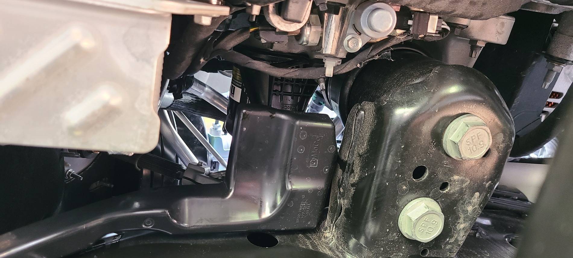

Ford Ranger Oil Change on the 2024 2.3 Engine ??? 20250614_160246
New filter goes on following the same way you removed the old one.

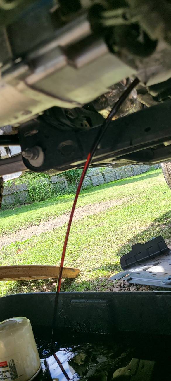

Ford Ranger Oil Change on the 2024 2.3 Engine ??? 20250614_160427
Drain the old oil and then wipe down everything and put the bolt and aero tray back in when done.

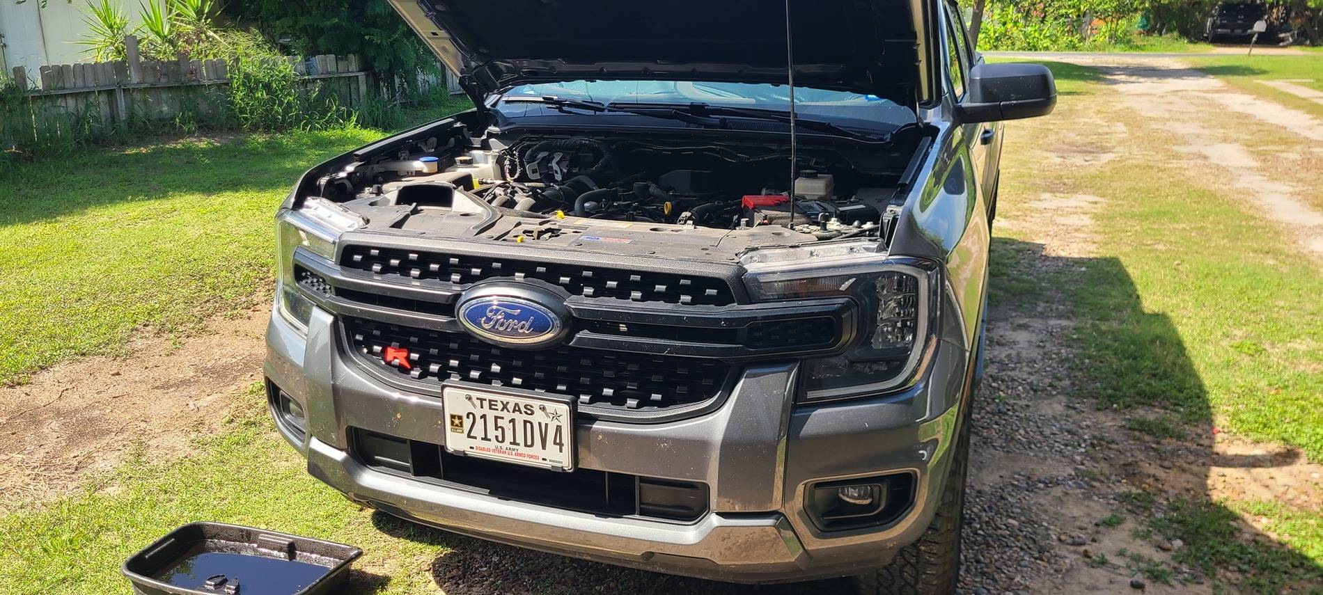

Ford Ranger Oil Change on the 2024 2.3 Engine ??? 20250614_162057
Fill the engine back up and change your air filter and you are done
