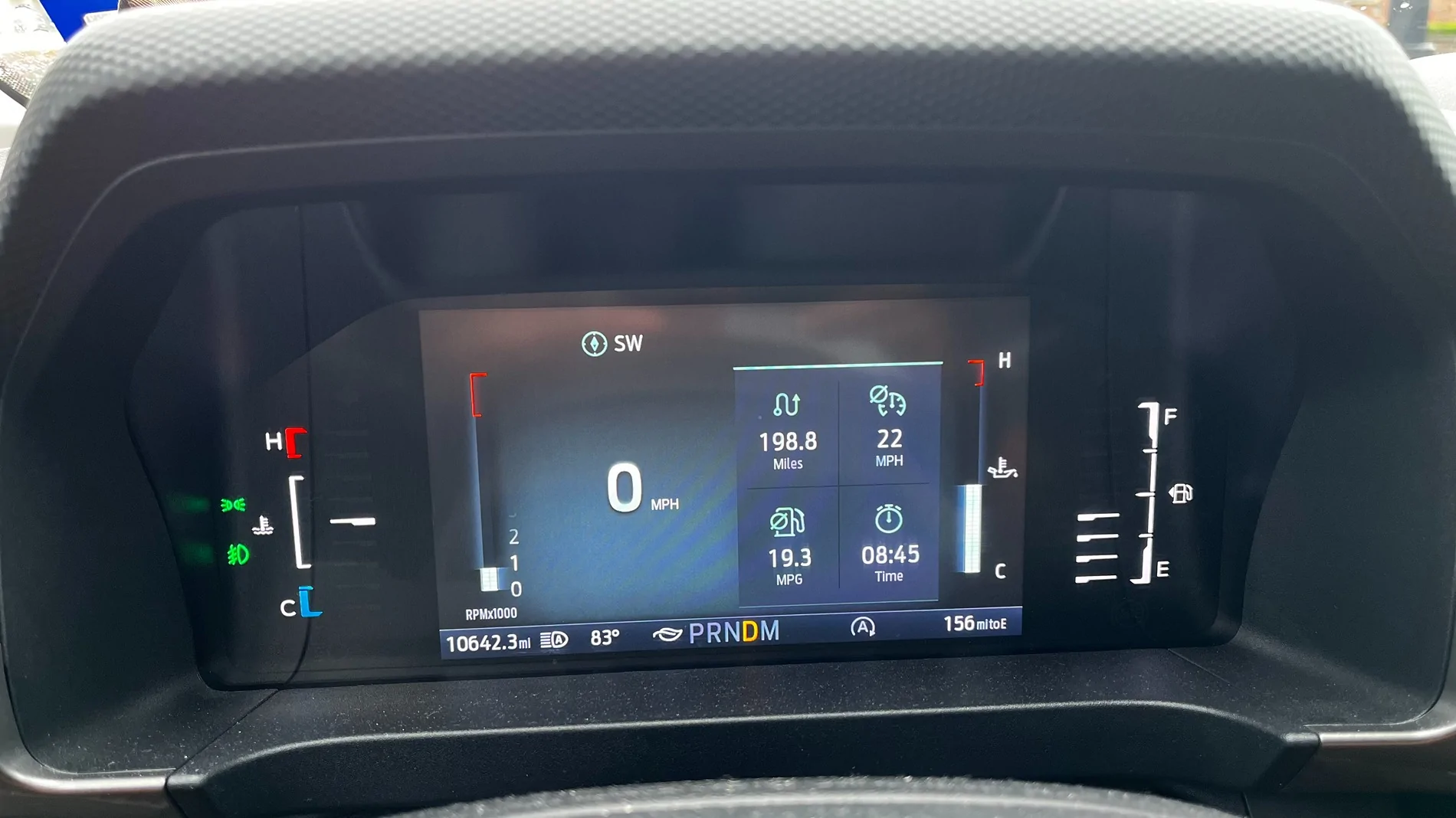

2. I hadn't looked at the oil temp gauge level closely before the change. Yesterday, after about 40 minutes of driving, the gauge was at about 45% (little below half). Is that the normal temperature? Any of you seeing the same (pic attached)?

The temp is normal. I haven't done my first oil change yet so I was unaware of the crush washer. All the washers I am seeing online are copper which I would reuse 20 times before replacing. If you have a photo of the washer that would be great.
