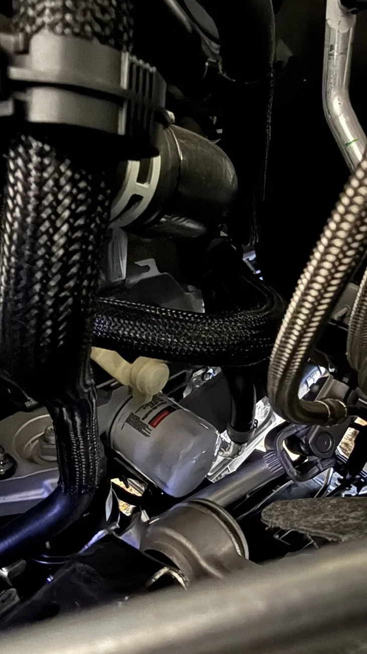

Just did the first oil change. Since I was already spraying the frame and underbody with ACF-50, I had the truck up on jack stands.
I changed the filter from underneath, but honestly it looks just as easy to access from the top if you prefer that route. I went with a K&N HP-1020—the nut on the end makes removal simple with a short 1" wrench.
Overall, the 2.3L EcoBoost in RWD layout is a dream to work on. Tons of space compared to my 2.7L EcoBoost 4x4. Even transmission service looks straightforward—no exhaust running near the fill/level plug, just wide-open access.
