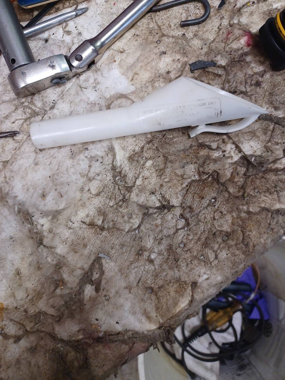

If ya have 2 wheel drive ya can go under left side and get oil filter off/on...4x4 gota go through left wheel era..getting inner fender out way is bitch!!! Ford used half screws half plastic push in fasteners...on oil refill takes full 6+ qt just 6 qt guts just above lower add dot. Did any one get a gas funnel for self sealing gas cap?? When I worked at City Garage every ford had one in glove box!! I didn't have a funnel here that would get pass cap!

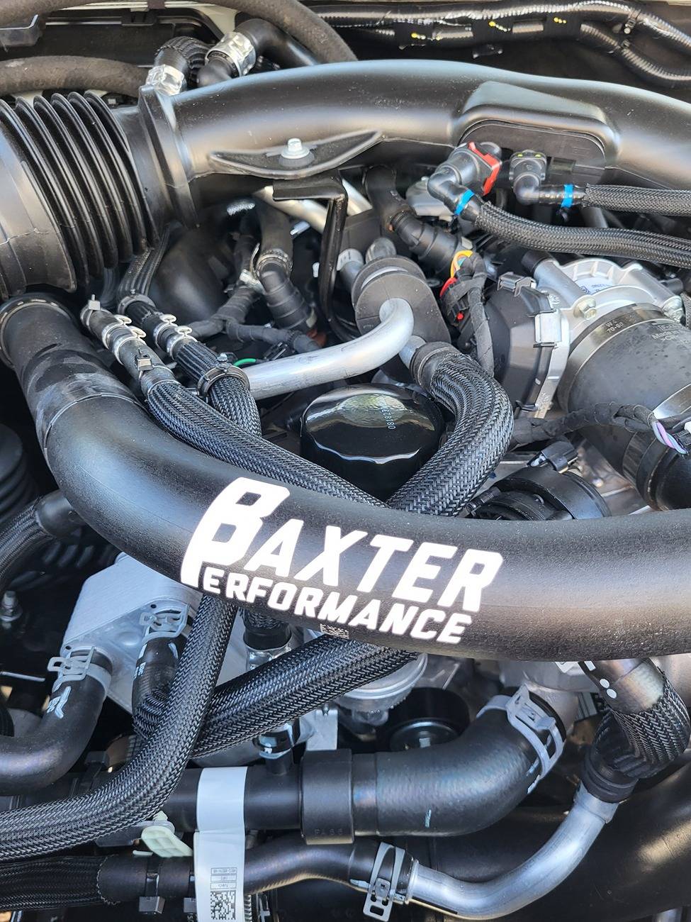

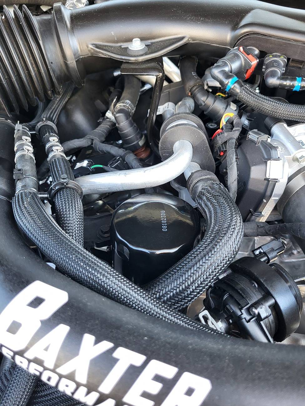

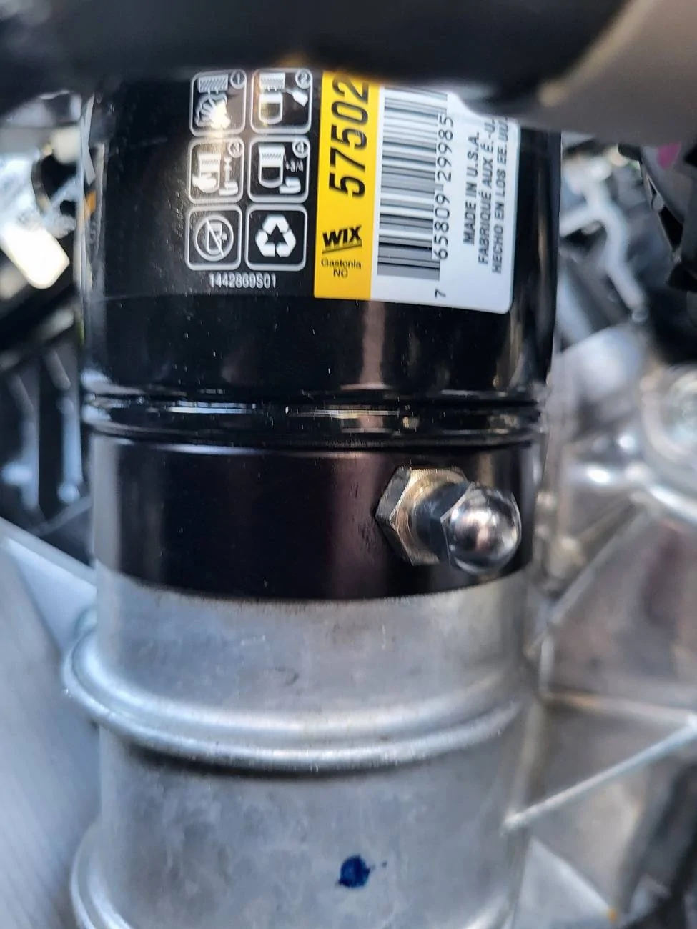

I changed my oil at 500 miles and added Baxters Performance oil filter adapter. It has a check valve to prevent dry starts it uses a wix 57502 spin on oil filter.

I thought that funnel was specifically for adding gas from a gas can (it goes into the self-sealing gas filler and pushes it open so gas from a container will go in, like if you run out of gas). You may not want to use it for oil.

I changed my oil at 500 miles and added Baxters Performance oil filter adapter. It has a check valve to prevent dry starts it uses a wix 57502 spin on oil filter. Didn't see an adapter on their site specifically for the Ranger raptors motor but will call and ask!! I'm glad they have something available.
