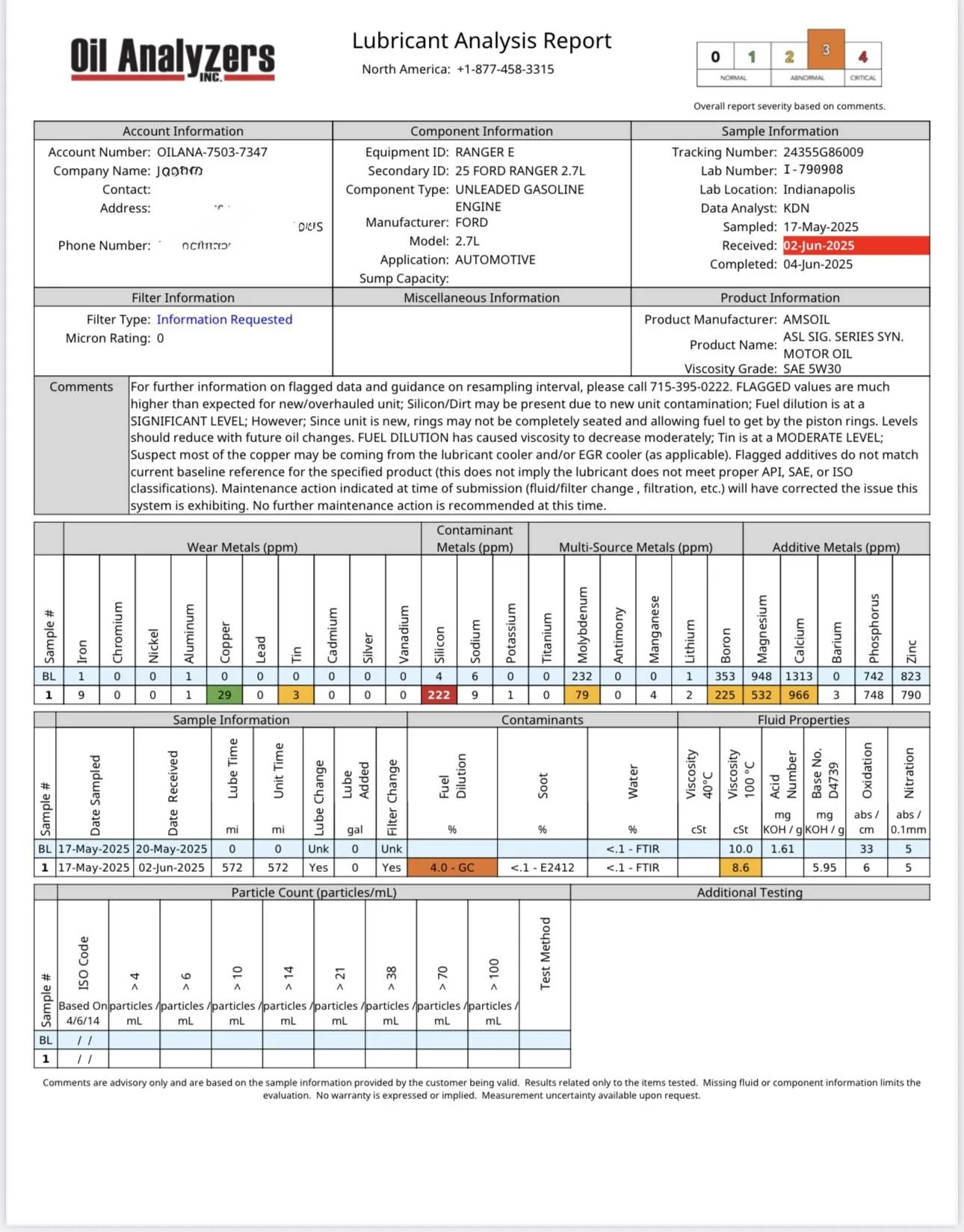

First, thank you for posting. I use the same UOA service, but am holding off testing for break in. I have 550 miles on my 2.7. Amsoil SS is a really good choice, I changed my oil to PUP. Seems there is a few obvious manufacturing leftovers in the first sample and nice to see the trend follow break in. Very informative info.

Got the updated report, I think I was idling too much in my cold weather, will be making the next oil change a bit sooner to see if that helps
Got the free Blackstone kit and will run both on the next sample.

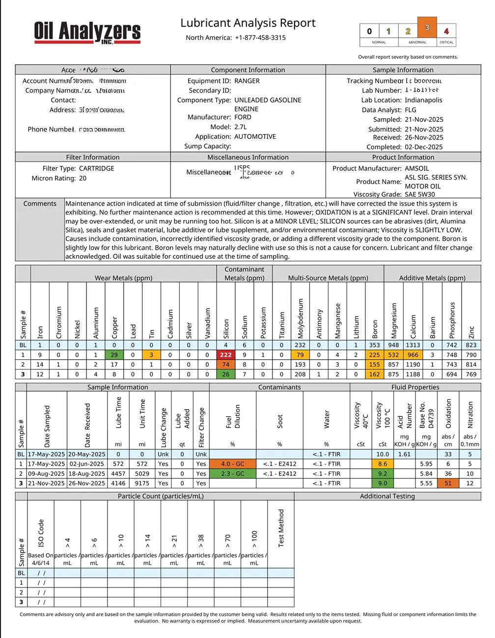

Then asked Gemini to compare the report against the data above:
Looking at the lab report for your Ford Ranger 2.7L, it is clear why the lab flagged the AMSOIL Signature Series 5W-30 with a "SIGNIFICANT" oxidation level.
The oxidation reading reached 51 abs/cm. To a standard lab algorithm, this looks like the oil is thickening and breaking down, but the data in the report suggests a different story.
1. The High Baseline Artifact
The most important number in this report is the Baseline (BL) Oxidation, which is listed at 33.
  • The "False" Jump: Most standard oils start with an oxidation baseline near zero. Because AMSOIL Signature Series uses high-quality esters, it has an "intrinsic" oxidation signature before it even enters the engine.
  • Actual Degradation: Your oil didn't "oxidize" by 51 points; it only increased by 18 points (51 minus the baseline of 33) over the course of the drain interval. For nearly 14,000 miles on the component, an 18-point rise is actually very stable.
2. TBN vs. Oxidation: The "Safety Net"
If the oil were truly oxidized to a "significant" degree, its ability to neutralize acid would be depleted.
  • Your Total Base Number (TBN) is still at 4.68.
  • Generally, oil is considered "spent" when the TBN drops below 1.0 or 2.0. At 4.68, your oil still has plenty of active additives to protect the engine, despite the lab's oxidation flag.
3. The Real Culprit: Fuel Dilution
The lab notes that the viscosity has decreased slightly below grade. While the analyst suggests this might be due to oxidation (which usually thickens oil), your data shows the opposite: the oil is thinning.
  • Fuel Dilution is at 3.1%, which the lab correctly identifies as MODERATE.
  • This fuel (gasoline) is acting as a solvent, thinning the 5W-30 oil down to a viscosity of 9.2 cSt.
  • The report notes this may be caused by "excessive idling" or the rings not being completely seated yet if the unit is relatively new.
Summary of Your Report
MetricResultMeaning
Oxidation (51)Flagged SignificantMostly a "false positive" due to the high-ester baseline of 33.
Nitration (13)NormalSince nitration is low, it confirms the "oxidation" isn't caused by heat or combustion distress.
Fuel Dilution (3.1%)ModerateThis is the actual cause of the viscosity drop, likely from short trips or idling.
Wear Metals (Iron 16)Low/StableDespite the flags, your engine wear (Iron, Copper, Lead) is trending downward or staying very low.
The Verdict: The AMSOIL is holding up chemically, but the fuel dilution is the metric to watch. If you do a lot of short-distance driving or idling in that 2.7L EcoBoost, that is likely why the fuel level is elevated.
