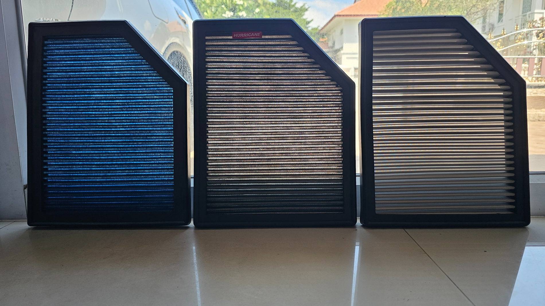

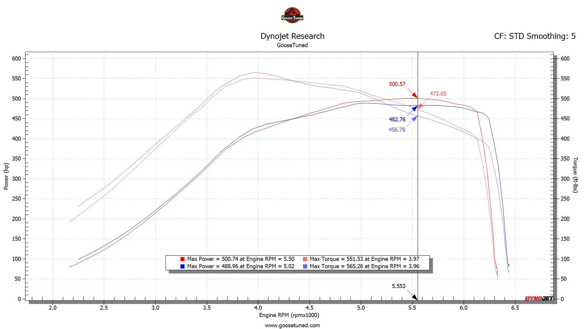

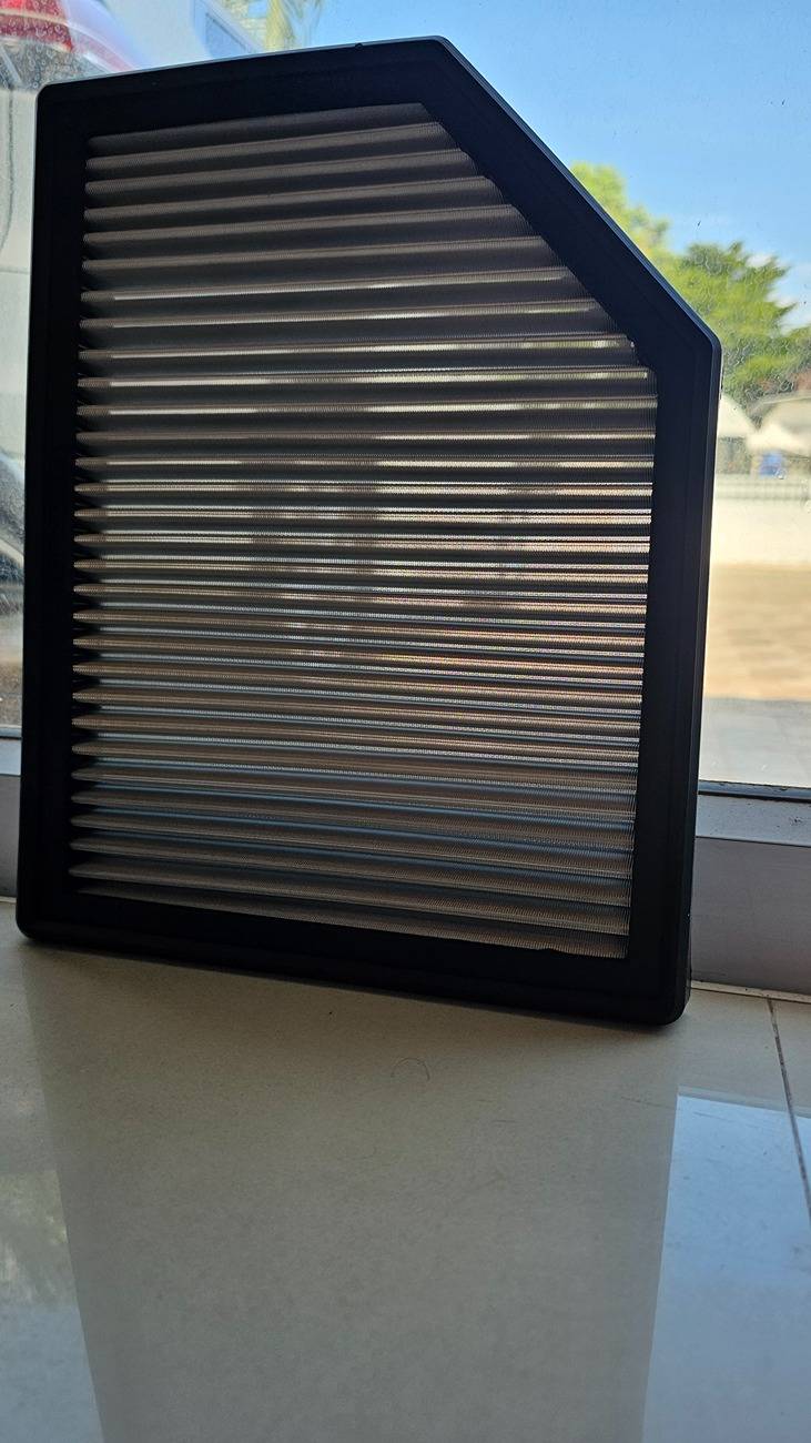

Goosetuned tested the S&B intake and picked up 15 hp. First page of this thread. I went with them as I had it on my F150 for 5 years and it was great. I'll never put enough miles on for all the "dirt" to wear out my engine prematurely. I put a BMC filter in then did the intake swap once S&B was back in stock. Btw, Porsche uses BMC filters on the $250k GT3 so I think we'll be alright.
