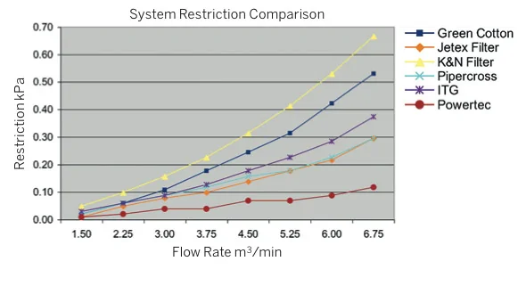

Stainless steel has the least amount of restriction. I've ran these filters on all my turbo cars and they absolutely make a difference over stock OEM. I agree though that all these aftermarket CAI show little if any gains. The RR already has a good CAI. Just change the stock AF out for a high flow type and save money. Powetech is the stainless.
https://www.fastcar.co.uk/tuning/performance-car-air-filter-test/
Ford Ranger ANY INDEPENDENT DYNO TESTS DONE ON COLD AIR INTAKES FOR RR 3.0? car_air_filter_test_results (1)
