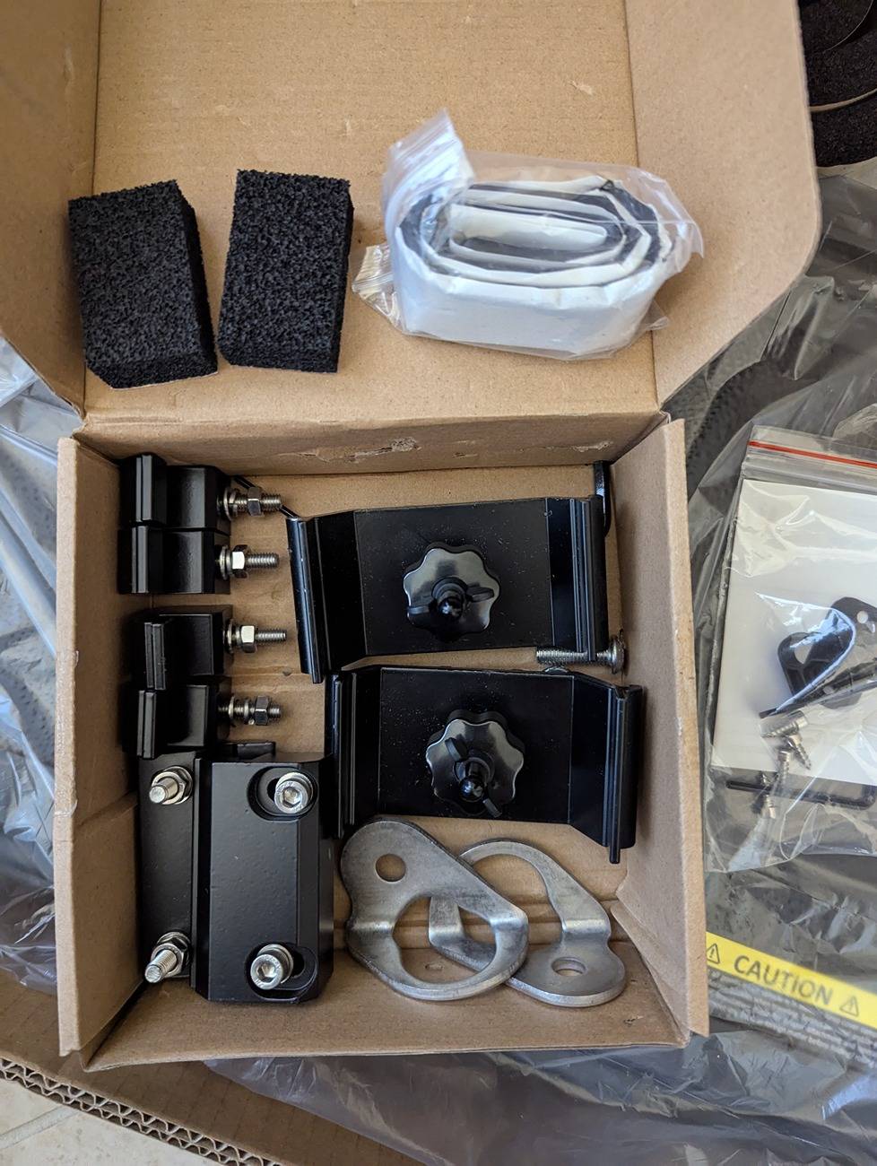

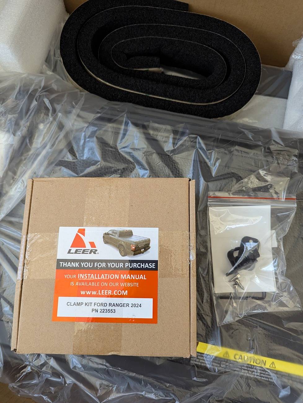

Can anyone confirm these are all the small parts in your box other than the rails and cover? Don't have my truck yet so want to make sure nothing missing. And no instructions at all?

Looks correct

So only two clams on each side? Again no parts list no instructions. Assume the 3M goes at the head of the bed to fill gap? What's the smaller sticky black stuff for lolol. Ugh

That's perfect. Thanks brother. I got no card but this is what I was.loolomg for. Buttttt no mention of where the 3M tape goes? Assume front bed rail. Also the black sticky tape stuff lol. What the heck you do with that? Assume behind each side rail??
Yaa, not even a clue with what to do with those in the instructions that I can see either ;-(

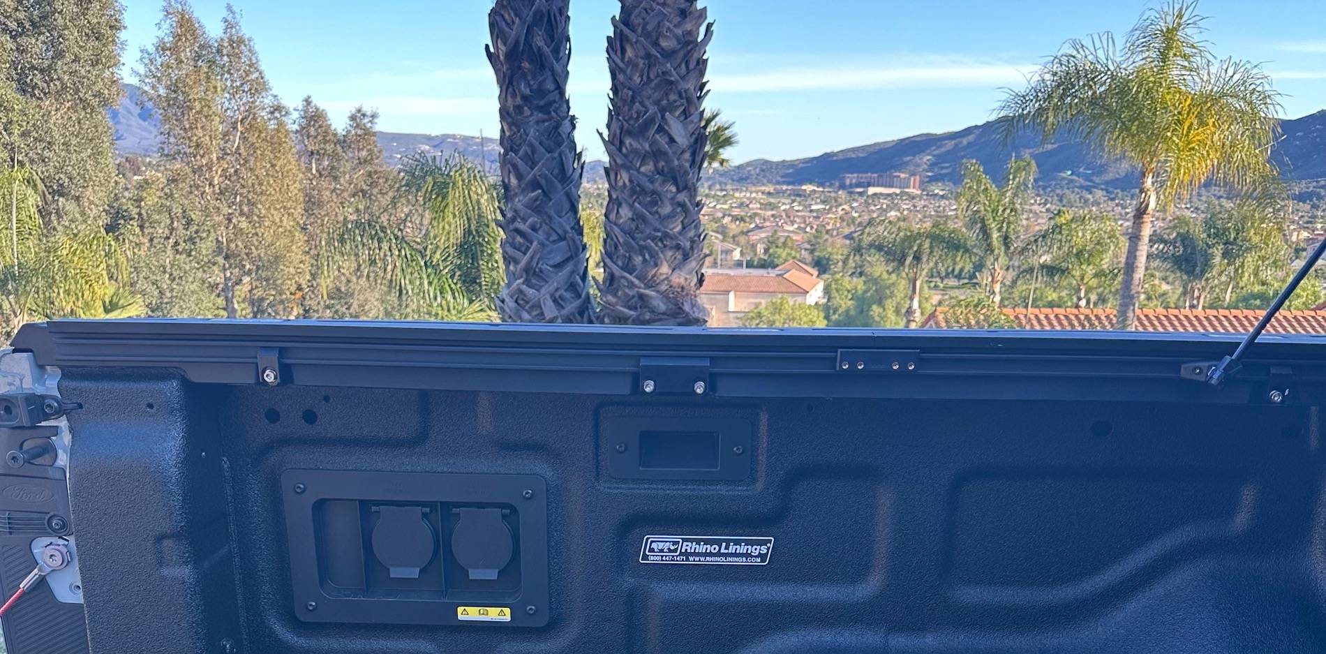

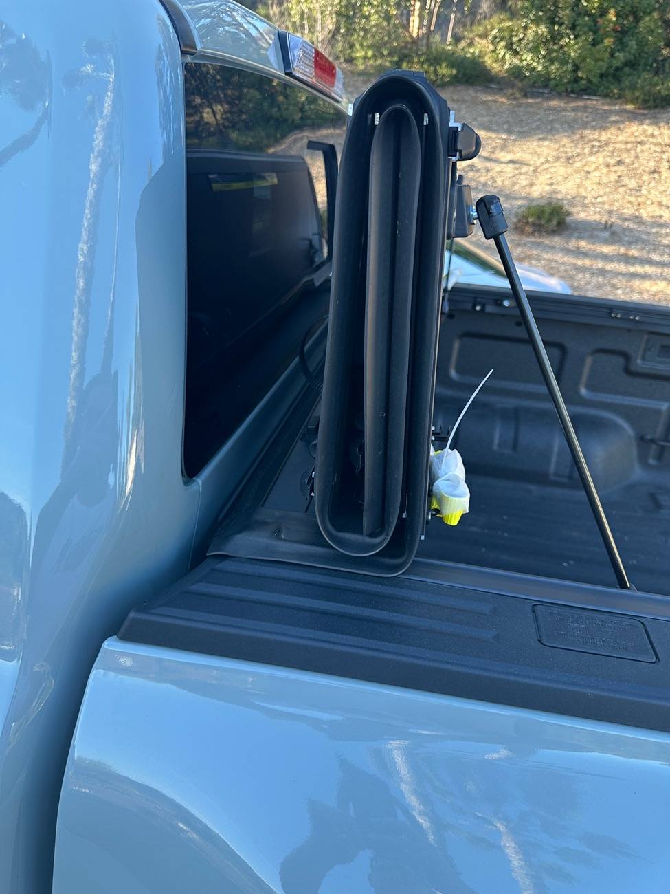

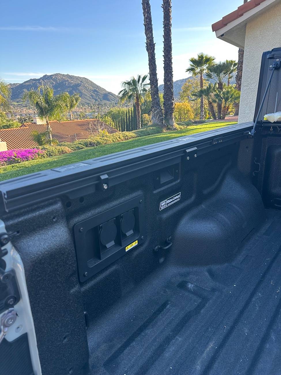

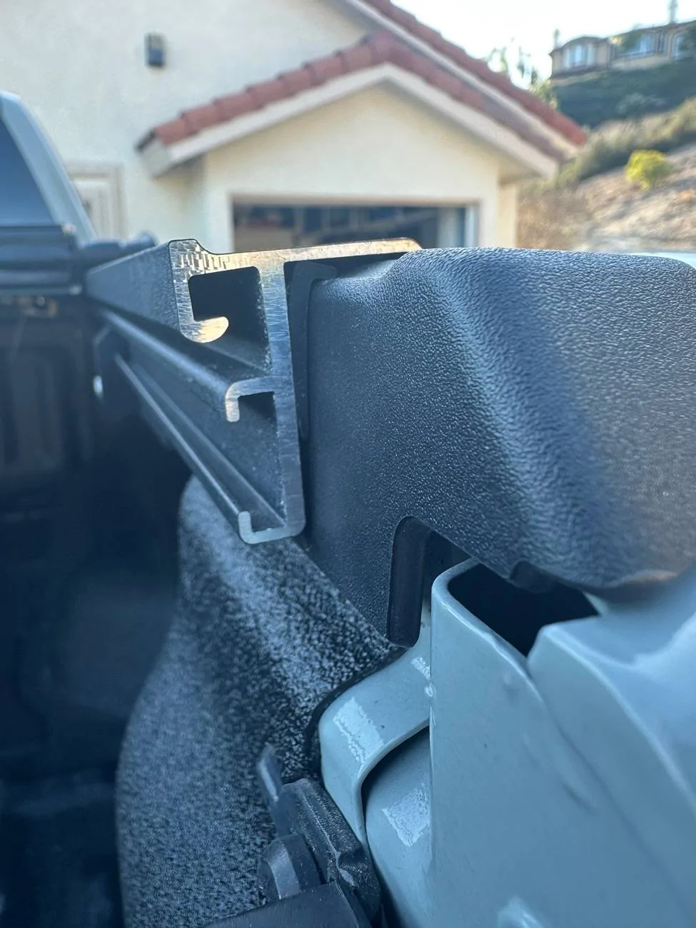

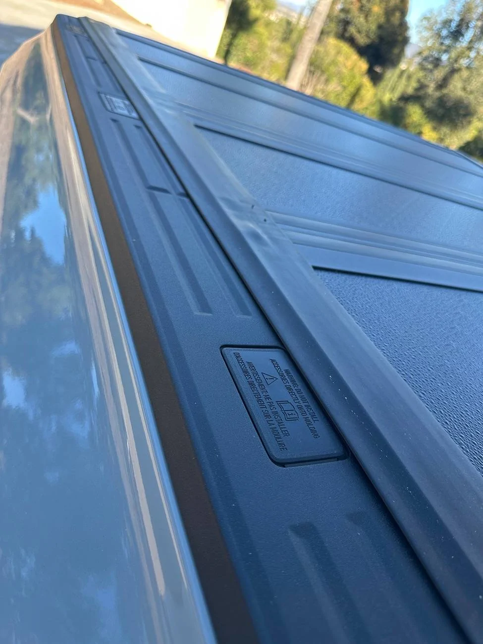

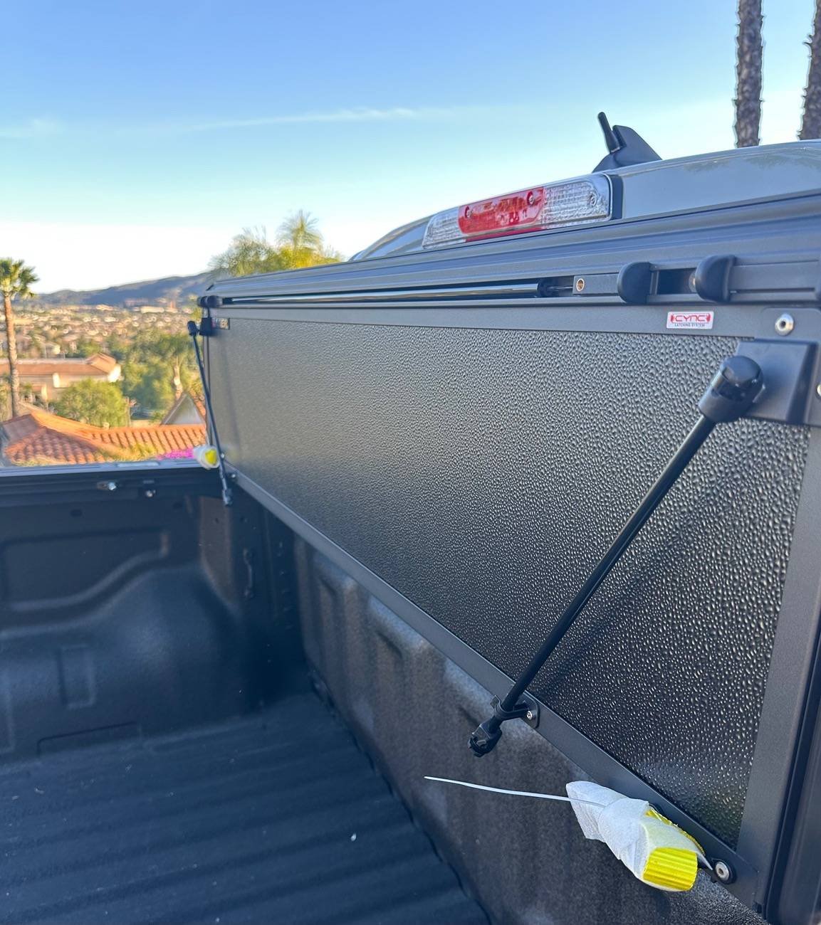

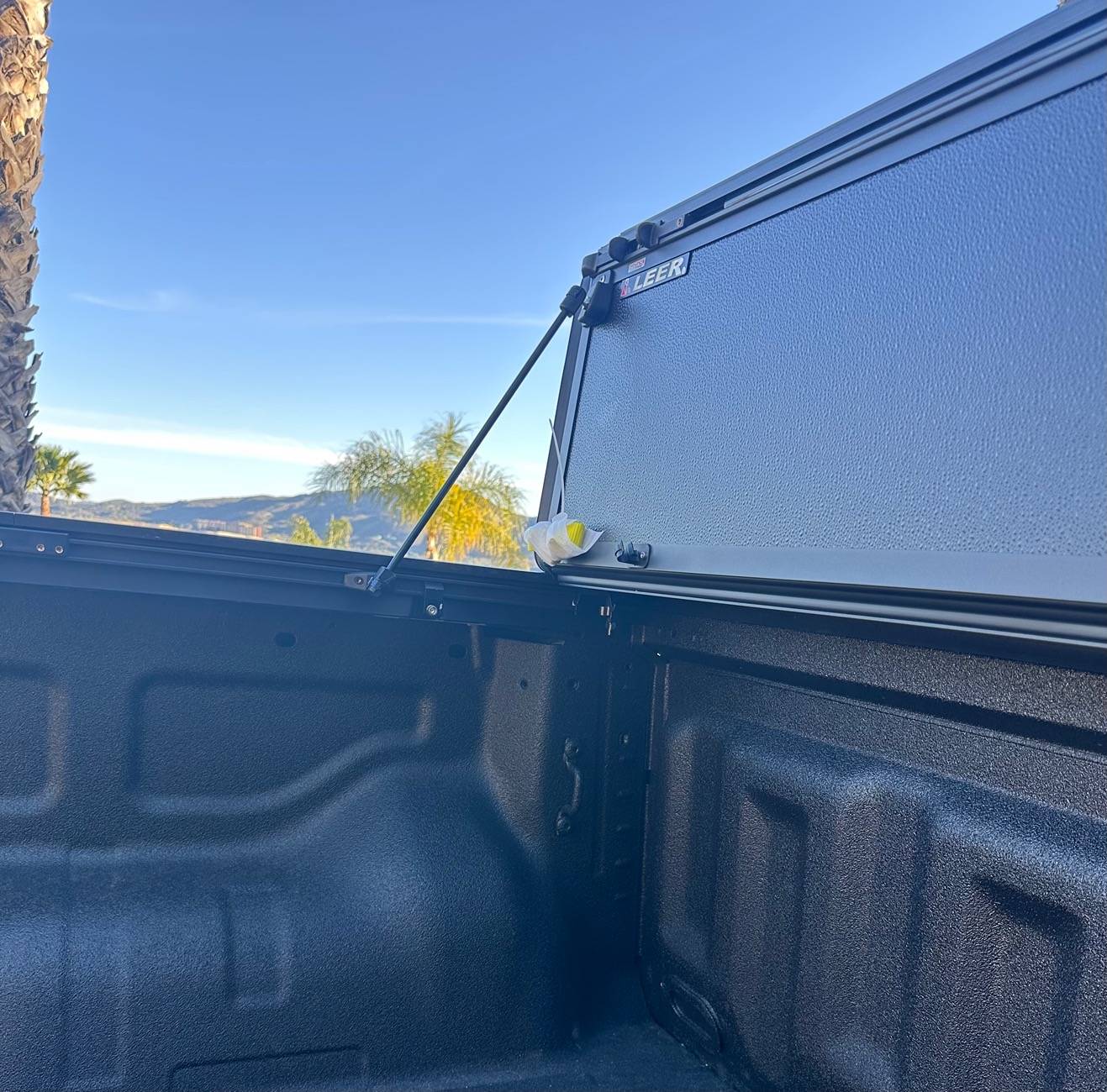

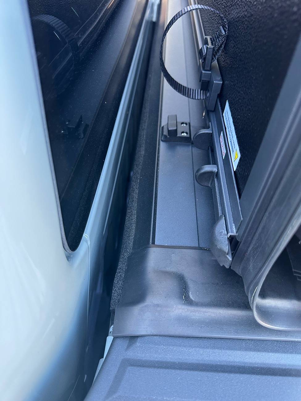

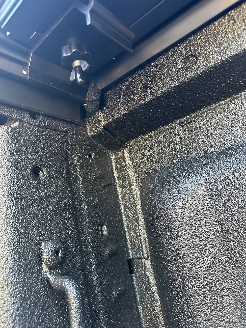

The long foam strip goes across the top of the bed rail close to the cab of the truck. You can see it sticking out in the pictures I provided. The 2 small foam pieces go between the side bed rails at the front inside of the bed so the side rails don’t hit the front inside of the bed. The thin smaller rubber strips go behind the metal rails along the sides of the bed.
Hope this helps.

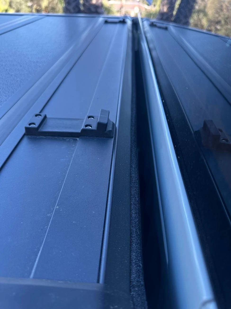

How does the top rubber strip look at the hinge point for the rear most panel? Mine has a bit of a crease.

You should have put the installation documents together lol. Great pictures and thanks for confirming my assumption as to where those parts went. Although nothing in the packaged instructions shows, that's exactly where I was using those parts. Just makes sense. Lot of guys just left them off. I think it seals it all up. Great job and thank you.
