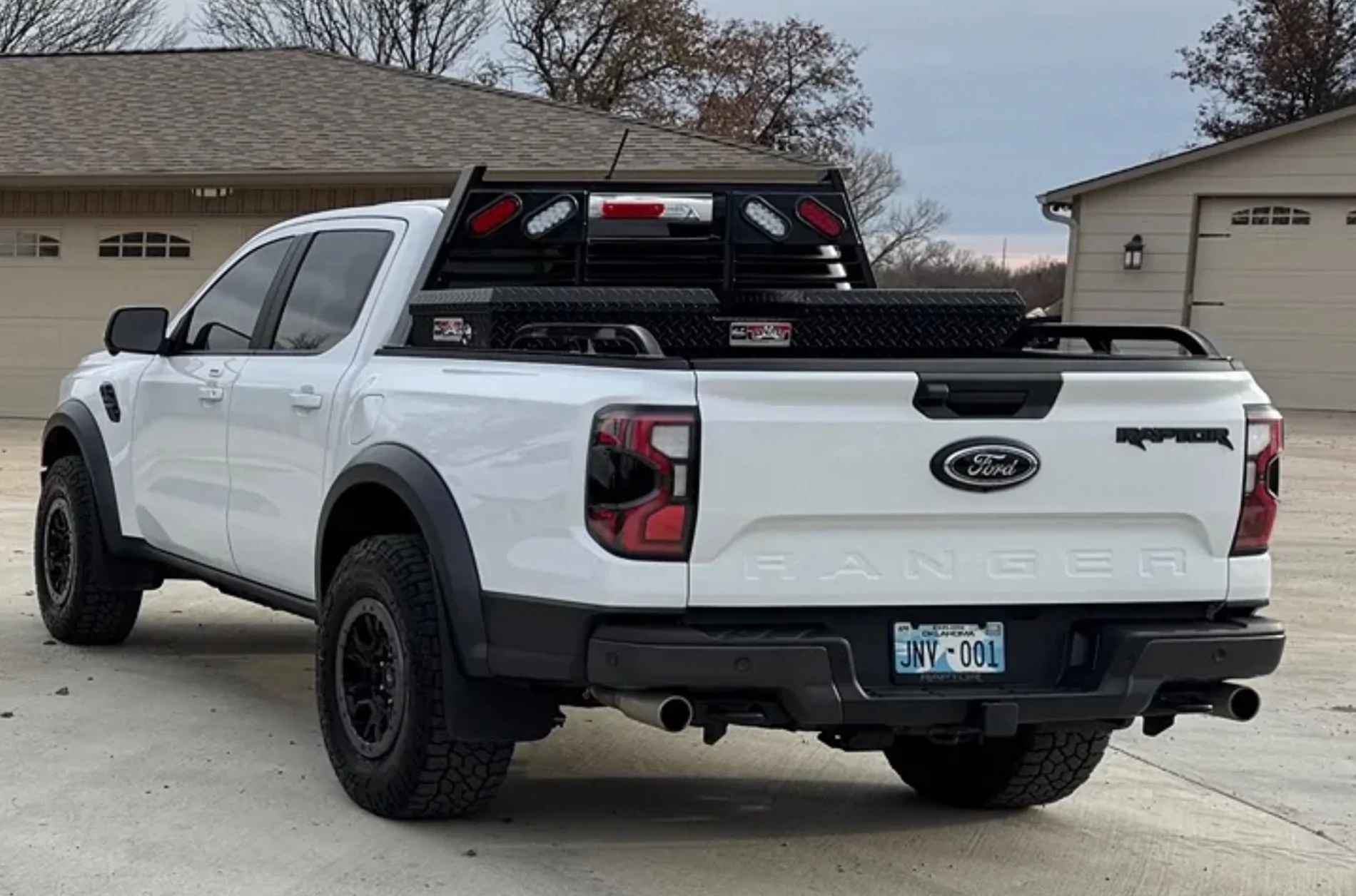

Ever since I installed my lighted headache rack on my 2024 Ranger Raptor.
About 2 years ago, I have had to program its lights as if it were a trailer.
Ford Ranger Anyone know why the rangers seem to randomly forget programmed trailer settings. IMG_6749
Which that trailer program setup has to be done in order to get the blindside monitors back online.
Which for weeks and at times months it would never have any issues, but periodically it forgets its default trailer settings, which I have stored as headache rack only.
Here in the past month it’s lost the default setting at least a dozen times.
‘It’s happened 4 times this week. Twice today actually.
No idea why it’s all the sudden forgetting its trailer settings.
Thus happening to anyone else?
Anyone know of a fix or what is causing it to forget its trailer settings randomly ?

I am Teed in on the back side of the bumper off the trailer plug.
Since I am driving at the time I am not sure if my lights on the rack are still working or not.
Does that not interfere with the trailer modes? I have heard of others plugging in to the 4-pin and it causing trailer connection errors as it confuses it into think a trailer is attached.

Shouldn’t effect anything, just adding more lights with adding an actual trailer .
Would need to add a different trailer profile for proper BLIS distance setup.

Got the 26C10 Update done today.
I‘probably had a 6-10 restarts today and so far so good, has yet to forget the trailer setting for my rack lights.
