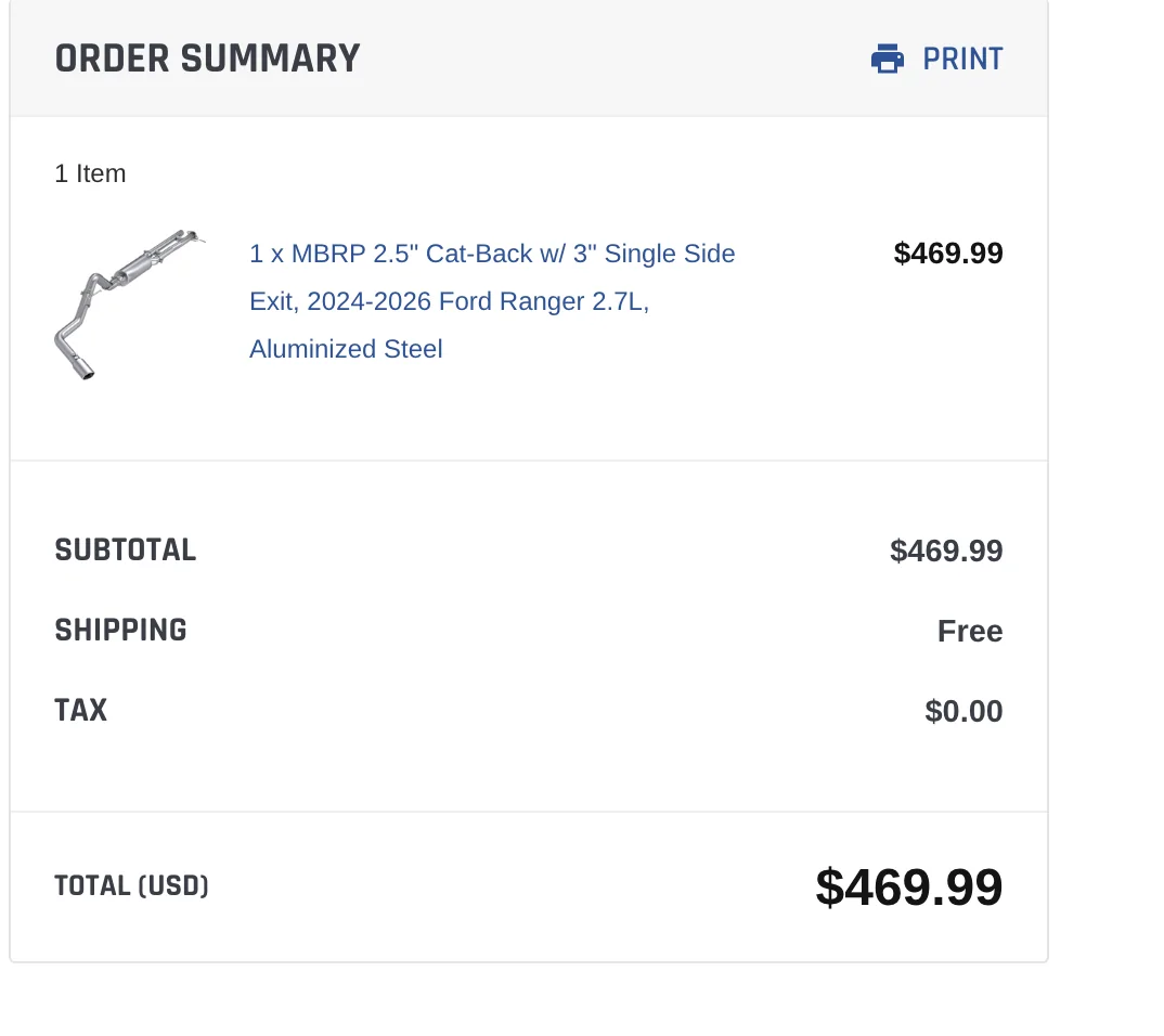

Did you install it yourself? Was it hard to get off the OEM one? I just bought this cat-back for my 2.7

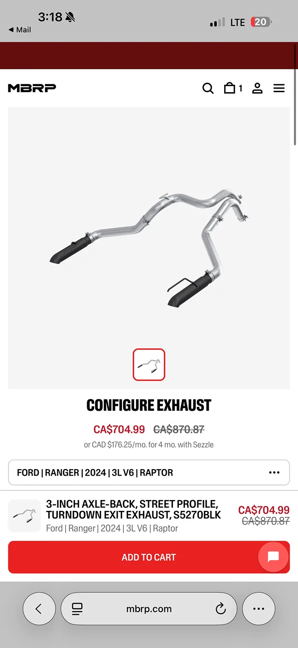

I just ordered the axle/muffler back with black tips. They are sold out and said 3-4 weeks to ship. I wanted turndown tips and black and couldn't find anything else. Shipping is free within Canada (they are a Canadian company). Would like to do a Trombone for the pre-muffler section as well when someone makes/sells them.
Edit: So much for 3-4 weeks, just got a notification that it shipped today. I should get it mid to late next week and plan to install next weekend.

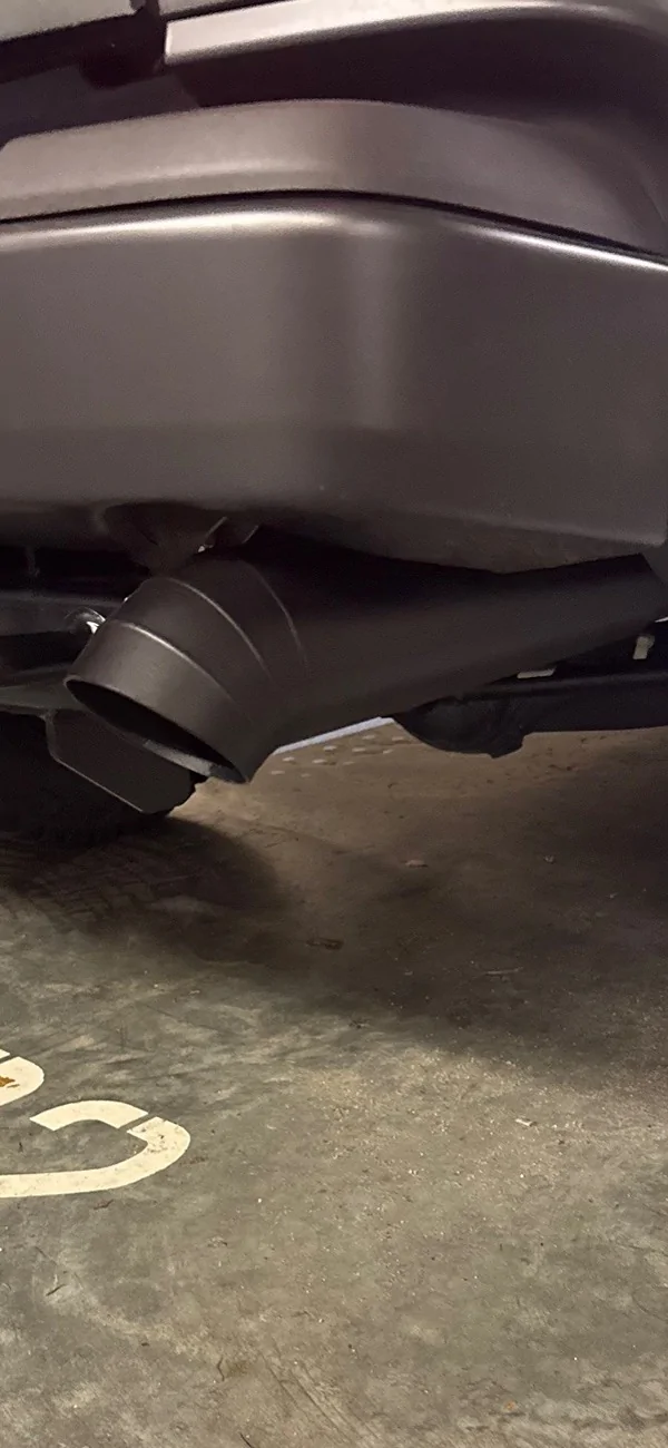

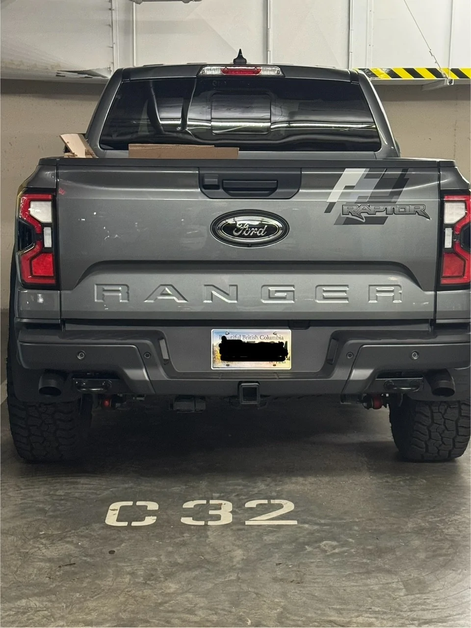

MBRP "Axleback" with black tips installed. Small ship (easy to touch up) on one tip due to poor packaging and two clamps were slightly small (couldn't slide on). Other than that fit was pretty good but there is very low tolerance to be able to have it so the tips fit right and there are no parts of the exhaust touching the chassis/other parts.
Regarding sound, I can't tell a difference in Quiet or normal but it definitely has some added volume and "bite" in Sport and Baja. I did not weigh either system but would assume this is slightly lighter.

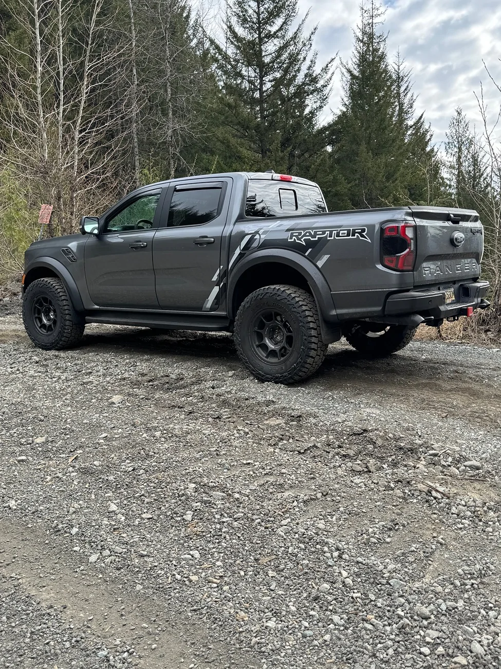

Got some highway driving and a bit of off-roading. No drone in quiet or normal. I’d say same as stock with Sport or Baja. Long steepish hill at 120kph (72 mph ish) in Baja was the only time it was annoying. But left it in normal for most of the drive and it was great.

Further Update, took a road trip from Vancouver, BC to Whistler BC. Did some mild off roading (Forest service roads but this is early spring so roads still had some snow, fallen trees, ruts etc. I didn't notice at this time but I worked the rear tailpipe section loos (shifter so both down tips were pointing in towards the rear tire). I then drove North on the Duffy Lake through Lillooet, BC, Lytton, Merritt and on to Kelowna where I noticed the left tip was just hanging on by...the hanger. I just yanked it out and drove the remainder of the trip with it off and will reinstall and refit the other side this week. In Rally the noise was NOT fun on highway (drone) but neither is the stock one (110kmphr-130 specially). Otherwise I really enjoyed it (along with my guilty pleasure Turbosmart BOV). Truck handled everything I did and was way more comfortable than I expected.
