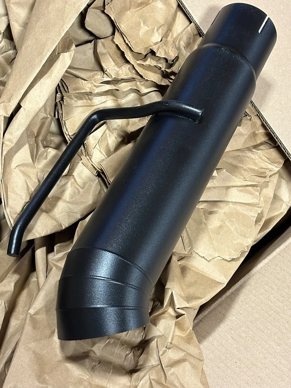

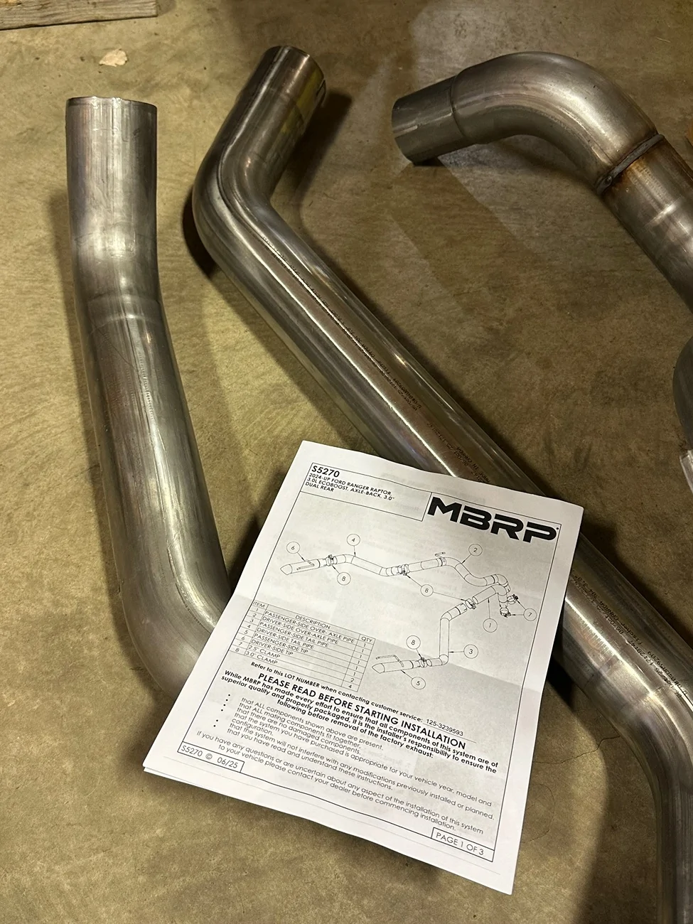

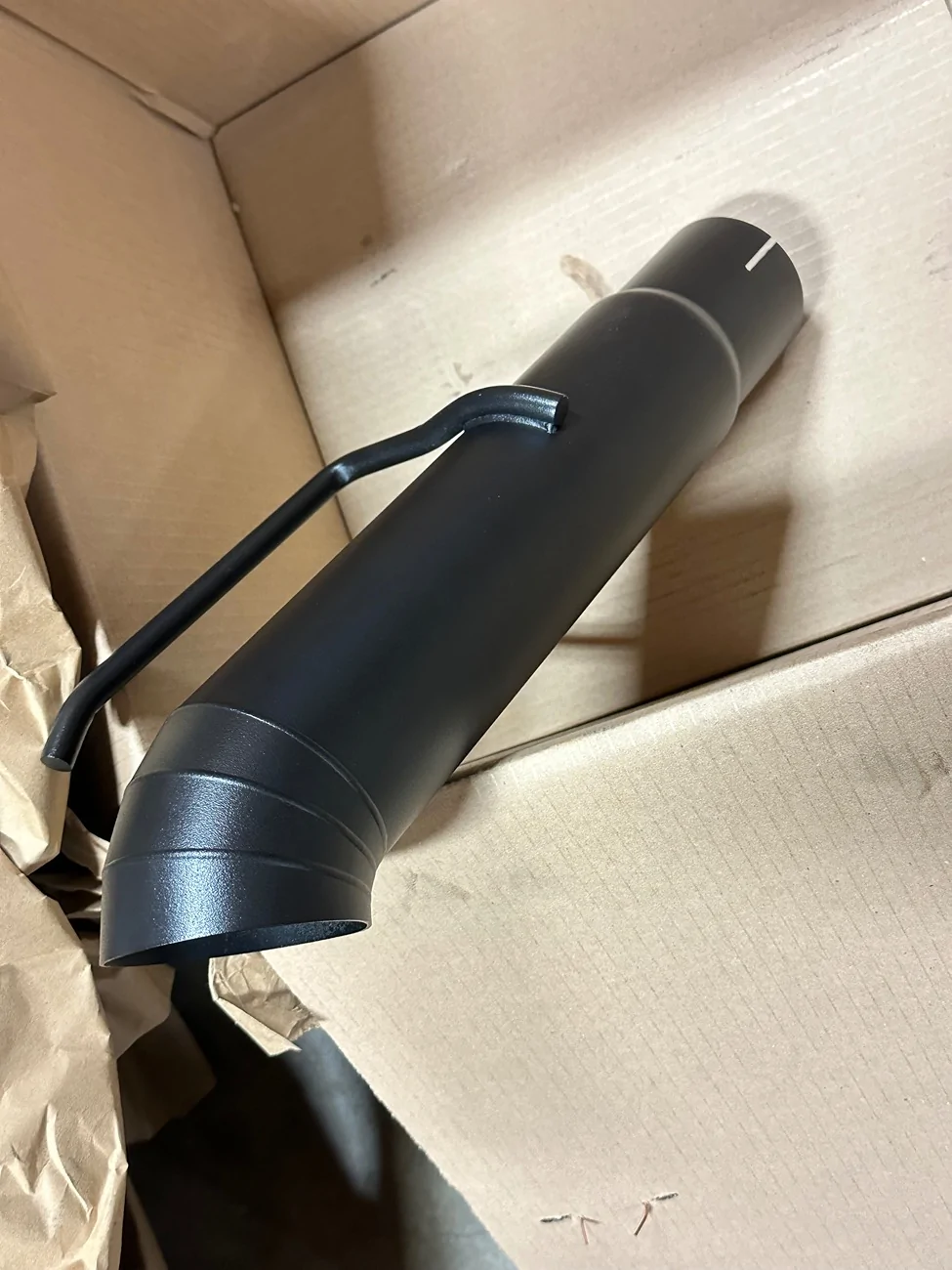

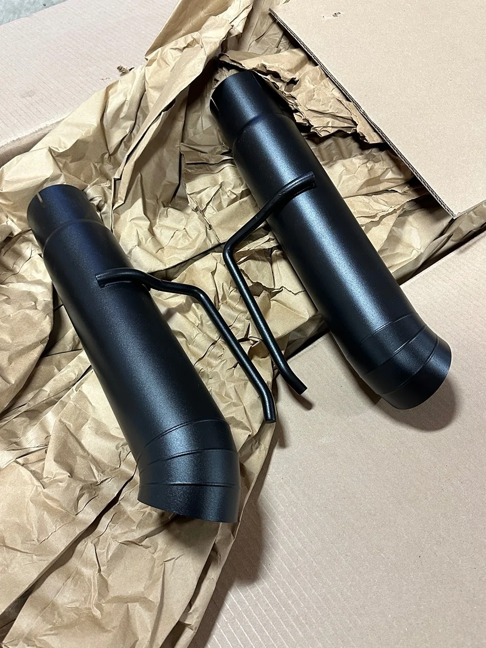

My exhaust showed up today !
only real complaint is the pipes are full of grease from the mandrel bending
it’s all 304 stainless , the pipe joints are mig welded - but that’s up behind the spare tire anyway
tips look good . Looks like a fusion laser weld for the pie cuts .

Wait so the pie cuts aren’t just from the mock up, oof!
No wonder they didn’t show closeups
If you have welded any time in your life you would know that those pie cuts look pretty good .. stainless needs to be purged and not get sugar on the inside . Looks like they just went a bit heavy with the wire cause it is not 035-045 tubing to fuse weld .. polish with a flap disc get the excess off and the scotch brite and will look fine if you do not like the pie cuts .. i would put my left nut down and say the mandrel Could not bend the end it would just pop out .. i do not know though have seen some super odd ways people have welded and bent pipe over my 15 years of fabricating and welding ..

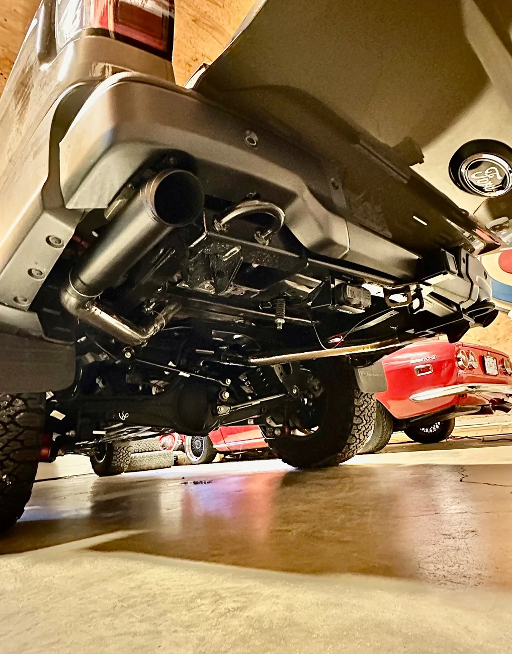

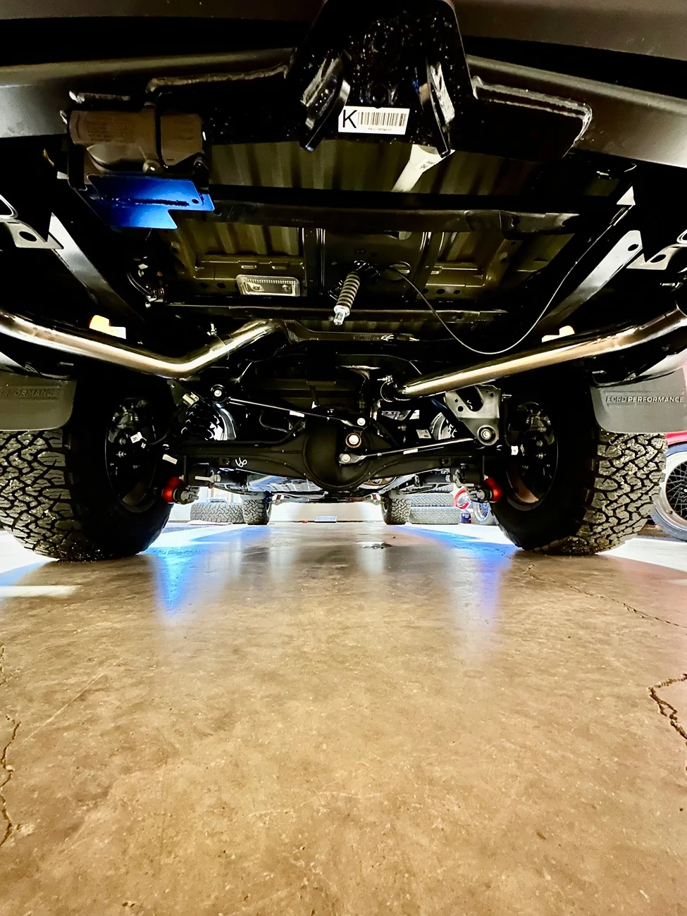

Finally installed my MBRP exhaust
haven’t driven it yet , but very happy with the fit .
