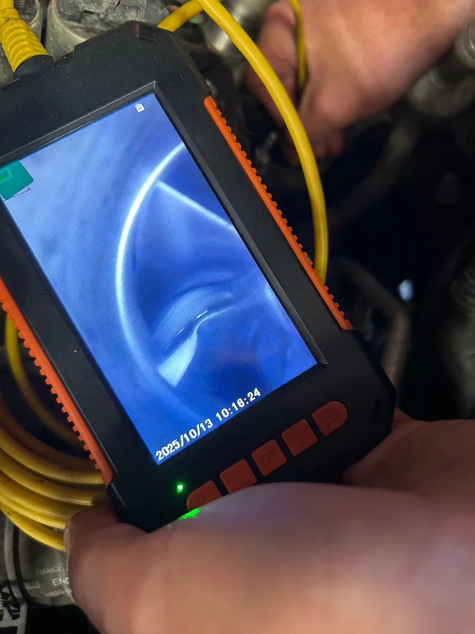

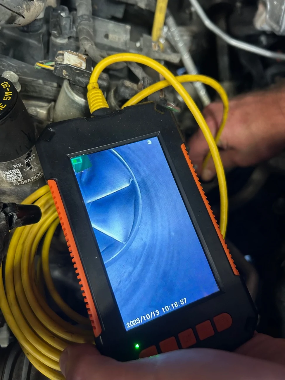

Second, the search continues for whatever destroyed my drivers side turbo. When I get around to buying and installing the Cobb intercooler I’m gonna check the stock IC for any debris or clues.

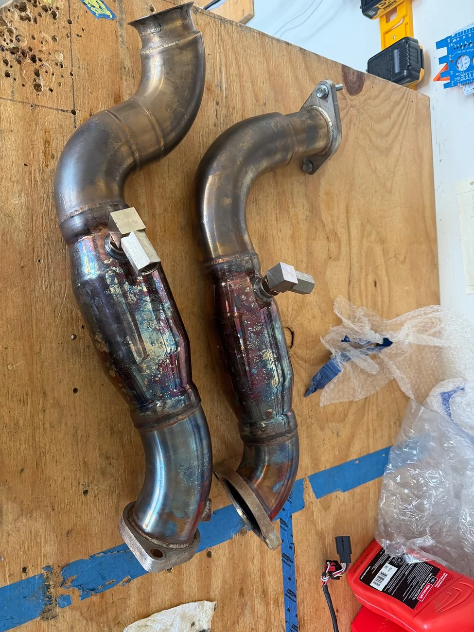

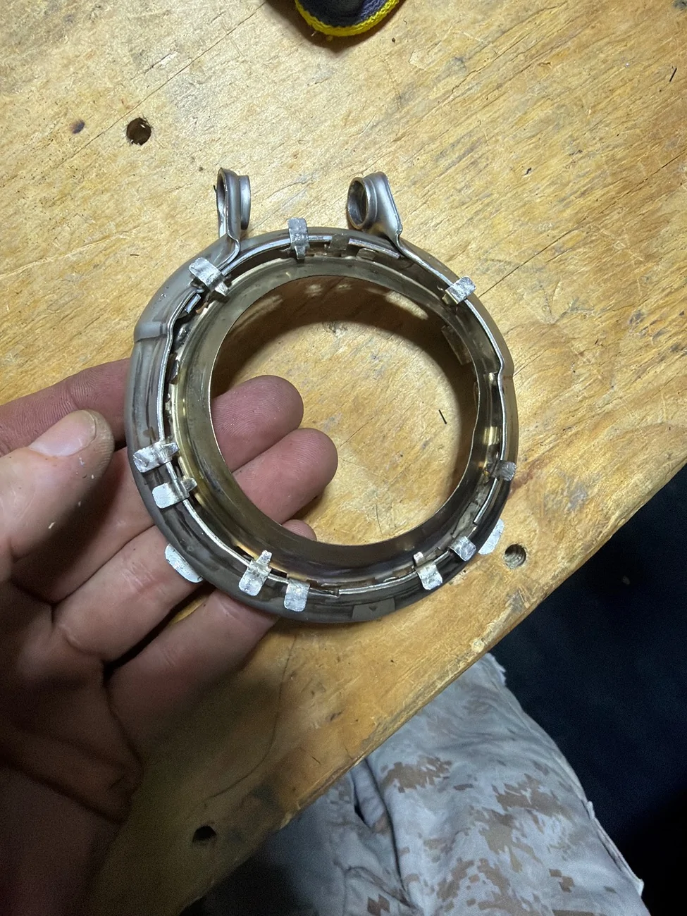

Finally, whoever designed the V-clamp brass gasket thing… should be pistol whipped, I have origami’d this stupid thing for over 2 hrs, and the clamp still will not take it. My last resort, is to delete the gasket as I saw on @wintersgarage YouTube install video and hope there’s no negative repercussions. Every. Single. Install. Video gleefully skips over this part of the install., and maybe (probably) it’s just me, everyone else made it work, why can’t I? Well to Ford V-clamp suggestion guy: tell me why the two bolt flange like the right side connection wasn’t an option? Is it because you haphazardly bolted one end and welded the other of a crossmember in that vicinity? Give me a logical reason why you’re making me F#@% with this?

What in the world happened to your turbo?
Is that the only fin that is hurt?
I'm not sure I've seen only 1 fin get damaged THAT bad, without taking out other fins.
This looks like very lowspeed damage, if that is the only fin. Or you may just have a bad turbo from the factory.

They said it “ate something”.
It happened before I put my S&B CAI on. So it’s either the plastic tab that broke off on the top of the stock airbox or it was loose like jordantii (on the forum) then when the BOV port screws backed out some internal bracket from the CAI did it… I’m gonna find out… cost me over $2k to replace the drivers side turbo.
Is the donut clamp gasket a must when installing the Downpipes? I’m beyond frustrated with trying to get it back on haha

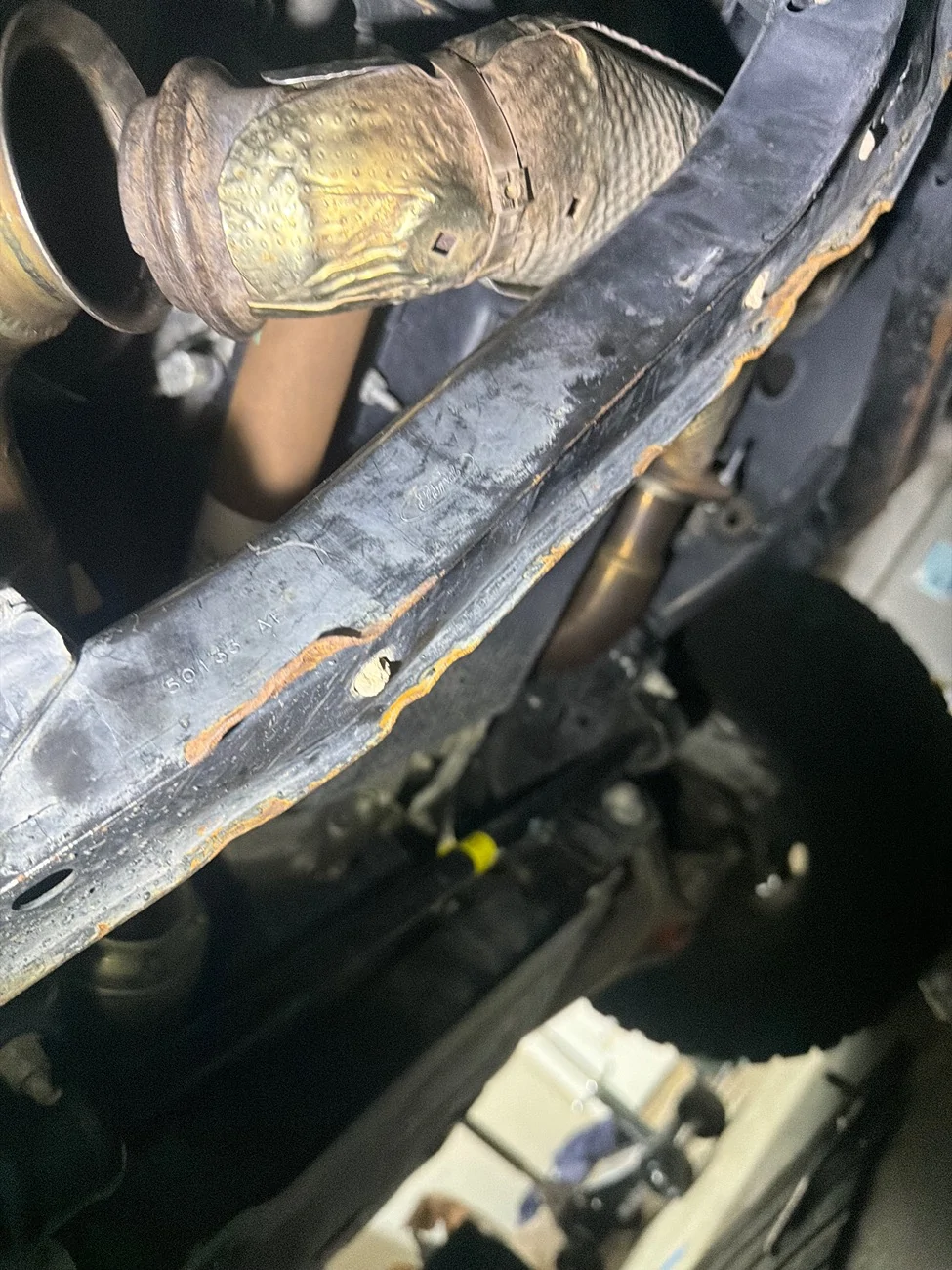

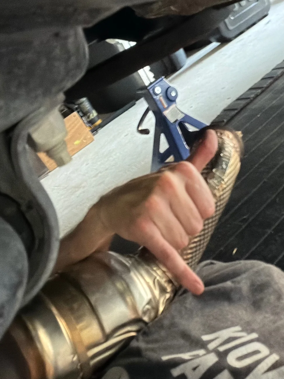

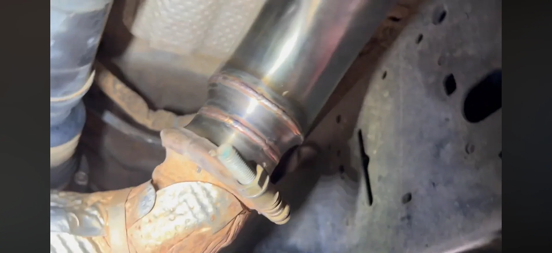

So my fight with the OEM donut gasket continues… I ordered a 3” V clamp off Amazon but it was too big even though the connection flares out to 3”, so I ordered a 2.75” and 2.5” that should arrive today.
I reluctantly reinstalled the gasket after I got a CEL, I also saw the passenger side secondary O2 sensor swivel was loose
*** if you’re going to do this install yourself, buy the O2 sensor “box” wrench or socket but I found the long socket does not really have the room to fit with a ratchet.
I fought the fuggin thing back in and applied a little leverage via bottle jack to the downstream pipe to get it as close to even as I could.. i even loosened the hanger after pivoting the transfer case out of the way…
I start it up, and I can immediately hear the flutter of an exhaust leak and the strong odor.
I ordered a stock replacement gasket and clamp as a last resort to have a muffler shop install it should the 2.75 or 2.5 aftermarket clamp not solve the issue… I really like the Downpipes, the sound and especially the tiny “kick/gargle/babble/noise” that occurs when downshifting in Baja exhaust mode.
but if anyone offers a course on how to install/reinstall this marthafockin gasket please hit me up.

I eventually admitted defeat on the v-band clamp and took it to a shop, turns out the cross section from the catalytic to the muffler/X-pipe was at a twisted angle and being on my back underneath 18in jack stands I just couldn’t get the leverage to have it meet up to the DSR downpipe. Once up in the air the mechanic loosened the hangers and got it done in half an hr.

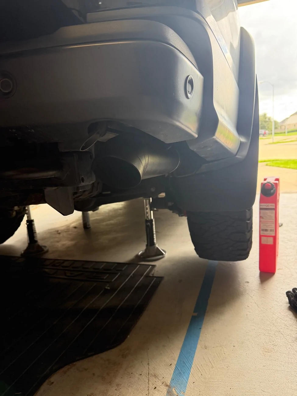

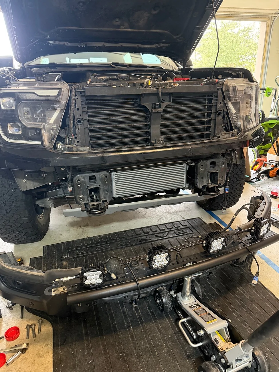

Fast forward to mid September… My buddy found a deal on the MBRP exhaust, so he contacted the guy and bought them, I Zelle’d him and finally got them from Corpus to Houston. I also pulled the trigger on a bunch of goodies from the same bad ass dude that sold me the DSRs. So wrenched away the whole weekend:
- installed the MBRP exhaust, probably could be tucked up a little higher if I had another set of hands..
- installed a CVF (not cobb) intercooler and painted the valence with rustoleum OEM bumper & trim
- tightened up the front bumper and added support brackets for the FMI light bar
I’m really liking the sound this thing makes once it’s warmed up
