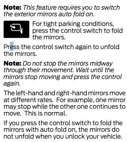

You can fold the mirrors at anytime using the switch on the door as long as auto fold is enabled. I found this out the hard way driving down the road when I tried to adjust my mirror, hit the wrong button and the mirrors folded in on me. Presumably a feature for tight trails when off-roading.
Pg. 109 in the 2025 manual:
Ford Ranger Auto Fold Mirrors RRManualMirror
Looking at the last line there, might have been possible that the OP pressed the button which overrode the auto fold. Perhaps pressing it will right everything.
